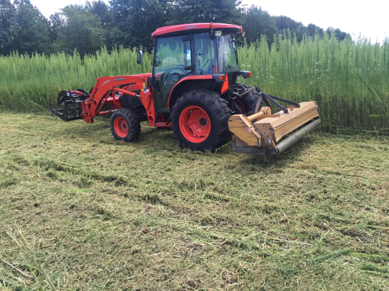

/ Let's talk flail mowers #2,254
<img src="http://www.tractorbynet.com/forums/files/attachments/436690-lets-talk-flail-mowers-image-4292312927-jpg"/>
