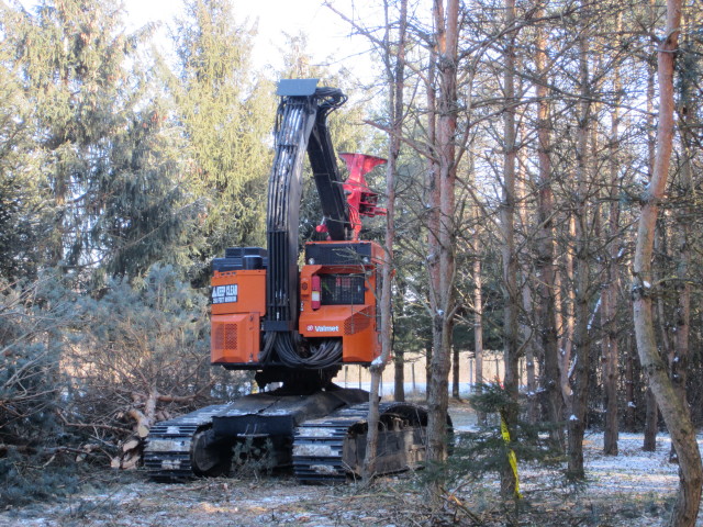

This rig moved through my pine grove pretty quickly.

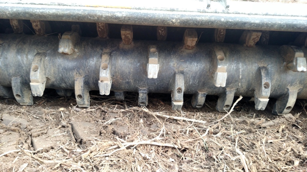

Actually, flail mowers use free swinging teeth, can't handle large material and are inefficient in comparison to fixed tooth mulcher heads with carbide or steel teeth. I started with a flail head 21 years ago when I did not know any better. Unless I am mistaken, Fecon only manufacturers fixed tooth heads. This pic is of an FAE head that uses fixed teeth. With the exception of steel, mulcher heads will destroy almost anything in their paths.

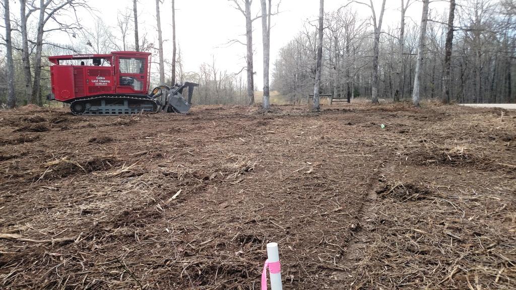

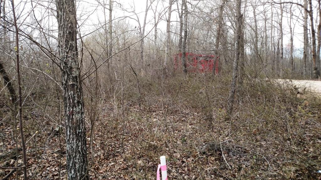

Before and after pics of a job I worked on this past week.
attachment.php
Just a tiny spot on the project but it was full of hardwood stumps and tree tops from logging 2-3 years previous. About 12-15 stumps in this patch measuring 20"-30" diameter at the cut and I took out some other trees as well. Soil rototilled and ready for seed to be cast directly on what is left. Time to completion was about 30-35 minutes and was about a quarter acre. If seed is cast down today, this can be pasture in about 2 months time from what I've seen with other past jobs.

As treemuncher posted not a flail at all. Fecon, FAE, DENIS Cimaf all make very nice mulching heads.
Here are the three options that Fecon has for heads. It is clear they are not a flail.
