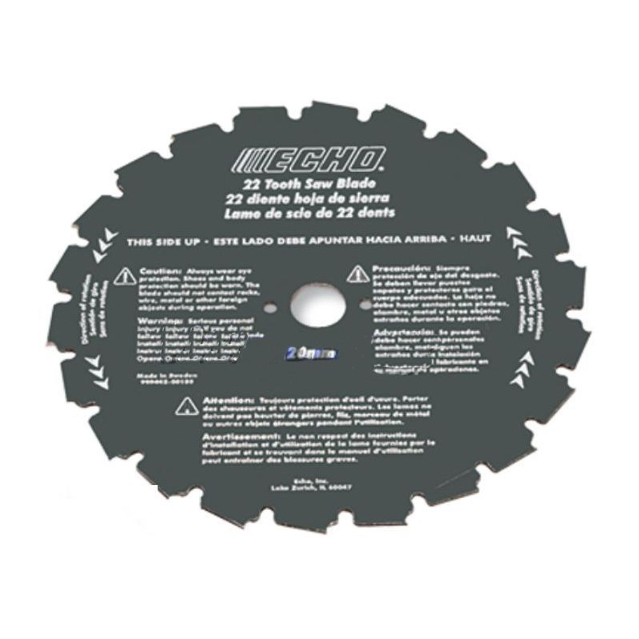

I use these
https://www.amazon.com/gp/product/B07XWNSWK5/ref=ppx_yo_dt_b_search_asin_title?ie=UTF8&psc=1 They cut like lasers and you definitely don't want to 'attack' the sapling, cut it like you would a saw and it cuts right thru. No good on rocks for sure. I have a Stihl trimmer I use line on and a Husky that I use the blade on. The blade is more for specific cutting, not just swinging the trimmer, like cutting saplings on a tree line or cutting saplings/trees in a field before brush hogging.

I use these
Those are interesting. I wonder if I could get them on my Toro. Everything around here is too tough for anything but metal.

Can the blade be resharpened?

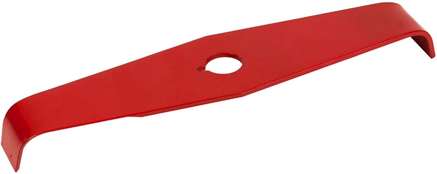

Sure would be fun to run one of those forestry mulchers, but I've cleared some serious brush and brambles (albeit on a smaller scale) with my Stihl chain saws, a zero turn mower and particularly my Echo SRM-410 with an Oregon 3-Tooth Mulching Brushcutter.
I have a LOT of surface rock and the Oregon blade has taken a beating and not slowed down. I suppose I could resharpen it, but it doesn't seem to need it. I cut up to 2" trees, wild raspberry canes, and any number of scrubby woody plants easily, then mulch them up a bit. I can cut larger trees, but they aren't worth the abuse, so they wait for a chainsaw.
