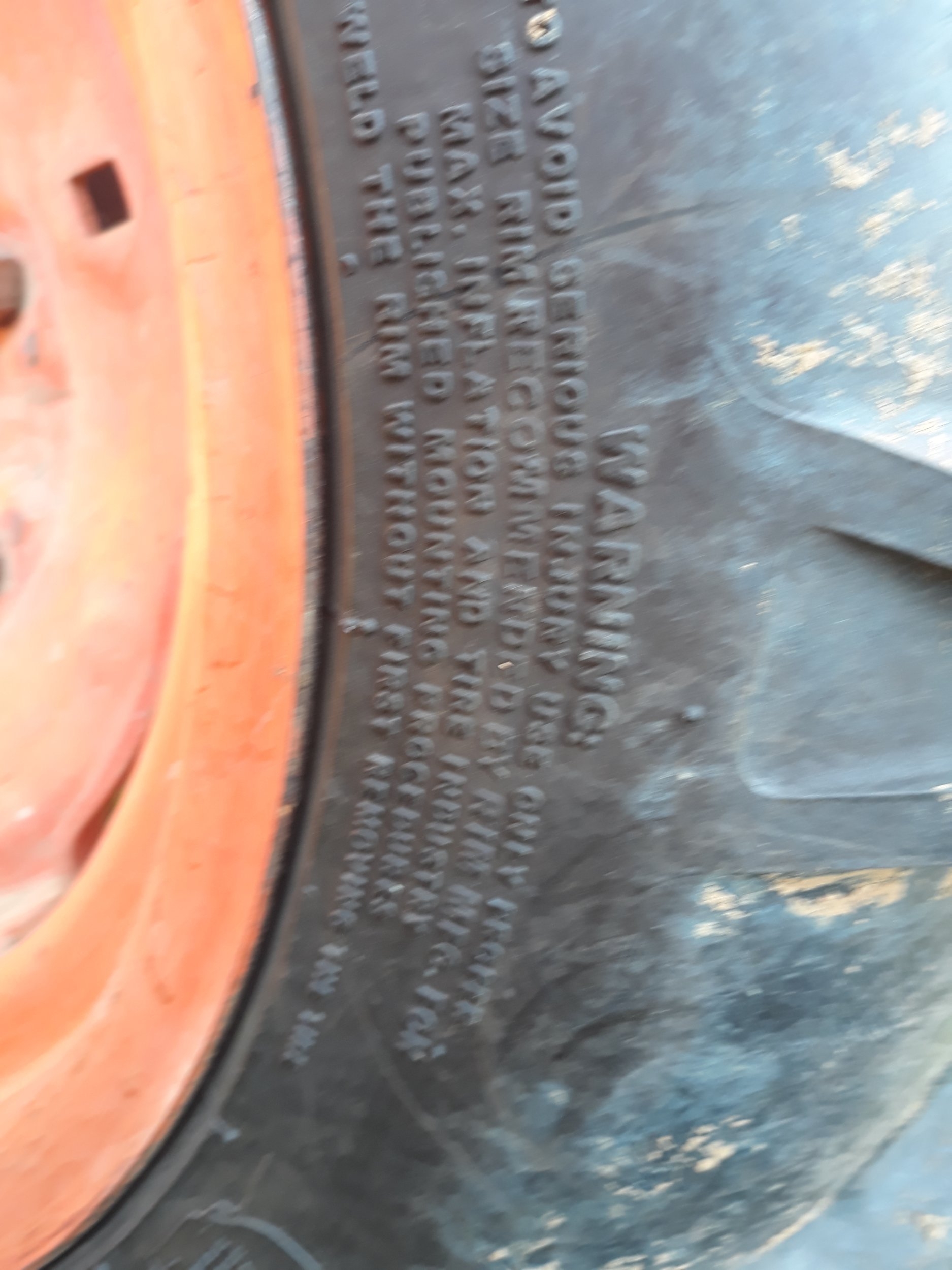

I have owned the tractor for less than a year and have replaced tire because of rolling the tires.Tire guy said to put tubes in front tires.I have bought 4 tubes for front tires in 5 months or so.What can be the issue?I have checked tires for size and they are right.Tubes are right size.I give up.Any ideas?

What pressure do you run in them? I keep them around 40 PSI... I only roll them off when they are low (Have a tube in one and need to put a tube in the one that loses air!!!)

I got tubes in both at 20 lbs

If you have a loader on your tractor I don't think that is high enough. I run mine at the max cold pressure written on the tire but mine are R4
/ Kubota L2800 tires #8
The tire information you gave means they are Ag / R1
Also, what Ply tires? (written on the tire) I guessing you might have the 4 ply vs. 6 or 8.
What does your tire say (on the side wall) about what PSI to run them at?
20 PSI does seem low...
With 4x4 and AG; are the tire sizes: Front: 7-16. and the Rear: 11.2-24

Not sure what the one pic of a tire warning is supposed to show.
But put them at 35-40psi if you have a loader.
20psi.....yea no surprise you are rolling them off the rim.

That is all the writing that is on the tire.I will air them to 35,thanks
/ Kubota L2800 tires #14
I looked up your tire, it is 6 ply and the pressure should be 36 psi (35 it totally fine). Air gauges are at best "rough" estimates!!!

I put them at 35.Its a waiting game to see if it works.Thanks for the help.Will holler back in about 3 weeks if it helped.

Should be fine at suggested pressure. Being smaller, yet handling quite a load, the front tires require more pressure. Mine are to be at 28 lbs, 14 at the rear. Turf tires, and smaller R-4s or Ag tires would be even higher.

Thanks,thats what i am doing now and tires dont look like they are rolling
