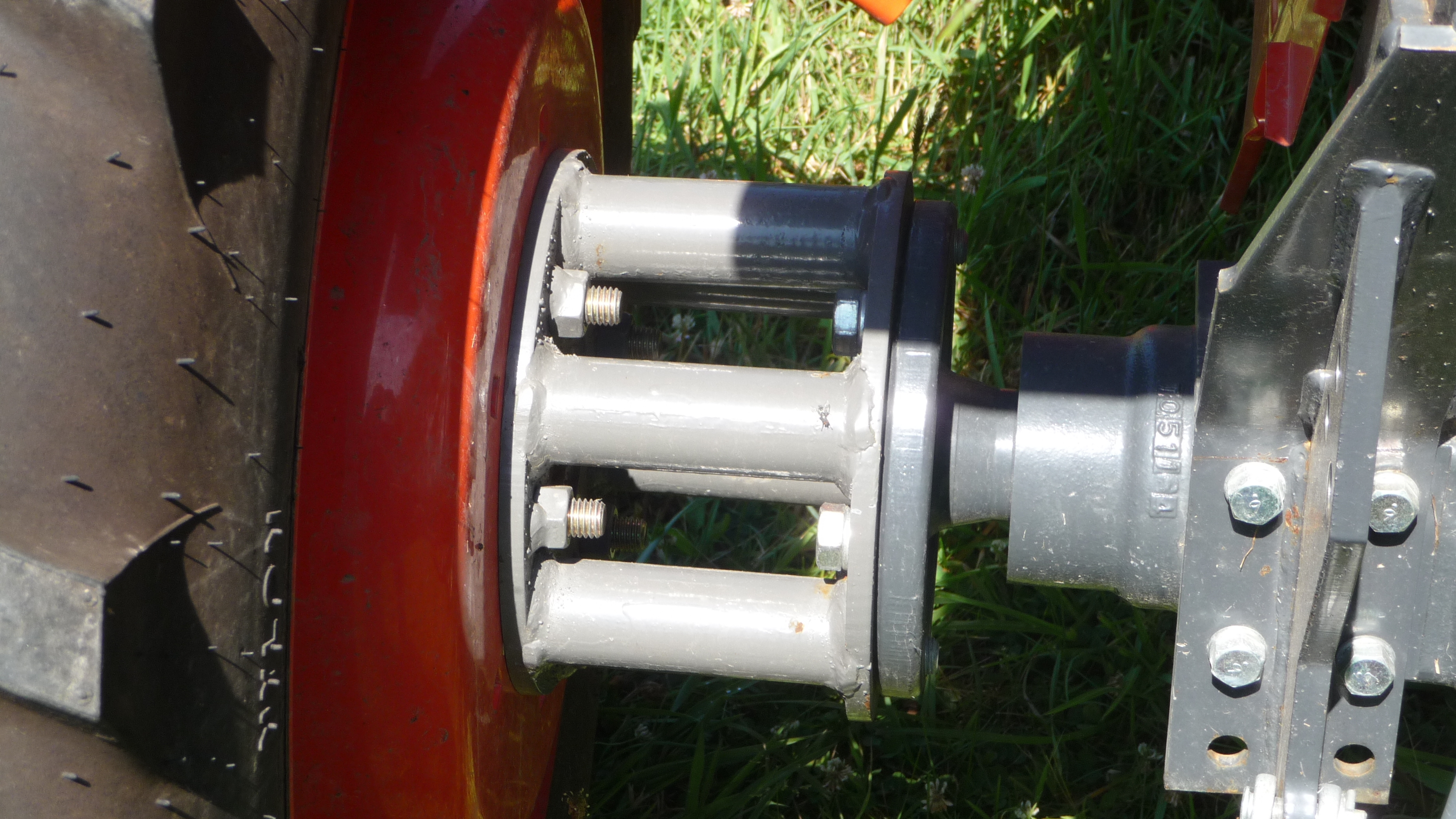

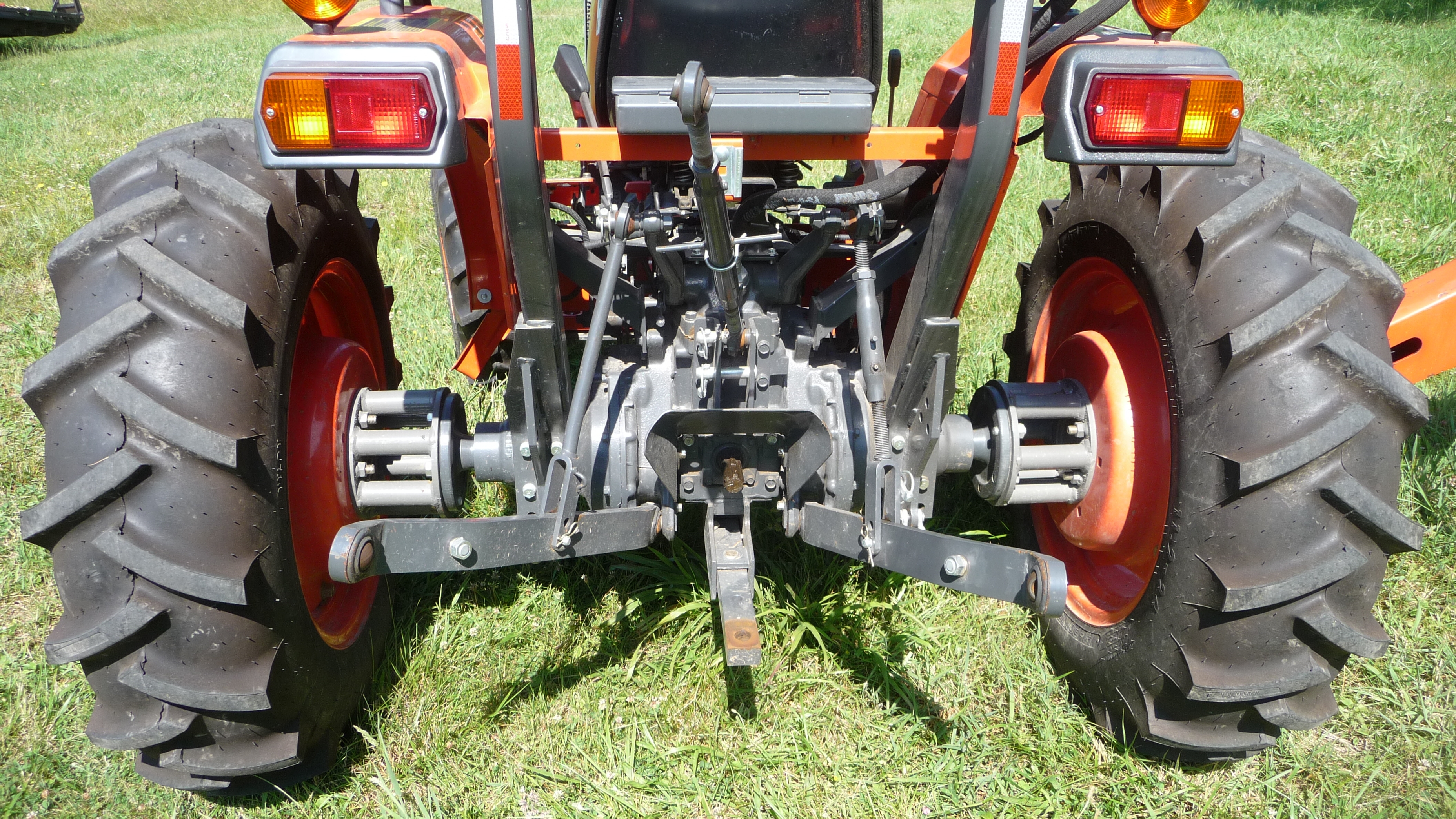

I'm strongly opinionated on this topic and have quite a few posts on it over the years. Can be looked up in TBN search but I'll just repeat my main points here: 1) The Japanese have yet to understand after many decades that a large % of their customers do NOT operate on flat ground. Steep ground does exist. 2) In my opinion one of the very few faults with Kubota is almost none of their tractors are made with adequate rear wheel widening capability built in. When they came out with the M8560 sized tractors (3x the weight of yours) they finally began to offer almost adequate rear-wheel-widening capability. It is still short of Deere, MF and New Holland but WAY better. 3) Now for more direct response to you: I had B2150's (have 3) which are fairly comparable to your B2650 in size/weight. It is very hard to overstate the value/impact of putting 6" wheel spacers on the B2150. Mine went from tipsy and unusable on steep ground to being safe, reliable and great on pretty steep ground (45% slope routinely.) Like a totally different tractor. That was 12" of overall widening and I have never regreted any aspect of doing it. The one "had to fix" aspect was the belly mower would no longer clear the big wide turf tires on it and I had to have the mower deck frames modified. Of course ideally I would not have big wide turf tires on a tractor I was using on steep ground mowing brush, etc. but that is just my oddball circumstance, not yours. That whole issue is gone if you are not using a belly mower.
The spacers I chose were BORA brand from Motorsport Technology in Reno NV. Everything thoroughly thought out and well designed both for use and for installation. Not cheap but changed the nature of this tractor big time. I've kept them on for 10 years , no problems, very pleased.
I'll go ahead and include a few photos. The 4th & 5th photos are a different (steel tubes) design used by my pasture renters on an L3400 34 hp Kubota. They are quite happy with their L3400 on steeper ground now and it too went from tipsy to comfortable. Those steel tube spacers were installed by a Kubota dealer and in some places have been listed as dealer installed Kubota options. They might be 4" each side rather than my 6" each side? Mine are the black machined aluminum units.

Thanks for the responses. I think the message is clear; wider is better particularly since I am not using a mid-mount mower nor ever will be. Now the question is whether to DYI this or take it to the dealer.

Mudfarmer -- I don't know what you may find with the dealer. They vary. The one in my farm area (north central WV) only carry one kind and one size of spacers. Buying on line you have a very wide choice of how much spacing you get and which brand/type. I can only speak for BORA Motorsport Technology that I bought which is excellent. In shopping around I found 2 others that seemed very good as well. As long as you can jack up your tractor, handle the tire/wheel moving, and have some thin wall deep sockets it is an easy installation process. I did use a helper only because of the heavy tires and my "feeble advanced age."
