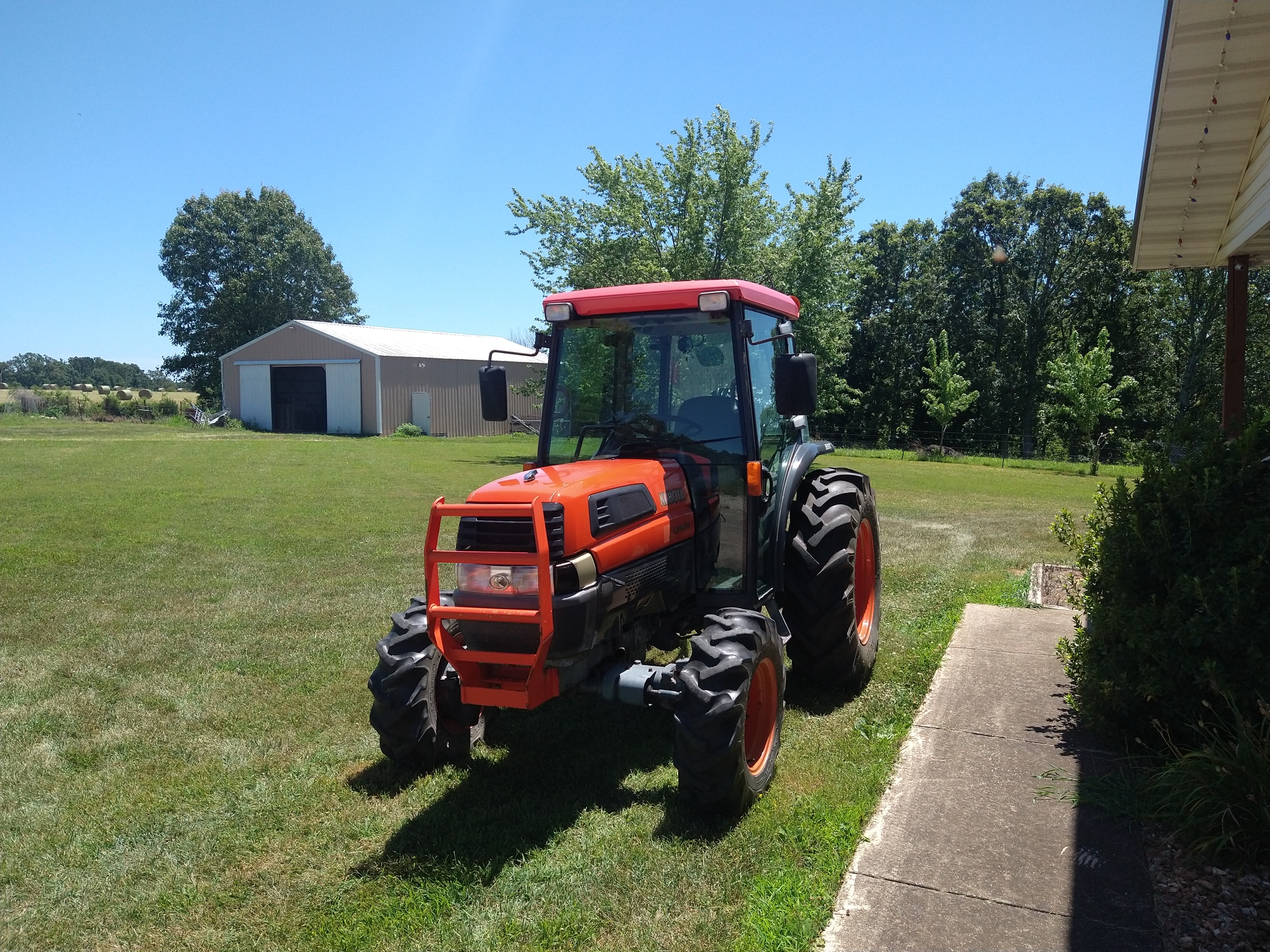

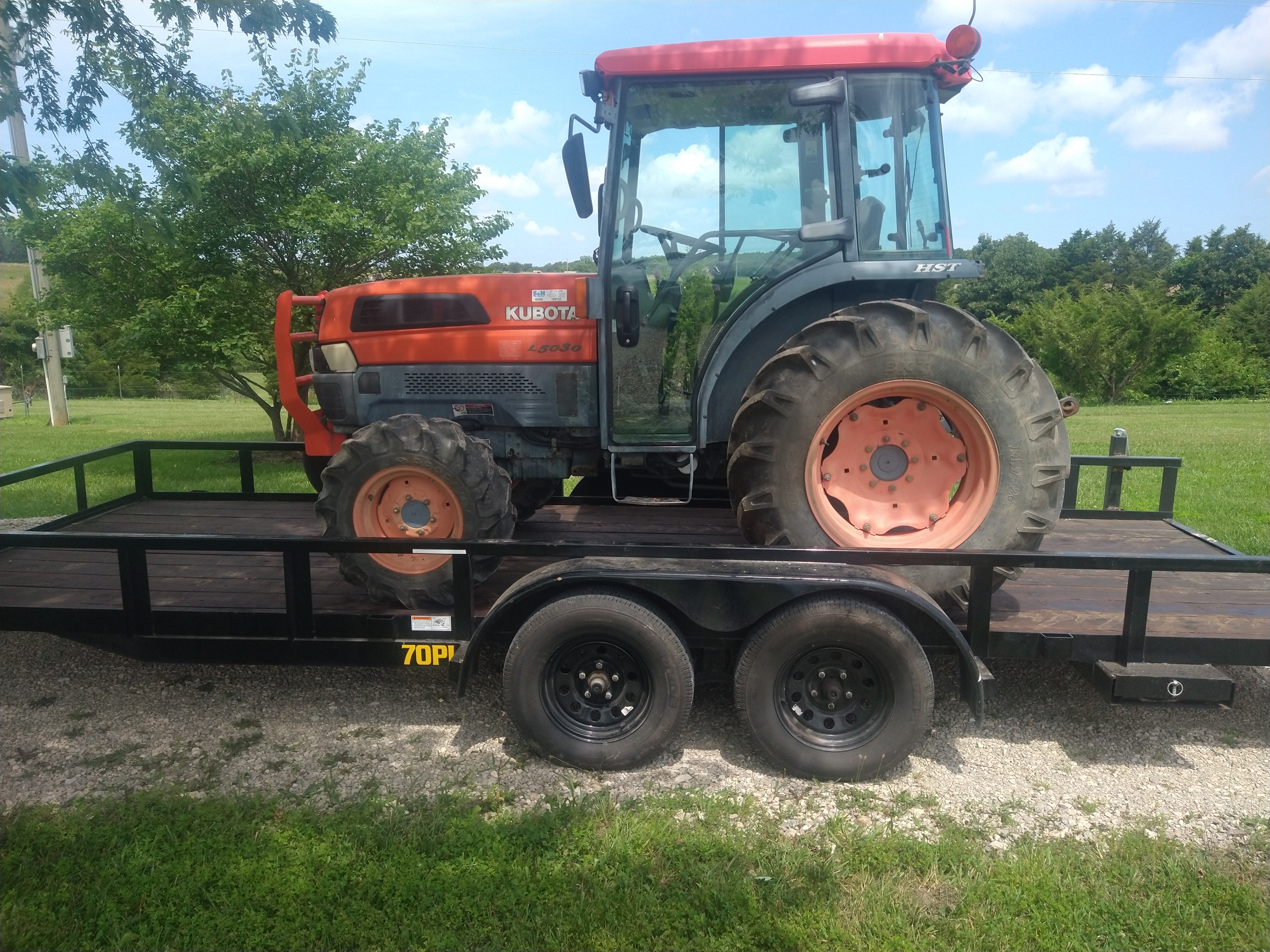

Two weeks ago I picked up a 20 year old pre-emission tractor to use to mow my fields. I still need to save more pennies to buy a 8’ finish mower to pull behind it … It's a 2005 Kubota L5030 HSTC.
I think paint should be shiny, and I used to simonize/clean cars when I was a teenager … so, I wanted to see if I could save this 20 year old faded ugly paint! Yup, there is hope for this old tractor, I waxed half of the fuel flap!

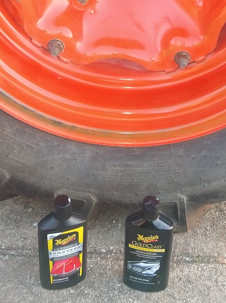

Since I was almost out of wax I ordered more, plus some rubbing compound … I had forgotten that I had previously bought another bottle of cleaner wax, but put it in the old box of the good wax because it had a nice storage spot for the applicators pad …

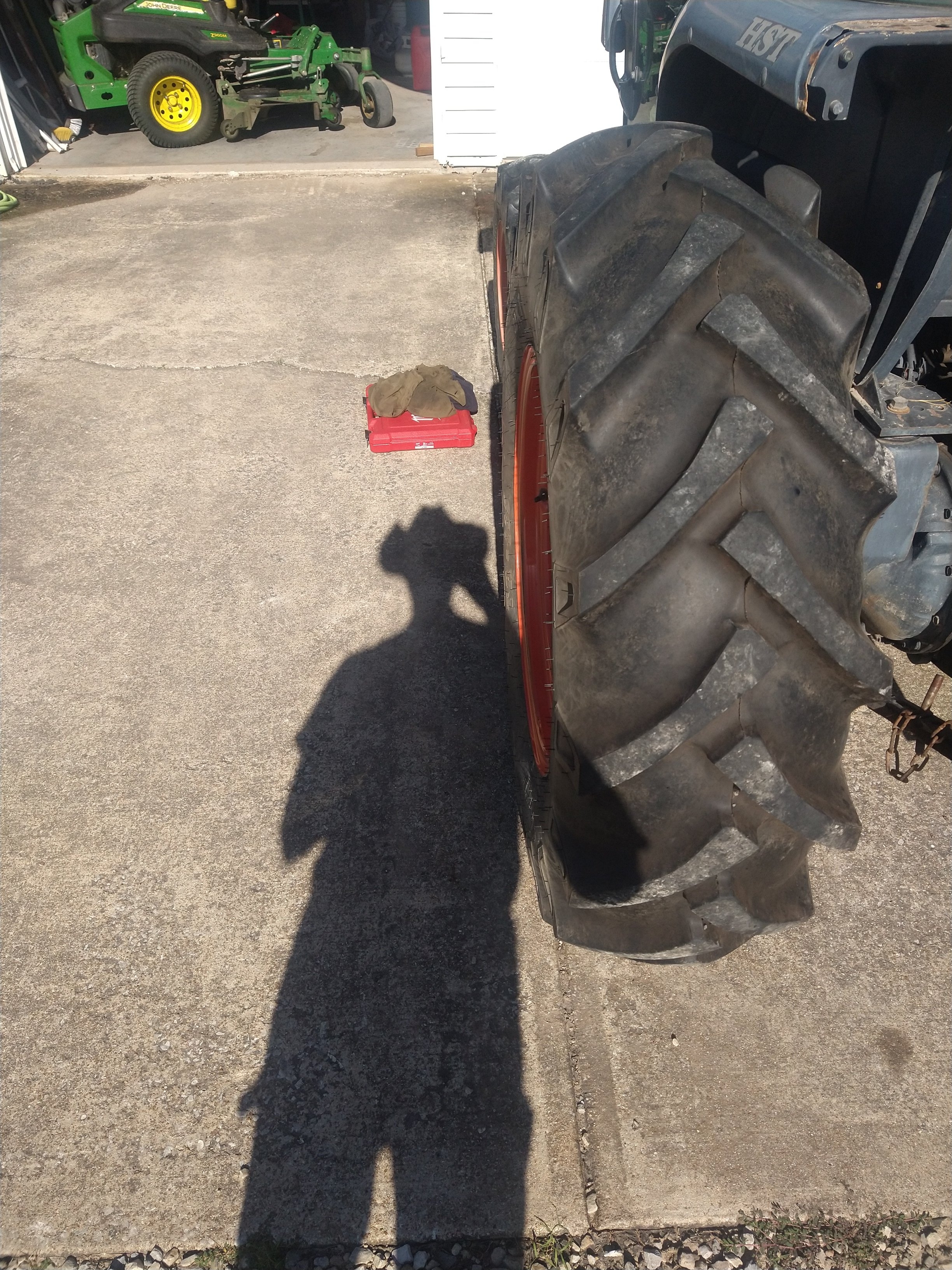

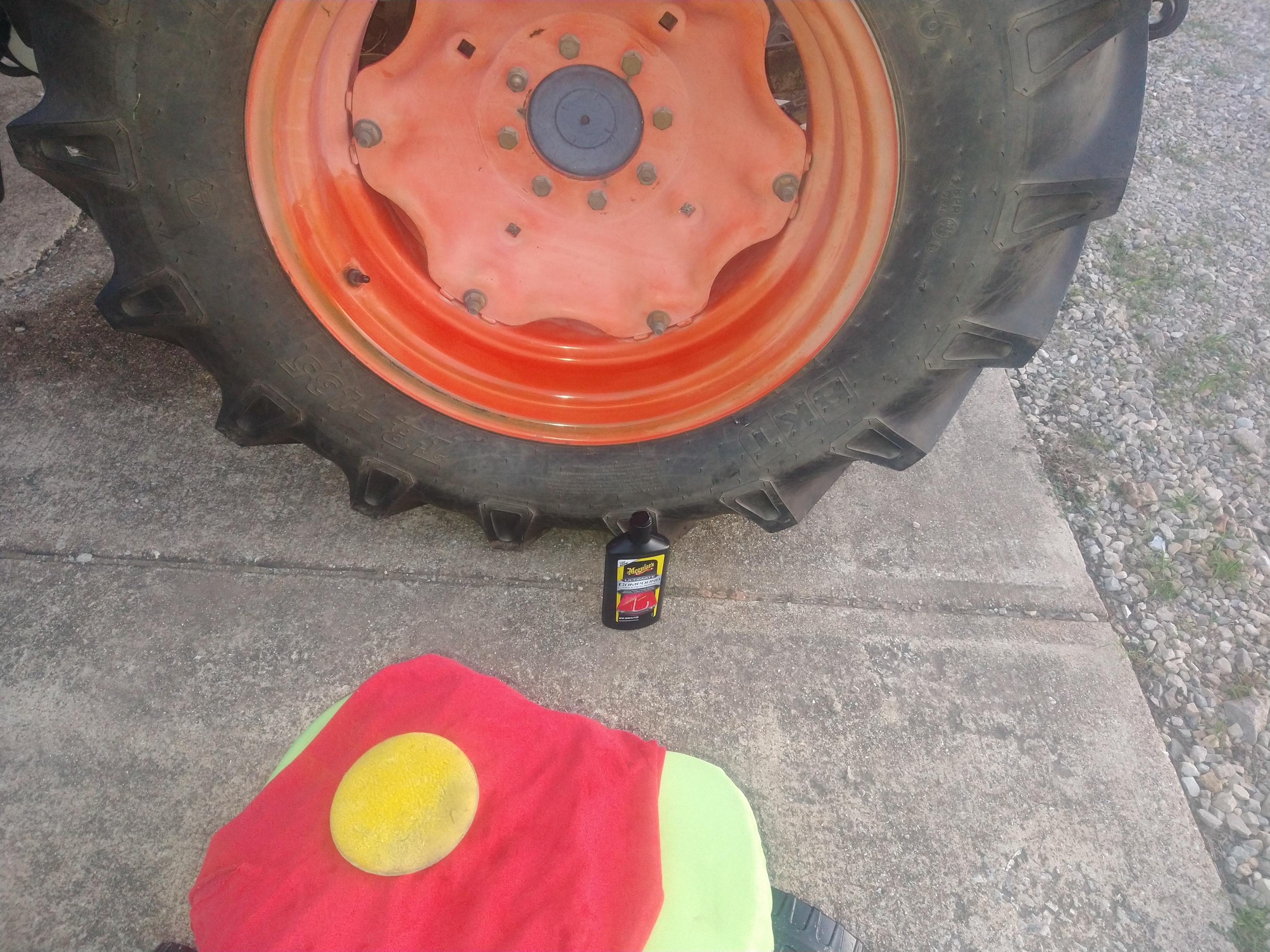

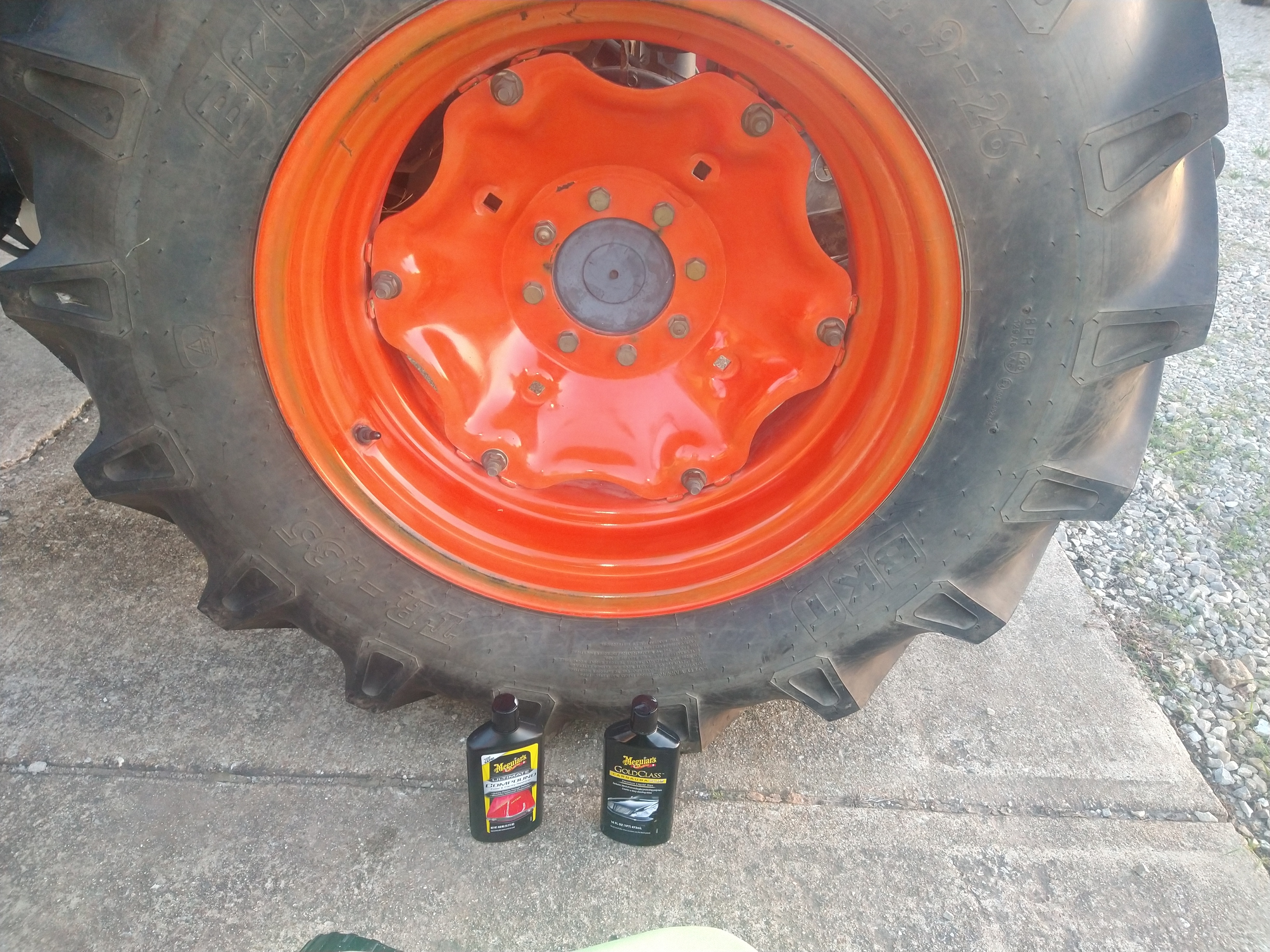

I got home again this morning for the day … I wanted to widen the rear wheel track width … I figured part of the process was switching sides, since I had already washed and scrubbed it last Sunday, I wanted to clean up the wheels before the outside became the inside…
Quite a difference a bit of elbow grease makes!

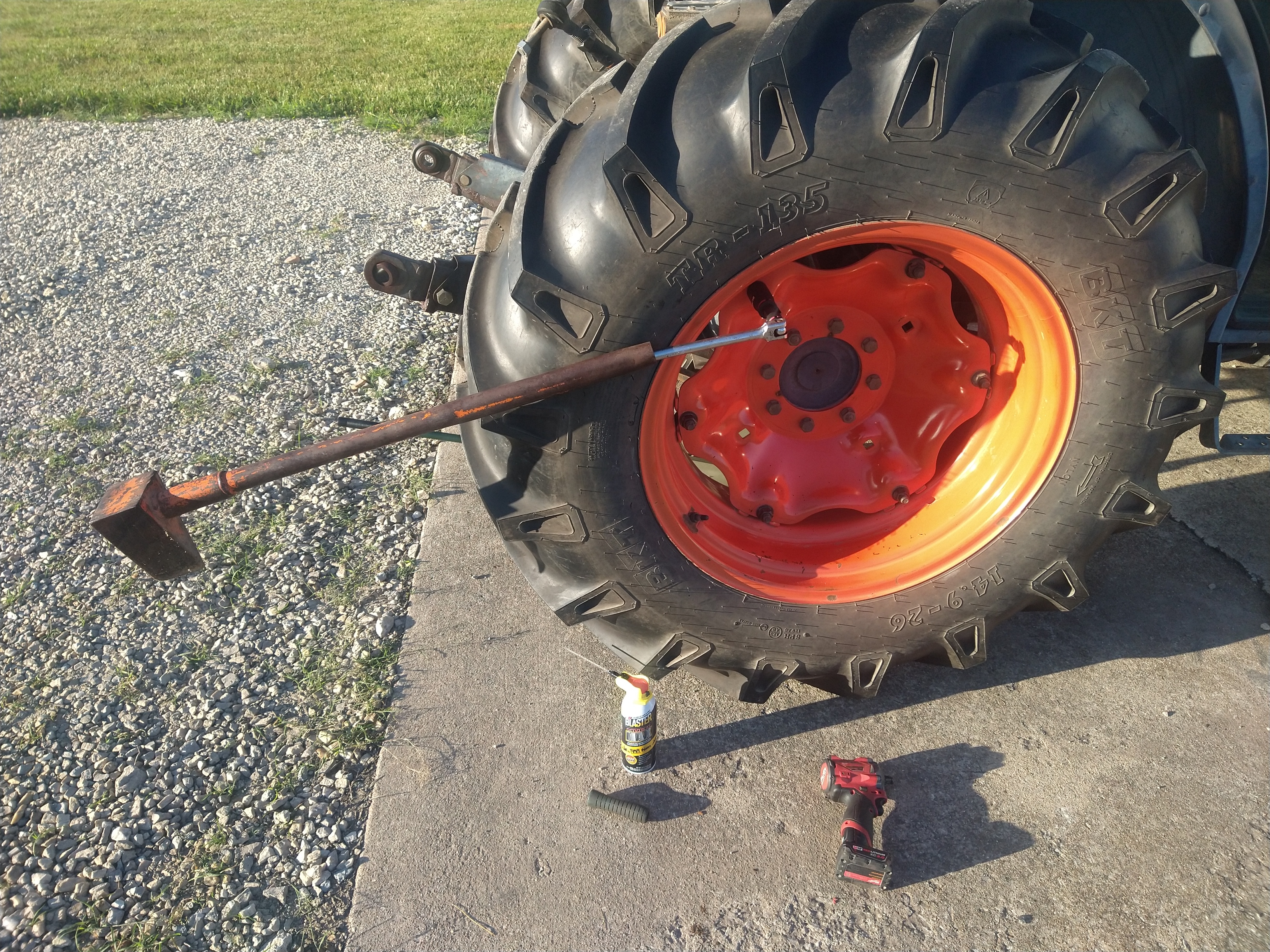

I did have a little trouble getting a few of the nuts off, my 250 ft lb impact wrench wouldn't budge a few of them … Monster Maul to the Rescue!

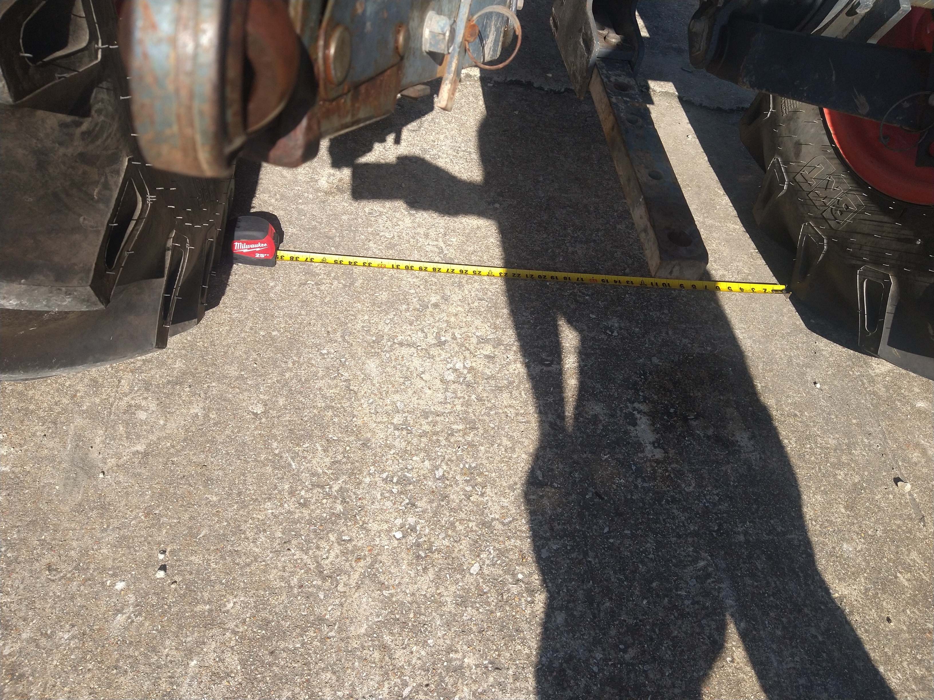

But it appears that the rings are centered in the wheel, so I didn't switch sides, or clean the insides!… so now they are as wide as they go … I gained 4.75”

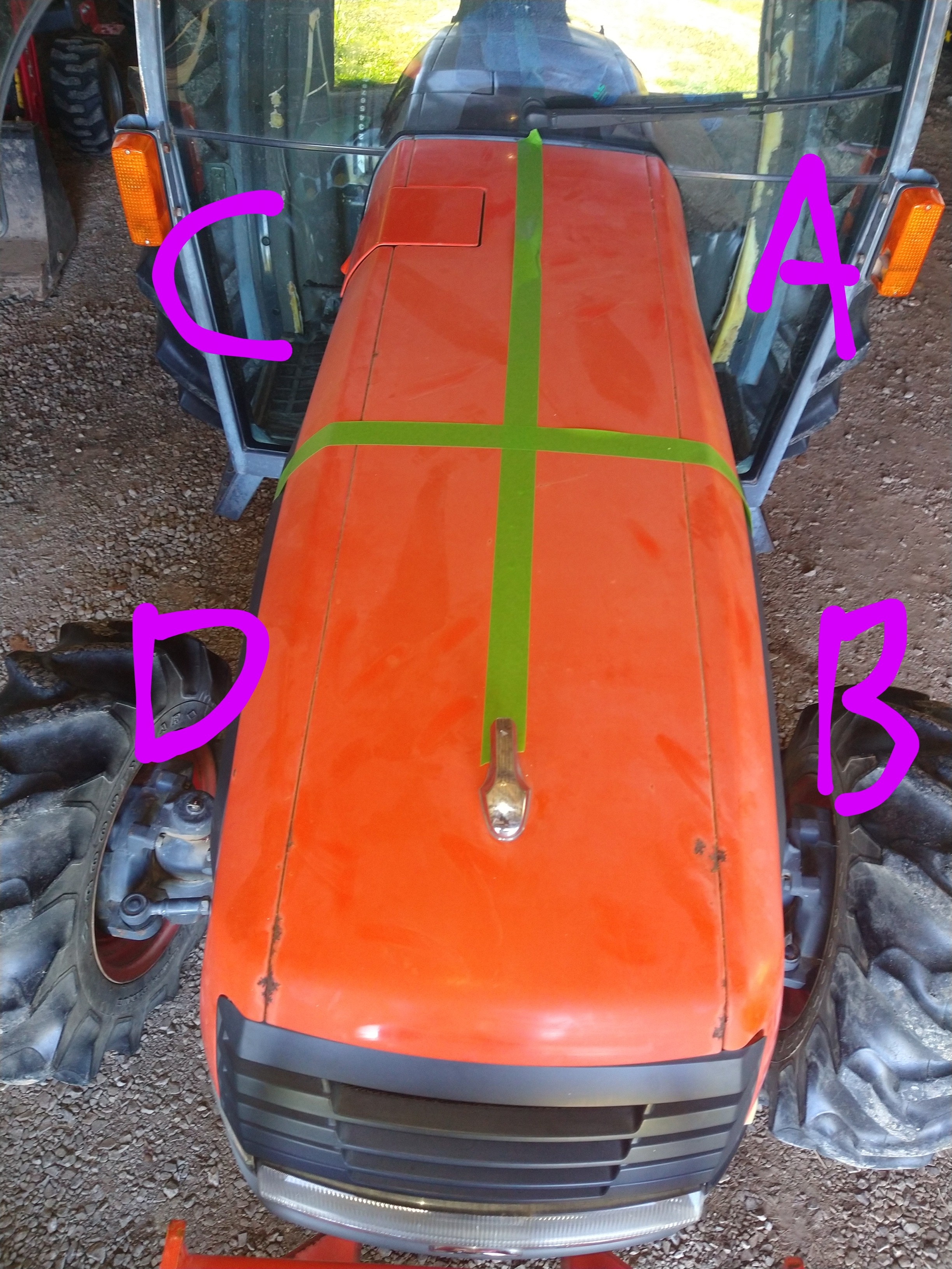

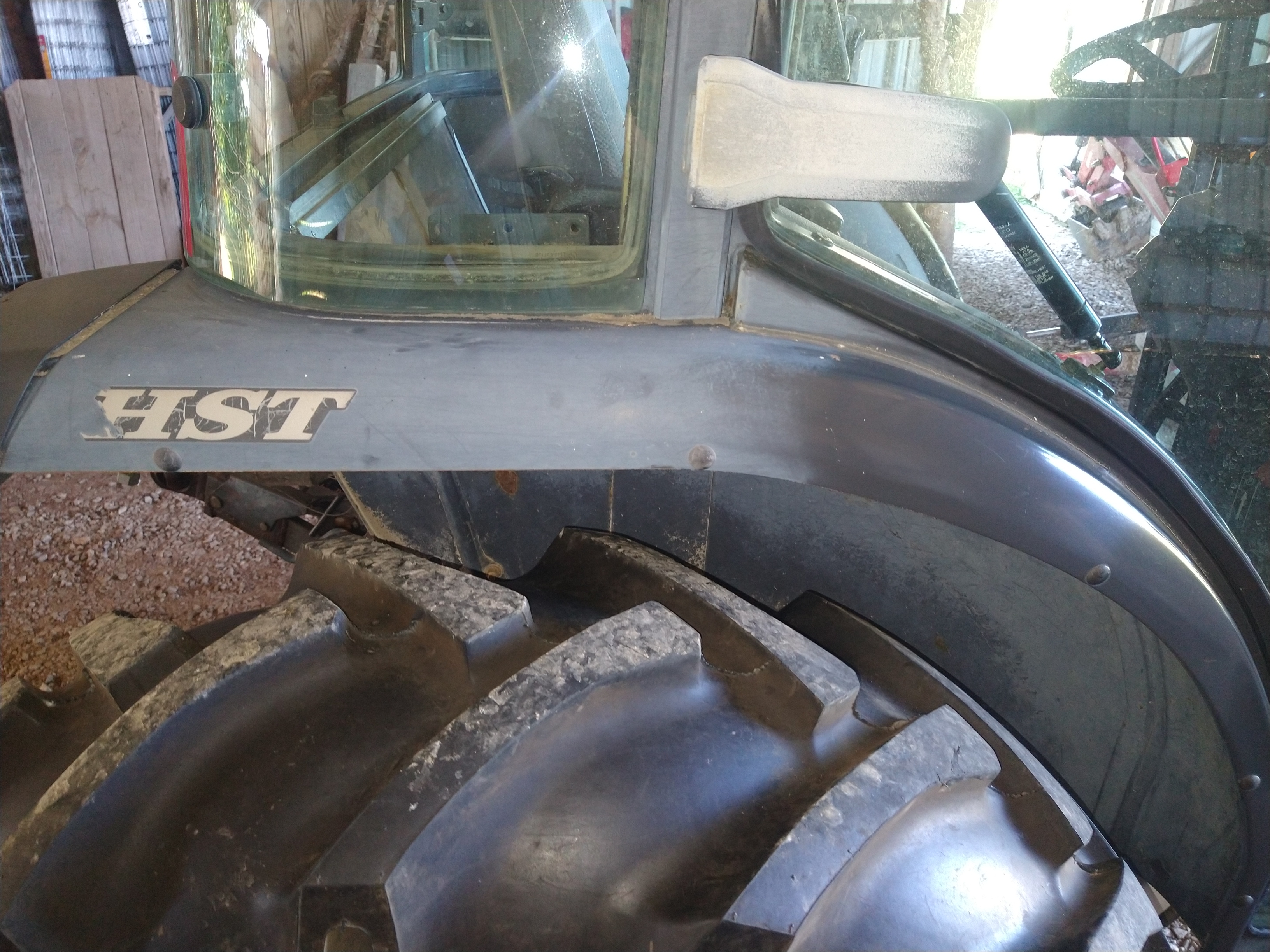

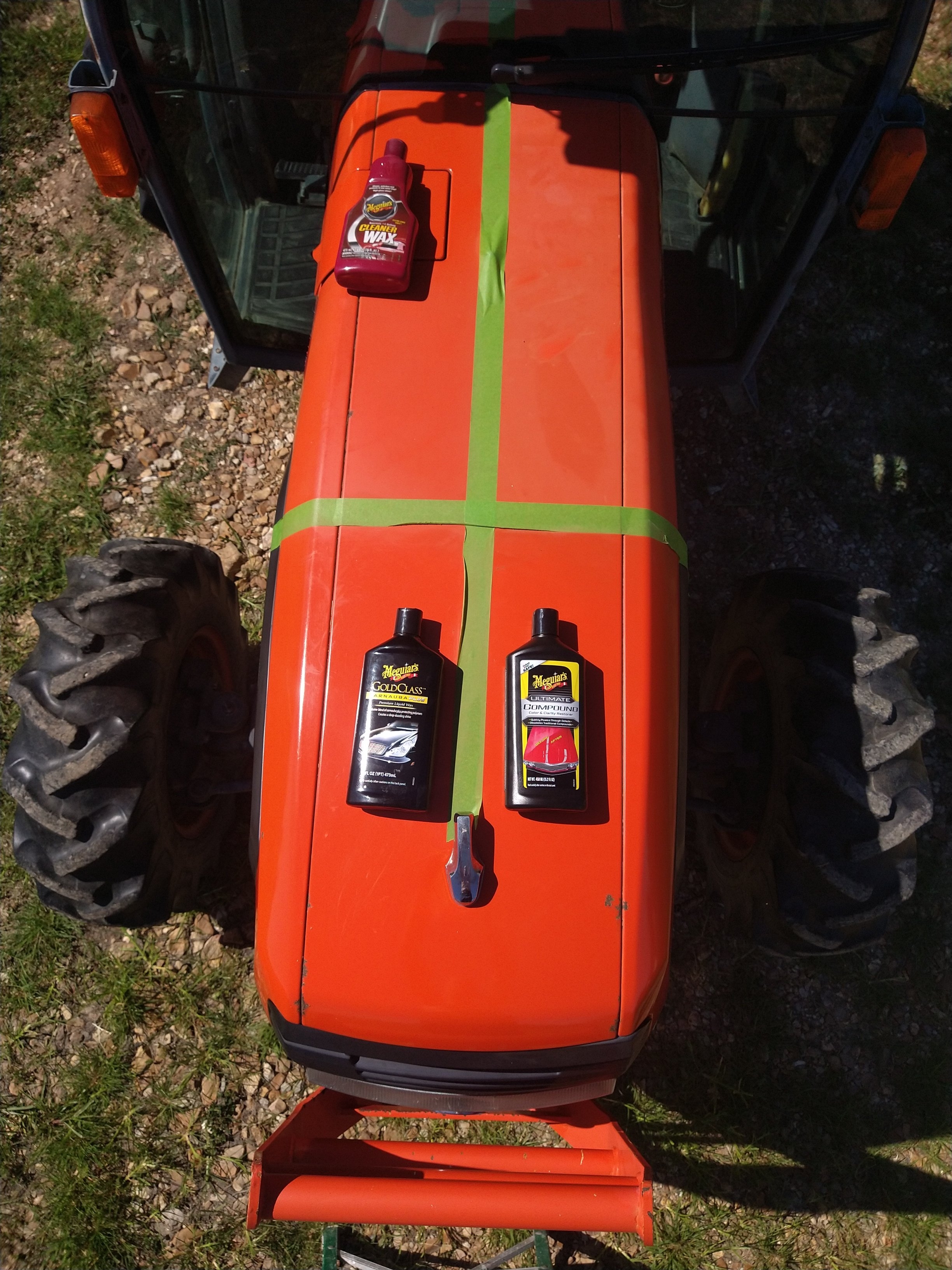

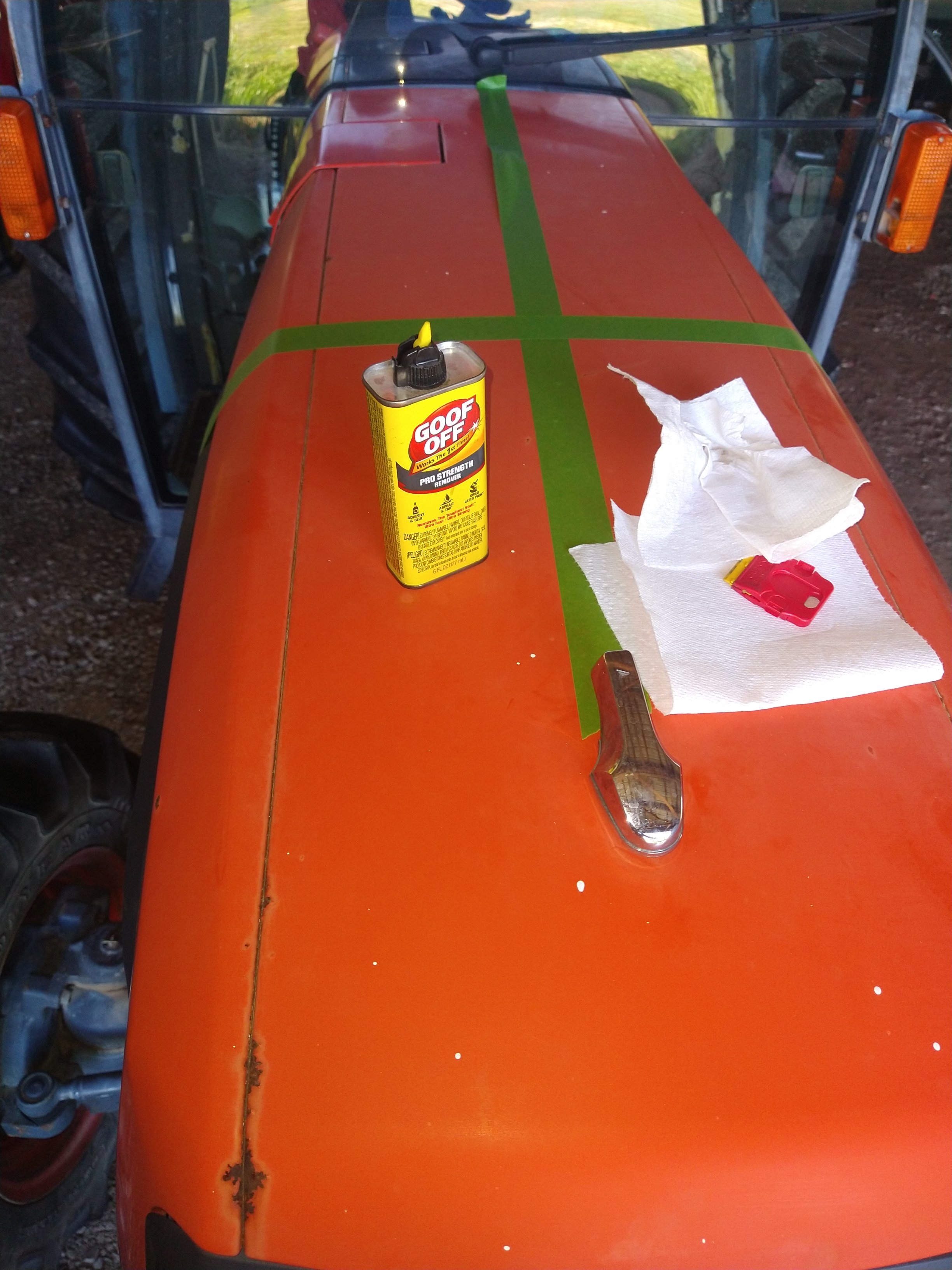

I then put it in the barn out of the sun, as we are in a heat wave now … I decided to see how these products compare … I noticed some white paint drops, which I was able to get off, then started my experiment …
A = Just washed and paint drops removed
B = Rubbing Compound
C = Cleaner Wax only
D = Rubbing Compound + Good Wax
The gray cleaned up real nice too!
I then did the Rubbing Compound on all of it, and used the good wax on all of it too …it's far from perfect, but probably the first time it has ever been waxed!

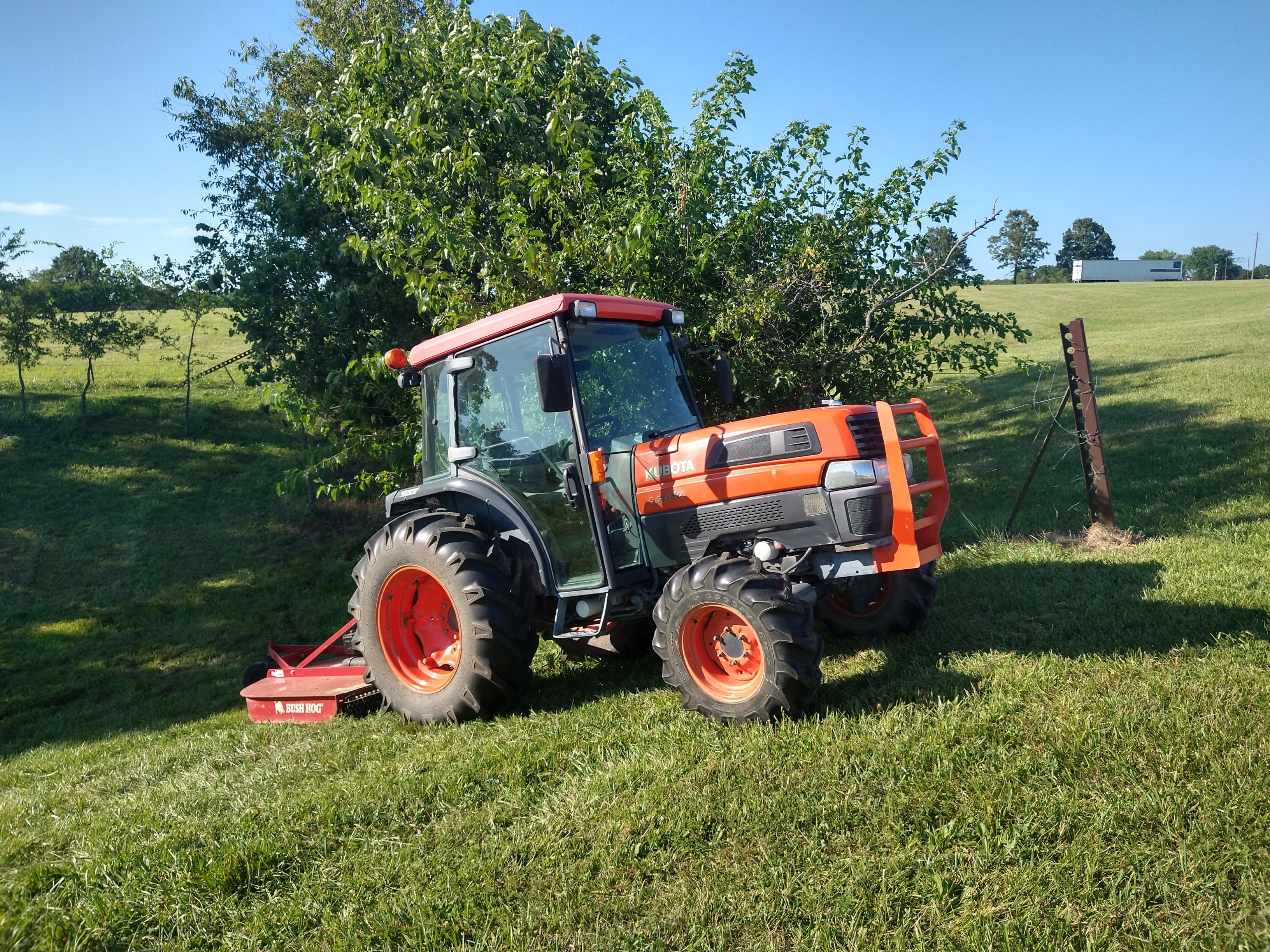

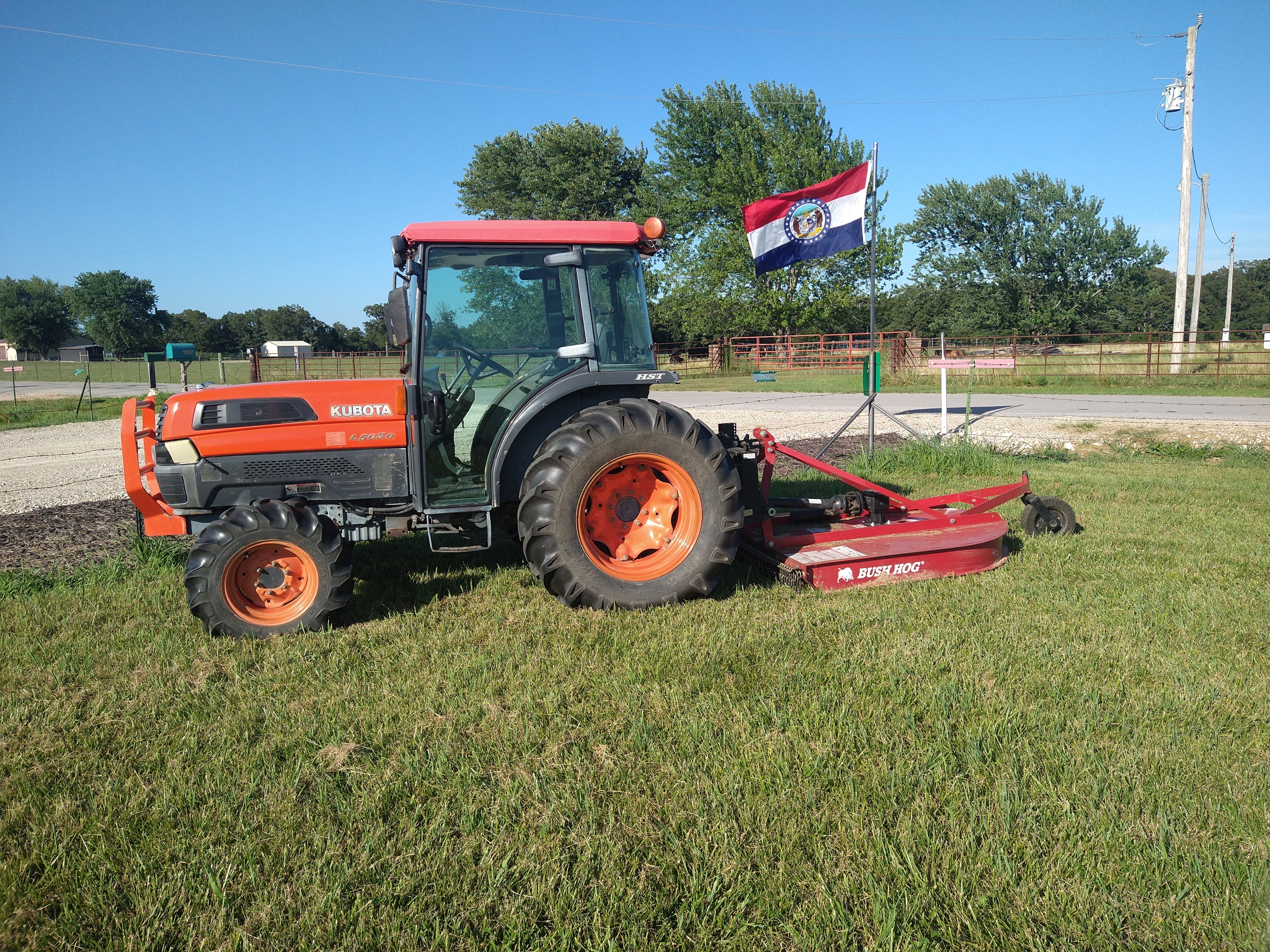

Then I borrowed the quick hitch from my SCUT. I have a new one sitting at the dealer, but they were closed when I drove by this morning before 05:00! I had to shorten the bushing for CAT 2 to CAT 1 about a ¼” to get it in-between the quick hitch.
The top link the dealer gave me was for a JD 4400, as mine didn't have one, the JD was re-sold with a hydraulic top link … it was just barely long enough!

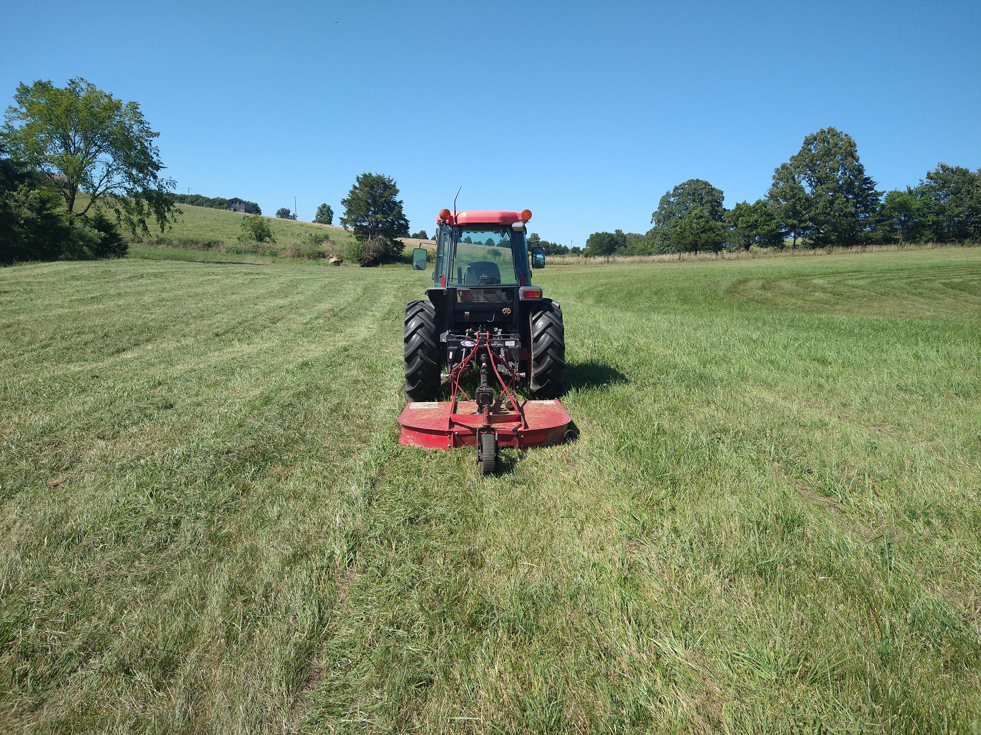

I got the 5’ brush hog hooked up, the PTO drive shaft is also just barely long enough!

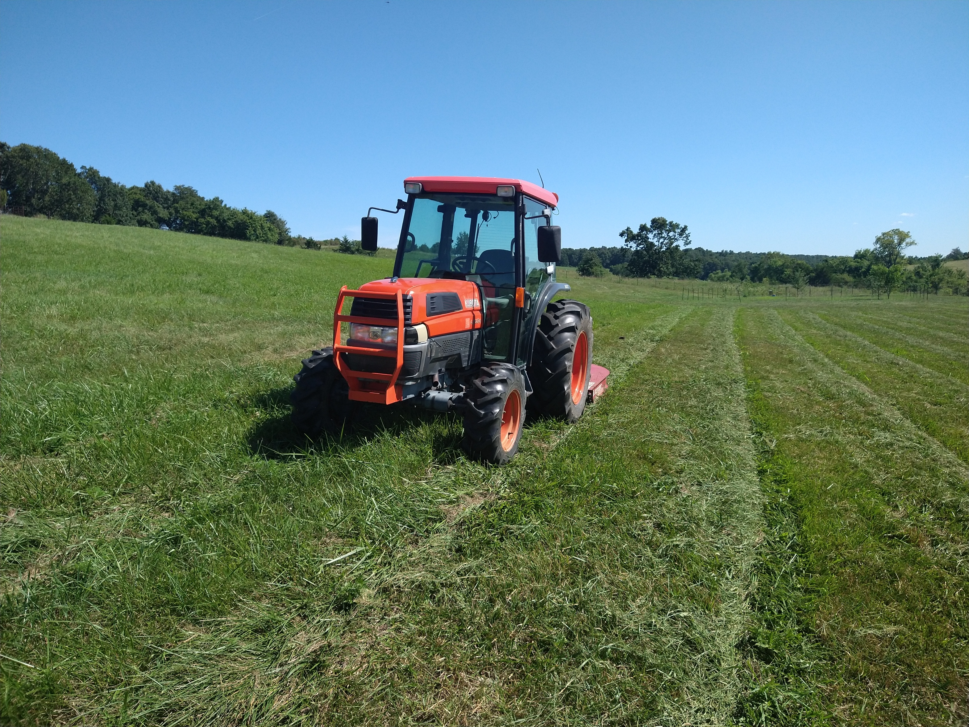

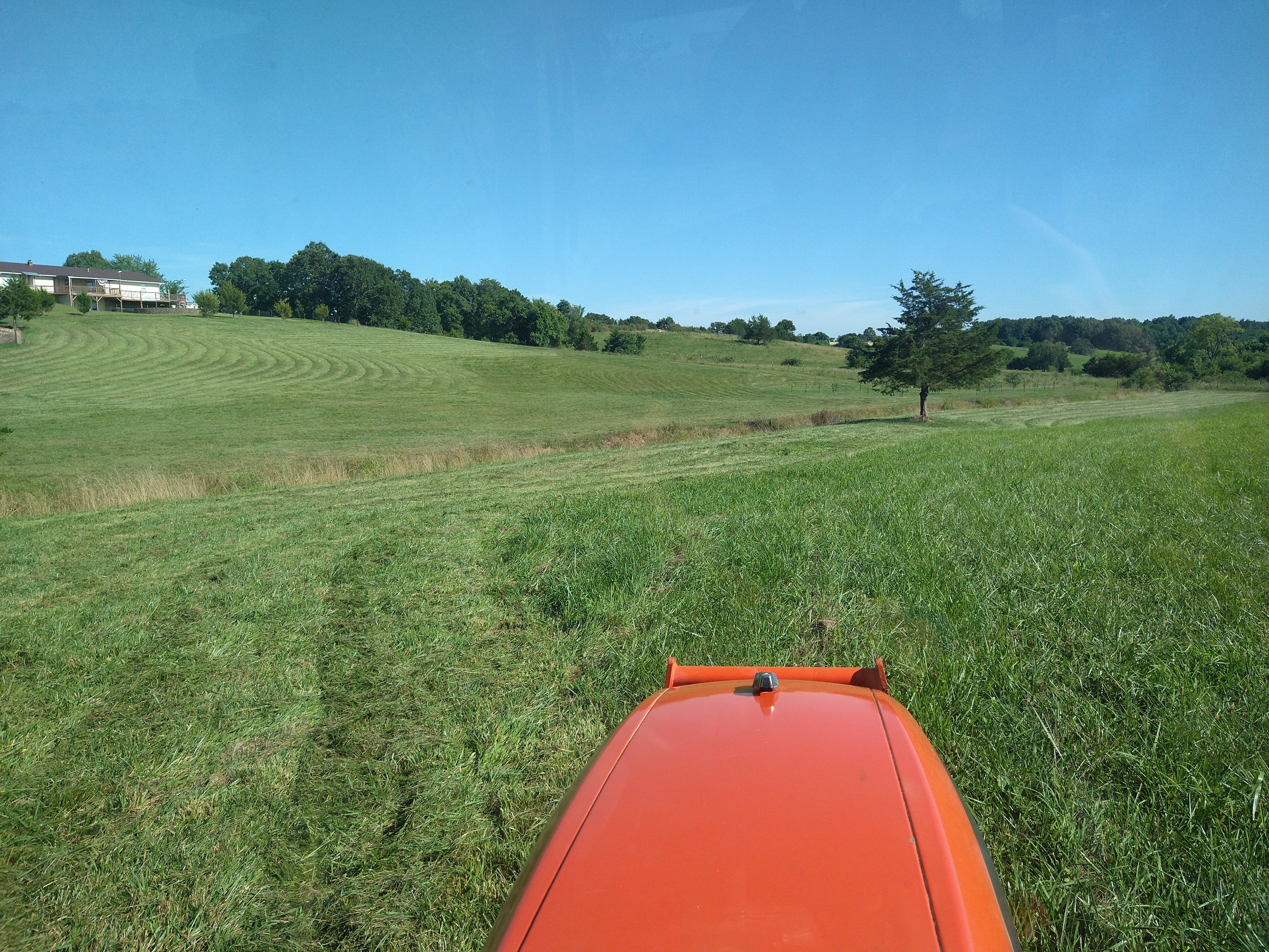

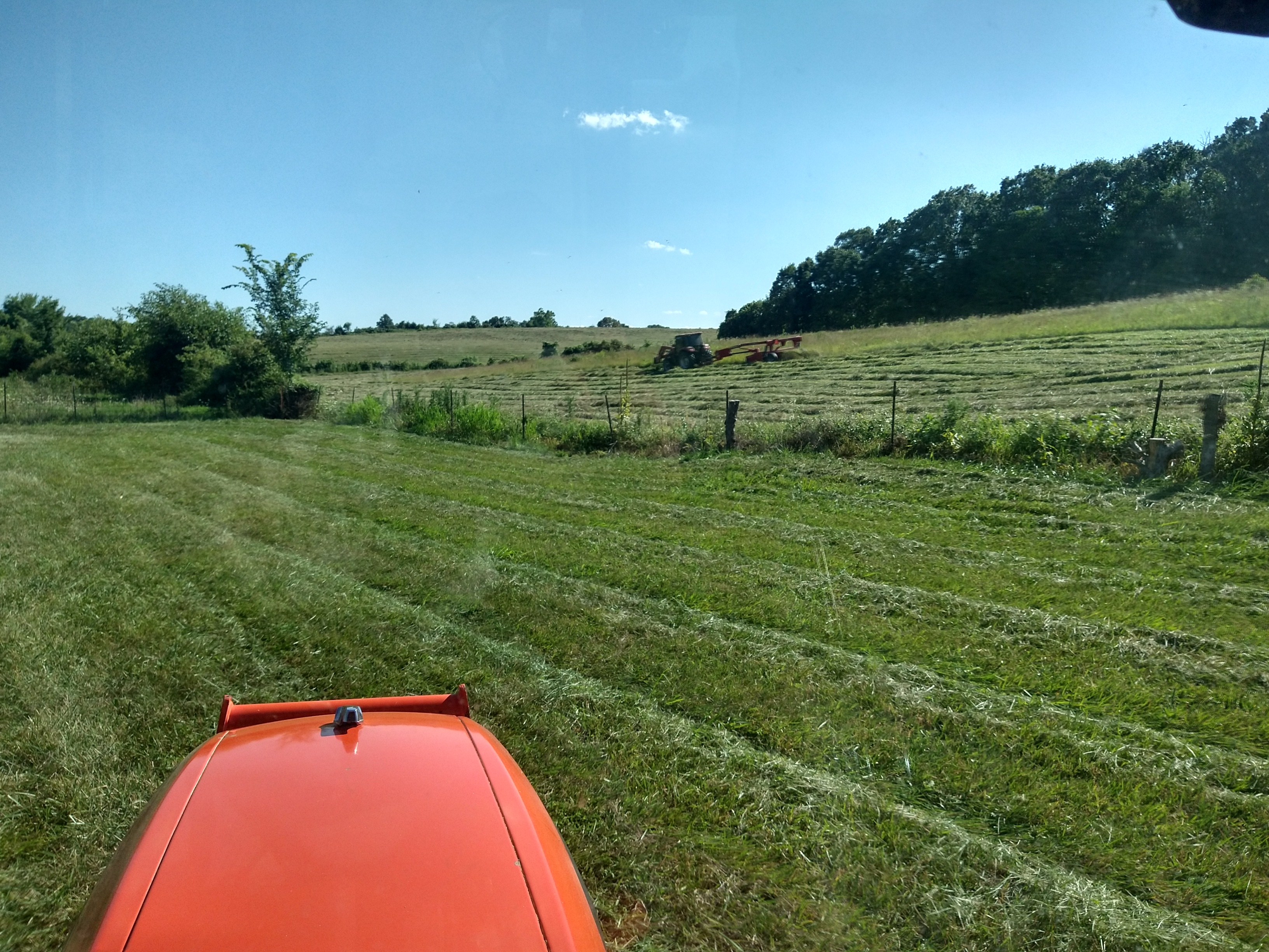

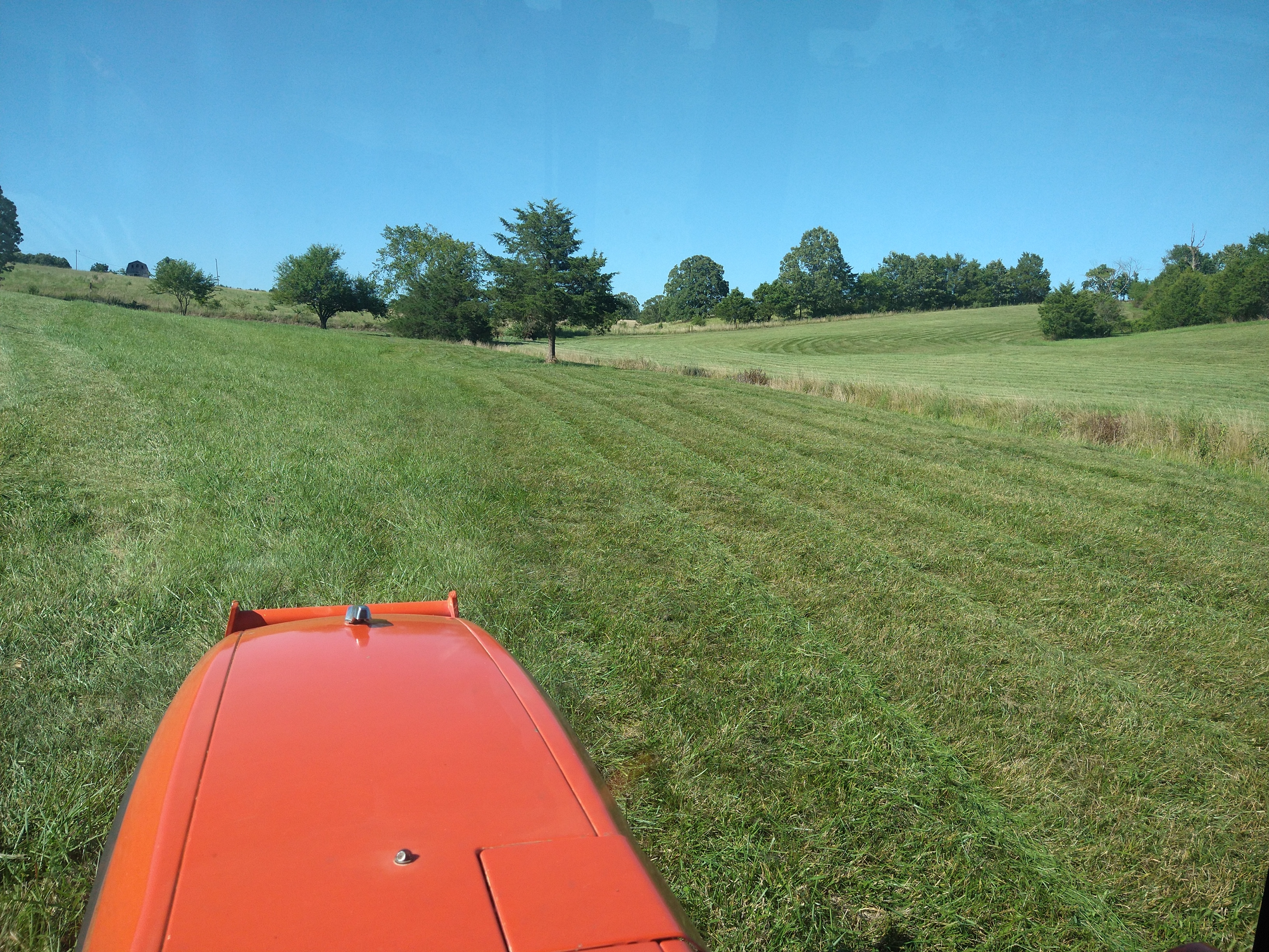

I went out to try it out! I was able to mostly mow at 5.5 - 6 mph, my neighbor was out haying, he saw me and sent me a text . . . It said “ That A/C is cheating!’ look what he is driving!!!
Overall much faster,and much more comfortable than my SCUT! I got 7 acres cut in just over 3 hours … a few working pictures ...
I'm gonna have some tree trimming to do in the future too!

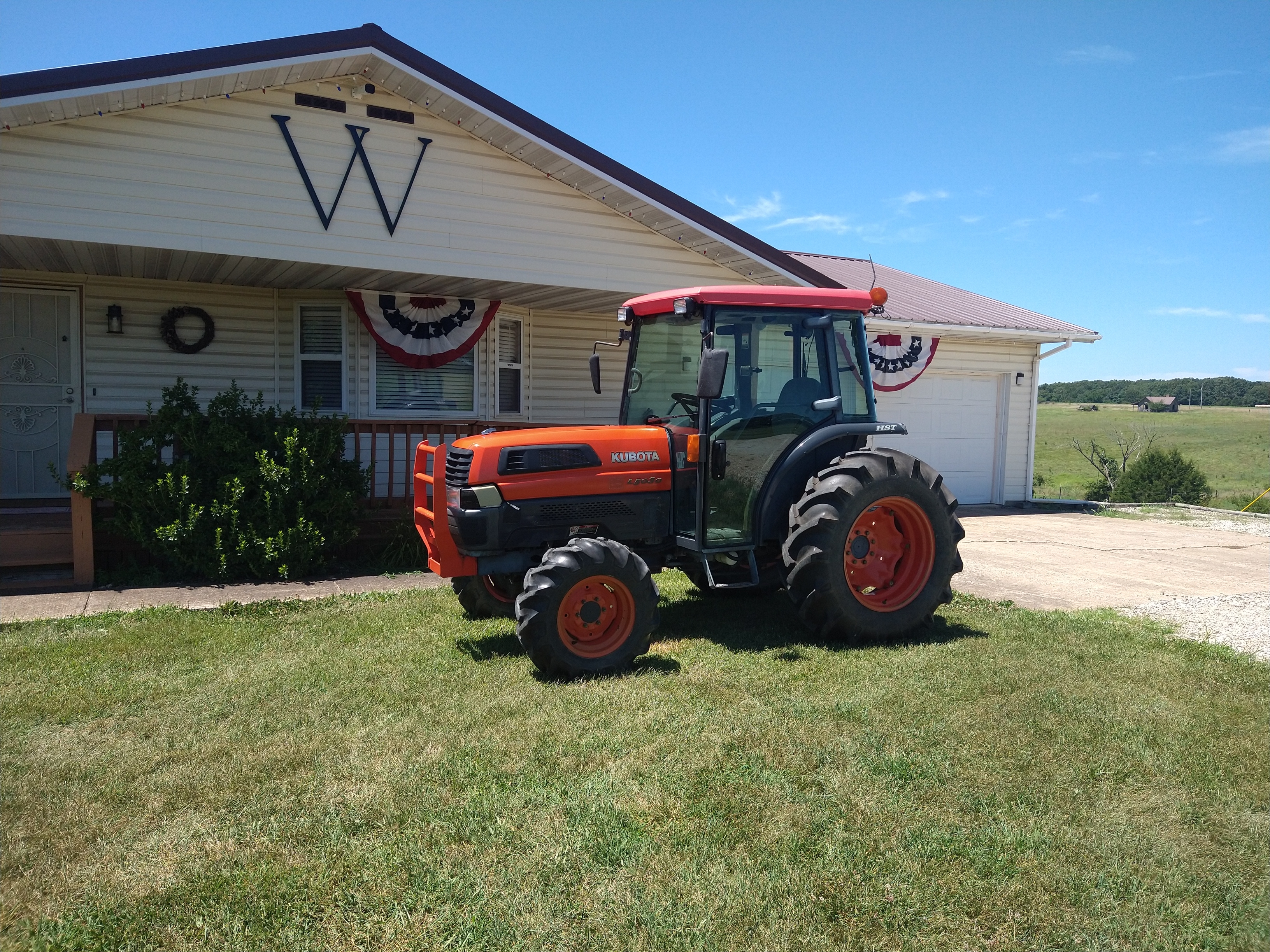

I took it out for a picture by my Missouri flag. I normally fly a USA flag, but our Statehood date is coming up on August 10th, so I'm flying that now … Missouri became the first state West of The Mississippi River on August 10, 1821.
The front field by the road is much smoother than our back, I mow that with my 10 mph Z-turn, I can drive the Kubota 7+ mph out there eas
ily.

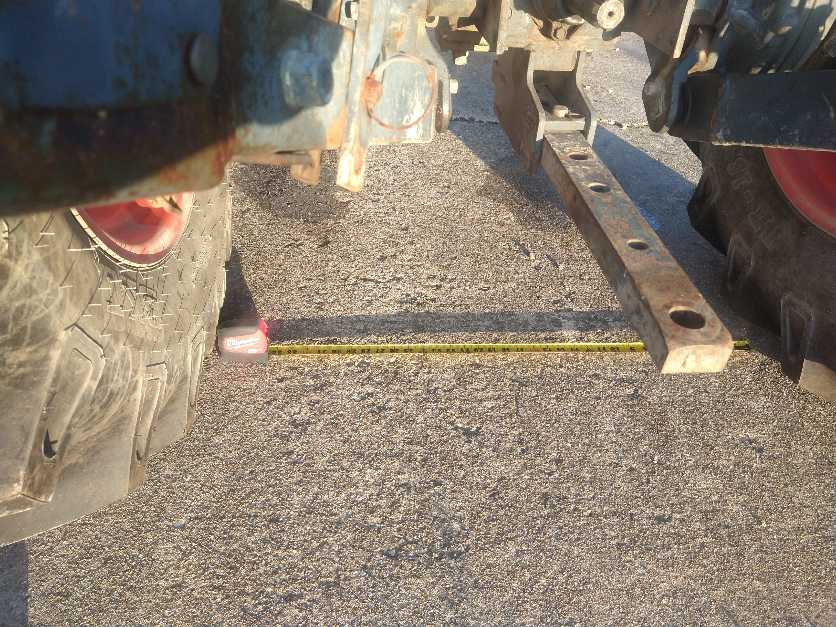

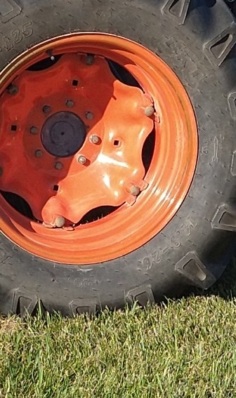

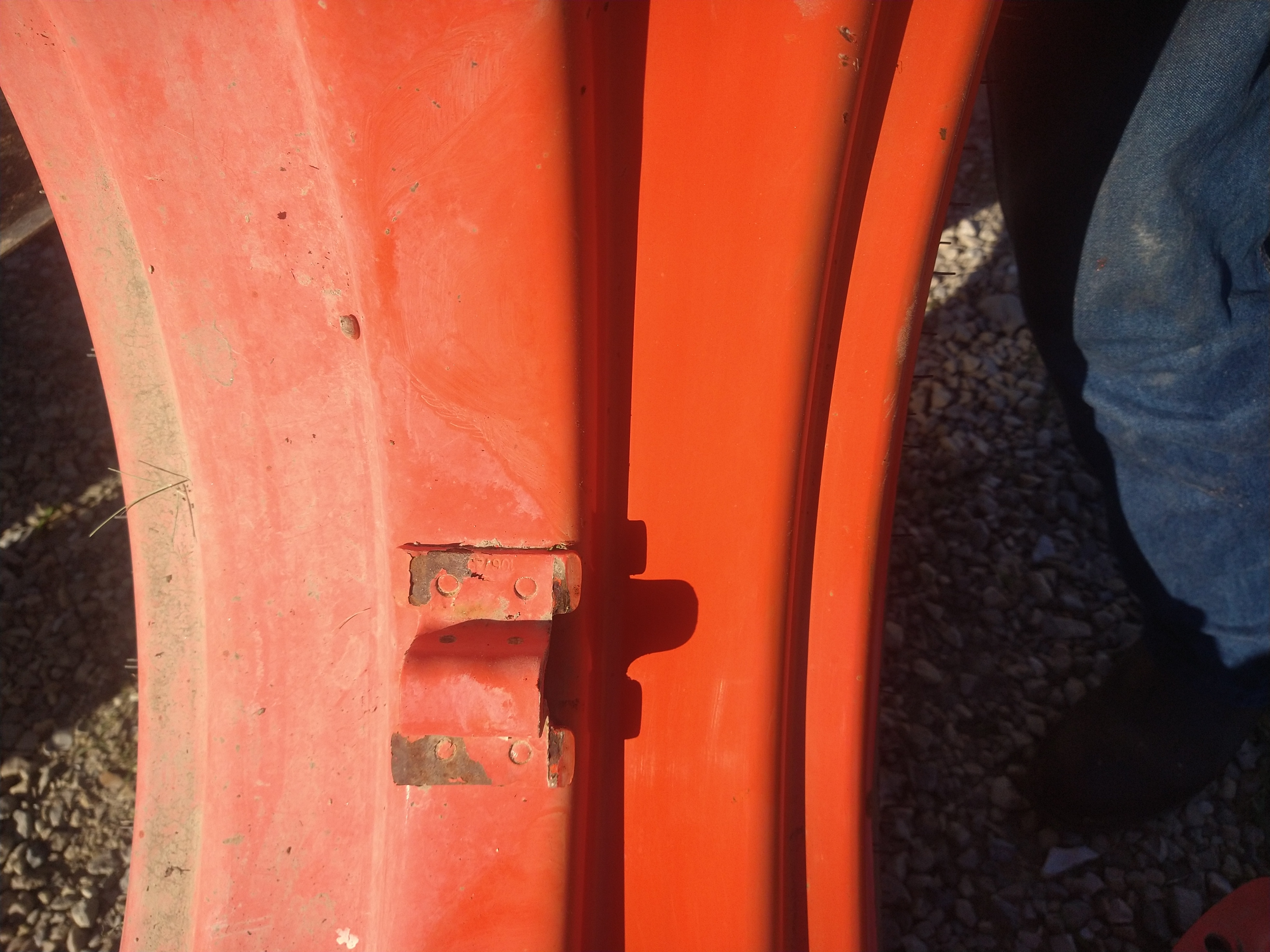

If you look closely at how the wheel is built, it has a "ring" or pipe welded on to the center section in places that bolts go through that then bolt it to the center disk which is bolted to the hub/axle ...
The way it was, center disk on outside, and nuts:
What I did was take the wheel assembly off and moved the center disk to the inside, so now you can see the "rings", and the carriage bolt heads:

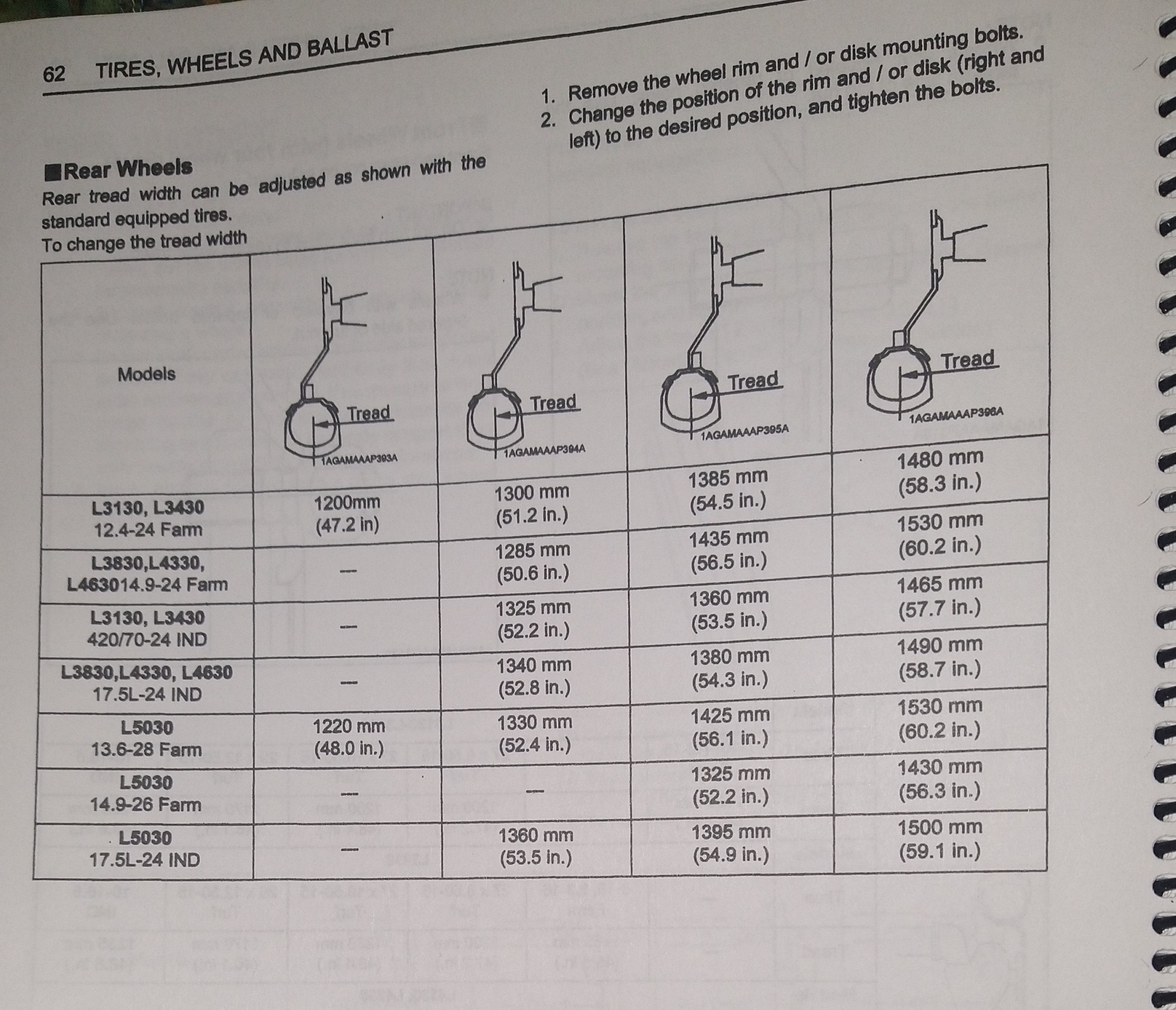

I see the manual says I only gain 4.1" though, my "rough measurements" were 4.75" ... My L5030 has the 14.9- 26 R1 tires, so I only have two options , I didn't realize that other size tire and wheels had other options . . . There is noticeable less side to side jostling with it wider, and it rides better with the lower tire air pressure.
Before:
After :

I did have a little trouble getting a few of the nuts off, my 250 ft lb wouldn't budge a few of them … Monster Maul to the Rescue!
The Monster Maul! That thing is almost as old as you are! And the best splitter I ever used this side of a hydraulic one...
Agree. I am old enough now I have trouble swinging the Monster Maul... 17 lbs? Have not used it for a wrench handle multiplier but I see that works...
