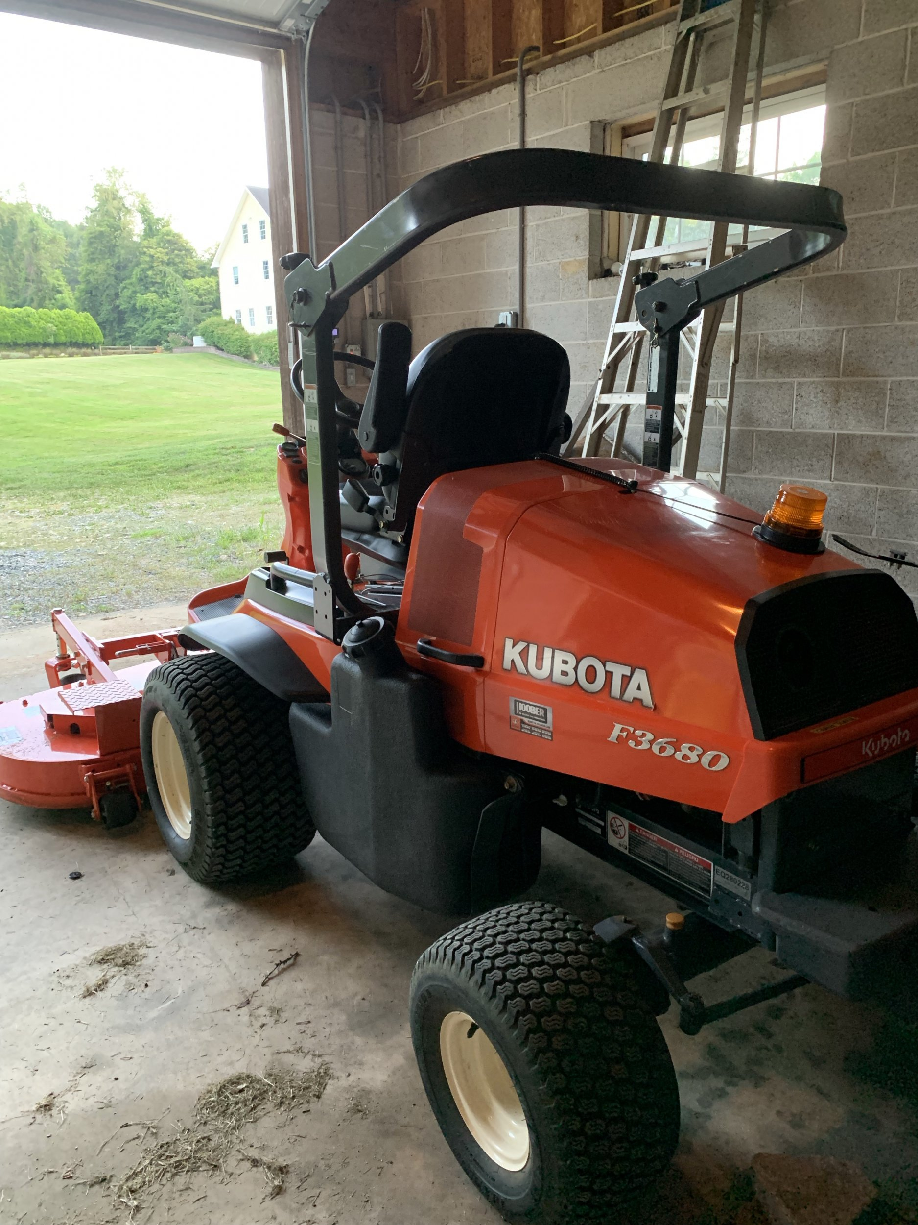

Hey guys, my F has been being used for roadside mowing for our biggest customer. I really want some warning lights as the road side has people blowing by us by double the speed limit by sometimes just a foot.
So it comes down to type of light and mounting location.
We always run with roll bar angled to get under trees.
Suggestions? I tried a magnetic strobe and it was ripped off and broken in 2 days.
I was thinking the sides of the lower permanently vertical part of the roll bar, but they could be ripped off if on the outside and they’re kinda low in that spot.
If I left the roll bar “up” it would be easy to mount lights, but can’t get under trees.

Could you run the magnetic lights to the top of the mower? Can you get some cones or a sign like the road crews use. Park your tow vehicle with the flashers going.

I agonized over the mounting location of a simple SMV triangle for several years on my ZD mower. Ended up bolting it through the thick vinyl on the back of the seat and adding industrial double stick tape.
Back to lights though, if I were mounting a strobe I would look at the stronger rare earth type magnets and fabricate a mount on the hood. I use 200lb magnets to carry my string trimmer and they are more than adequate.

Can you rotate your ROPS to the rear to fold it down? If so, mount warning lights to the top of the ROPS, so that when it's folded to the rear, they are clearly visible and protected from low hanging branches.

I have not taken time to do the web search but there are MANY very bright LED light bars on the market of umpteen different sizes and surely they could be mounted on the already-folded ROPS such that they point to the rear. If nothing else use big hose clamps. Instead of powering it from a solid 12v power source , I suggest tapping in to the existing flasher wiring on your tractor. The circuit will most likely easily stand the low current draw of LEDs and that would produce a flashing bright light impossible to miss.
If you lack flashers on the original machine, go to an auto parts place and buy a flasher kit (I think Tractor Supply sells them too.)

Wonder if 2 rectangular blinking strobes would be good here?
