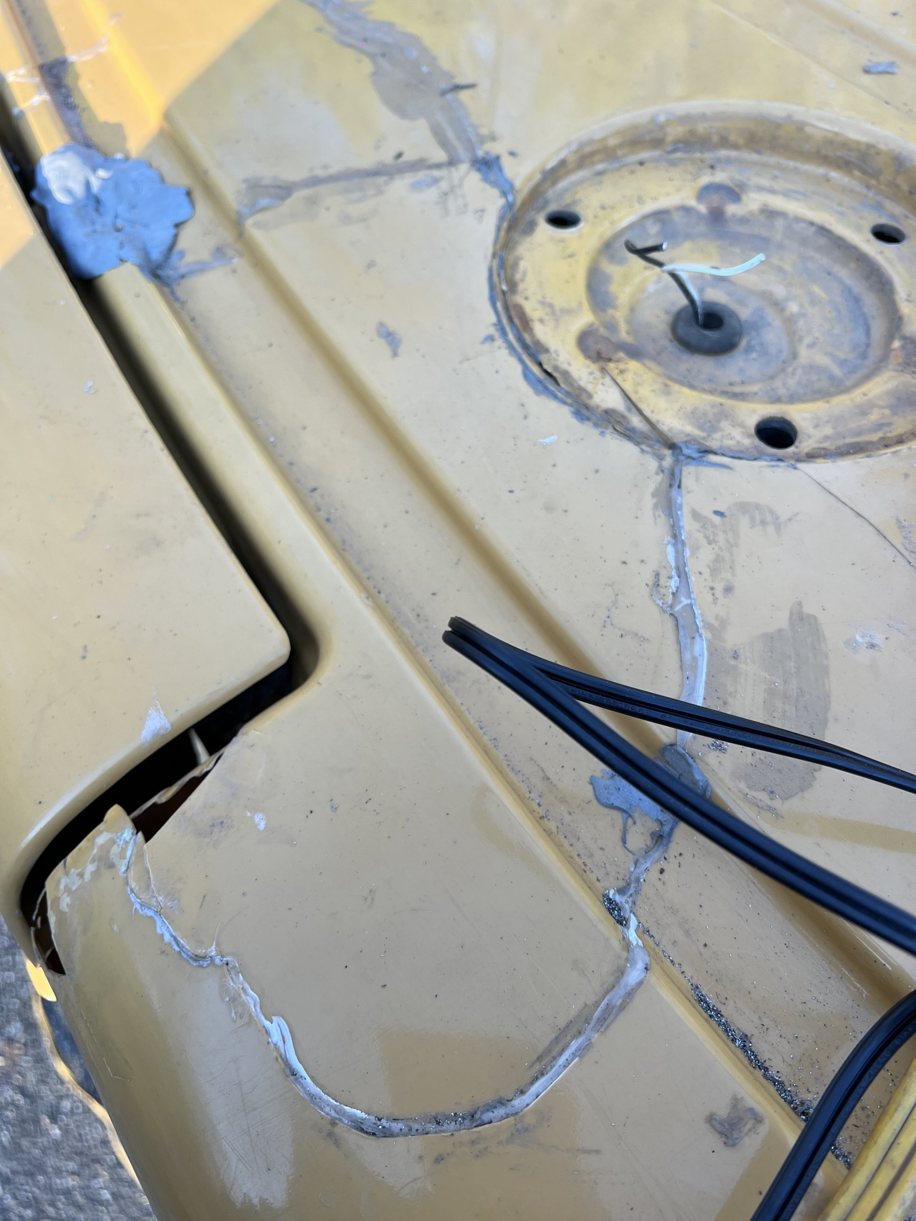

Got it done with 1” to spare. Going to do one on the other side, too.
You can see how the previous owner cracked the roof by hitting the old taller beacon on a 10’ garage opening, or maybe a big branch.

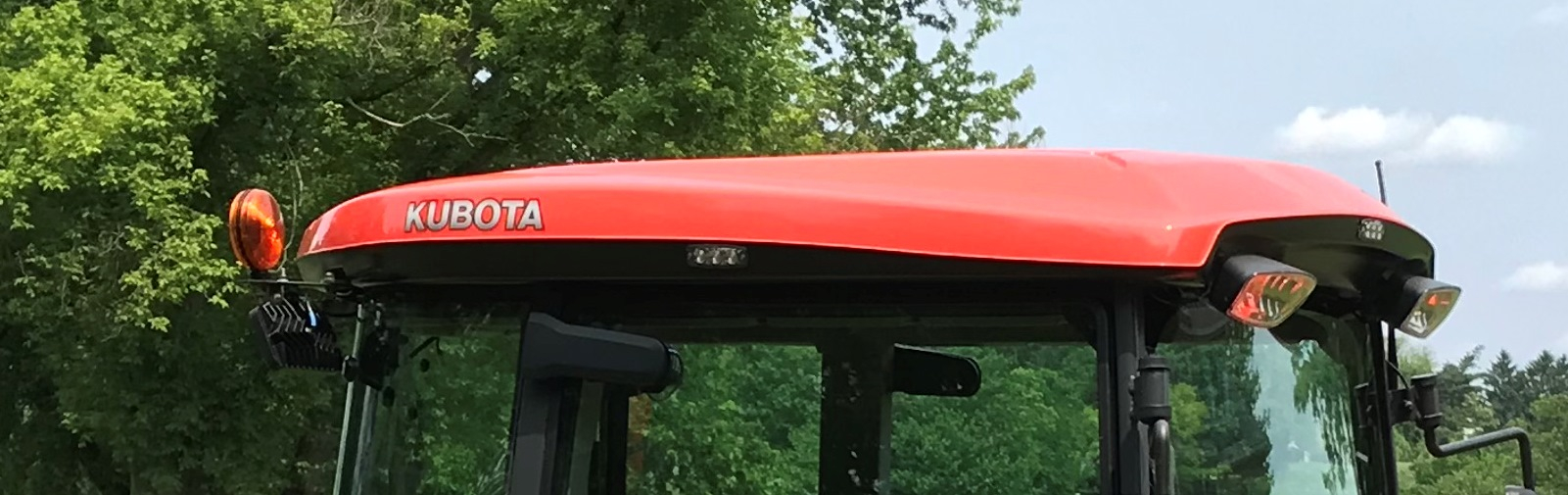

I really like those and would like to have in 4 cab corner lights.

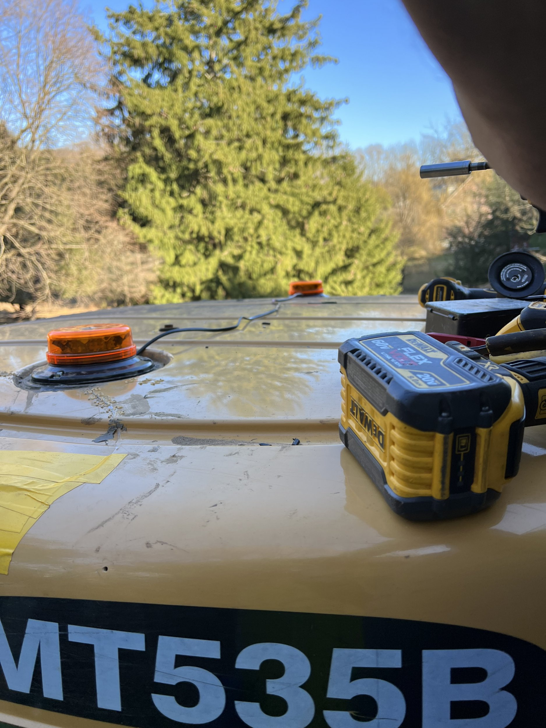

Just a little update. I added a second matching beacon to the other side of the roof, where the other steel magnetic base is.
I wired them together and they work well.
Only thing I don’t like is since they are low profile, they are also not easily visible particularly during the day.
At night or 30’ from the tractor, they look great. Up close, you can’t really see them since they are 9&1/2’ in the air.
It came down to a choice of being able to fit into a 10’ garage opening with low profile strobes.
Now I have to tape that cross-over cord down to the roof with gorilla tape so a branch wont rip it off.

A little more info: The home made light bar was welded to the 2 flat circular metal magnetic bases mounted to the roof plastic.
I found these: 6” diameter only 2” high with magnetic base.
Maybe I cut off the home made light bar from the 2 bases and just mount these to the flat metal magnetic bases?
That sounds like the best so far or add magnets to your existing strobe and mount it on one corner.

The lights came with a gasket, so I pre drilled the steel plates using the light base as a template and screwed them down. I used quad caulk around the tractors steel bases to seal them and hold them down. Hopefully, with just one more trip up there to tape the wire lengthwise across the roof, I’ll be done.
I think the twin steel base mounting system Challenger mounted on their roof was borrowed from Caterpillar backhoes.
