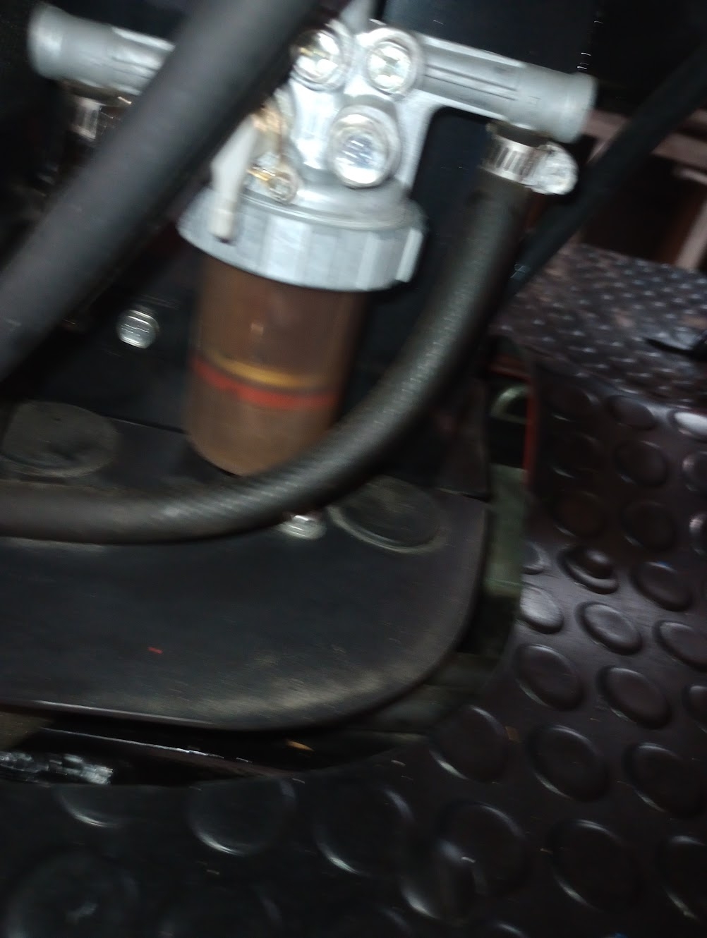

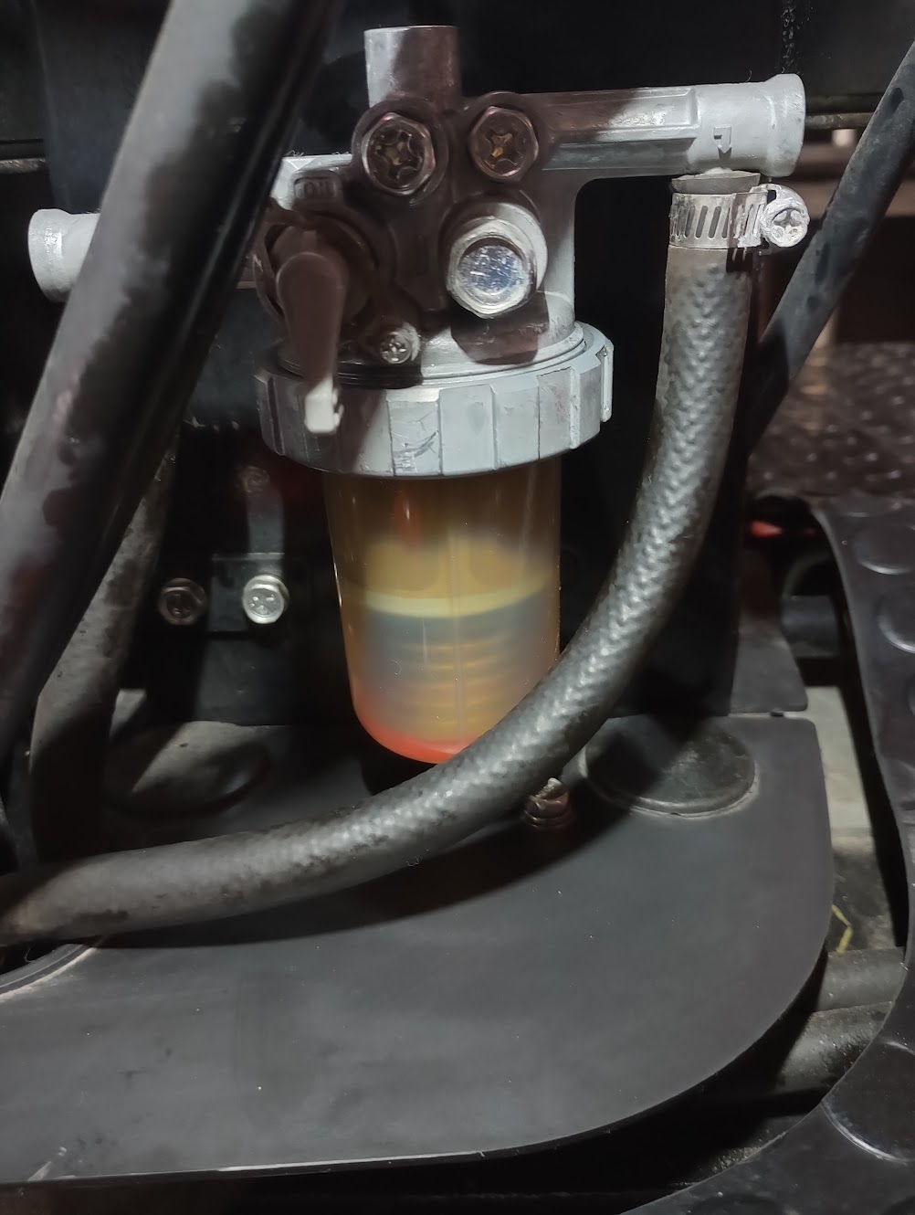

In today's TYM adventures, I found my fuel/water separater near half full of water! When I had the lower dash panel removed the other day to see what kind of battery she had, I noticed the primary filter / water sep, what ever you want to call it, looked a bit murky, but I got side tracked and moved on to other things. It crossed my mind again today and I had a better look at it. Sure enough, the red bobber ring is all the way to the top!
I probably dumped an ounce or two of water out of it and it had sludge in the bottom and a brownish tinge I had to wipe out of the inside of the plastic bowl. I cleaned the filter element and housing real good with brake cleaner and reinstalled everything. I'll keep a closer eye on it now. When I bled it, it refilled with nothing but fuel thankfully. Here's before and after pics.

Hopefully that's still leftover from being outside on the dealer's lot. I would address the strong potential of water still being in the tank. If there's a low point drain, you could drain off any water, or if not convenient you could put a water absorbing snake in the tank for a few weeks.

I'm going to keep a close eye on it. It's like a saddle bag fuel tank setup where there's a 3gal tank under each rear fender, then the two of them are connected at the bottoms with a 1" or so rubber hose.
