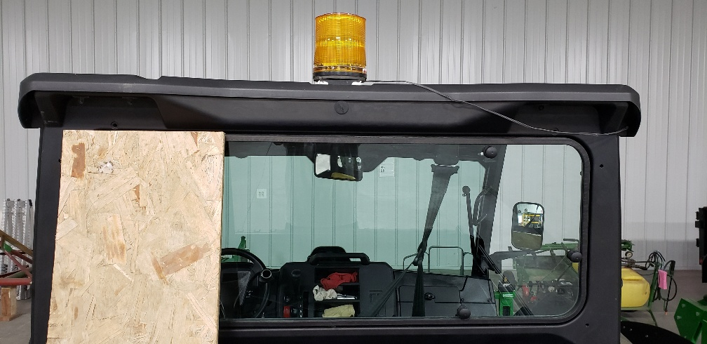

I caulked a 4x4x.5 inch flat steel to the Gator roof with a product called Lexel that I bought at Ace Hardware. It says it will stick to almost anything, waterproof, mildew resistant and paintable. So I gave it a try.
I stuck my magnet base beacon light on the flat steel and plugged the power cord in. What was just a "temporary" setup has been there for two years now.
