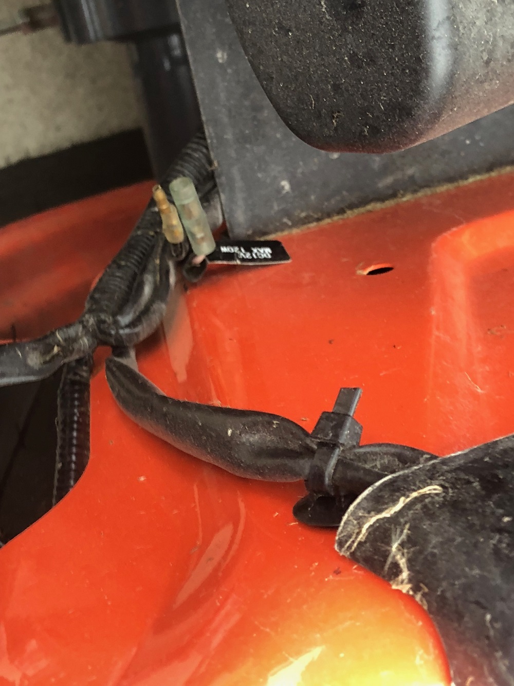

I found a plug to add more lights on the tractor it even has a tag on it saying the max watts. It's back behind the seat now i just need to figure out what type of plug that is.
/ B2650 ROPS light mounting bracket? #29
I'd put a meter on them and see what turns the circuit on and off or whether it is always on, etc. Those are very common type connectors in tractor wiring even back decades ago. I do not know what they are called. Might or might not find them in an auto parts store. My guess is that those connectors were for a rear work light and that the circuit comes on when your tractor headlight switch goes on. That was the case with similar wires/connectors I found back there on my B2150 and I used them for an extra light. Pretty handy to have them already turned on and off with an existing light switch (if that is the case.)
/ B2650 ROPS light mounting bracket? #30
No guarantee but that looks like the connectors on my hazard lights for the grass catcher. I'd do what jwr says. Put a voltmeter on it and turn on the hazard light button on the dash and see what happens.

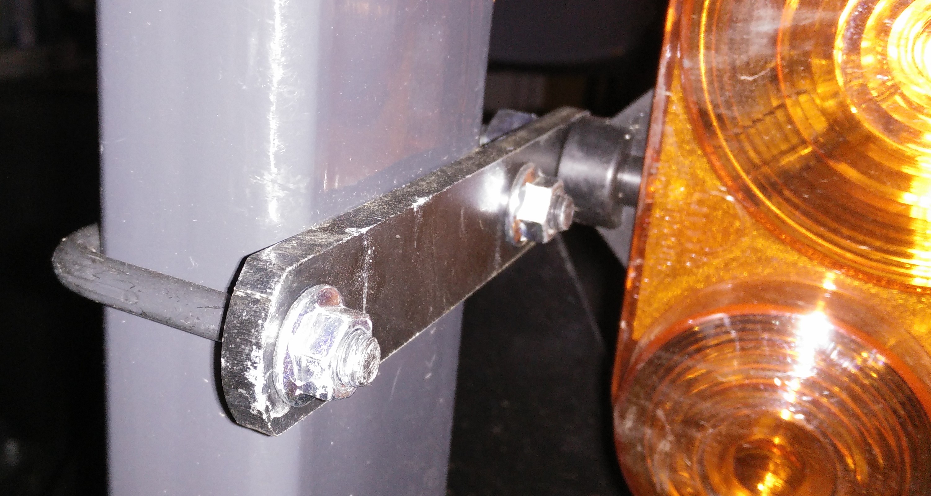

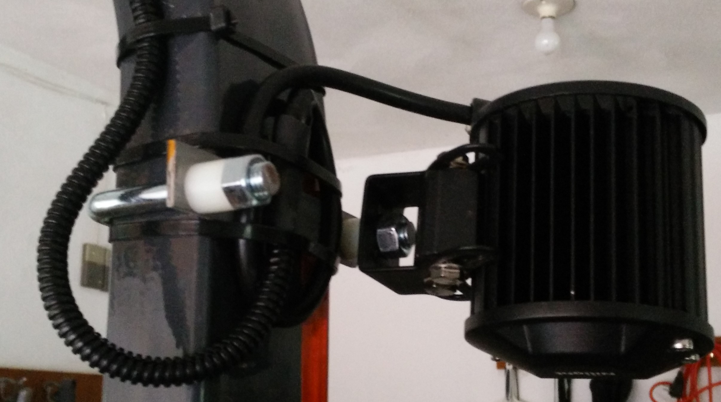

Here are some pictures of my setup. Hope this helps. First, I got a waterproof switch, and used silicone sealant to affix it to the dash so water can't get in behind it. Its wired direct to the battery so I can turn the lights on when the tractor isn't running, which is convenient.
I have two 4 inch floods facing rear. These square u-bolts were fairly long. I put nylon spacers to keep tension and give me a little space to work with then cut the extra bolt threads off with a hacksaw. The lights come with the little bracket, just put it on over the end of the bolt and tighten it up. Holds great.
Did you use 3 inch square bolts?
/ B2650 ROPS light mounting bracket? #35
I don't remember exact size, I measured the rops and measured the internal space of the bolt at the store to make sure it would fit. You should be careful buying them sight unseen, as the stores are not consistent in the way they list their sizes. Some reverse width x length, etc.

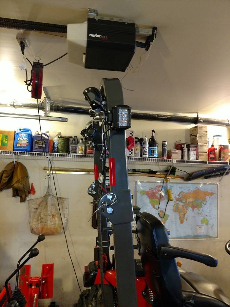

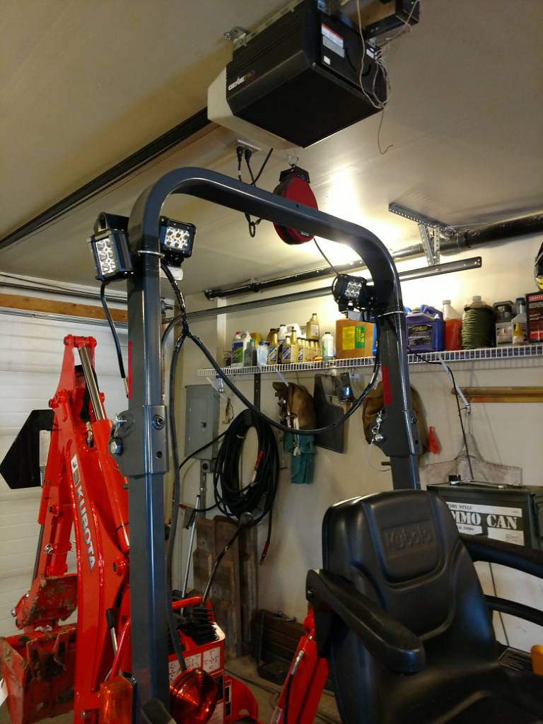

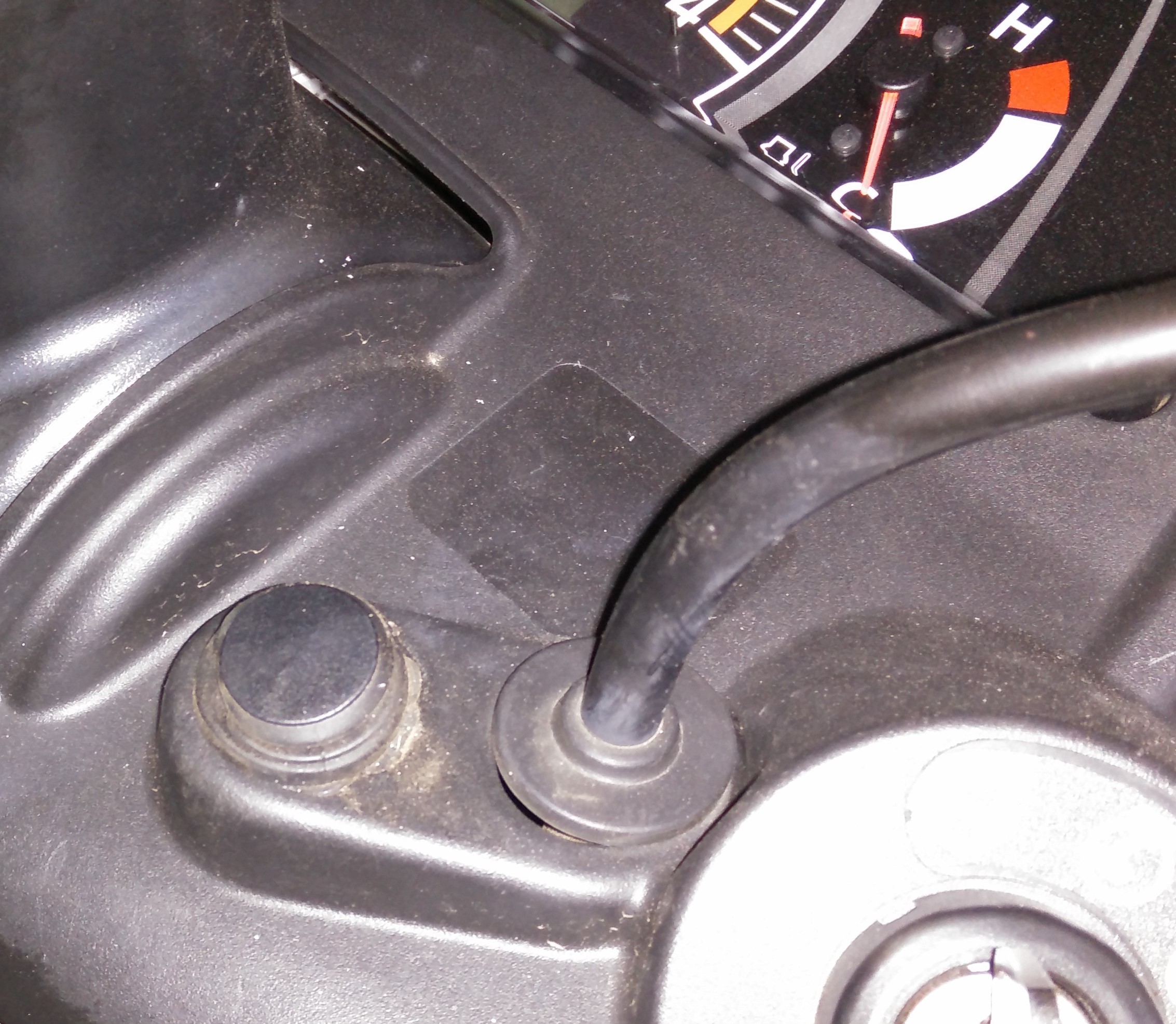

I finally got the lights mounted now i just need to wire them up. On my dash just below the idle lever there are two blank spots how hard would it be to mount a switch in one of them? I really don't want to cut holes so maybe the two blank spots just pop out.
/ B2650 ROPS light mounting bracket? #37

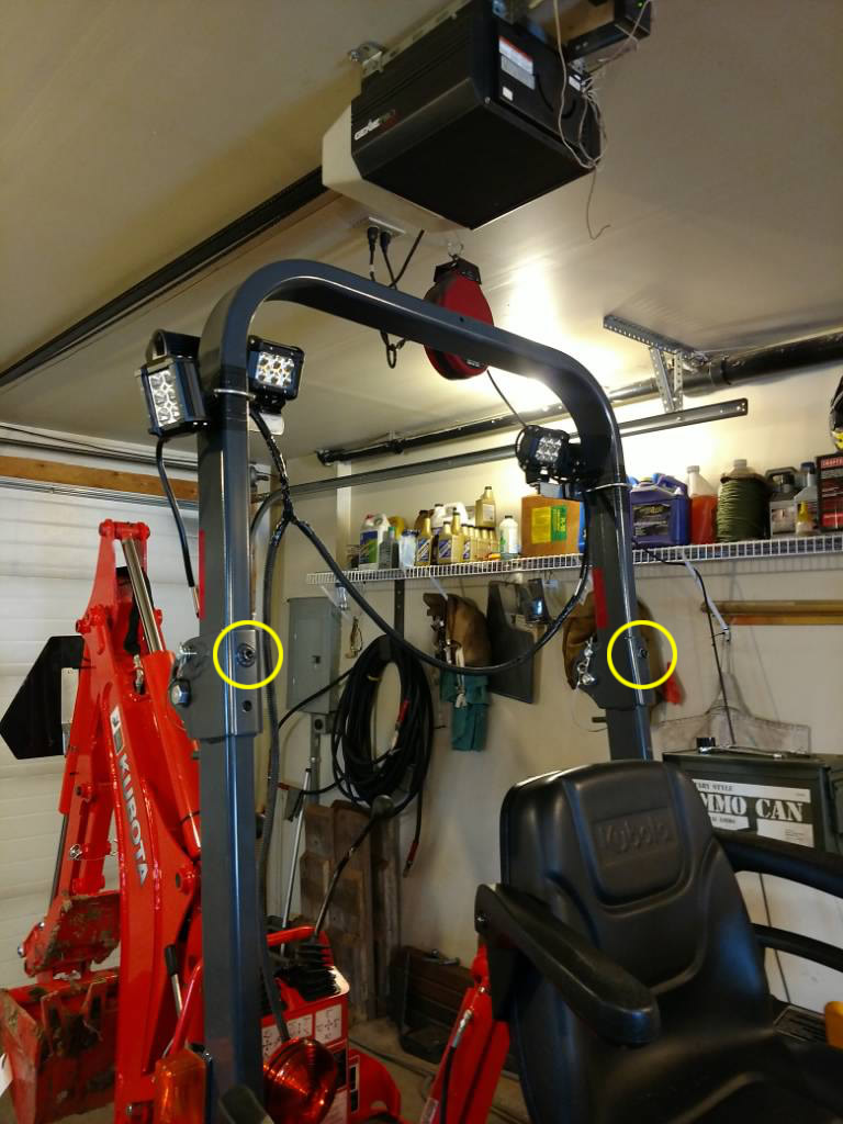

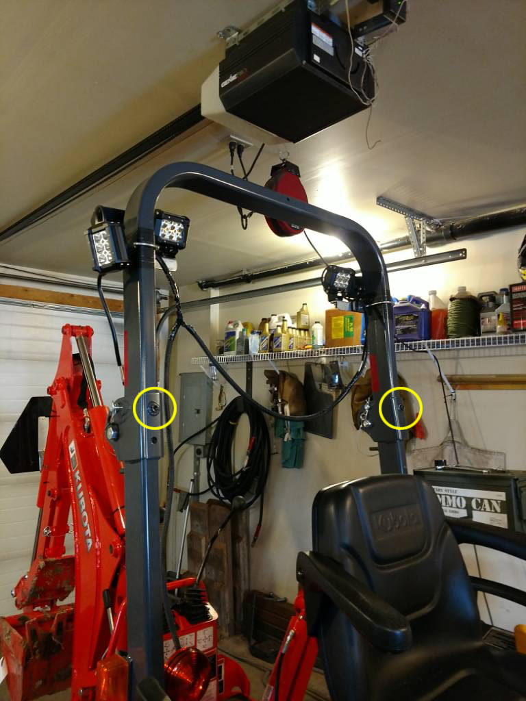

The easiest will be to tie into the work light circuit, which runs a wire to one of the rear fenders already (normally the left). Tie into that and then add a switch (or switches) at the rear of the tractor.
As far as mounting, I am amazed more people don't use the threaded mounts already on the ROPS, circled in yellow below:
It's a good fixed rigid mount that doesn't get affected when you fold the ROPS and you don't have to dick around with clamps, etc or clutter up the ROPS. I forget the thread size, but it's a standard metric thread (M10 maybe?).

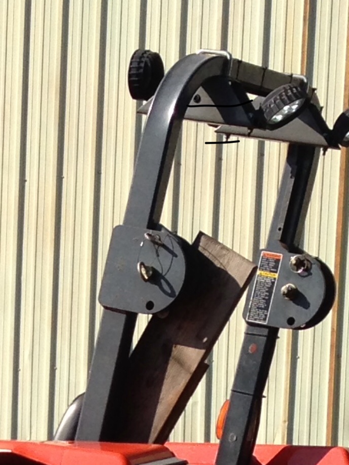

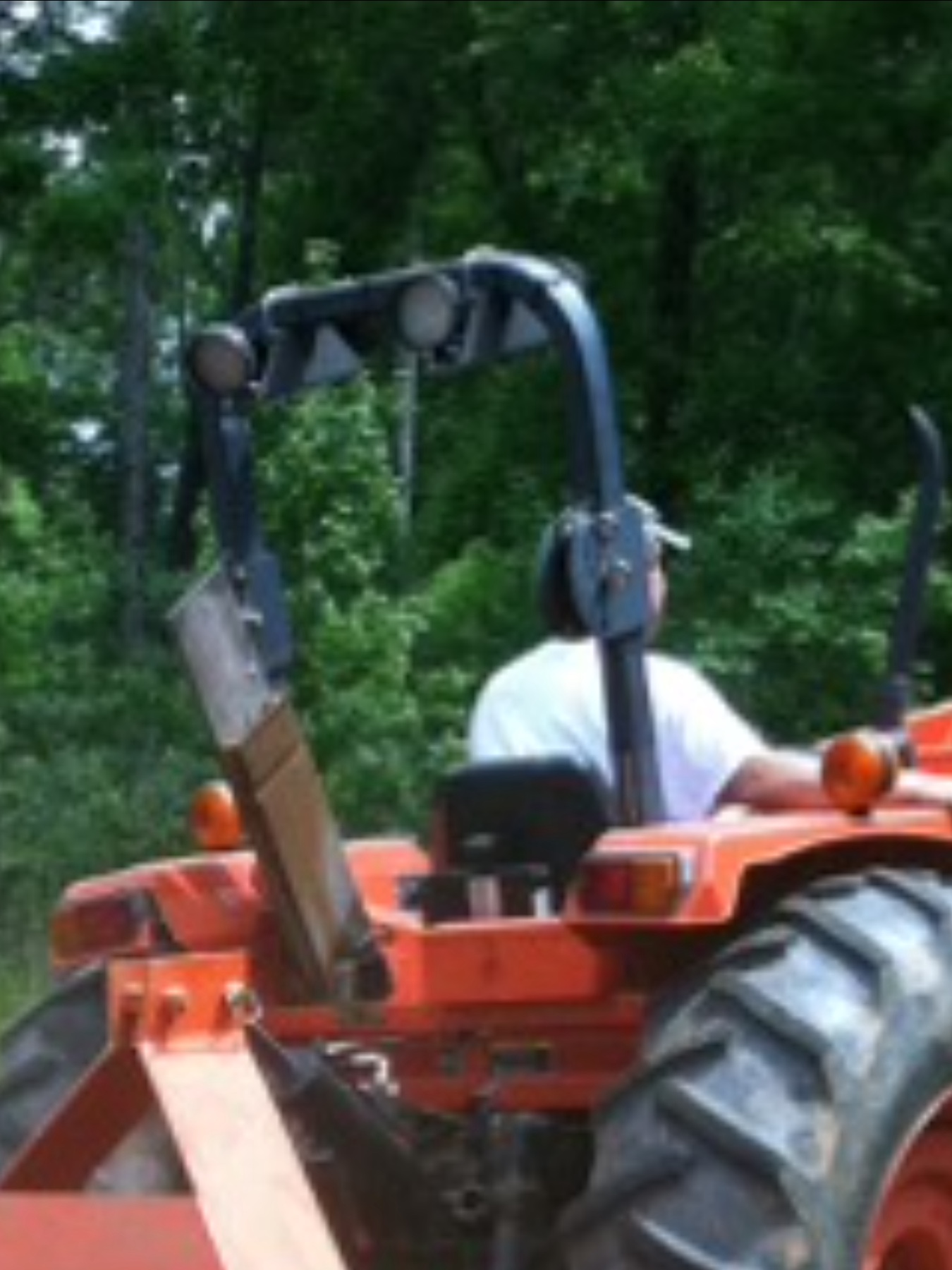

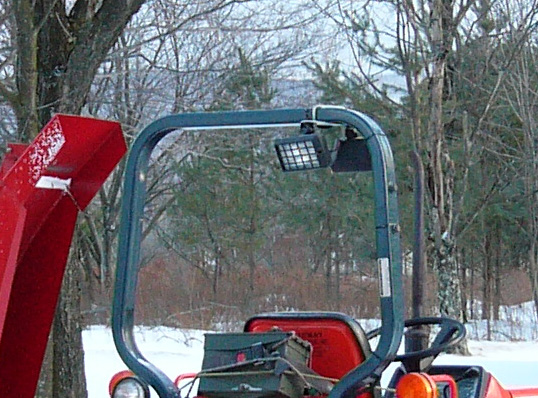

s219 -- don't know about you but I don't want the lights shining into the back of my head. Or right in my face if I turn around. Need them much higher.
Rob80 -- take a look at the pictures I posted earlier in this thread. You can see where I installed a switch. On my tractor there was a rubber grommet there. No cutting, just pulled out the grommet and dropped the switch in.
/ B2650 ROPS light mounting bracket? #39
Hasn't been an issue on my Kubotas -- I mount the lights there on all of them. But I can see how it might be a problem on a smaller tractor like a BX though, as the ROPS is a lot shorter and narrower on those.
That's a great feature and good to find out that the threaded mounting hole exists. It does not exist on many models, especially older ones, however.
