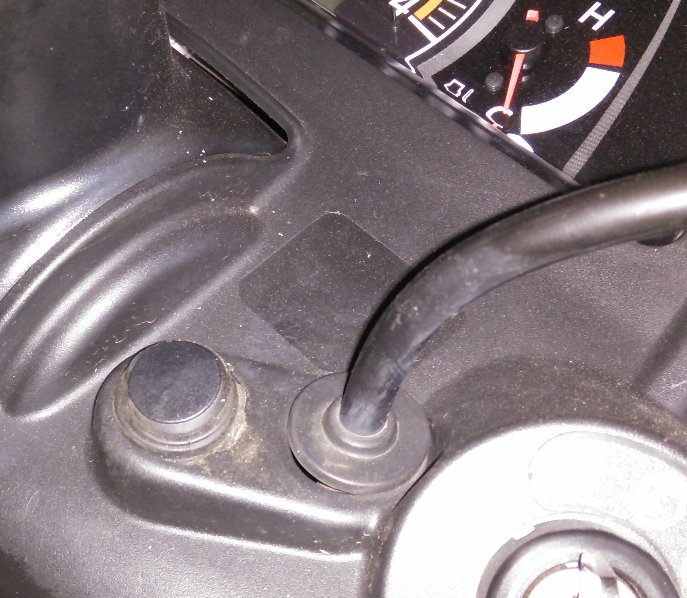

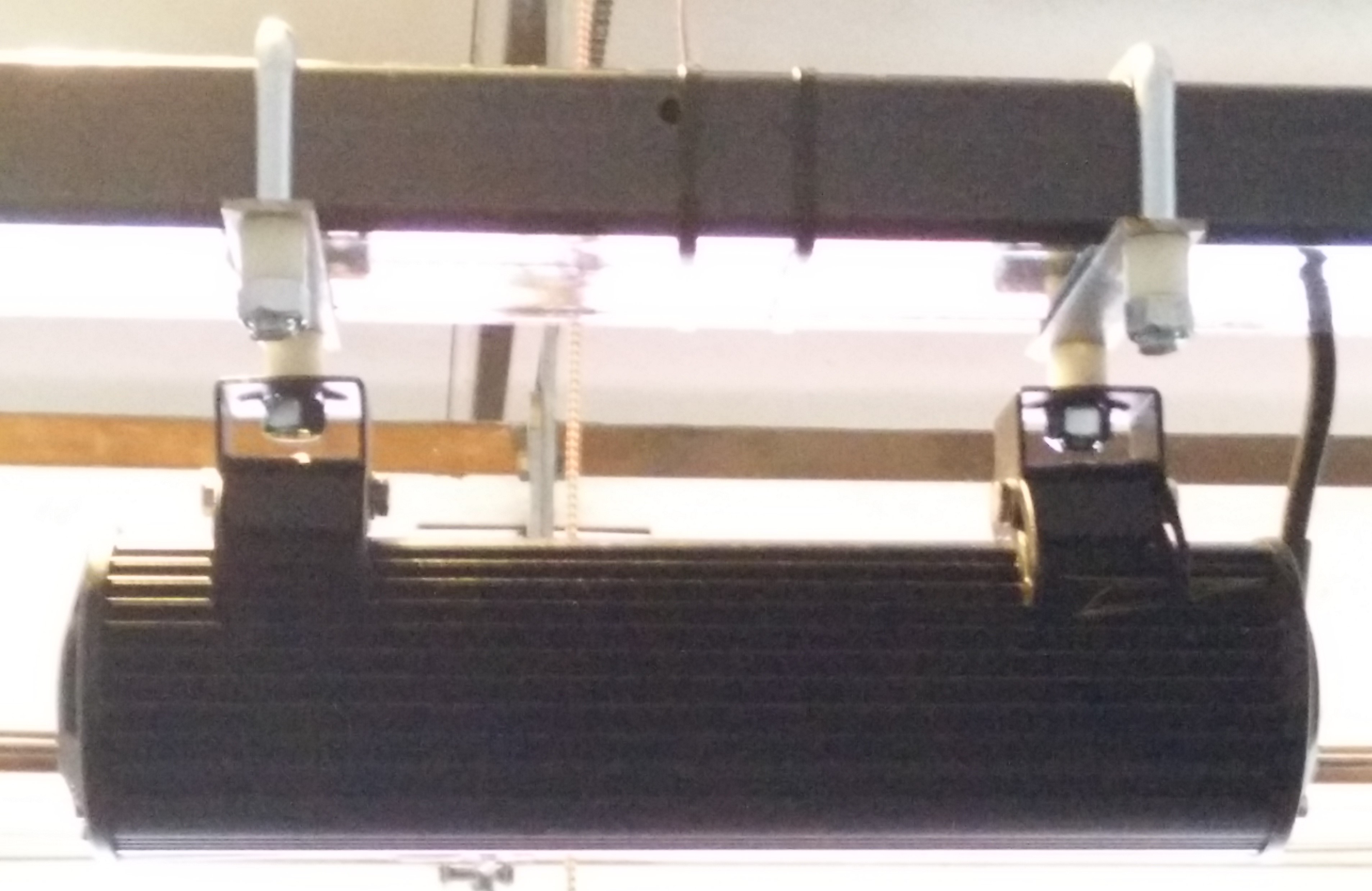

Here are some pictures of my setup. Hope this helps. First, I got a waterproof switch, and used silicone sealant to affix it to the dash so water can't get in behind it. Its wired direct to the battery so I can turn the lights on when the tractor isn't running, which is convenient.
I have two 4 inch floods facing rear. These square u-bolts were fairly long. I put nylon spacers to keep tension and give me a little space to work with then cut the extra bolt threads off with a hacksaw. The lights come with the little bracket, just put it on over the end of the bolt and tighten it up. Holds great.

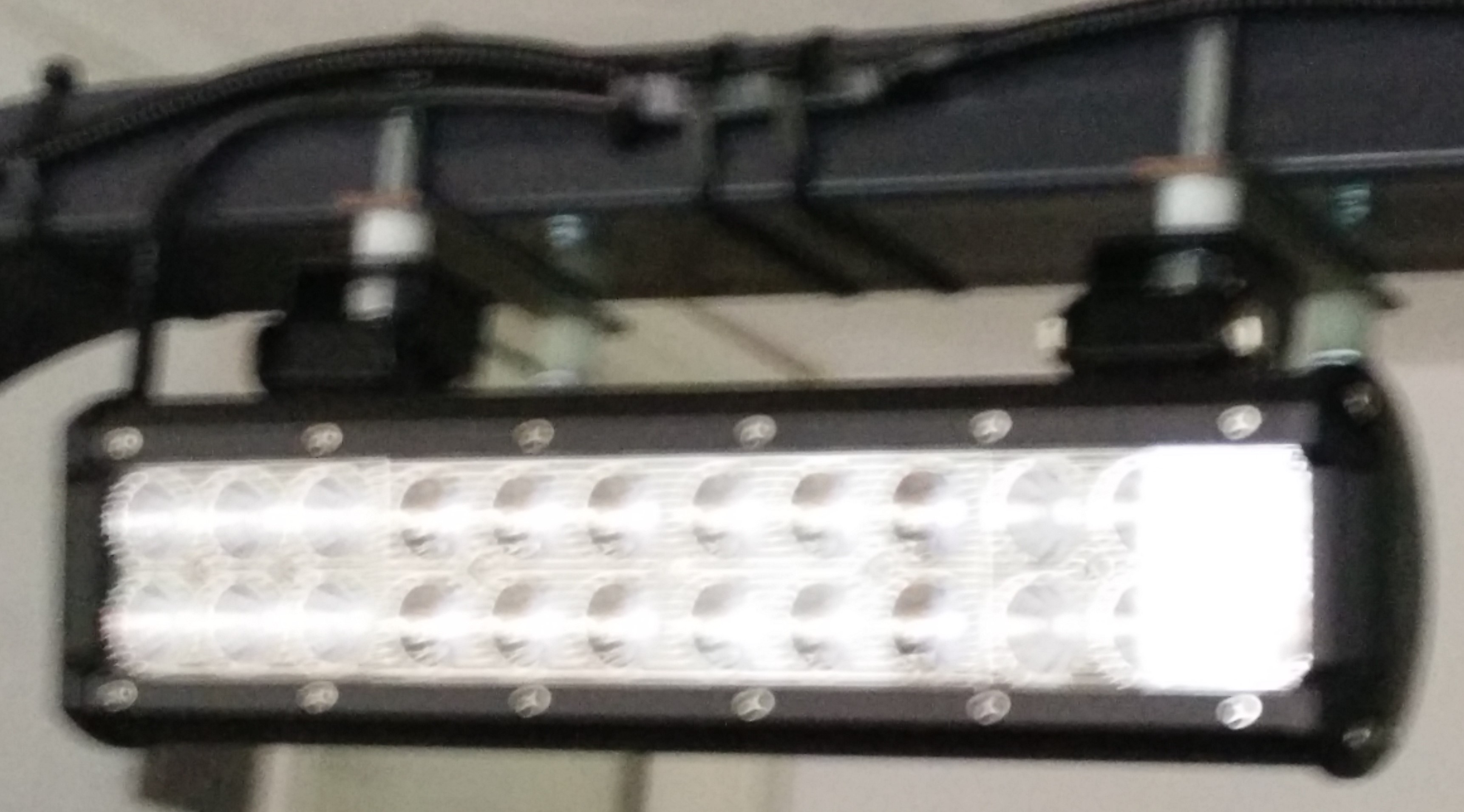

Front facing I have a 12 inch combination spot/flood light bar. Same setup as with the floods, one bracket each side.

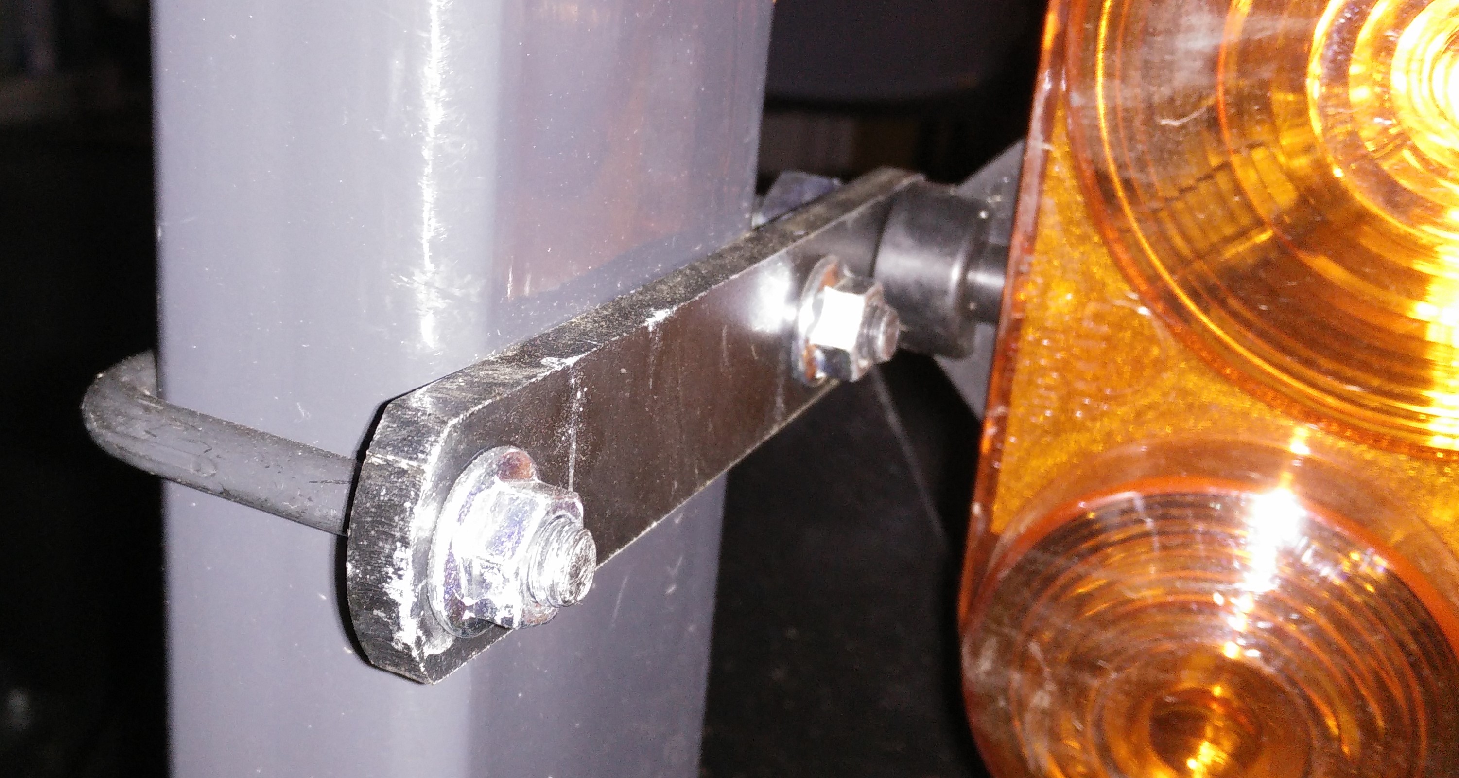

Here is the part information for the kubota oem mount that they use for the hazard lamp. This is thing is beefy, perhaps overkill but whatever. They have separate part numbers for the pieces that make up the assembly. Here goes:
The backing plate: K2581-96270
The u-bolt: K3181-62243
The nut that holds the u-bolt on: 02751-50080
Here is a pic of the hazard lamp mount.

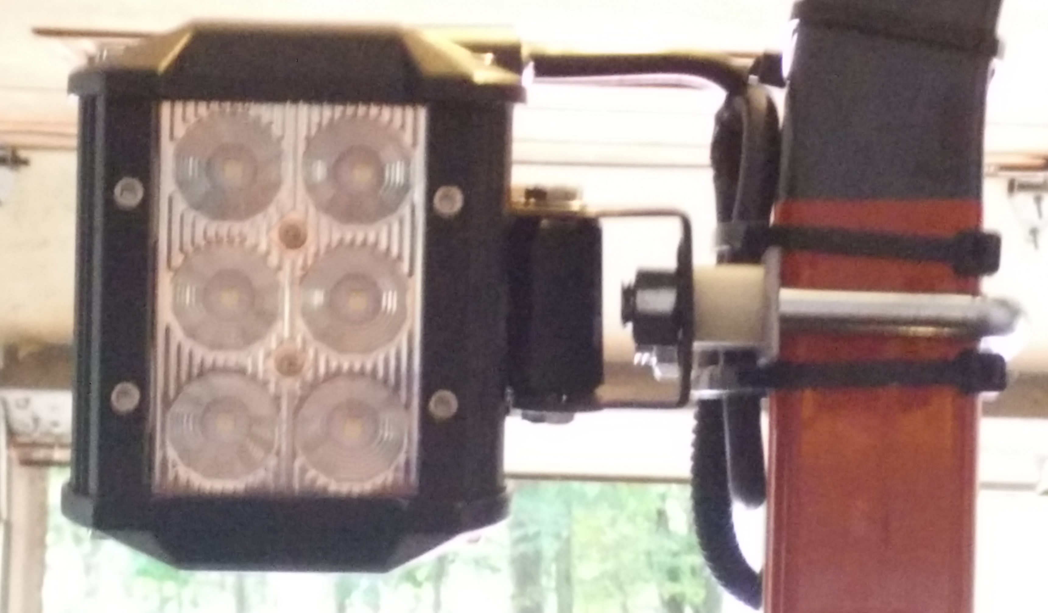

I went to Tractor Supply and got the square U-Bolts that fit the ROPS bar, I cut out and drilled my own back strap similar to what you see in the post above showing the Kubota ones, then I made a bracket to attach to that U-Bolt that would fit my 3 NiLight LED cubes per side. This way, I hit my switch and get a 360ー halo of light. I have spots in front, spots facing rear and floods on the sides.
The only 2 negatives I have found is that:
1) I can easily rip the lights from the brackets, I can shear the brackets and/or I can tear the aluminum light housing from the nut that the bracket bolt goes in to. All it takes is a solid tree and you can quickly clean the lights off..... I've had to hoopty-rig them back together many times now.
2) You must use medium Loc-Tite thread locker on all of the light fasteners. They will rattle loose and the lights become hanging clankers! After seeing this happen a few times I took an hour and in-bolted every fastener and thread locked them, now at least the lights stay on there until a tree cleans them off!
I have been running NiLight LED cubes on my Jeep and SxS for 5 years now. It is the only brand I buy because they offer exceptional value with a very fair price and unbeatable reliability/durability.

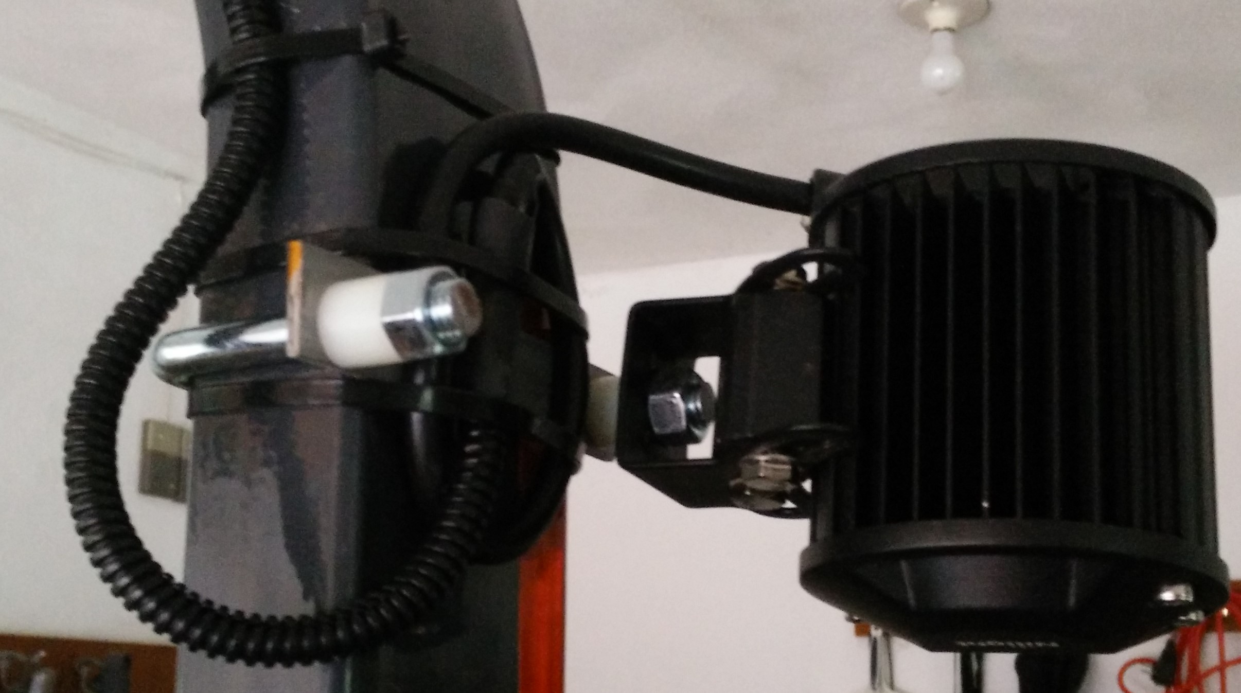

You have hit upon a universal problem that many/most of us came across. RockCrawler, Atticus and SDT all gave you good descriptions/pictures. I will add to the chorus as follows:
I used a square U-bolt (as I think most do) selected to fit the larger dimension of the ROPS frame. No reason to go flimsy, use a heavy one. I replaced the flat cross part of the U-bolt with an aluminum bar maybe 1" wide and 1/4" thick. That is of course very easy to cut with common tools/hack saw, to drill, etc. I made the cross piece about 2 to 3 inches longer than the original cross member and drilled it to fit the U-bolt which makes a very solid mount. Then drill the outer end of the crossbar for the lights. I mounted two lights, one aimed forward and one aimed to the back. This makes a pretty universal approach, can be mounted on the side of the ROPS, the top underside, the top on the top side of the ROPS, etc. Use lock nuts/washers of course. I found the light swivels (made as part of the lights) are harder to keep pointed in the same direction without vibration, branches, etc. changing them.
That was easy. The greater challenge to make a halfway neat job of it is the electrical part. The wires can be weather resistant twin cable of some sort that looks nice with the usual zip ties to secure to the ROPS on the way down. I too went to a direct accessory connector to the battery with a pair of toggle switches just behind the driver's seat and an in-line fuse.
On a different B2150 than the one shown below, I rummaged around until I found a spare circuit with a dangling unused wire near the rear of the tractor. Tested it with a meter to see which switch turned it on, etc.[most likely it was originally for a rear work light...] and used that for the electrical source. Who knows what the circuit was intended for (comes on when the headlights are on) and it blew no fuses so I am happy. That avoided adding any switches or fuses. These were done years ago prior to the better LED lights we see these days.
