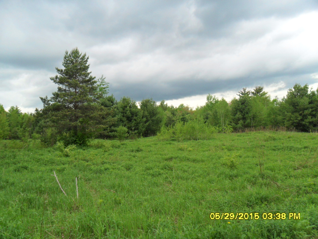

That's what I thought but was not sure next week I am going to plow the field and cut down a few pines then this farmer who rents my other field is going to disc it for me. I don't think I'll have enough time to do anything else to it before work starts back up for me. I have a lot of deer on my land so I want to put in a food plot if I do have time I livge to cover the field with a good fertilizer so next year I'll be good to go with what I plant,the field must be about 1 acre or so. Here a pic. of the field last time it was plowed was 20 yrs. ago I took my tractor on it for a drive and I was bouncing up and down very bumpy.

And what are you planning to plant for a food plot?
/ killing weeds need help.
#19
clover
alfalfa
soybeans
don't know what else yet.
