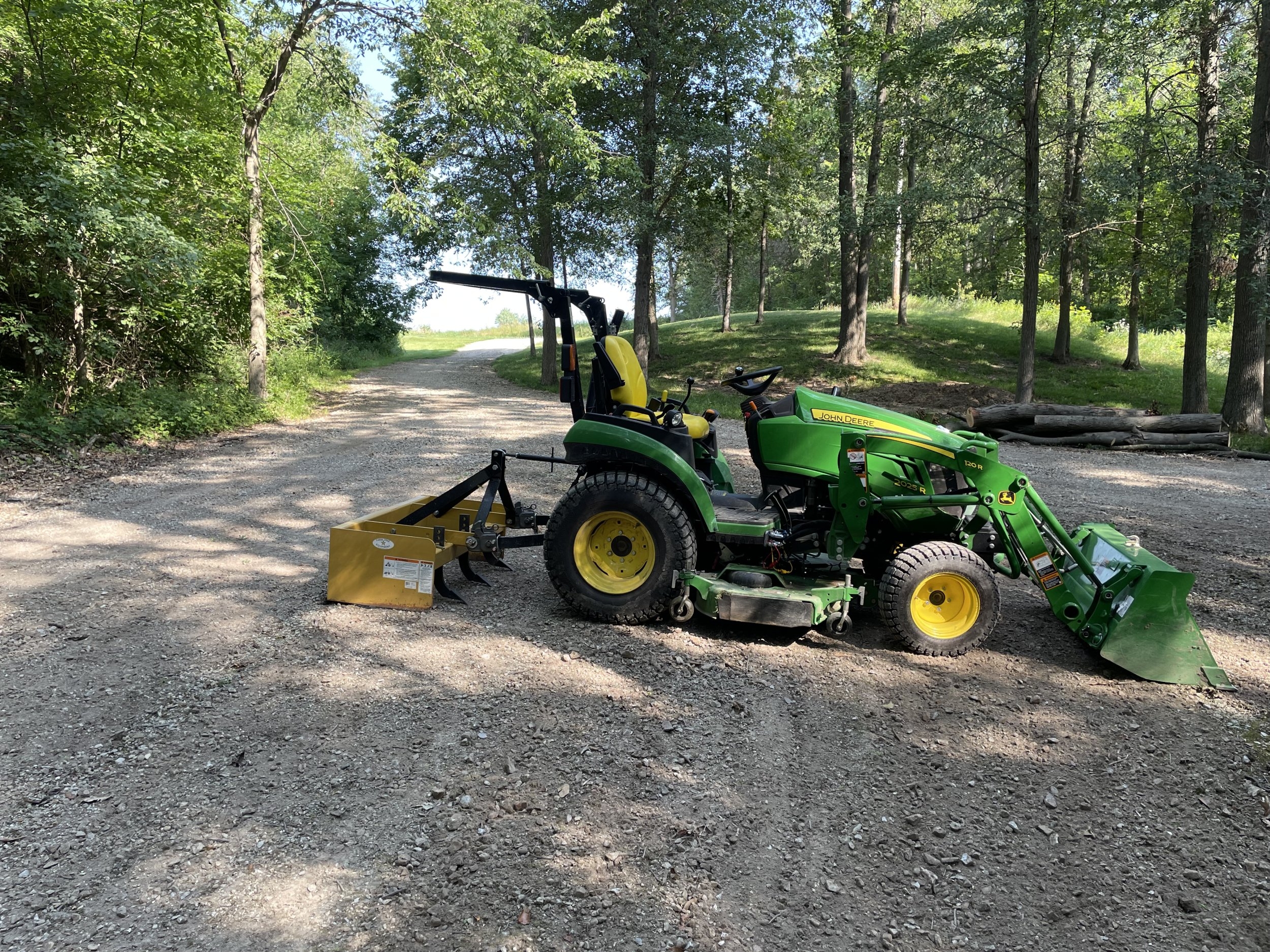

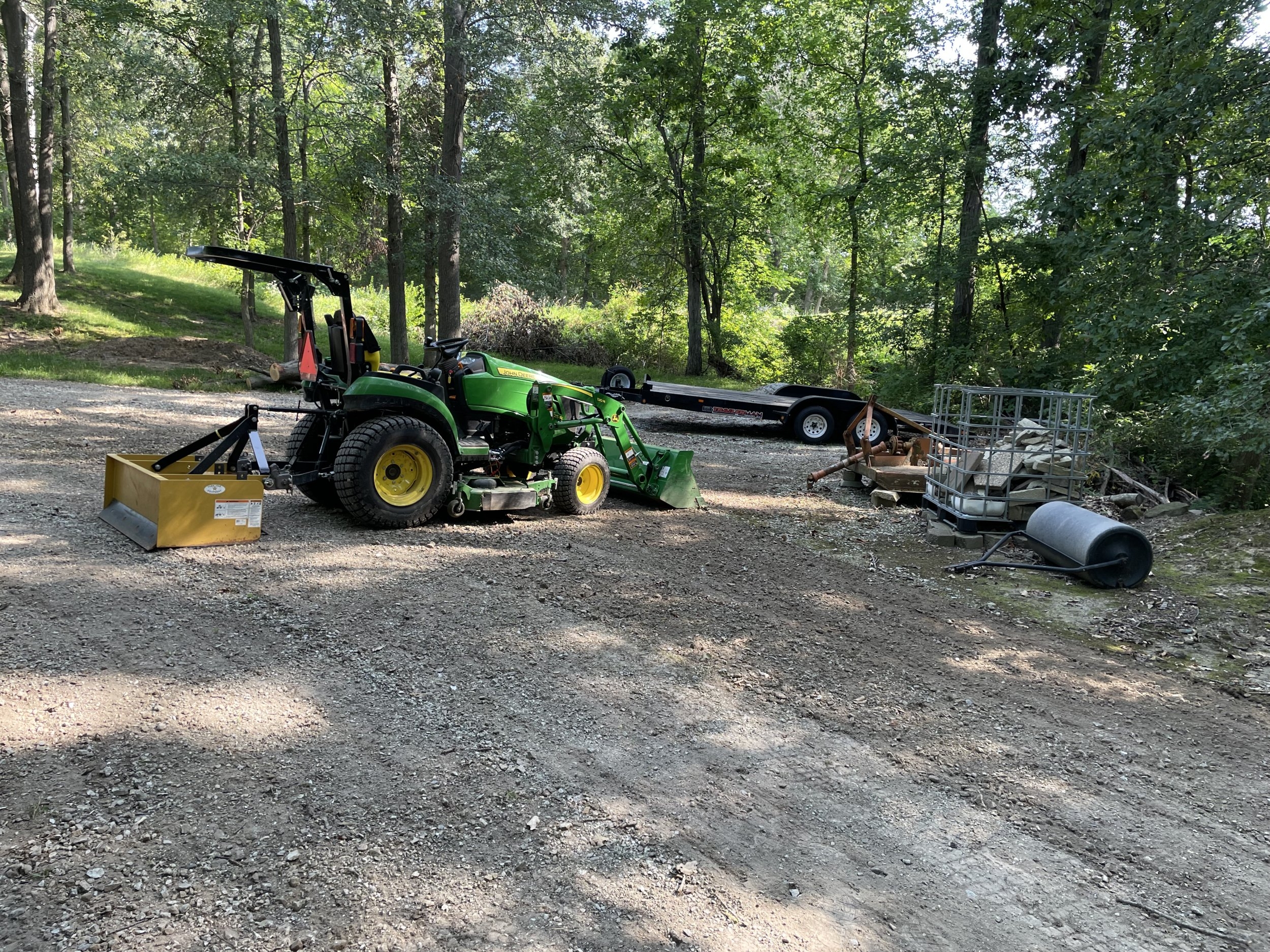

I bought a box blade last year and used it on my gravel area. My main driveway is paved but I have a second gravel driveway and parking area. I attached a couple of pictures and it did a good job. I don’t think it lasted any longer than using roundup though. It doesn’t get a lot of traffic though either which traffic will help beat the weeds down.

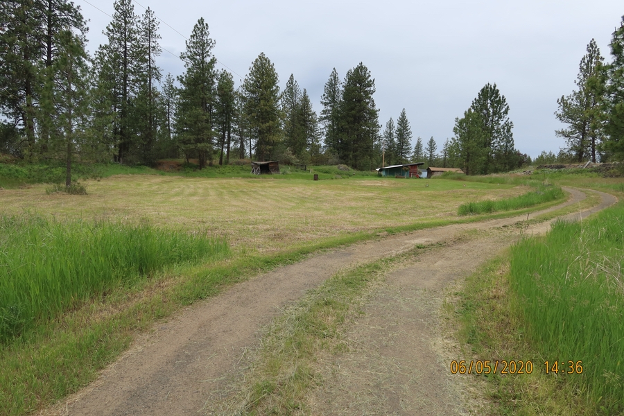

This is my driveway - a day or so after I mowed.
Every year the center crown grows a better crop of green on our drive.
Winter snow removal can be brutal and make much of the greening go into reset. I am patient, yet eager for the center crown to define the rutted two lane approach to our home.
