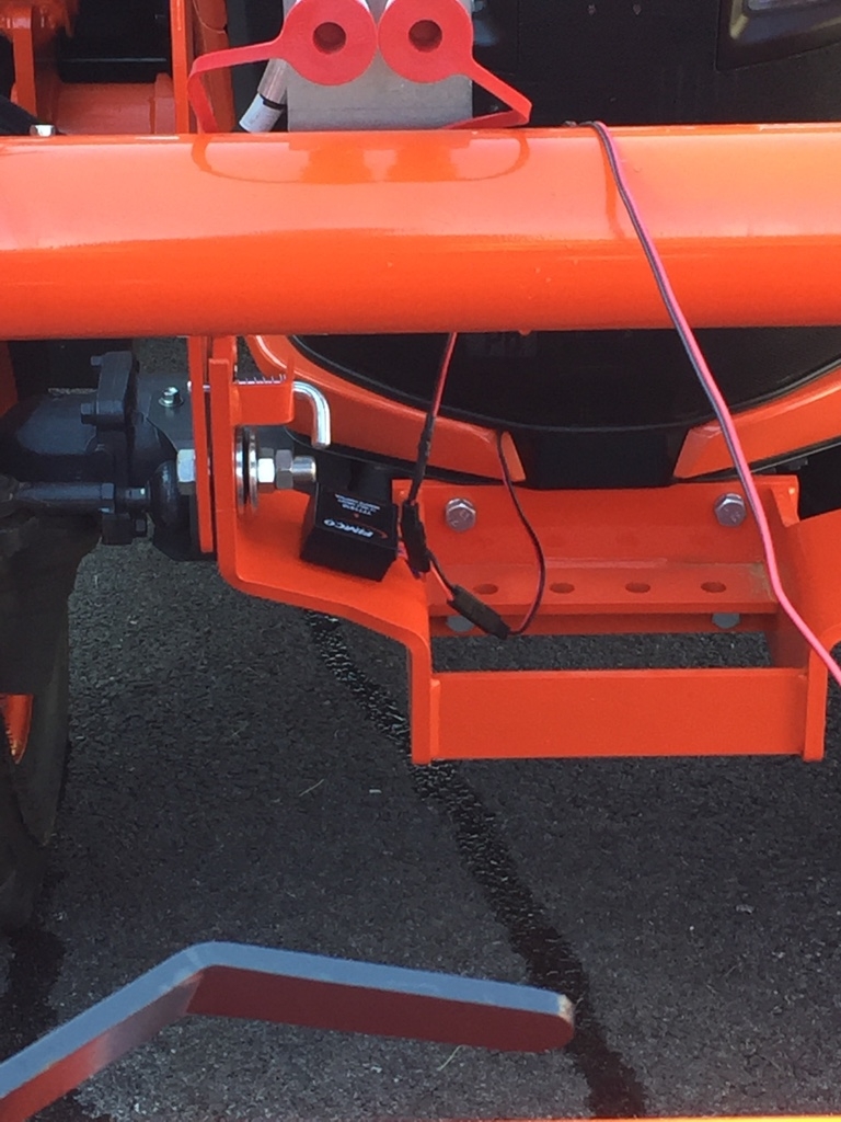

I adapted a small sprayer for my fel, but I likely wouldn't drive into the spray if I didn't have a cab. I guess you could go backwards in an open station, or mount the boom on the rear.
Anyway, I used lightweight galvanized angle iron (sounds wrong!) and added I think 4 nozzles for an 8' swath.
The first picture is of the Fimco wireless switch that allows an easy remote power switch. Plug and play.
