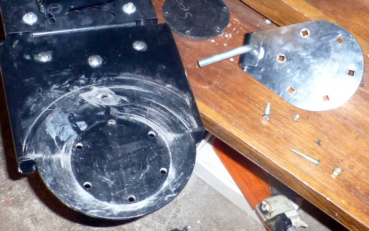

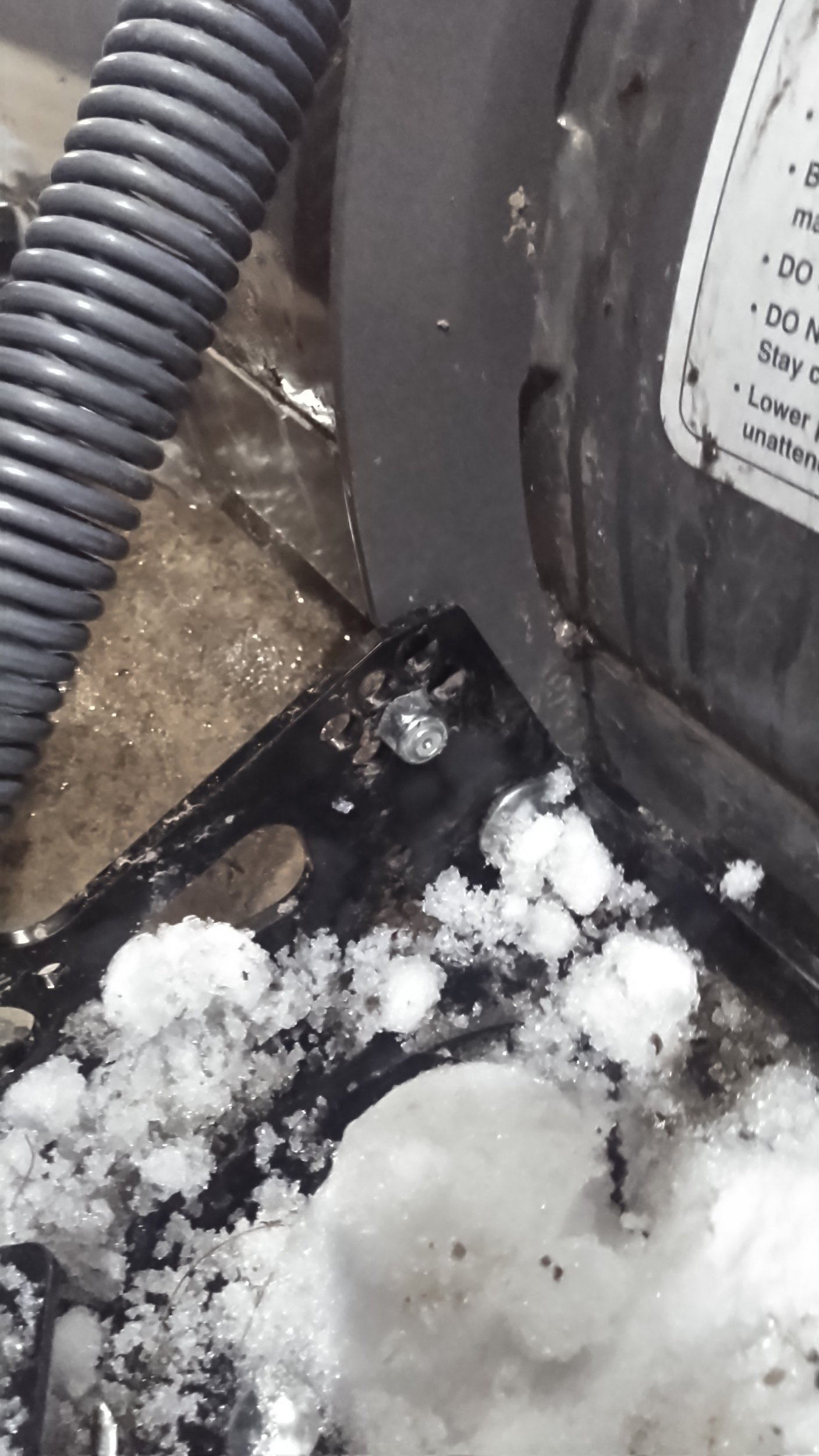

It seems the distance between the center point of the plow pivot and the angle lock pin are pretty close which would add force to the pin. If the pivot and pin were further apart, the force applied to the pin would be less.
/ KFI plow updates #46

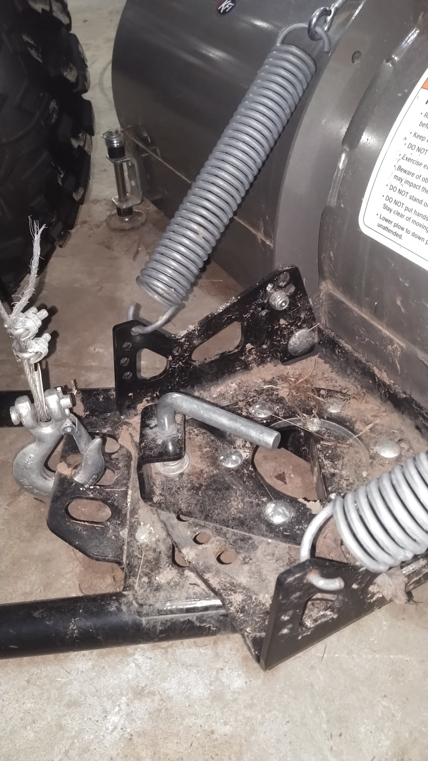

Here's the adjustment holes I've used for blade pitch with welded pipe, probably replace it this spring with new pipe I'll spend the few extra bucks and buy hardcoating rod, probably do it once and done. Another thing I'll probably do is weld the spring loops shut they are starting to deform. Like I said almost three seasons using it and no major problems on a 1k' driveway plus 1/4 mile road to Xmas trees during season. Any questions feel free to ask.

I have my blade back stop limiter bolts installed in about the same location as you do. My trip springs attachment hook bolts don"t seem to be stressed to the point of being bent.. My blade does trip. :unsure:

I have a 5' plow hard for me to believe an extra foot would over tax the pivot or trip mechanism. Like it did to yours, like I said only running two oem trip springs and none of my holes are egging out in the angle adjustment at times I'm pushing heavy wet snow mostly with blade angled. However I do use my tractor to push banks back when they start encroaching the plowed roads? When I used atv to plow up by you I always had to ramp banks to push snow farther out of the way. With a blower it definitely eliminated that and probably extra wear and tear on plow?
/ KFI plow updates #49
Also I've probably mentioned this a thousand times but welding a pipe to cutting edge virtually eliminated hard impacts which I used to feel how hard that is on the plow and plow vehicle even with trip springs.

Ahh is that what there called? If you look at all the possible holes it can either angle the blade forward or rake it back have to adjust spring tension accordingly to the stopper bolts imo. Because of your problems I will monitor my plow more closely, Anyways my kfi plow works great, best of luck

Well that 1/2 angle control pin size a design short coming.... I heard from other guys using a KFi plows having the same greif.
/ KFI plow updates
#52

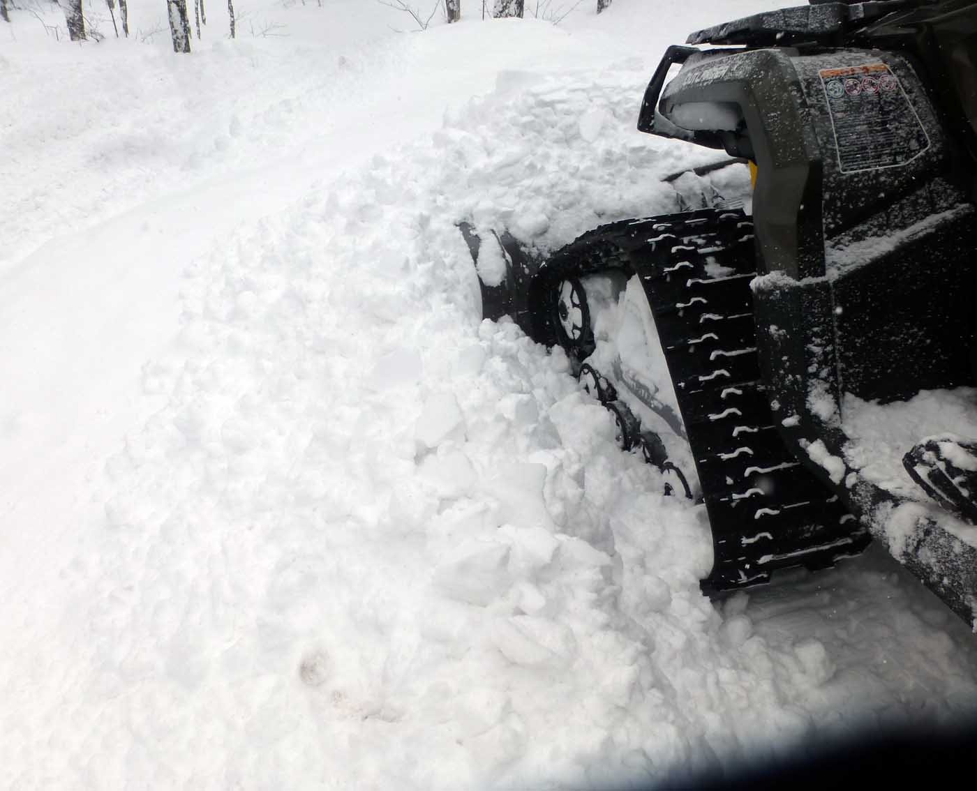

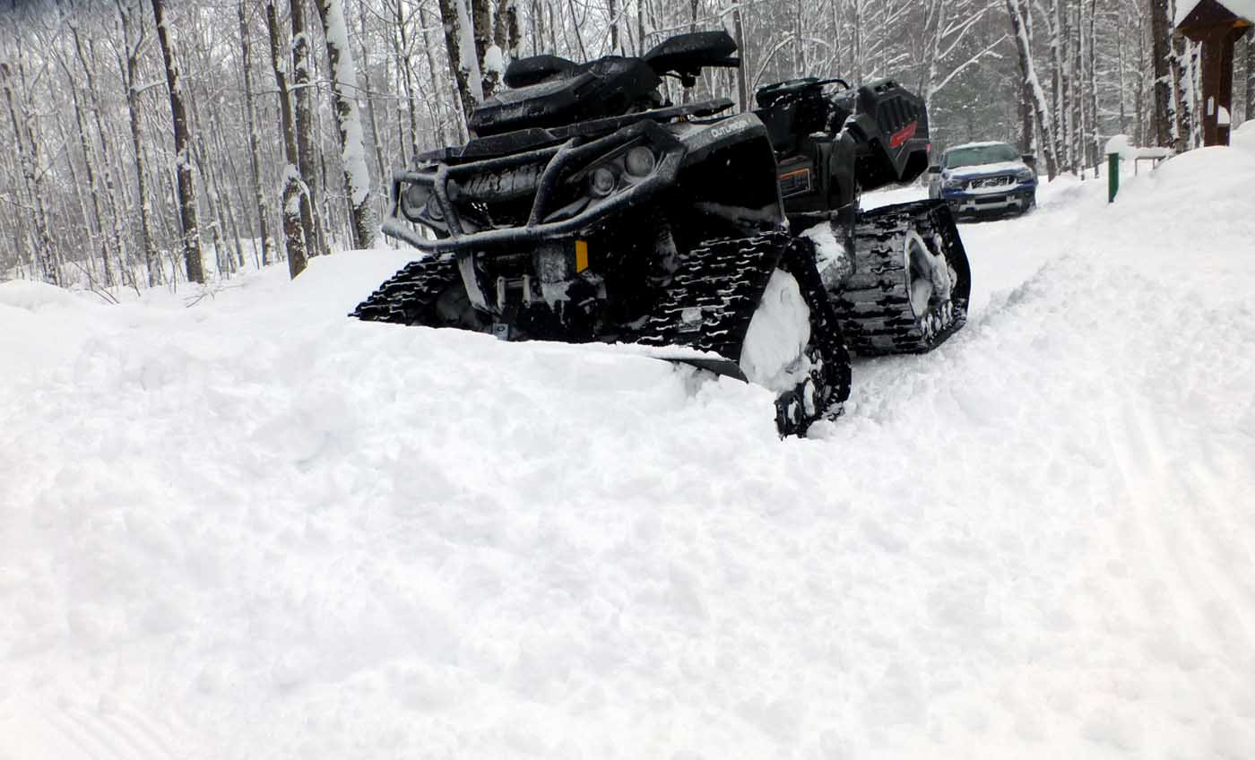

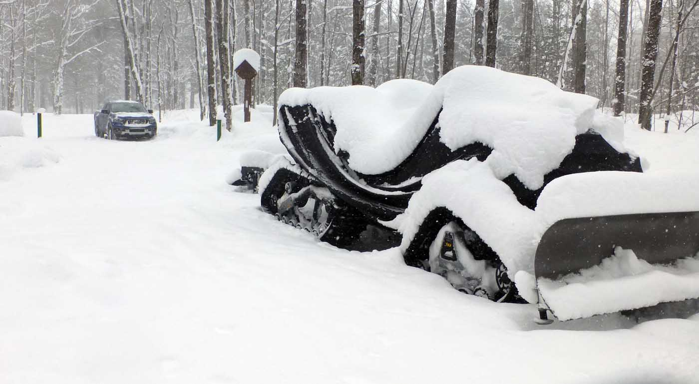

I just got back from plowing a foot of snow off our ski trails parking lot. That 5/8 gravity pin is a keeper! And I tried to pay attention to the HP or throttle I was using to push the snow off. I barly was above the RPM to engage the clutch. Pushing snow just doesn't take much.
Self engineered repairs that actually work no matter how butchered they look are gratifying for me anyway.

I hope you're not tripping it by pushing into a pile of snow.
/ KFI plow updates #57
How often was the blade tripped today?
You usually plow with blade angled or straight? For me anyway it's 95+% the time plowing it's angled.
/ KFI plow updates #59
Ok I'm fortunate I have long straight runs, I do feel having it angled is easier on plow and the machine pushing it. Glad to hear it's working for you.
