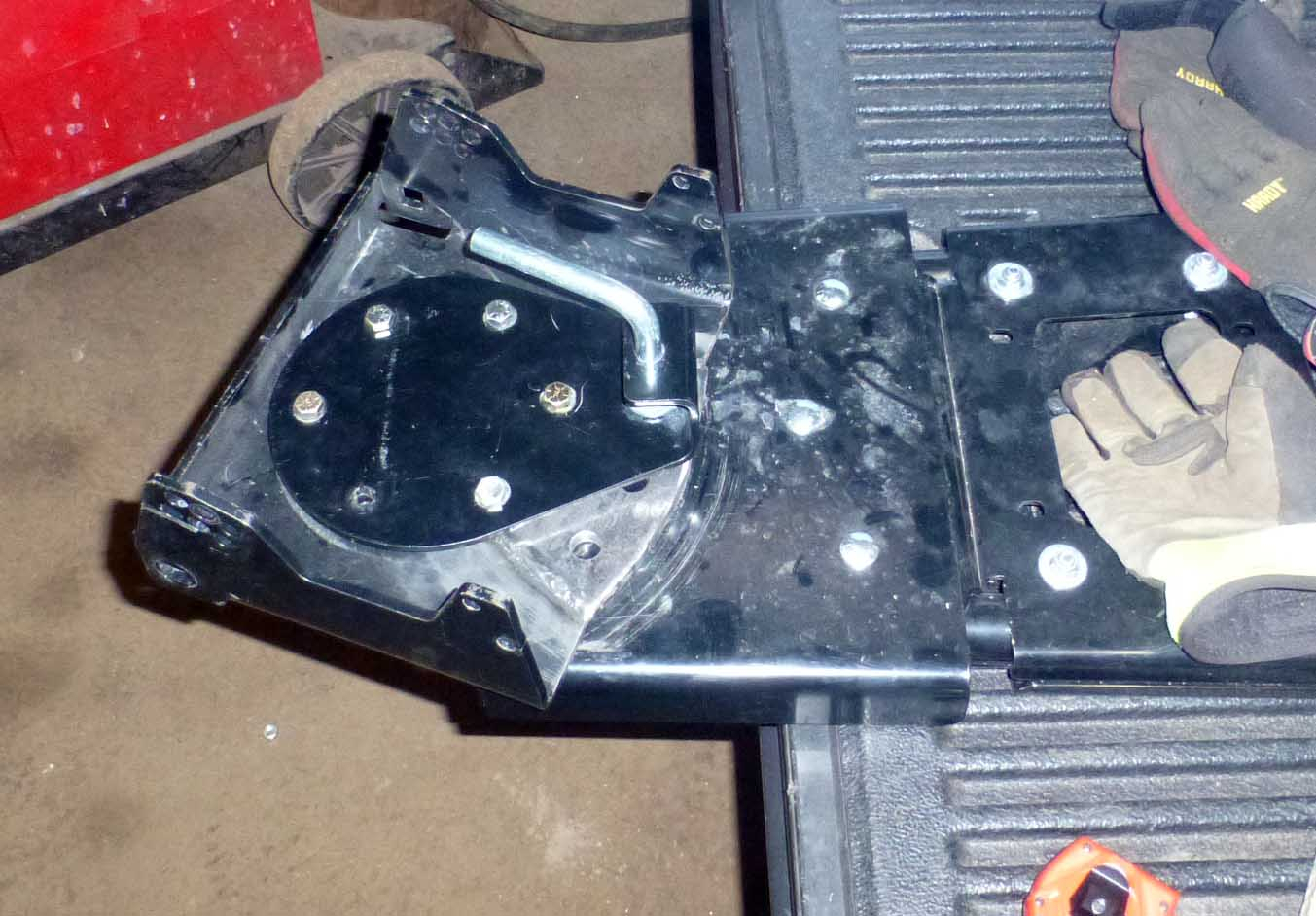

Th egged holes are between two plates so any added thickness needs to be compensated for. I also moved two holes so as to work better with our setup so the washer thing wouldn't work very well. Nonetheless, going to 5/8 lock pins wasn't hard to add and should take care of future wear? :unsure:
Ahh now I see the problem your having yep definitely not much clearance without reconfiguration.

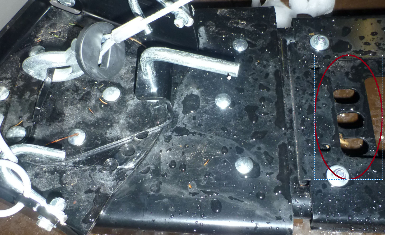

Another user after we'd got this plow did state these holes egg out. Hopefully with more meat in the plates AND moving up to a 5/8th pin will make it go a few years.... Its kind a strange that this plow is built so much more heavy build than the moose one we used was on the boss was. Yet its pin angle system is weak.. :sick:

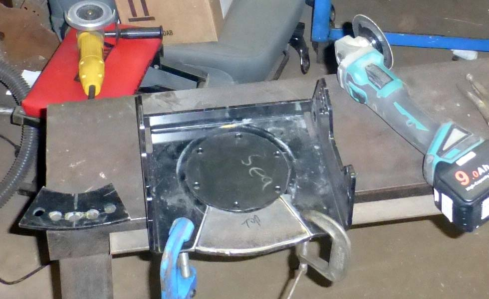

I don't have much for pics but here is some. In the top one, you can see a hole in the center and its has a bottom to it. This is the roation pin hole so only 1/4 an inch of insercuion can be attached with the pin. Of cosure it was egged. I drilled throught the lower plate to give it more material and allow the pin to go a bit lower.. I beleive this was a designe flaw when they added the extenion, the hole was covered.. In the lower photo yuou can see the top plate as well.

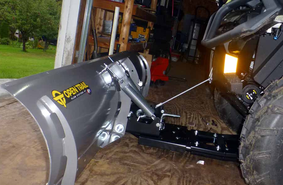

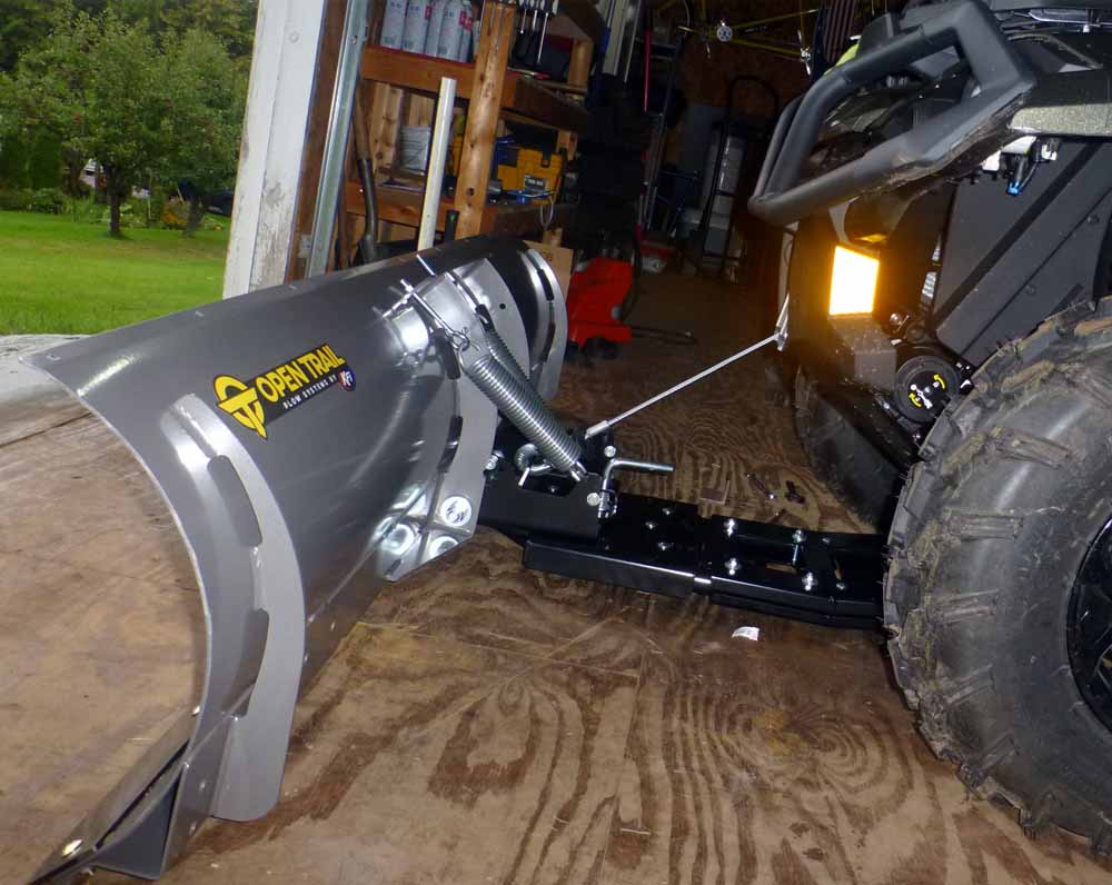

I got it on late today along with a strap on the winch for lifting purposes and discovered the angle holes I made were off..... and the blade hits the pods. :(:cry::unsure:😟☹️😖 Feel free to call me stupid for not testing it before drilling them.

If the blade is hitting the pods you could extend the blade out a bit more to clear the them. Especially if you like the present angle.
