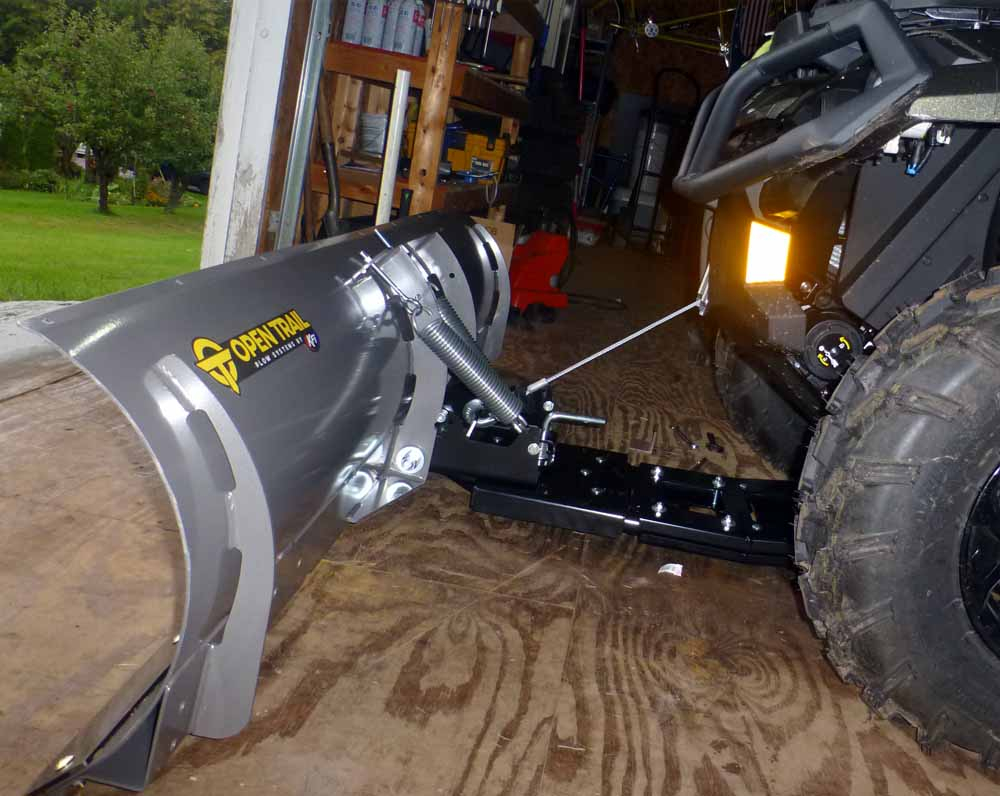

We have one of these units on our 6x6. Does anyone else here use it? Looks like I'll have to be modifying ours since I've put it to use.

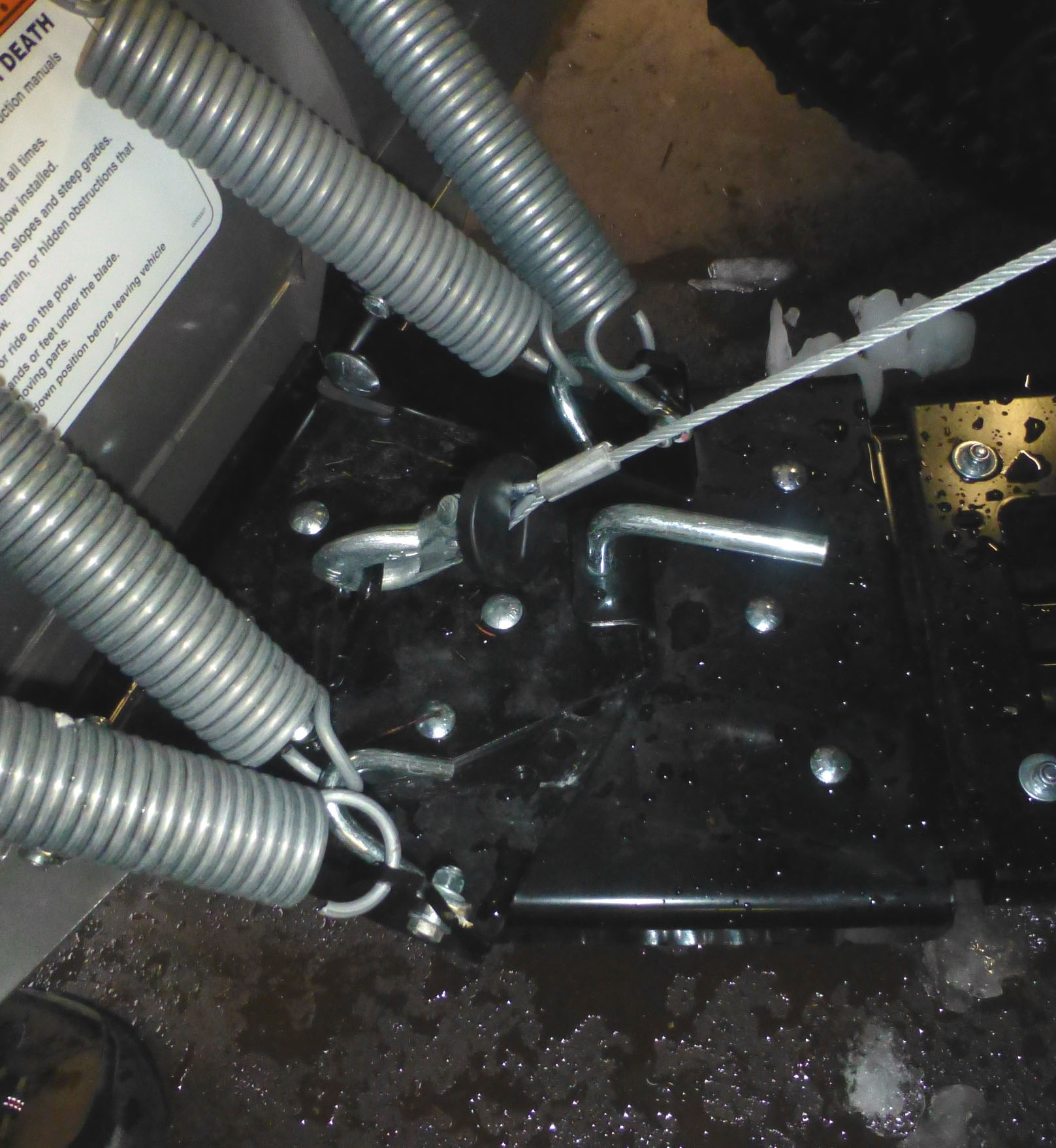

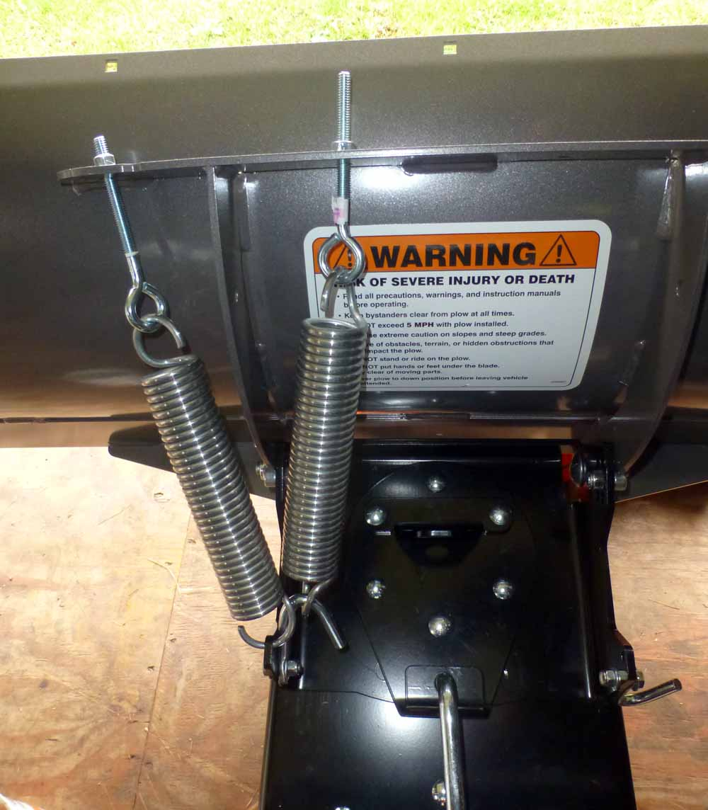

I'll need to get the angle adjustment plate off and see if I can build a thicker one since this one is getting egged out from side impacts. I've already doubled the trip springs as seen in the bottom photo. Top is a photo of that plate with oval pin holes.
/ KFI plow updates
We're predicted to hit 38 today and no snow in the forecast so I might try get some work done to this plow when i get home from work.. I'd going to see if I build a new angle plate from thicker material and change the hole spacing (plow angle) some. :unsure:

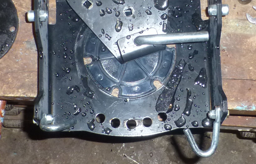

I took off time from work and disaemblied the "pivot-n-lock" system on this plow. The holes that are egged out are punched in 1/4 plate and seems I can bump it up to 3/8 thickness. More to follow.

I'll need to get the angle adjustment plate off and see if I can build a thicker one since this one is getting egged out from side impacts. I've already doubled the trip springs as seen in the bottom photo. Top is a photo of that plate with oval pin holes. View attachment 776147
I should have said in this photo, I added another pair of trip springs to it and it now trips less.

I worked on this setup a bit yesterday. In this photo you can see the three angle adjustment holes are egged out. Its 1/4 plate so I will cut the rear section out with the holes in it and replace it with 3/8. I can then also move the holes slight to make it work better with our machine.

I got a new plate installed today. Ya, not much done. I work slow... I decided to replace the 1/2 pin with a 5/8th one which will happen later. In these pics is the original .5 one and the hole it locks into was just to egged out to leave as is..

Today I drilled out all the lock pin holes to 5/8th* and made a new center HDPE bearing from 1/2 material. Yes, my 3/8 was to thin to allow rotation. On Monday I hope to get to a HW store and get the longer bolts I need. I'll post pics later.

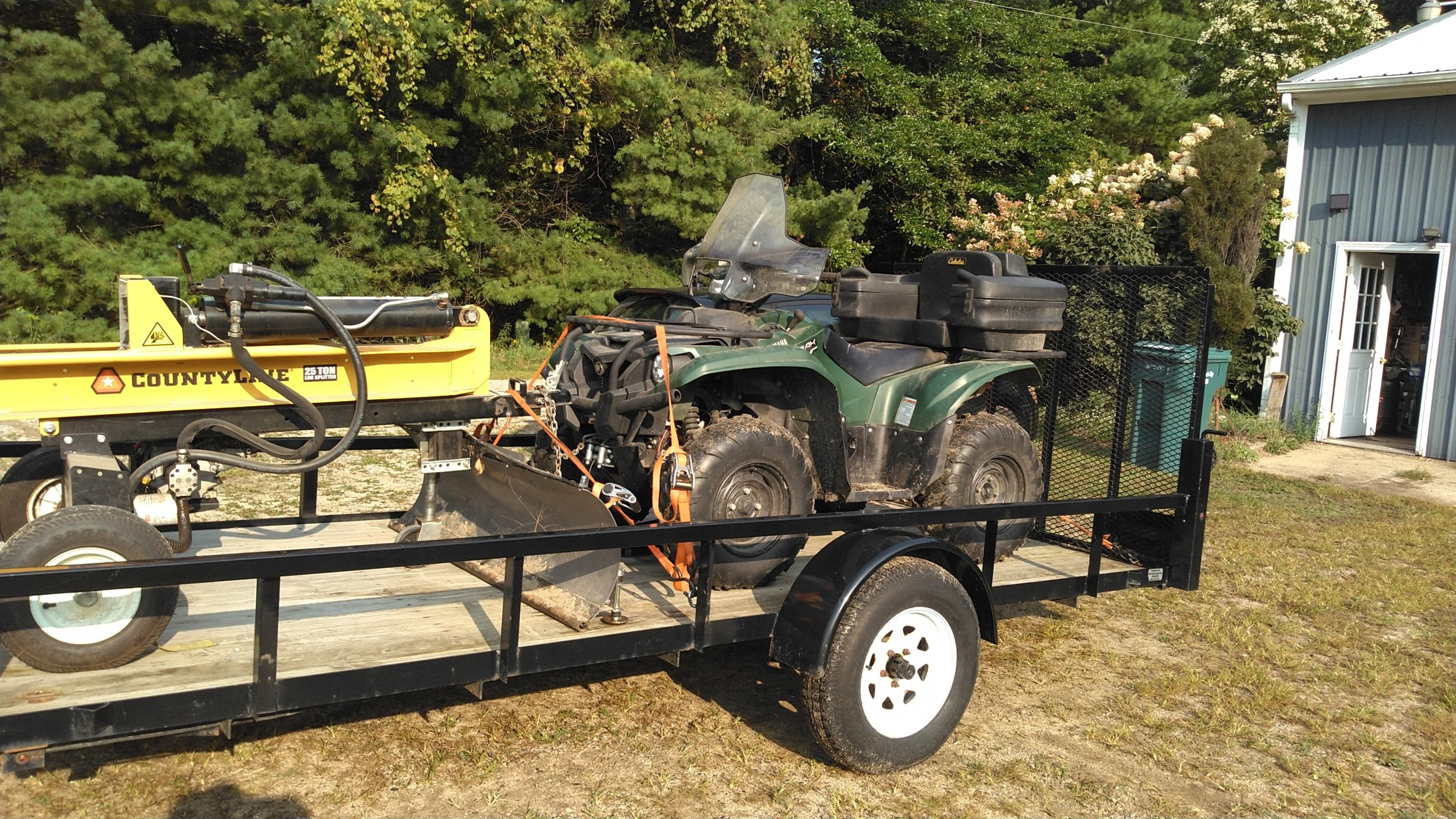

Have one for my Kodiak use down state for over two years now great plows imo, 5' I believe. I see you installed extra trip springs, on previous ATV plows I replaced those little springs with smaller truck plow trip springs. I also weld steel pipe to cutting edge it was a complete game changer plowing unfrozen soft ground for me anyway also bolted a piece of ridgid plastic across top of plow so snow doesn't go over the top of plow as much. If it were me what I'd try and do is weld grade 8 washers where your holes are egging out. Good luck.

Th egged holes are between two plates so any added thickness needs to be compensated for. I also moved two holes so as to work better with our setup so the washer thing wouldn't work very well. Nonetheless, going to 5/8 lock pins wasn't hard to add and should take care of future wear? :unsure:
