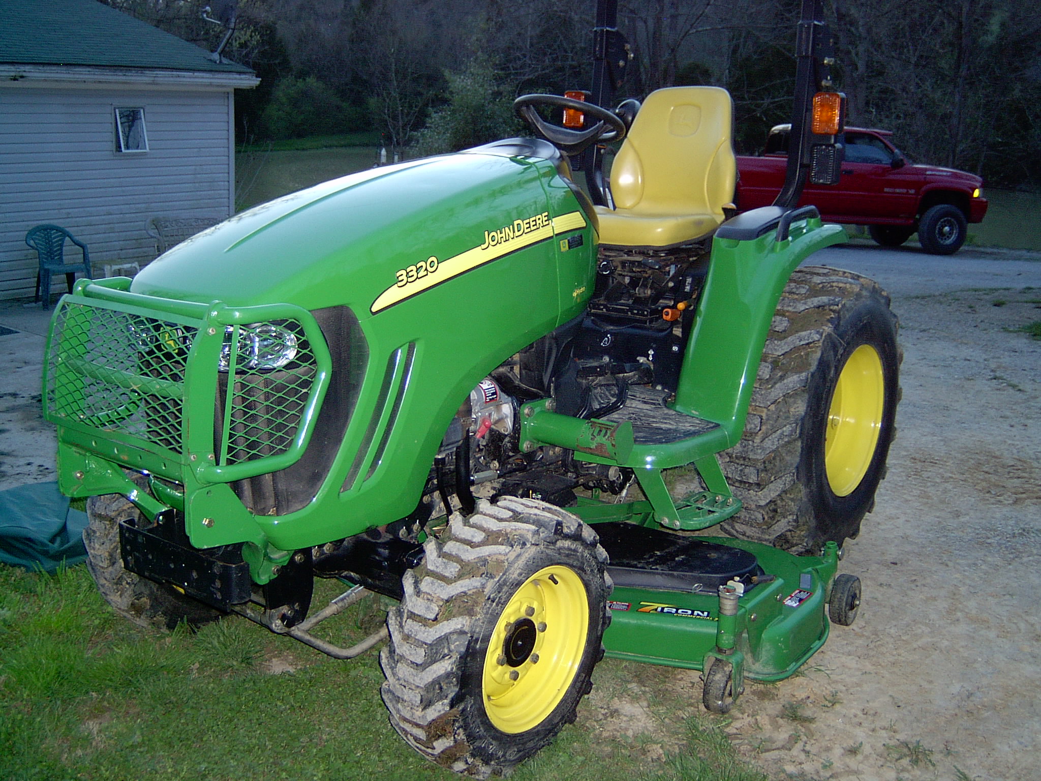

Thanks JF. BigMike, I can have a full load of dirt of gravel in the bucket and get the same result. I was going slow so it would show up in the video. I've also noticed my 3320 has the stacked rops lighting like the 4000twenty series instead of the single light. Was that way when i bought it. Never really gave it much thought. untill now. 3320 005.JPG

Thanks JF. BigMike, I can have a full load of dirt of gravel in the bucket and get the same result. I was going slow so it would show up in the video. I've also noticed my 3320 has the stacked rops lighting like the 4000twenty series instead of the single light. Was that way when i bought it. Never really gave it much thought. untill now.View attachment 320106
Nice brush guard!
