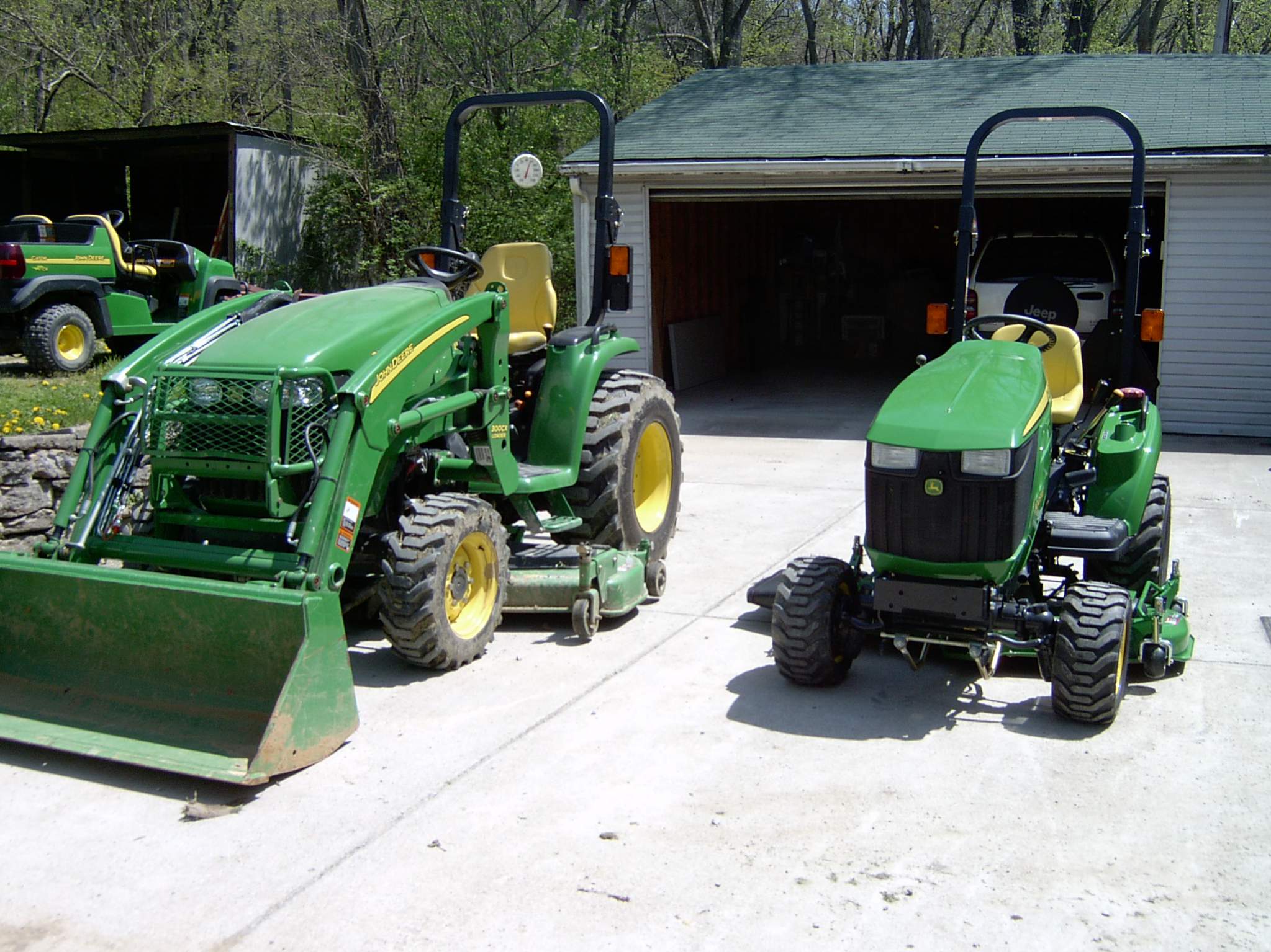

We . As for the curling while lifting on your loader, I have no problems with the 300cx on my 3320. I do it all the time. Have your dealer check that also.View attachment 319916
My machine is going in next week so ill check. but I have to tell you, I would love to see a video of your machine doing this if you have one because I have watched more than a dozen 300 and 200cx videos on youtube to verify this condition and every single last video exhibits the condition of only doing one operation at a time. not doing both. haven't seen a video yet of a machine raing while dumping.
