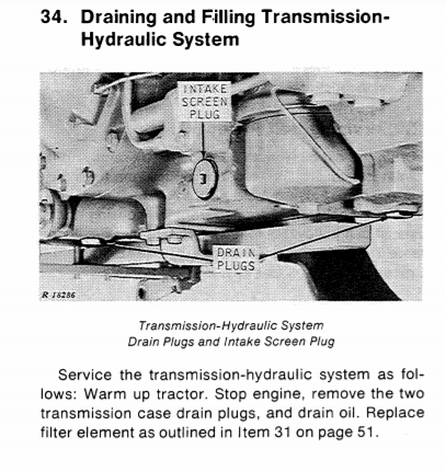

Yes hydraulic noises & vapor being emitted from hyd filler hole behind seat indicates that rockshaft control valve seals are leaking & need to be replaced. Rockshaft housing must be removed to replace those seals. What type valve controls front end loader(independent or scv)? How many hrs of use since hyd filter was changed & hyd oil suction screen checked/cleaned?

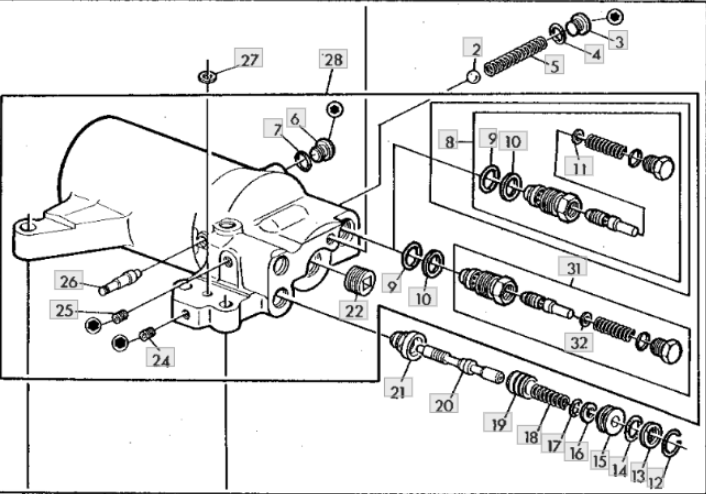

Thank for responding. Can you post a diagram with the seals that you said are leaking? The loader is independent. The hyd filter and fluid are replaced every year. It has been probably been less than 100hrs. I just cleaned the suction screen. It had metal shards in it which I am assuming is from the brakes.

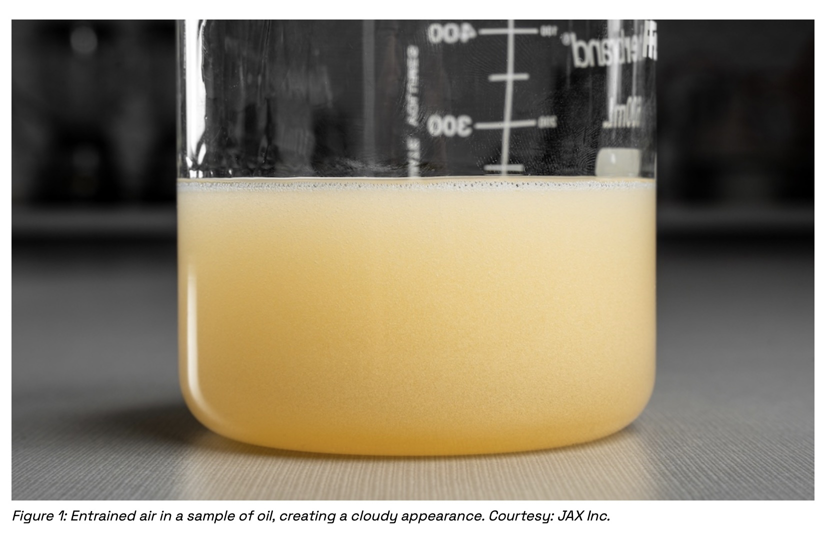

The hydraulic pump can suck significant air in through a pinhole leak that won't leak oil to the outside. At most, it just makes an oily coating on the outside of the hose. Some suction lines have rubber hose with worm drive hose clamps. On those, it is best to replace the hose.
But the easiest test for air entrainment is to pull an oil sample with a syringe and look at it. It is very easy to tell by looking. Hydraulic oil with air in it beomes cloudy like that picture shows. If you blow up the photo you will see the cloudiness is thousands of tiny air bubbles. But if you let it stand overnight it will clear up just like new oil.
I posted a picture of what it looks like on that other thread. Here it is again.
Shown below is a photo rockshaft control valve parts diagram. One must remove rockshaft housing to gain access to these parts.

I still think you should at least take a look at the fluid to see if air is being entrained. It meets the symptoms.

I simply don't know the particulars of those 55 series JDs well enough to know exactly how to shut off any particular system. But after looking at that valve body picture TX Jim posted, there sure are a lot of places where age in a seal could cause a persistant high pressure leak in a closed hydraulic system. And yes, a leak in that valve body would hiss and make vapor when you open the fill port and listen.... probably even worse than entrained air would.

Thanks for posting the diagram Tx Jim, I wanted a second opinion on which seals to replace, so from the part numbers on the diagram I ordered all of the o rings, valve spools and seats, and the two big rings that go on the rock shaft piston. I will pull the rock shaft housing which I have done many times on tractors, and replace these parts. I'm guessing this is a pretty easy repair. I still don't think that the leak that I can hear is what causes the hydraulics to get slow when the tractor is hot.

JD utility tractors built from '65-'92 have a long history of rockshaft control valve seals getting bry=ittle with age & leaking. If you can hear a hyd leak I'll bet that internal leak is contributing to poor hyd performance.
