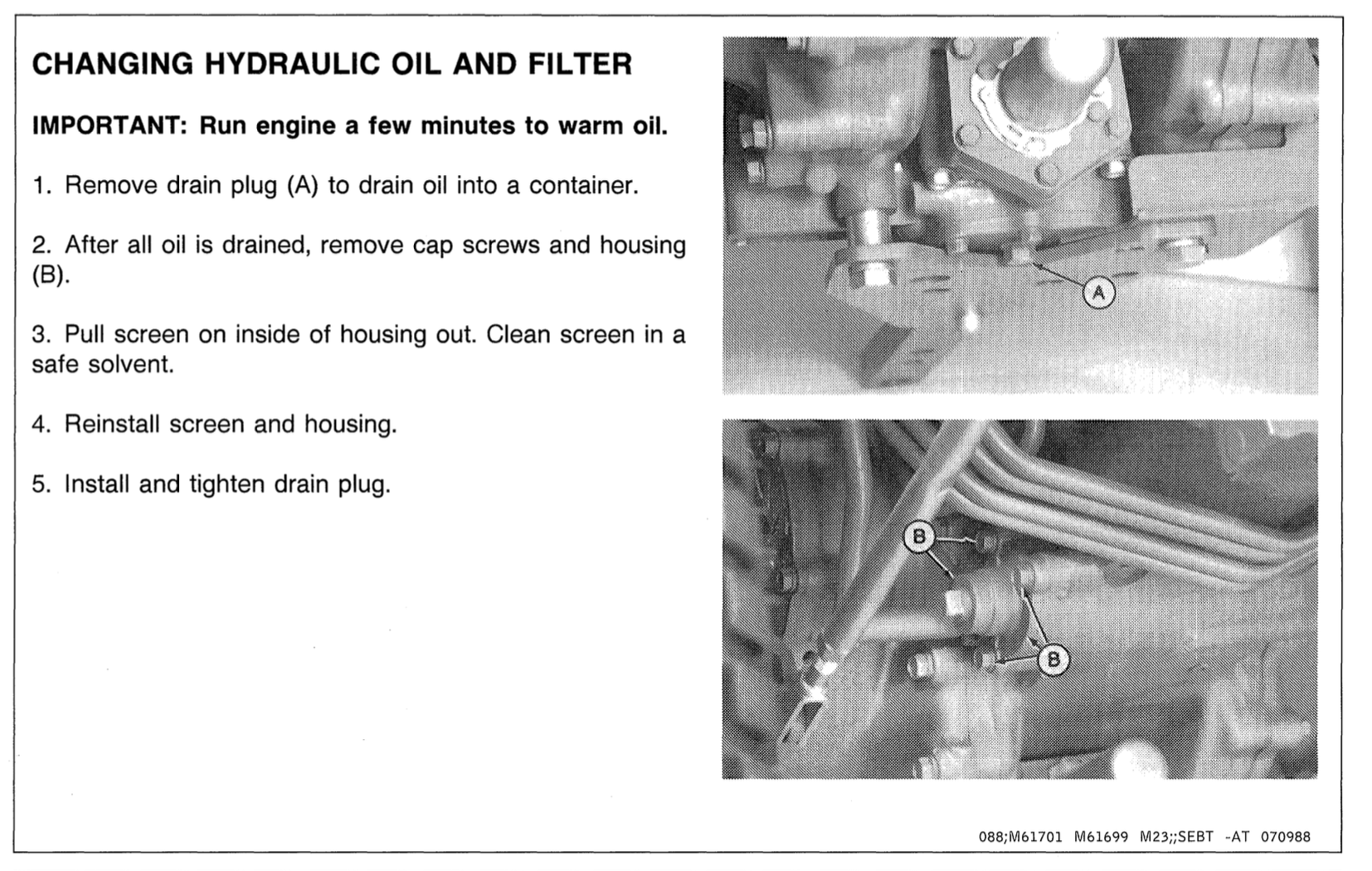

So, how do you get the metal screen out ?!? Looks like lots of crap has to be removed. Except, looks like there's a cover at the far end of the suction line connection (so on the right-hand side of the tractor) and you just remove that (and maybe one little suspension piece) ?
Guess I'll buy a new filter, replace that and the oil (I assume the oil all dumps out when I remove the screen). Can't find a part# for the screen so just clean that I guess. And go from there.

My inlet screen had more debris on it that I want to admit and was collapsed. I flushed the system and replaced it with a larger inlet screen [same filter mesh, but larger length and diameter], using a bushing to step up to the large pipe thread size. There was plenty of room in the reservoir to accommodate the larger suction screen. I also added a Hycon/Hydac spin-on return-line filter with a gauge on it.

What's this about pipe threads ? This all my manual has about the screen ...

All the Japanese tractor manufacturers came up with different setups to access that cleanable screen type suction filter. Some didn't even include that feature - although most did.
My guess is the cleanable screen crud flter itself on modern compacts is a holdover on some from the earlier tractor designs from the 1970s&80s when that feature was common to all small 4wd imported tractors.
The filter covers can be located low down or underneath and on either side of the common transmission/hydraulic fluid sump. It varies. A few didn't have it at all. A triangular cover having three bolts is a pretty common way to identify the removeable filter cover - as your photos show. That weird triangular 3 bolt cover seems to be a common feature on Yanmars and also on the tractors Yanmar made for JD.
There is a non-critical cover gasket under the cover. Most folks either make one or use RTV...or both.
BTW, is the manual you are using specific to the 670? Or something more general? The photos you posted seem to be two different sites for that same cover. Some of the imports did had the cover back by the PTO or near the draw bar.
Like "qualsite" says, the screen is commonly found to be covered with crud and/or smashed. Straighten it out and reuse. The screen usually fits loosely over a couple of projections. It is not a fluid-tight fit at all. You can make your own with 200 mesh stainless steel hardware cloth from Ace hardware, or even sew on patches with stainless steel thread.
I've never seen or heard of the cover or insides screen fitting pipe threads, nor one where the cleanable screen had enough entry clearance so the filter could be changed in size. My guess is that qualsite's tractor is different from typical Yanmar/JD. Or maybe his had been modified before.
It's specific to the 670 AND the 770. Mine looks exactly like the lower photo (in the image I attached) - the 3-bolt cover with the drain plug in the middle of it.

Sounds like you are good to go. No reason in the world why you cannot carefully decant the hydraulc oil into a clean container, strain it, and reuse it - just as long as it is still clear oil and has not gotten all milky with water.
BTW, I just realized I still have a JD ops manual for the 870/970/1070. Right there on the 500 hr service pg 93 is yet another picture of the screen cover. Hard to tell just where the cover is from the picture, but it is clearly in yet a different place from yours.
The manual says to "pull the screen and clean in a safe solvent".
The JD 870/970/1070 models also have a spin-on throwaway cannister style transmission/hydraulic filter in series on the suction side. But it is the screen that always causes fluid starvation problems because of not having a bypass valve.
