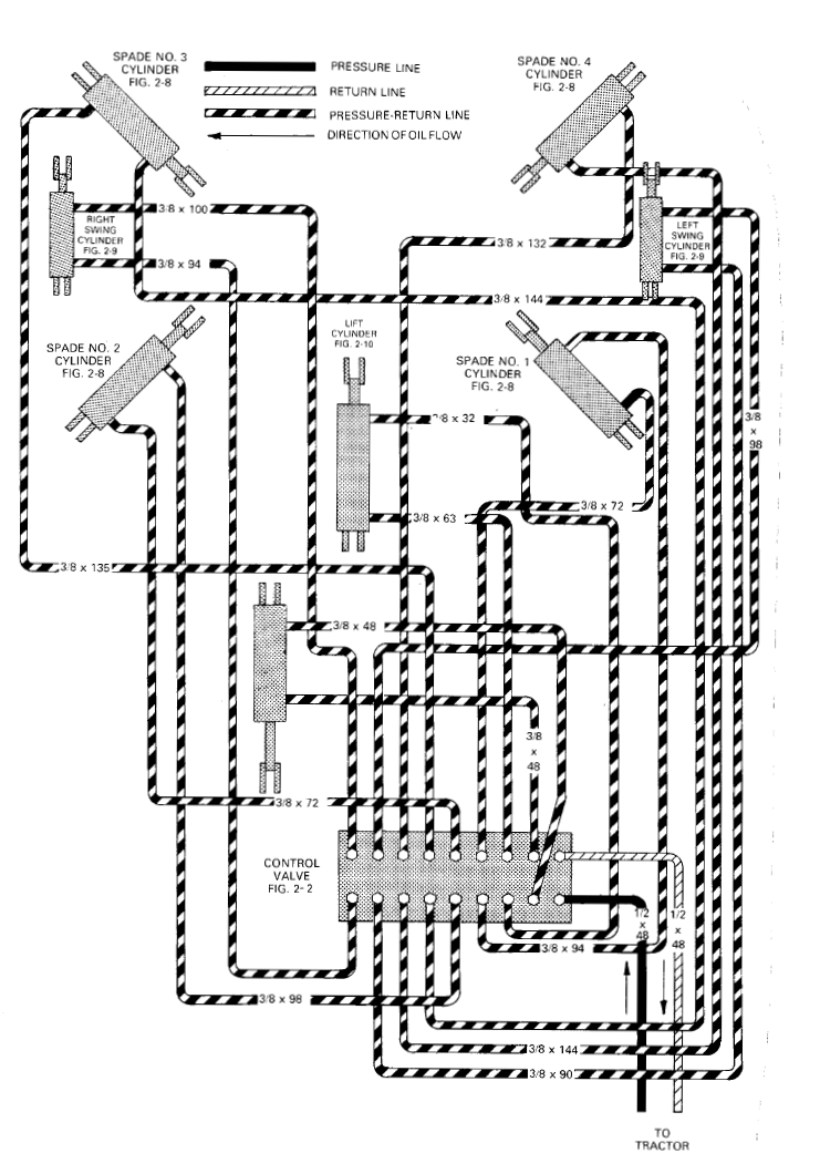

I've got a bit of a problem with a tree spade, and am looking for help.
I've got a Vermeer TS-30 tree spade (tractor-mounted version) that I hook up to my Deere 4020. It's probably 50 or more years old.
The problem is that when I use it, the hydraulics on the tree spade act funny. I engage the hydraulic pump on the tractor, and then can use the tree spade with no issues. When I disengage the pump on the tractor, often the hydraulic valve levers on the tree spade start slowly moving on their own (causing the various spade functions to engage; the spades open, the tilt engages, etc.), AND I get a bunch of hydraulic fluid leaking from the valves and running everywhere. Obviously this is not ideal. This is not new behavior, it has always done this (I've just put up with the bad behavior, but I need to fix it).
I have recently discovered that the tree spade is set up for open-center hydraulics and my tractor is closed-center. There is a plug to convert from open-center to closed-center, but I don't have the plug, Vermeer doesn't sell it anymore, and the original hydraulic supplier ("Energy") hasn't made this valve block in 40 years. From what I can tell, the plugs made for this type of conversion aren't universal, so I can't make one from another hydraulic manufacturer work. Our local welding shop 3D printed a rubber plug for me to try, but when I used it today, it still had the bad behavior. I know the problem is with the tree spade, because the tractor hydraulics work fine on other implements.
My questions:
1) Is what I'm seeing (valve levers moving and leaking hydraulic fluid) consistent with running open center hydraulics on a closed-center tractor? Or is something else going on? If I fix that problem, will it be resolved, or am I chasing the wrong cause to my issue?
2) Long-shot... does anyone know where I can find the plug to convert this system to run on CC hydraulics?
Thanks in advance for the help!

Here is a diagram I found; based on the way I think the SCV outlets operate on the tractor (pressure vs return), I may have been running this backwards...
To answer "oldnslo's" other questions, there's a pan underneath the valves that keeps me from seeing where the oil is coming from, but it does look like it's coming from more than one (or all of them). I do think that the valve levers move all the same direction when they move on their own.
Thanks again for the help.

What might be happening is back pressure from tank line is causing the valves to leak around the spools. On the end opposite lever connections is the centering spring assemblies and caps or covers over these assemblies. If the cap is not vented and leakage slowly fills that cover it could push the spool moving the handles. What I can’t answer is why this would happen if the valve on tractor supplying oil is in spring center / home position.
It has been 20 plus years since been around a 4020 so don’t remember if there is a return or tank connection that does not go through selective control valve. If there is a connection direct to tank I would suggest connecting the return - tank line from tree spade to that connection. Pressure can stay connected to tractor as is today.
/ Tree spade hydraulic issues #6
I would try zrtext's suggestion first. I have worked with a lot of valve stacks and they absolutely have a correct flow direction. Usually the inlet and outlet ports will have a P for pressure and a T for tank. Pressure on the return side will cause it to do odd things. Unless you have damaged seals or o-rings the leakage should stop if you correct this. This is going to be an issue even if the "closed center" conversion is going to work. A flow restriction would have the same effect on the valve but I don't think you have that.

I put the hydraulic lever on the tractor in the opposite position (down) from the way I normally operate it; you could hear the engine pull down about the same amount as if it were in the up position, but in this case, the hydraulic control levers on the tree spade didn't work when I actuated them, or if they did, only a little bit (and it may have been in the direction of gravity, so I'm not sure the hydraulic were doing anything), and then the tractor would eventually kick the pump out and put the control lever back to the neutral (no flow) position.
When I put the tractor hydraulic lever in the "up" position (where I typically run it), the functions operated normally, but when disengaging the tractor pump, the tree spade hydraulic levers moved as I mentioned before - the picture below shows where the levers stopped moving after about 5 seconds. In that picture, the red line is what I would call the "neutral" position (where the valve lever normally sits when it's not being used). When I shut off the pump, 5 of the function levers (at least this time, I'm not sure it's the same ones every time) actuated. And at least a couple of them are moving against gravity (raising the spades, for example). Maybe it's interesting that the valve levers that are moving are all moving in the same direction (down towards the bottom of the picture, not up, away from the tractor)... but I don't know if that means anything or not.
So, in summary, changing the tractor hydraulic flow direction didn't fix the problem.
