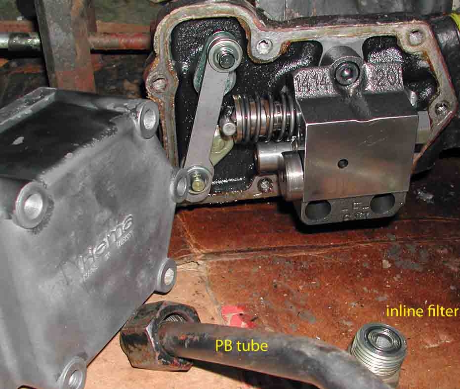

The picture is the 3 point valve correct? Thanks I am gonna need to get into that.

That is the Hema 3-point valve.
A working tractor is worth a lot. Parting it out will be a lot of shipping work.
You could have just a worn-out implement pump, which is not a hard fix. More investigating is called for, IMO.

The 3 point valve was just stuck about mid travel. a couple times gentle working it back and forth with lube freed it up. Still no pressure. Am going for the pump next.

The oil line from the scv to the rear of the 3 point housing. is it right hand or left hand thread? the adapter has that notch around the middle which indicates left hand thread. The tube nut is on really tight but the adapter is loose . Is one right hand and the other left hand?
Also You show that inline fitting with the screen ... where is that fitting located?
Again thanks Gary in Ohio
/ Hydraulic problem plus PTO John Deere 4200 tractor #8
No left-hand threads anywhere that I found.
The inline screen is on one of the hardlines behind and below the seat. JD added it after the 4x00s came out, apparently hoping that there would be fewer issues with the 3-pt cyl valve. Didn't help. The screens just blow out. You may not have it on an early unit.

On top of the loader valve scv are 3 nuts take them off and they are check valves. Hollow nuts with a spring and a plunger. It is like those plastic plungers expanded and they were stuck up in the nuts fully open. A couple hours with a dremel honing out the nuts and a file fitting the plungers and they all work freely now. They are a hundred and some bucks apiece. Oh Well it seems to work now. The tilt works both ways but has a leaky hose and a rusted out steel line on the lift but it works.
