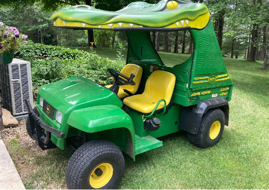

Know this site is mostly about tractors. But looking for any assistance on finding the year and model of a JD gator my son has. The only numbers we could find are on the engine decals. It’s a 2 x4 with dump bed. Thanks to anyone that might know. Pics attached

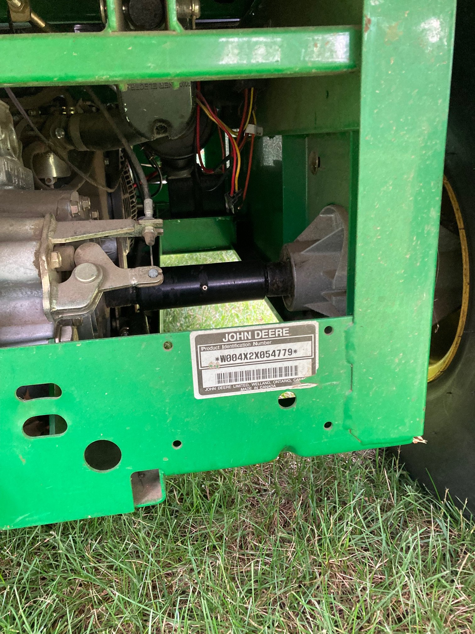

A picture of the gator would help, I believe the 290 engine was used in the 4x2 gator but would have to do some reading. Deere put a serial number plate on the rear, just to the right of the center post where a hitch could be bolted, it was also stamped on the top of the outside of the frame rail under the passenger seat.

Pic of my 24 yr old 2001 4x2 Gator. It is like the energizer bunny.. just goes and goes and goes. Never a complaint but for the lift linear actuator stripped studs (easy fix).
Attached S/N tag on rear frame.

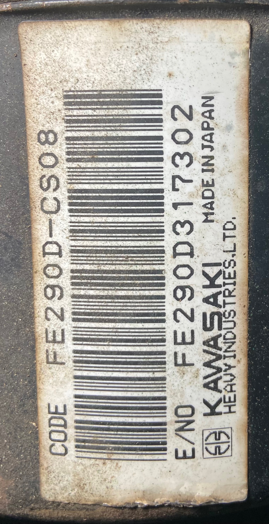

Attached engine tag as well. Looks to be the same engine FE290D-CS08, but an earlier mfg. number.

If the serial Number tag is missing the number is also stamped on the frame. It somewhere from the late 90’s to early 2000’s. I just rebuilt one of these FE290D’s. Very robust engine that includes an oil pump that runs around 50 psi oil pressure. I added a spin on oil filter.

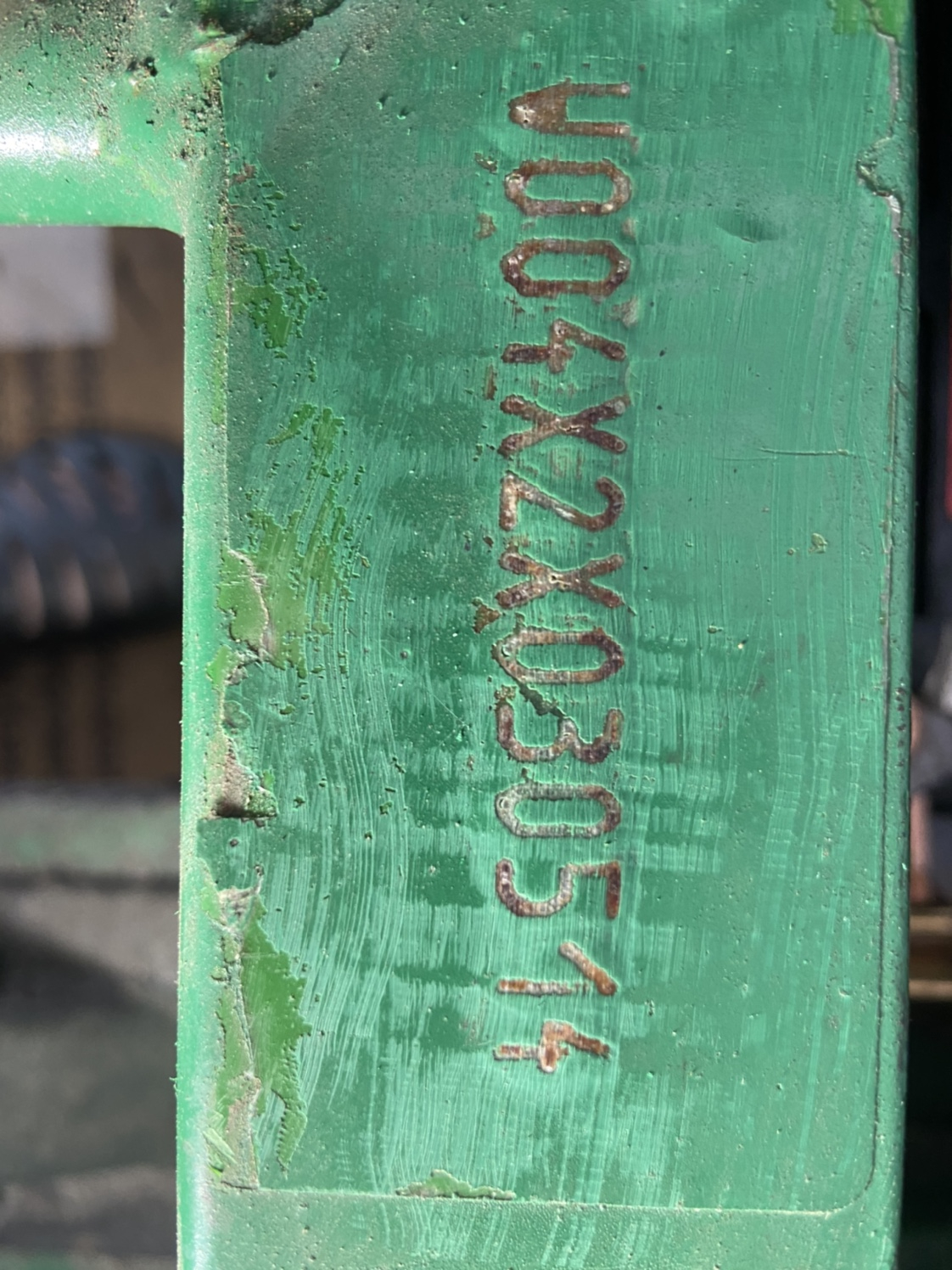

So with the info. Checked under passenger seat. Could see decal that was painted over. Took a razor an scrapped. So does the last number mean it’s a 2014. Or am I way off ? Doesn’t matter the age. Runs great. Just want infor for future part ordering an specs. Again, thanks much.

She’s a 1998 model
The model like yours and mine was made from 1993- 2004
1998 Model (SN W004X2X028039-036169)

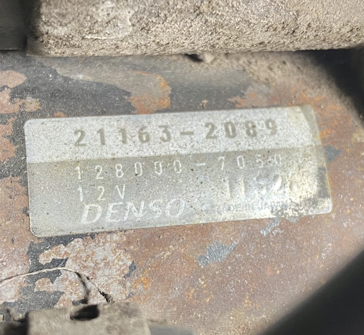

This is a pic taken from passenger side. Held phone down at bottom of motor to take pic.
/ JD Gator year/ model #15
From what I can tell most of the 4x2’s did not come with a filter. Maybe it was an option. The filter adapter bolts on in lieu of a plate. If you look close at your pic you can see the hex head of one of the two bolts that attach the adapter. Because these are air cooled engines you will do yourself a favor by blowing every bit of dirt off of your engine, especially around and under the sheet metal baffles.
