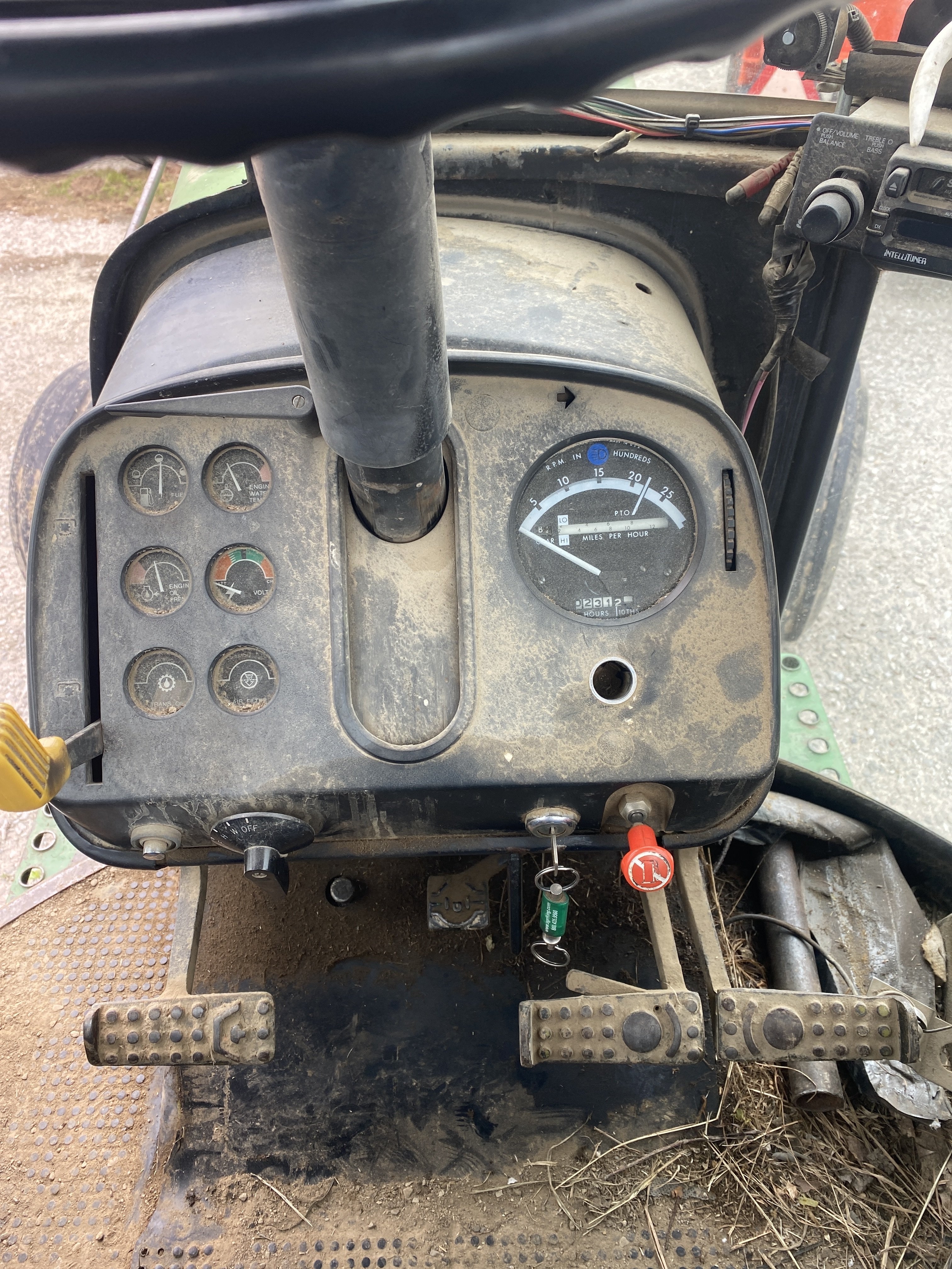

/ Uncle's JD 4230 #72
What goes in the hole in the dash?
Also, what model is the International? I almost pulled the trigger on a 856, years ago.
1586
The hole in dash is the lighter for your cigar now it is used to keep cell phone charged
