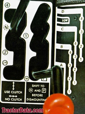

Is this 4230 below or above serial # 019,559? If above that serial # it has metering pump steering that doesn't function very well unless engine is operating. Your statement that wheel spins similar to roulette wheel indicates this 4230 has metering pump steering. All 4230's have only hydraulically controlled steering with no mechanical linkage. Before moving tractor very far be sure to put transmission gear selector in "tow position".
