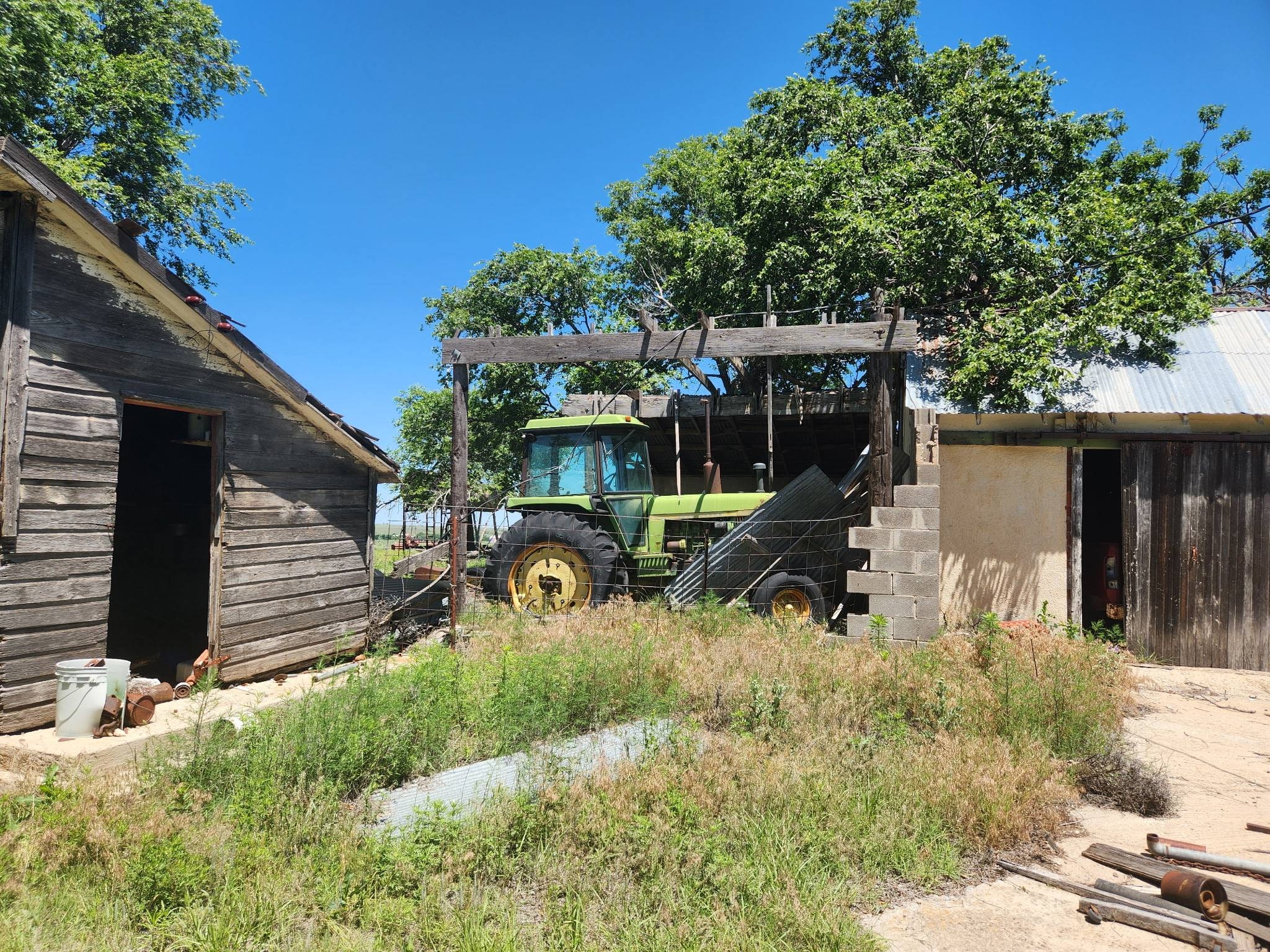

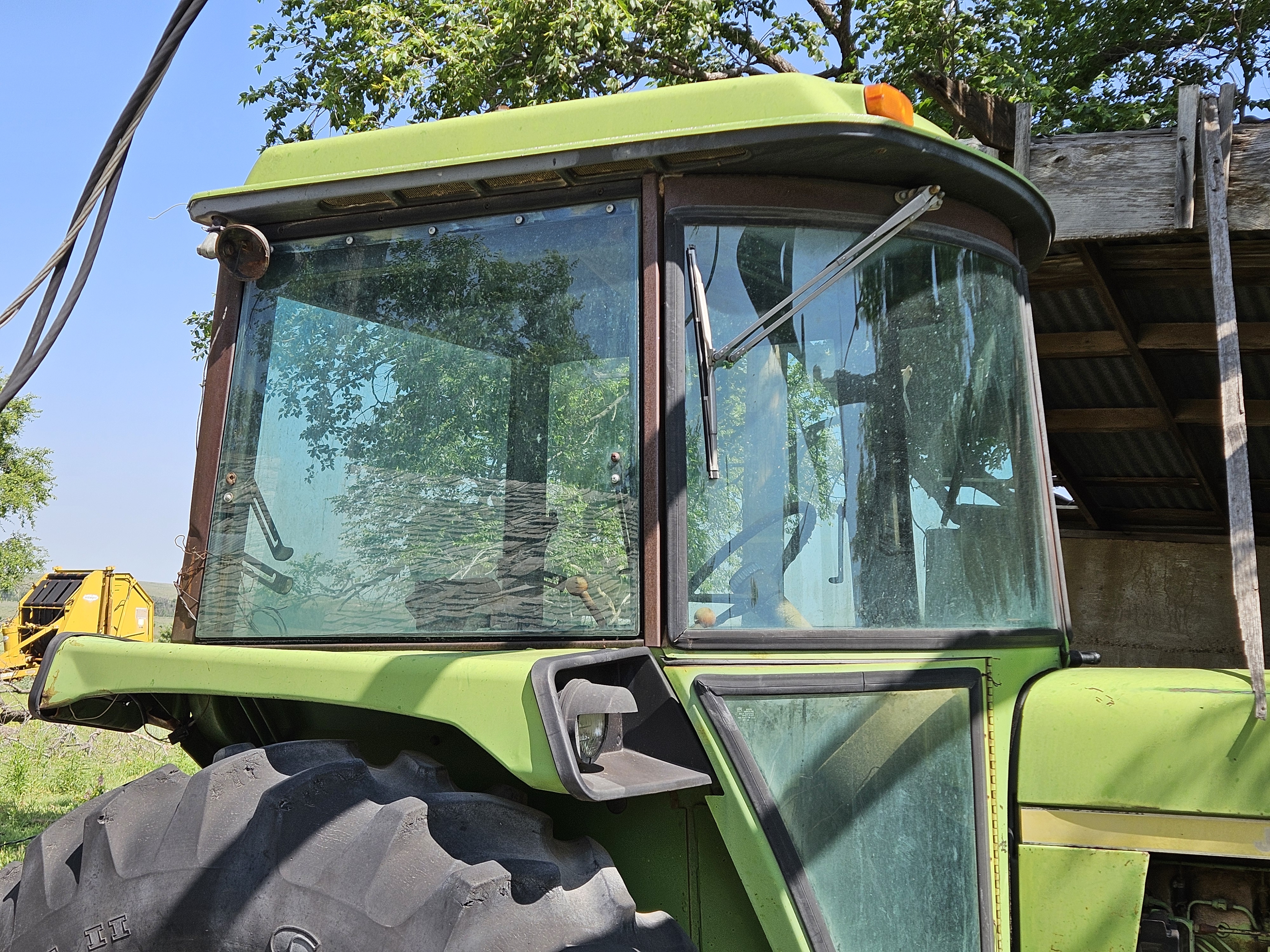

I attended a cousin's funeral last week, in the Texas Panhandle. After the service, we drove out to Grandpa, then my Uncle's, now my cousin's farm. It broke my heart what I saw. The farm house my Dad was raised in needs to be tore down. The brick house my Uncle built in the 1980s needs to be gutted and redone, because of vandals. But what really broke my heart was seeing the 1973 JD 4230, bought new, sitting in it's shed, the roof blown off around it and hadn't moved in 12-13 years. I waited a day after getting back home to talk to my cousin. We agreed I could have it for $5,000. Grandpa had a D Model I wanted, but Uncle Woody (yes, that was his name) traded it in on the 4230. Sentimental value, to me, is priceless. Only problem it is 580 miles from me. Question I have, should I put a new battery in, check fluids for ugly colors and smells, hit it with some either, after cleaning or replacing the air filter...............and try to crank it up to drive it onto my trailer? Or, since it hasn't ran in 12 or more years, just get it to roll and winch it onto my trailer?

Looks like a good find. Keep us up to date how the starting or loading process goes. Will you try soon?

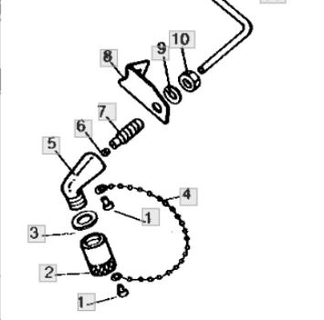

Unless modified it uses 2 - 6volt battery in series. I would avoid either at all cost and if electric available plug in the block heater and get here good and hot. Put a battery charger on her in case it takes several attempts to get it to start. Only boost from the starter on 12 volts. I would also replace the fuel filter and check the air filter

IMHO any amount of starting fluid that doesn't pass through the starting fluid port on the dash is TOO MUCH. Starting fluid adapter has a built in orifice that limits amount of starting fluid that can enter engine at one time.
I always attempt to start engine without utilizing starting fluid. Piston rings & piston lands have been damaged by using too much starting fluid.
I suggest to change fuel filter then check for good fuel flow from tank tom inj pump. If installing batteries I suggest to change to either one group 31 or two 12 volt batteries attached in parallel if tractor still has two 6 volt batteries attached in series to yield 12 volts.

Just talked to my cousin. He says he will look for the manuals when he goes (50 miles) up there to mow. He says he thinks there is one 12 volt battery. Is it located under the step on the left side? He says he remembers shooting ether into the air filter. He doesn't remember a port on the dash. Guess that is why they added a step forward of the JD steps in the photo.
