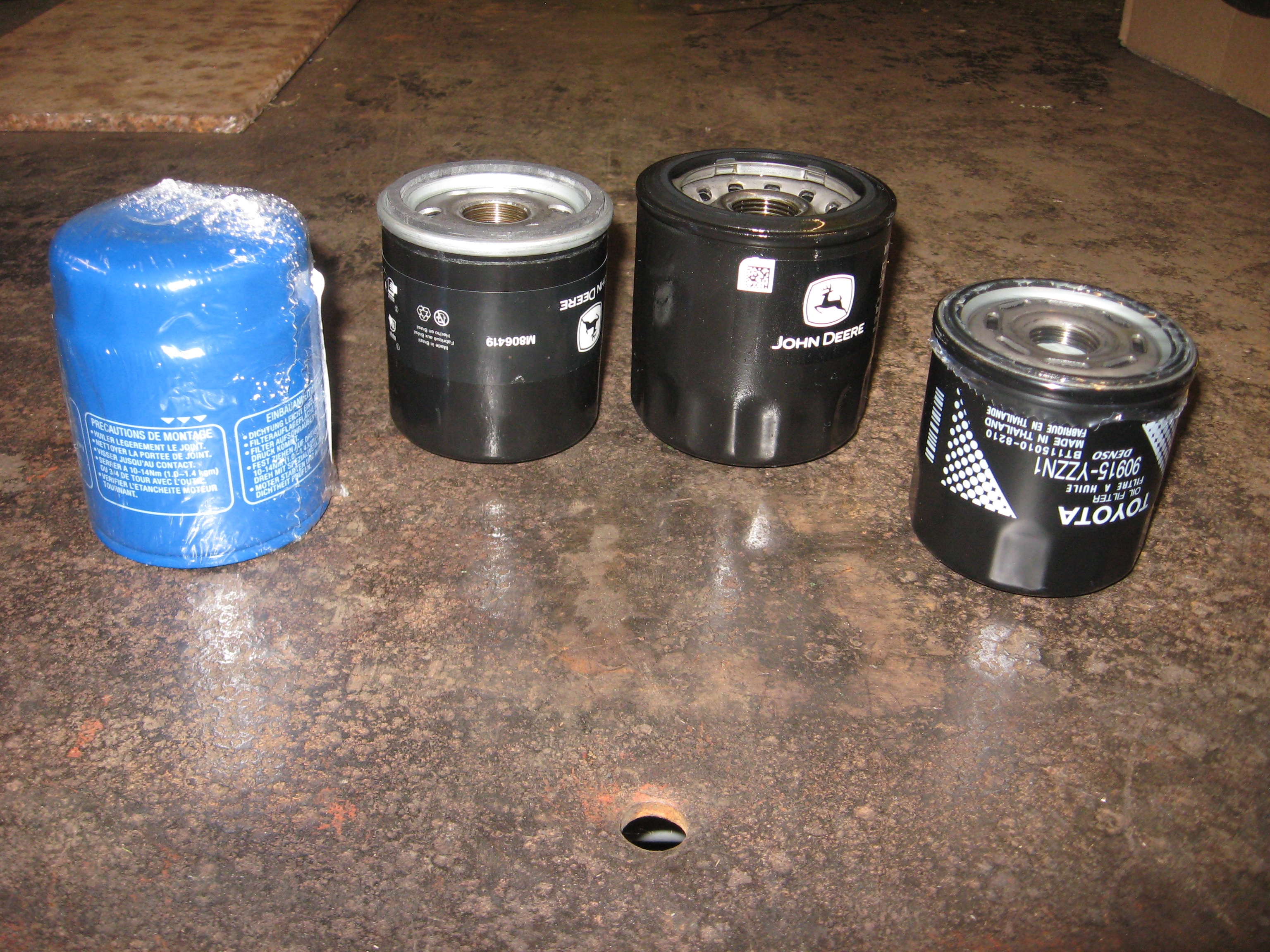

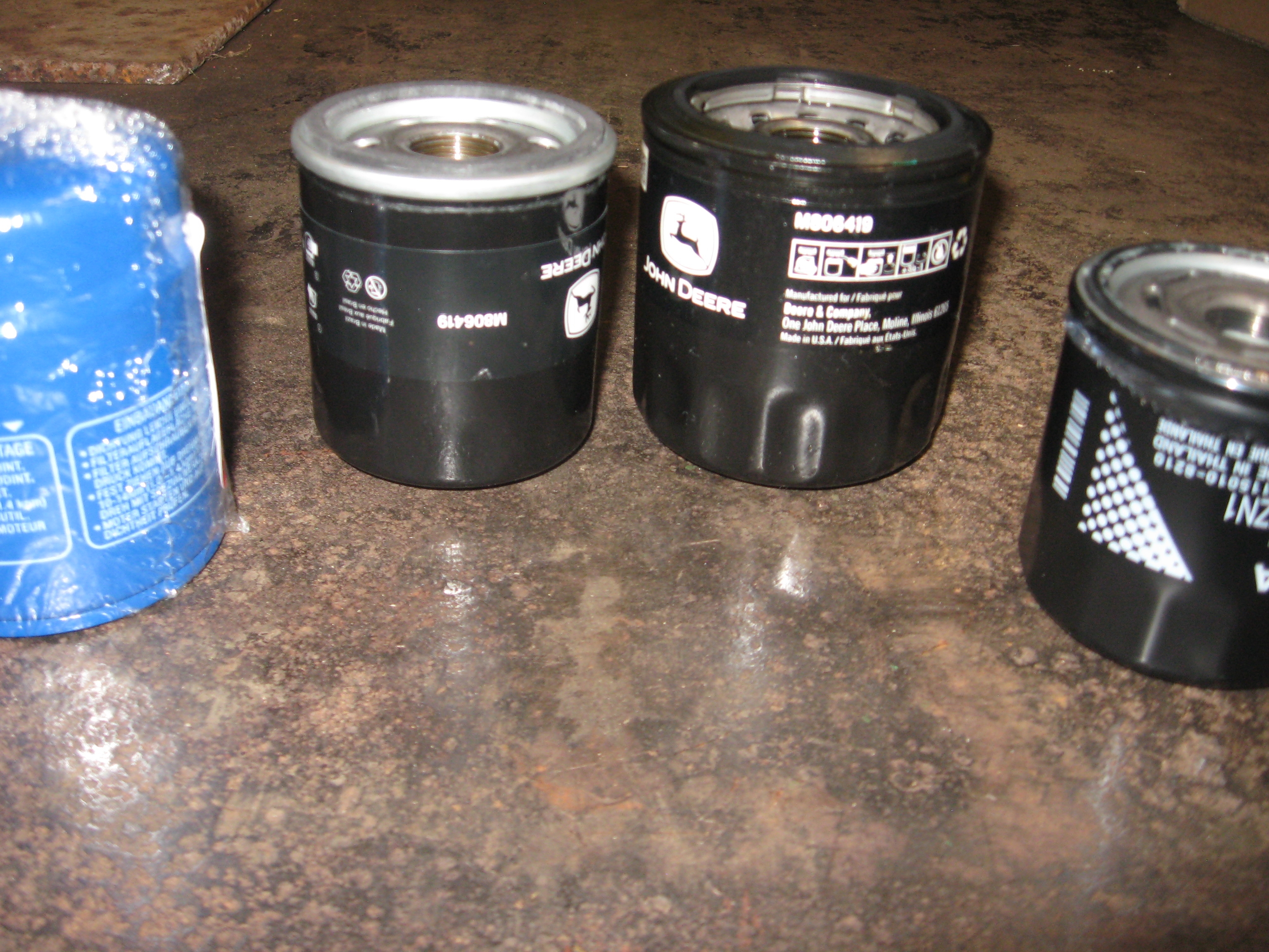

Noticed that JD changed the design of the oil filters for the 2520 when I did my annual oil change the other day. This is the same old part number they've had since 2007 (M806419), but now the filter is smaller. Looks more like what you might find for a Honda or Toyota. Usually, they do it the other way around, i.e., the part stays the same but the part number changes. I guess the new smaller one will work OK since they are selling it for the same purpose. See attached pics of old, new and a couple of car filters for comparison. Thread and gasket size are the same.

I asked the parts manager for my local Deere dealer about this last year, when I'd noticed the same. He said Deere changed manufacturers for these filters in 2024, and you're just seeing the new ones push through the system as the old are flushed out of stock. Same spec's, just slight differences in canning.
The only frustrating poing, whenever a supplier does this, is sometimes the filter socket-type wrenches you already bought to reach a difficult place no longer fit the new can.
I believe most of Deere's filters and fluids are made by contract manufacturers, to Deere spec's. I wouldn't be surprised if they solicit competing bids every few years, and then hop to a new CM when it's deemed the savings are worth the time, effort, and customer blowback that always comes with switching CM's on a consumer product.

I wasn't too terribly worried about it since it was obviously made to fit on the block the same and because it's as big as the ones used in my 4 cylinder cars.
Definitely did a double-take and re-checked the part number though. I (rightly or wrongly) like to give the new filter just a little extra twist with a filter wrench (or strap wrench) when installing, so had to go back to the tool box and get a smaller one.
