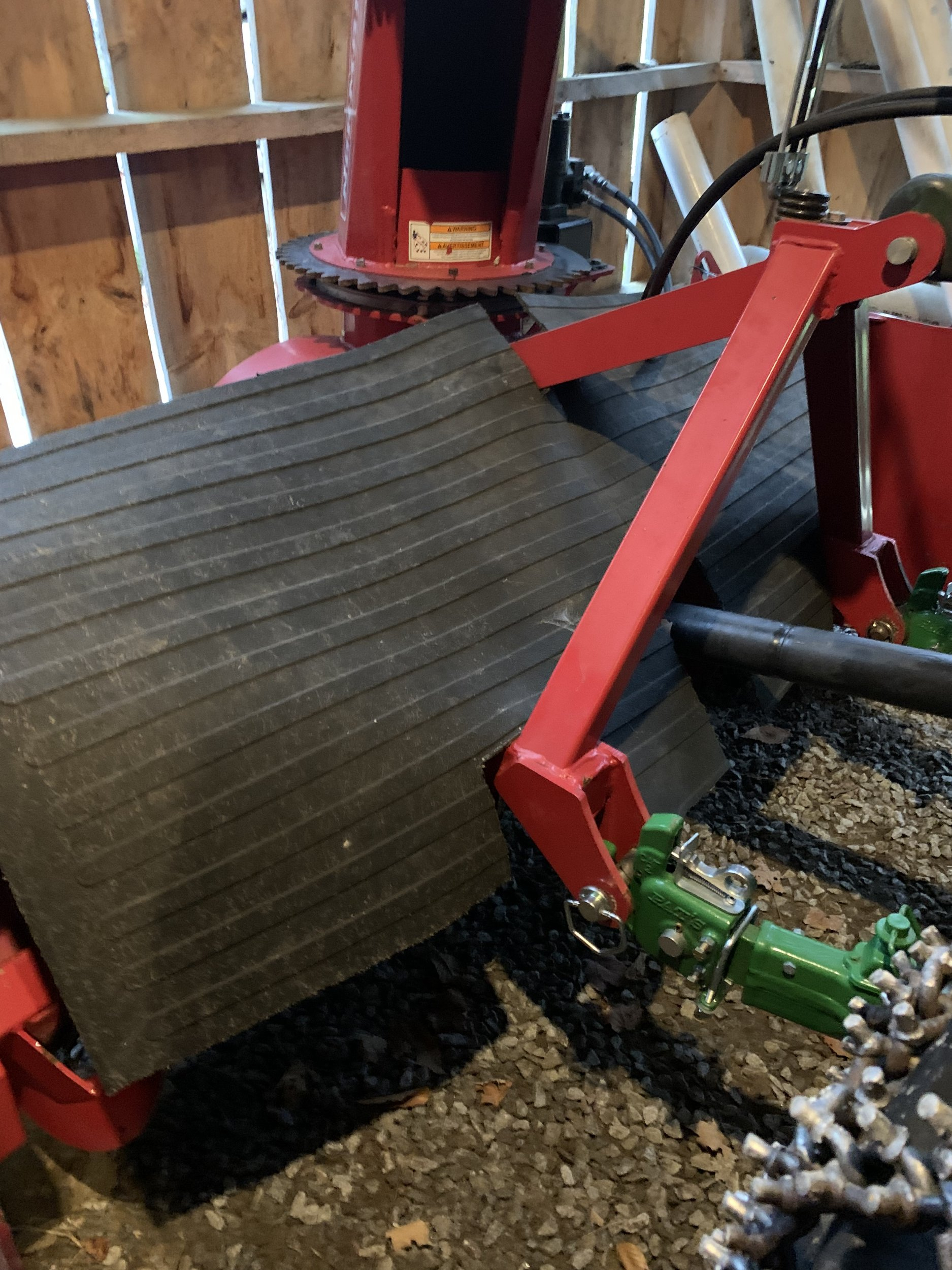

I have to blow out class four road. It’s roughly a half mile or more and has granite rock in it as well as gravel. I keep the feet all the way down but it still picks up rocks in early season. The rocks were beating up my three point and more importantly bouncing off the glass. I decided before busting out a $500 window I should do something.
I had on old bed mat kicking around. I cut it up and have it held in place with cable ties. No more rocks beating up the rear of my tractor or bouncing them off the window.
Once I have a good base down, I cut the ties and remove the mat. I’m usually good all the way to spring.
I hope this might help someone out?
