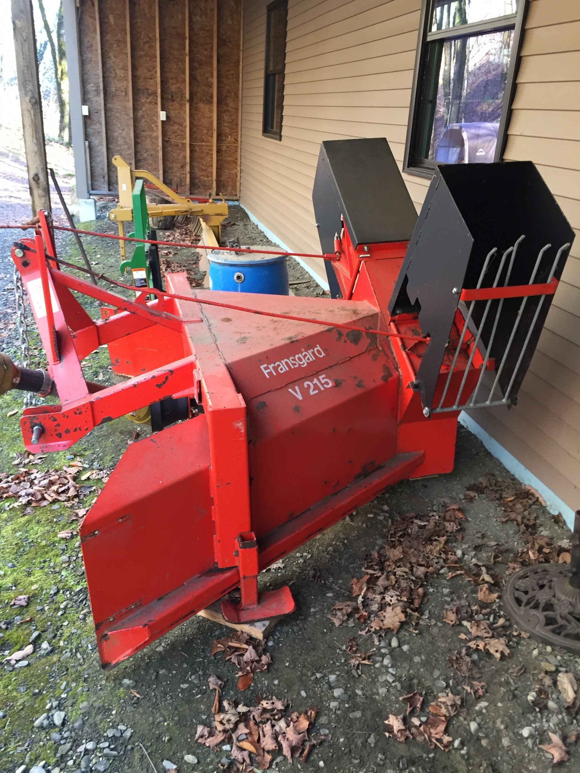

Unfortunately I have not. The other two inverted blowers I owned before the Normand were V style types. They were a snow way( I think) and a Fransgard. They both worked good but the Normand out performs them in manny ways.
The Fransgard only had a 24” fan and my Normand has a 28” fan. That alone makes a big difference. The Fransgard was 84” wide and the Normand is 92”. I personally thing the auger takes a lot of air out of the freshly fallen snow so the machine can process it quicker.

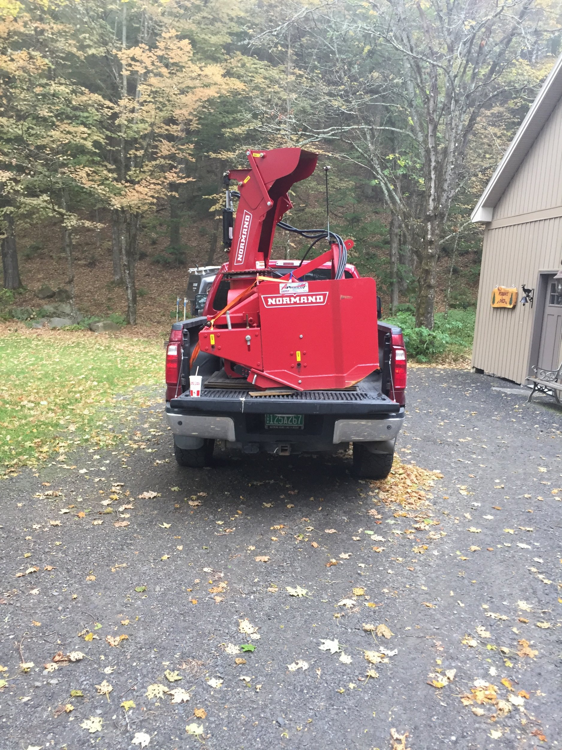

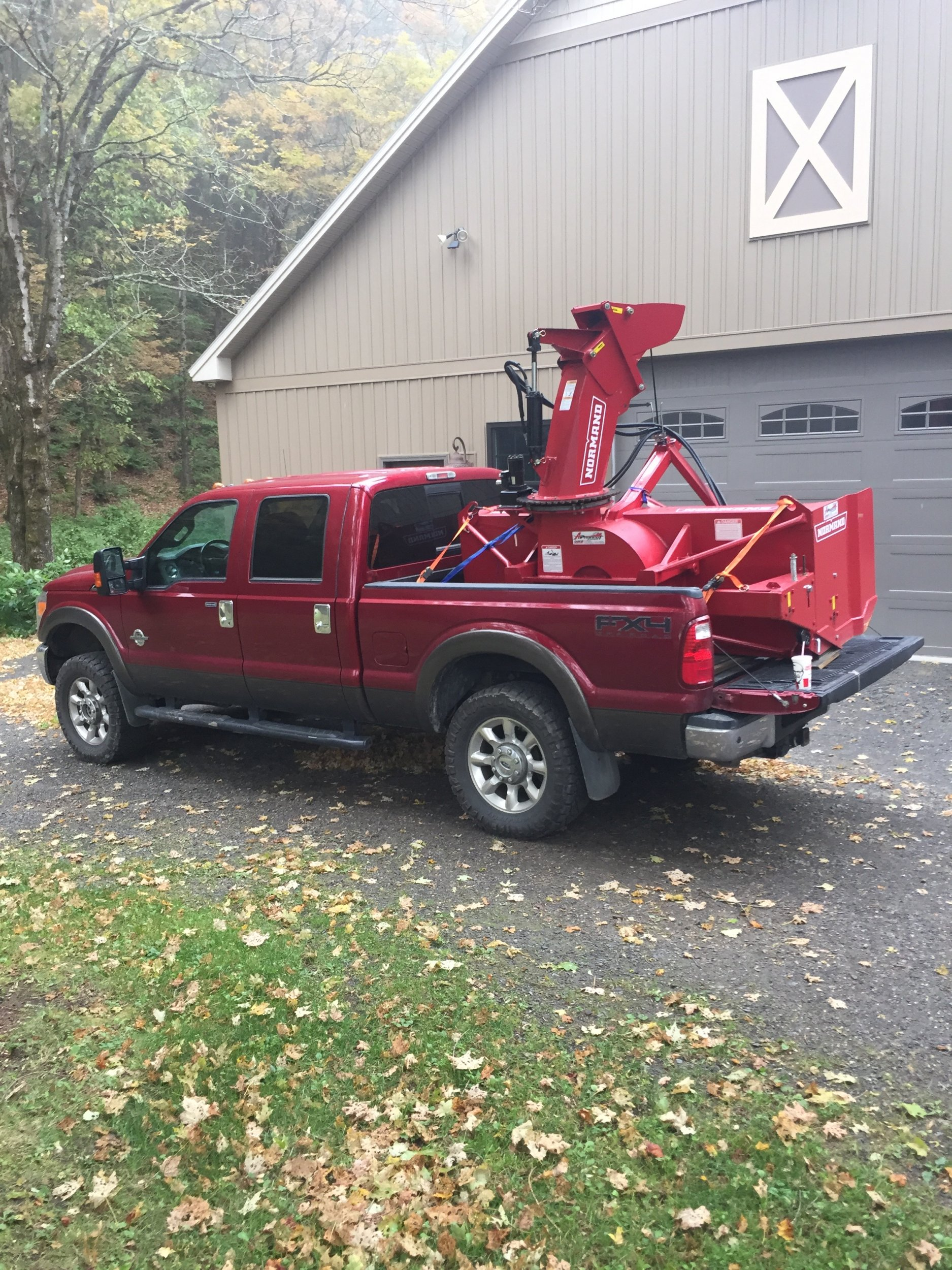

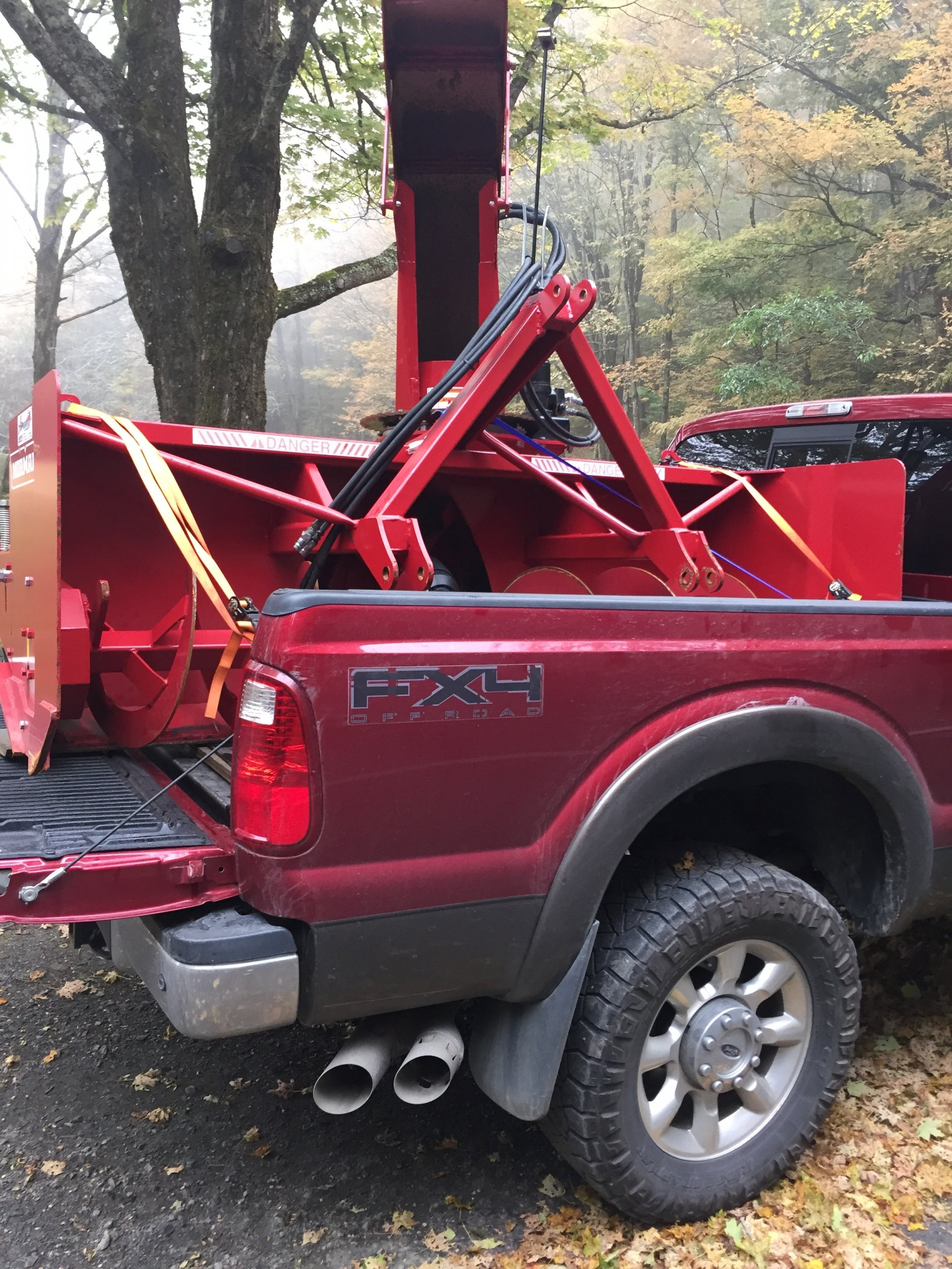

Just for giggles, don’t let anyone tell you these won’t fit in a pickup!
I went to Canada and got this one with 4 hours on it in 2018.
/ Inverted Snow Blower #88
That Blower almost makes the truck look small!
The dealer there did not think it would fit either! I have a friend with a John Deere like mine and he got a beat up Pronovost 92” inverted blower. He gave it a total restoration and new paint( John Deere colors) , I measured his to make sure it would fit before going up north 4 hours to get mine.
That’s the only reason I knew it would fit!

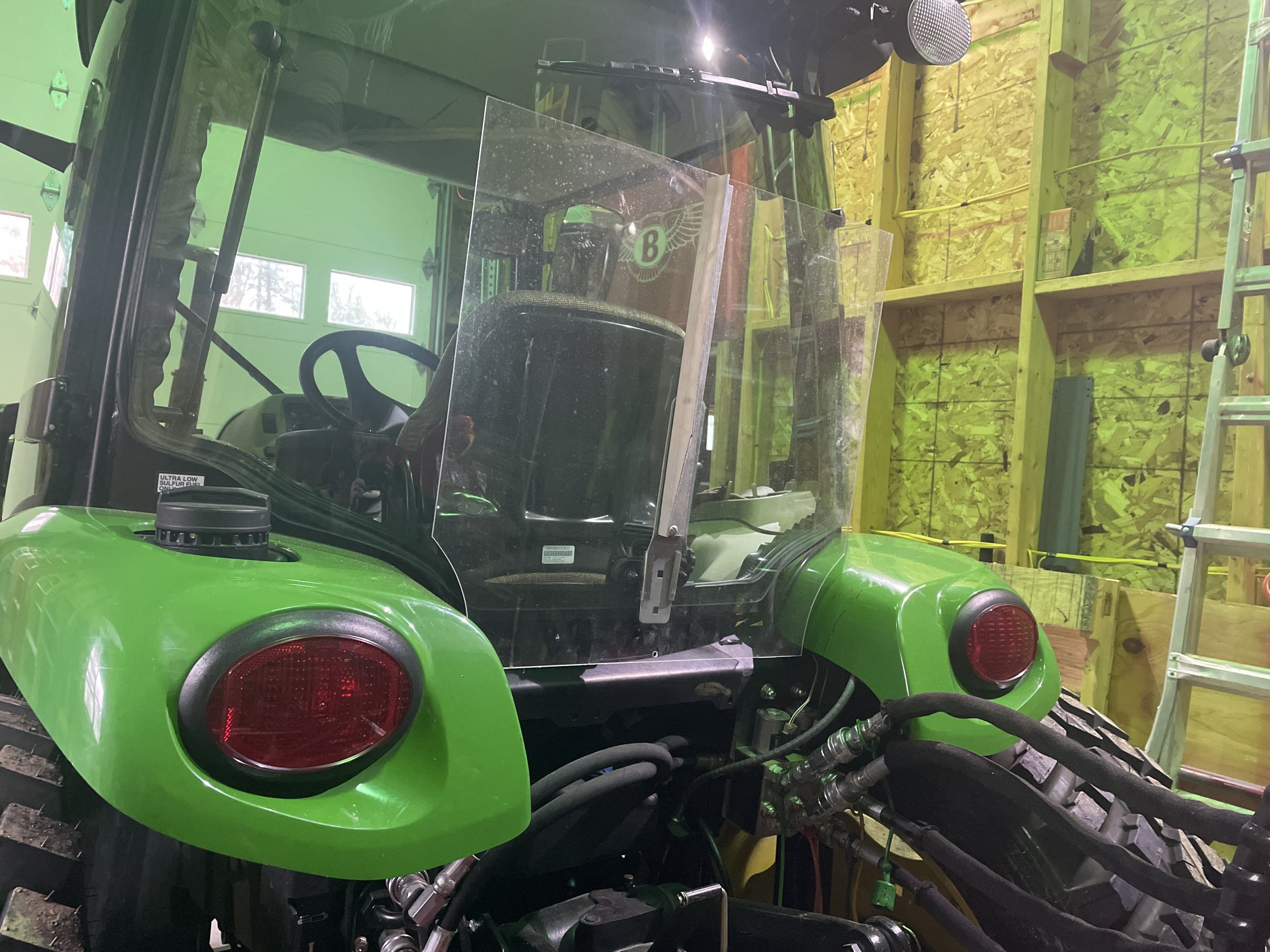

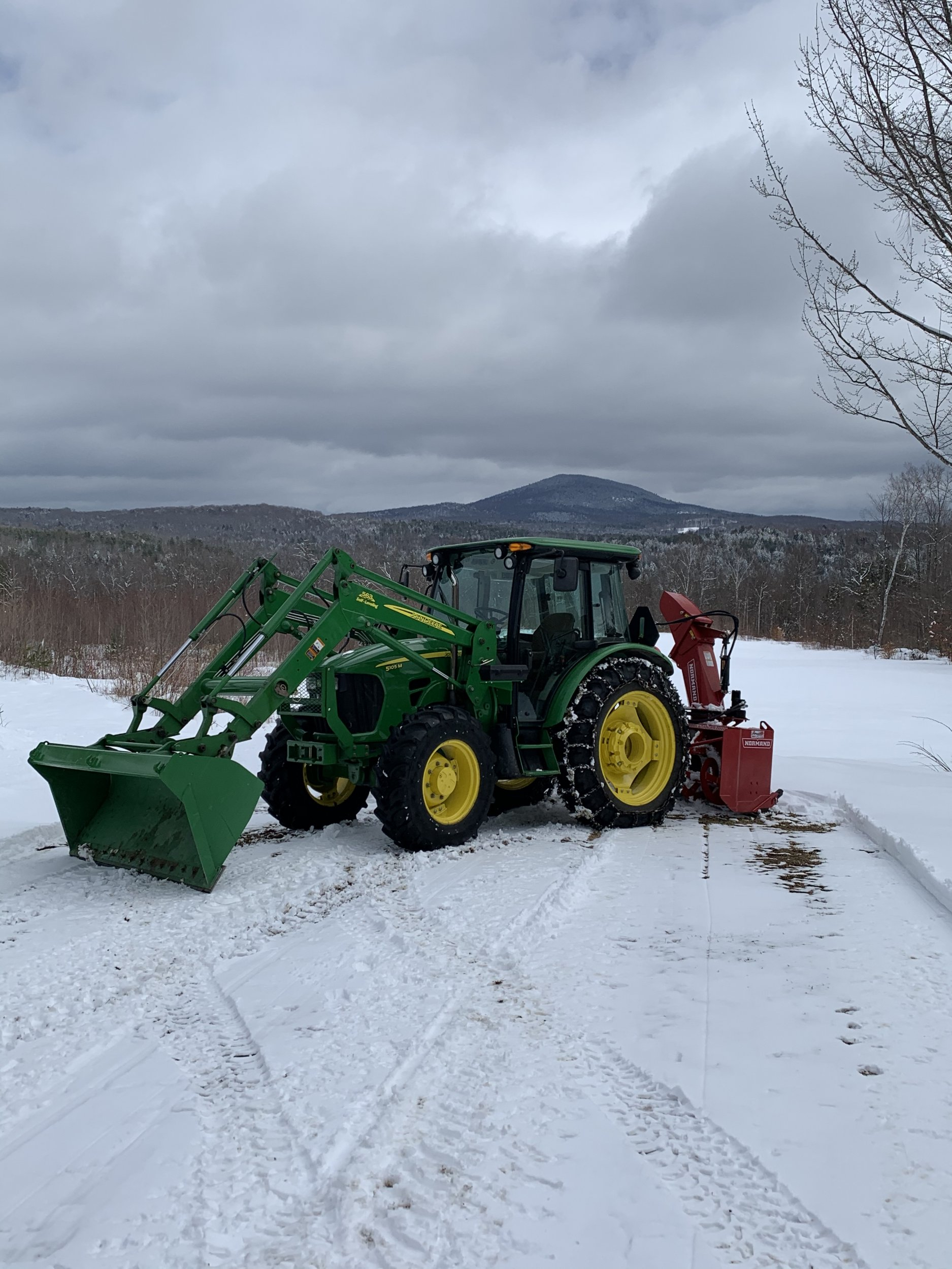

I hear ya on the window protection with an inverted blower and a dirt driveway. I’m rather sure the curved glass don’t come cheap from JD Parts. 😂
I bought the slow vehicle frame for the slot and added 1/8” Lexan scribed around the fenders and a aluminum angle stiffener and nothing hits the glass anymore.

There have been a few times I have accidently blasted my rear window, getting the control lever on the hydraulic chute mixed up. I couldn't imagine using this blower in an open station.
Even with the amount of snow that gets pushed towards the cab with the wind would be enough for me, let alone getting blasted in the back of the head! :oops:
