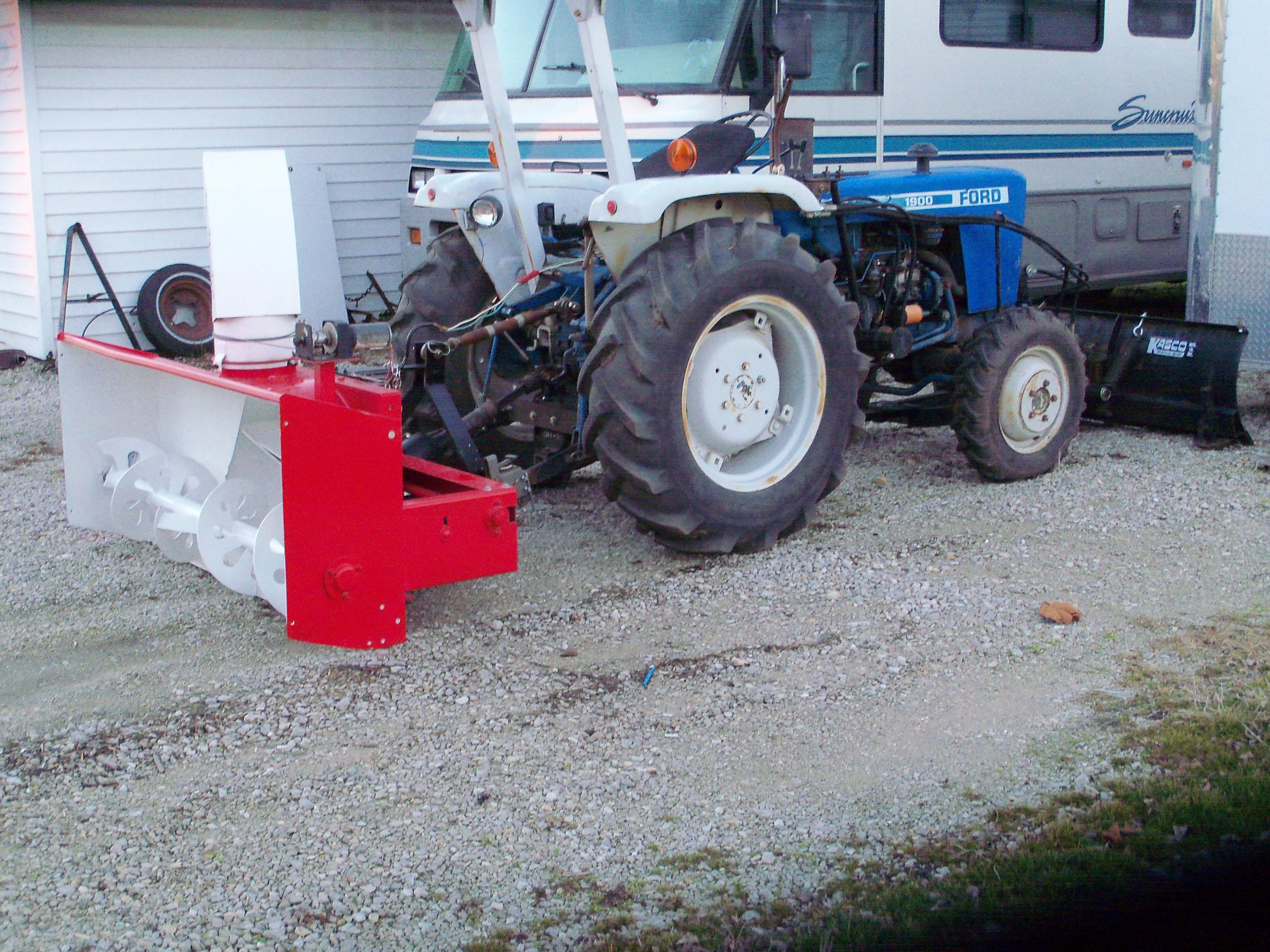

I have 2 snow blowers. I have not used either one yet. I have a 5'6" McKee with a 24" 3 blade impeller on my (29hp) Ford tractor that operates at 540 rpm's. If I did my math correctly this blower will have a discharge velosity of 38 mph. On my Kubota (21hp)I have a 52" with a 16" 4 blade impeller that operates at 1100 rpm's. The discharge velosity on this comes out to 51 mph. Acording to the math the kubota should be the best blower. Am I missing any thing here. It will be interesting to see which one does better. Maby one will do better in wet snow and the other better with powder. We will see if the math lies if it ever snows here.

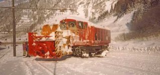

If you want a blower to throw snow a long distance laterally you need one with a rotating drum as shown in the photo. Eliminating the chute from the path of the snow eliminates a lot of friction. There have been small blowers with this feature in the 1970's such as a walk behind by Gravely. I dont know the current market. The rotating drum design is found on more commercial units because it adds to the cost but I think a creative person could modify a blower to build in this feature.
Dave M7040

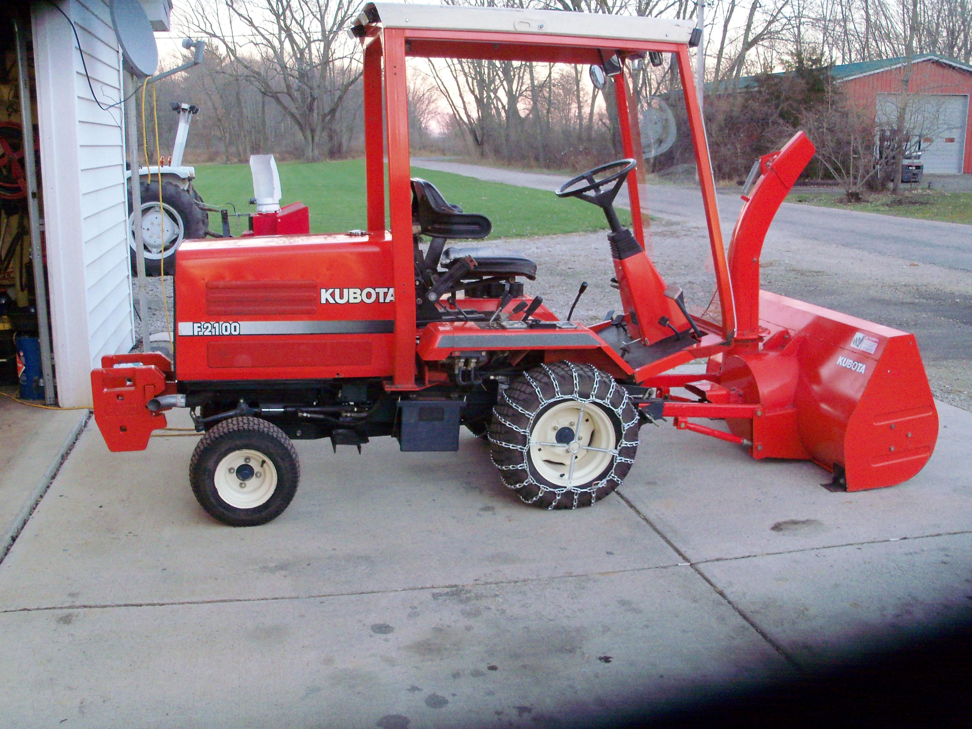

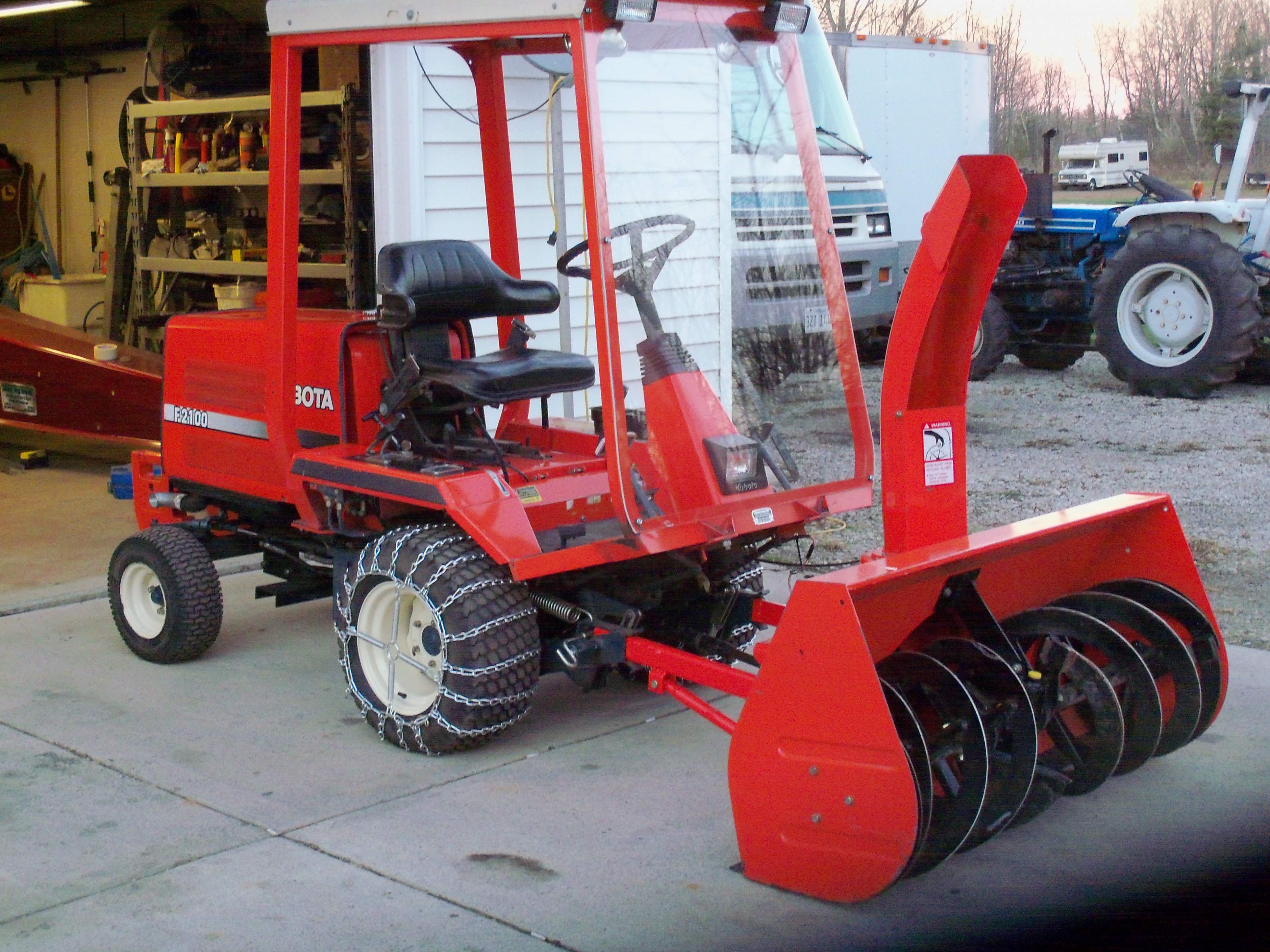

I hope the Kubota does as well as I am hoping. The front mount will make my life a lot easier. here are some pics.100_0479.jpg100_0480.jpg100_0481.jpg100_0482.jpg
/ In theory which blower would be better #14
IMHO front mount blowers are safer and easier on the body. (No twisting around to see where you are going.)
