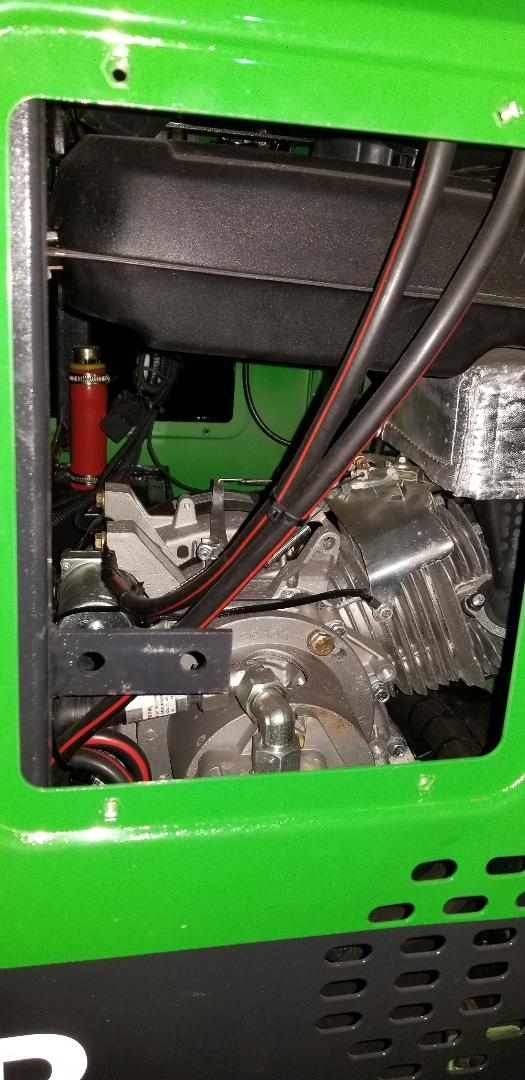

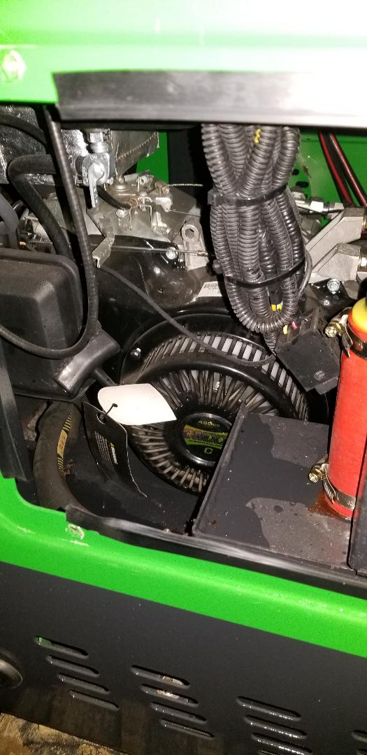

Hey Folks , got some pics for you.

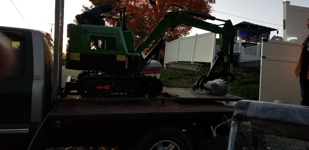

Made it back without incident. 5 1/2 hours each way. My assessment of AGT Industrial/ Agrotk is not a bad machine for the price of a zero turn mower. I'm sending pics that I hope will help others.

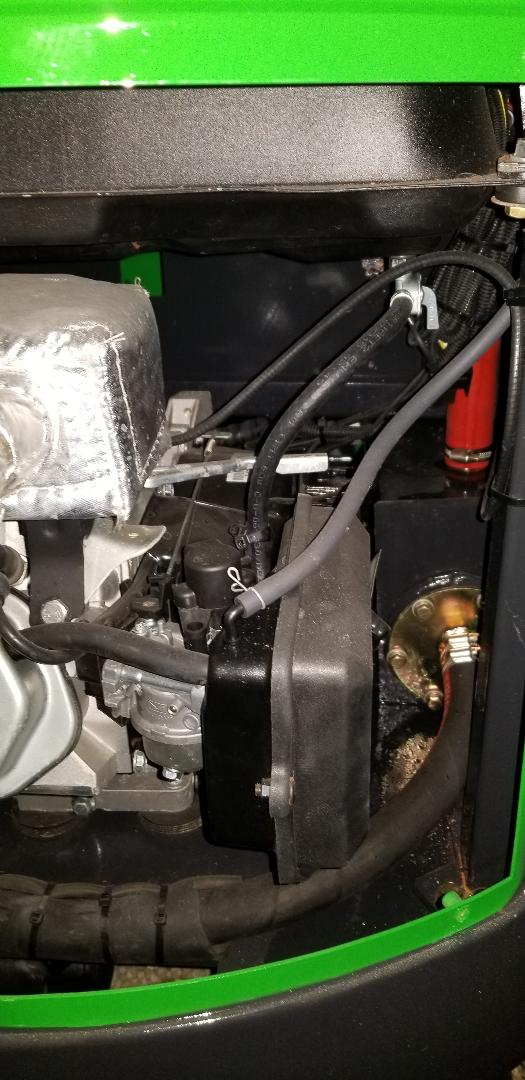

I wondered why the trailer floor was covered in oil. I removed the cover plate/floor of the machine and found this.
/ Importing and modifying a new mini excavator from China #430
Didn't take long to figure this one out. Oh! Thats where that goes.Of course , easier to fill the hydraulic tanks on multiple machines by zipping off the tops.

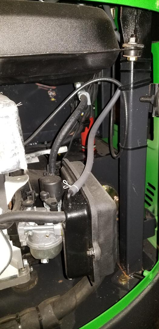

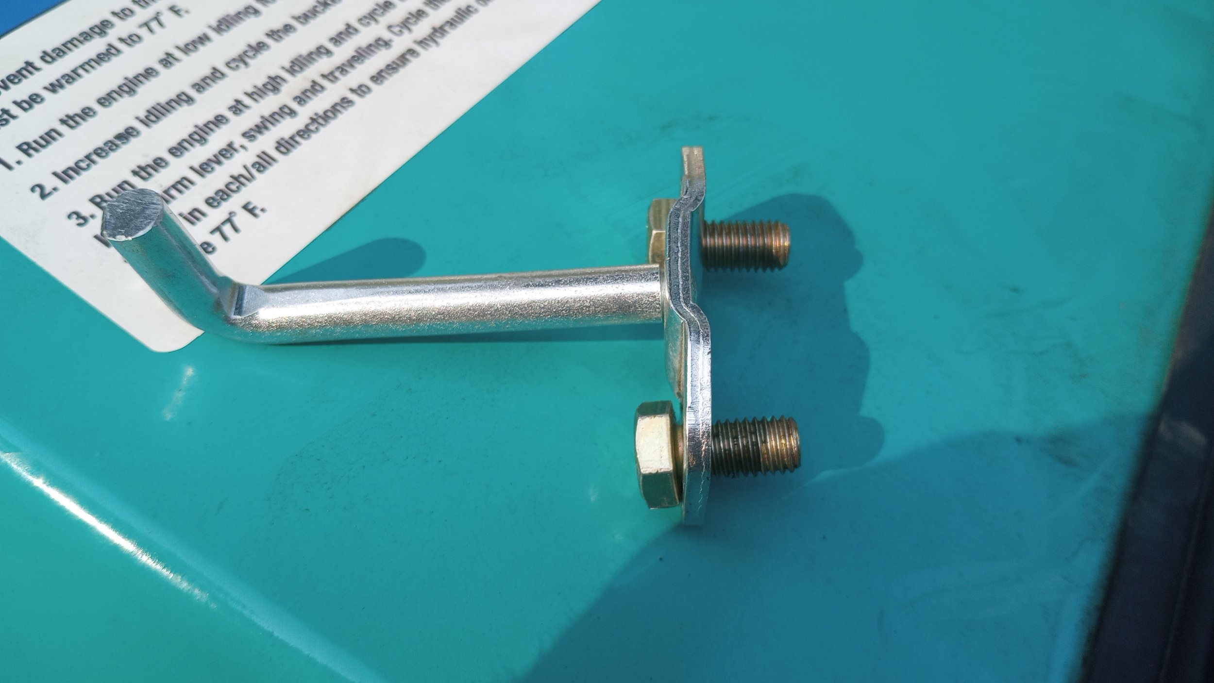

Found the engine house latch sans nuts. This thing just sat there for G** only knows how many thousands of miles . I went over every nut , bolt , and Hydraulic fitting on the machine before even starting it again.

Found the engine house latch sans nuts. This thing just sat there for G** only knows how many thousands of miles . I went over every nut , bolt , and Hydraulic fitting on the machine before even starting it again.View attachment 803669
Reminds me when I got my Jinma tractor. I still have parts that I found and stashed away and never found out what they were for since 2007.
I think they had shop clean up day when they packed my tractor up and threw all the leftover stuff in my crate.

Hey Folks , got some pics for you.View attachment 803641
Nice machine, I like the engine cover access better on that style than standin on my head to check the oil on my style (toaster green also).
I have only seen pictures of that style, but didn't see a filter in the pictures, but I might have seen a Cooler, is there either?
