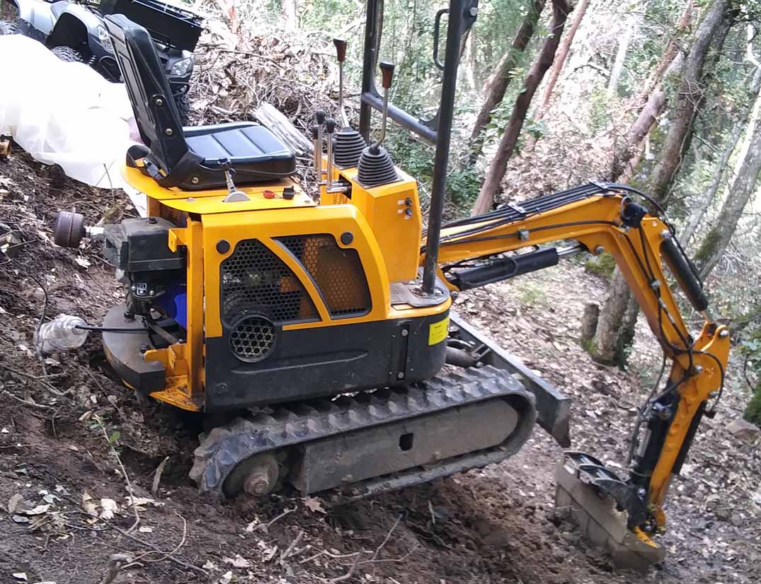

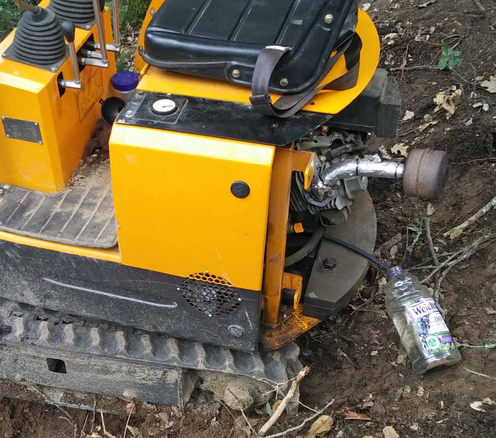

Instead, I will show how I do a field oil change on my XN08. It was at about 90h when I did this, which is about 25h since the last change. These Chonda thumpers have no oil filtration so it's best to change often.
I wish it was easier. I love the remote oil change tubes on some small power equipment. There was no easy way to install such on this machine, tho I really wanted to.
So, what I do is put the machine on a slope, tip it up far enough so no oil will come out of the drain hole. Then I turn off the engine, remove the plug, and push in a temporary rubber hose. Then I start the engine, and tip it up the other way. With the engine off again, I put the hose into a collection bottle, and let it drain. These motors take only a bit over a quart.
In one photo, I show how steep this slope is with a level (at level) on the tracks.
At 25h, the oil is still pretty clean, but I try not to get it too hot.

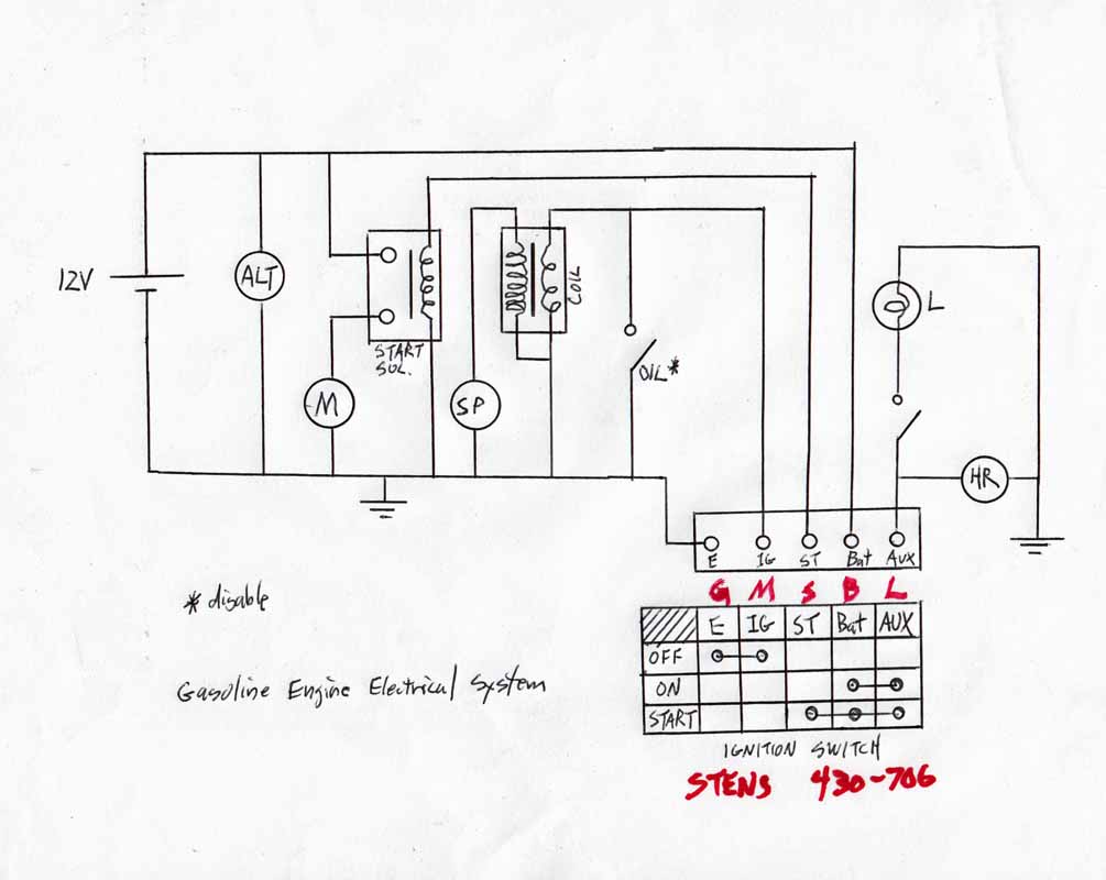

So, I got the last of the 6 black Oking minis in the shop, to be improved before being sold. It has never been used, and I think the electrical system is plain unacceptable as-shipped. I will upgrade it as I did on the one above.
So, I updated my electrical schematic, showing an actual ignition switch you can buy with the right logic. A Stens aftermarket unit intended for lawn tractors. The terminals are marked in red, and also on the back of the switch, which is about $12.

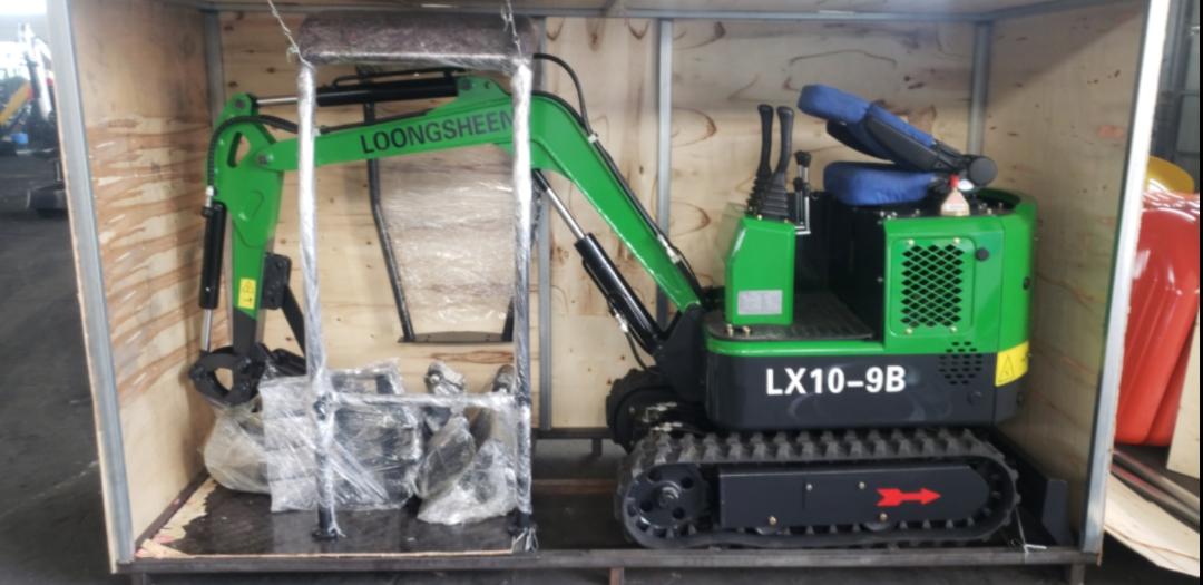

Not sure if this thread is still being followed, but just in case it is. I purchased a Loongsheen 1ton excavator and should be picking it up in the next couple days. Is there anything I should be looking for or planning on changing when I get it other than fluids?
   / Importing and modifying a new mini excavator from China #198
Yes, you should plan on posting a bunch of pictures and process of purchase, etc... :)
Welcome to TBN! :thumbsup:
   / Importing and modifying a new mini excavator from China #199
As for the process it was very easy. The sellers freight forwarder handled the shipping to Pittsburgh, my customs agent handled all the paperwork, and I'm stuck trying to be as patient as possible to pick it up.
