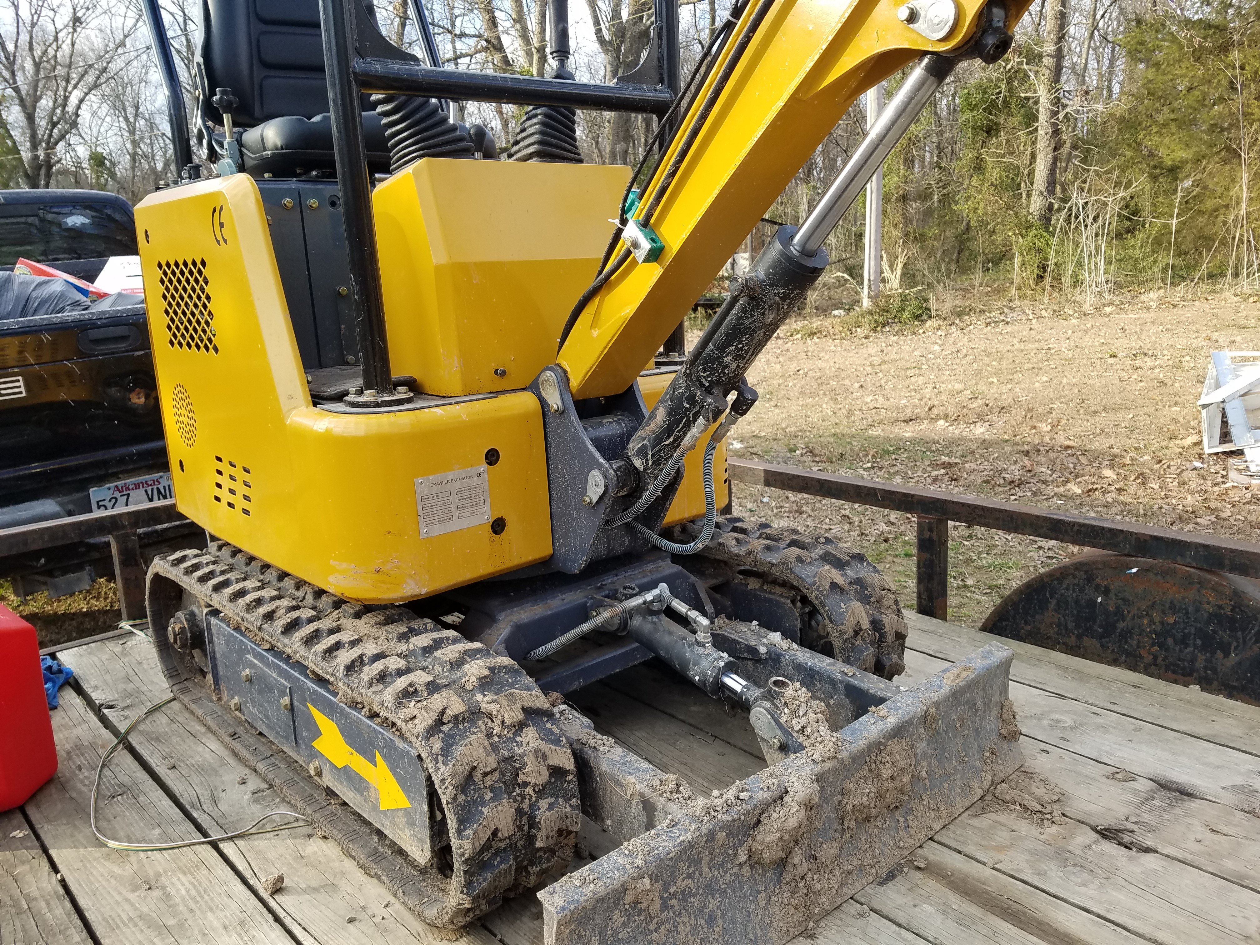

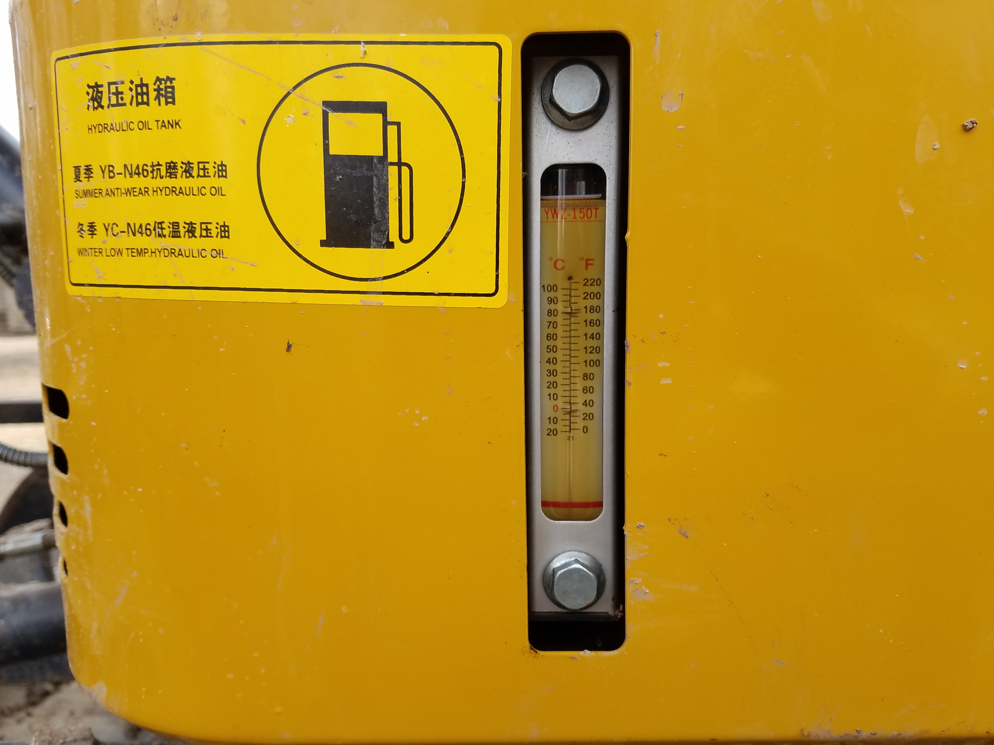

Yes it's a hightop came with a Briggs 420cc sending pics to PC now will post asap.
I can see already that your hyd oil tank is in a different location, and I imagine you have a short fill tube, causing your problem. Often, when they make a design change, the consequences are not fully anticipated.
The new passive temp gauge inside the sight glass is nice, but you can not see it while operating. The one I installed is also passive, but it has a gauge near the left side console. At least it now has a temp gauge! I changed my hyd oil within a few hours of first operation, and you should do so with the engine as well. I plan engine oil changes about every 25-30 hours after the first one.

Why did you change hydraulic oil so soon? Yes I have had rear body panel off. They actually did not install a choke for some dumb reason so I added my own. I'm in Northwest Arkansas. I think im gonna try and extend my fill tube. Do you have a picture of yours?

The first fill of hyd fluid has the most dirt and debris from manufacture in there. For tractors, too. I can't believe what I find in there. Also, they use the cheapest crappiest fluid they can get. My first unit had only a suction screen, but I added pressure filtration. I expect to change at maybe 200 hr or so.
See post 31, first photo for my fill/breather tube.

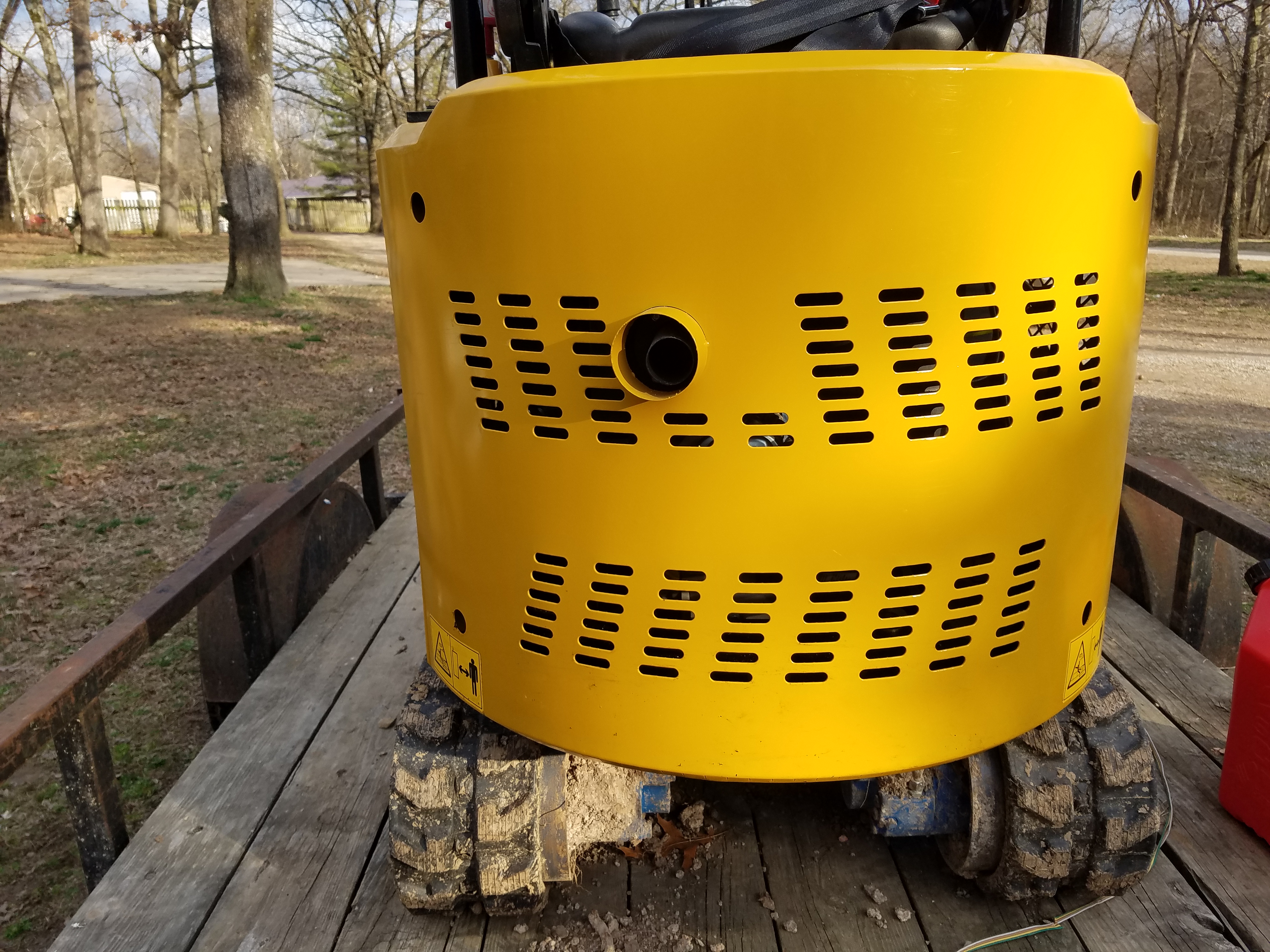

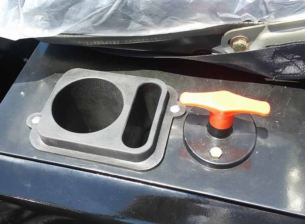

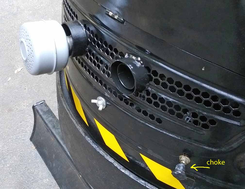

Here is a photo of the choke control that was installed on the newer Oking units. I copied it for my own LCT engine. It consists of a stiff push-pull wire inside a cable housing, similar to what you see on a lawn mower. The end is cut off and a Z-shaped end is bent to fit into a hole on the carb's choke lever. Works well.

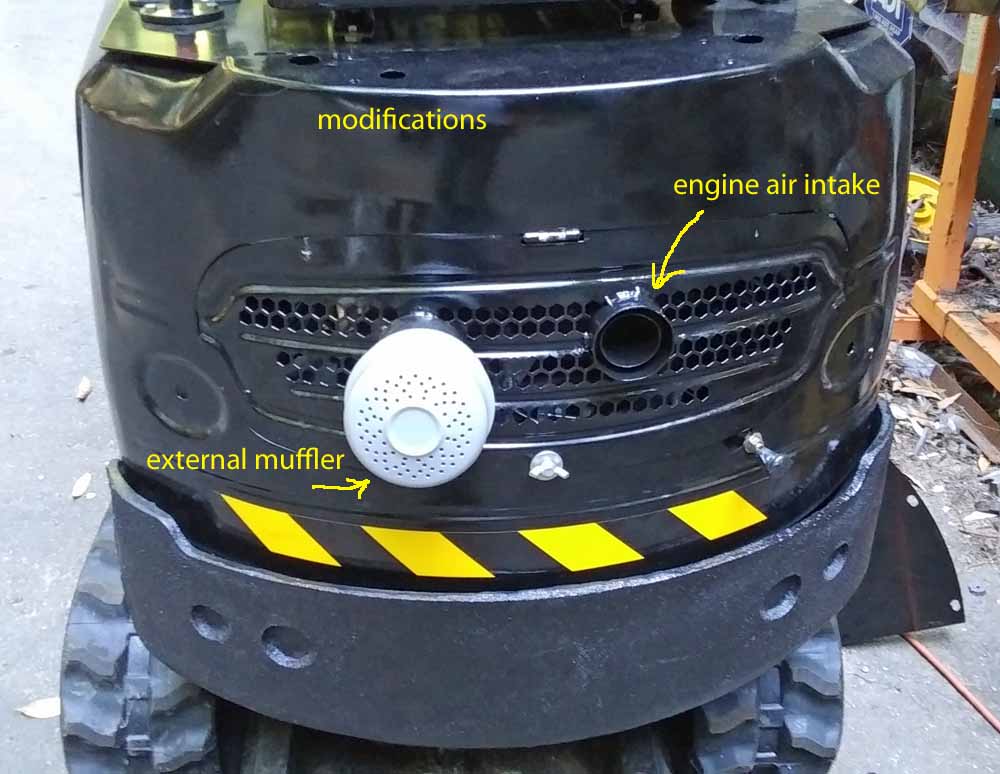

The Oking unit features a small hatch cut into the back body panel, but I do not see much value in it. In my 3rd photo you can see where I added an outside combustion air port, and an external muffler to remove heat from inside the house.
The cupholder and cellphone holder on the Oking units is a nice improvement. All tractors and minis should have it.
BTW, I sold this improved eval unit at my cost ($8500), a few months ago.
Nice.. I need to add a cup holder like you did. My unit had the perfect spot for the choke they just didn't add one, so i did. They had a spot for the diesel oil pressure gauge course i didn't need that but it made it nice adding the choke.
