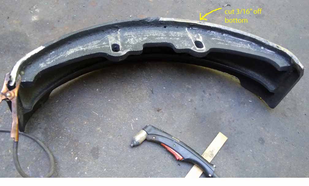

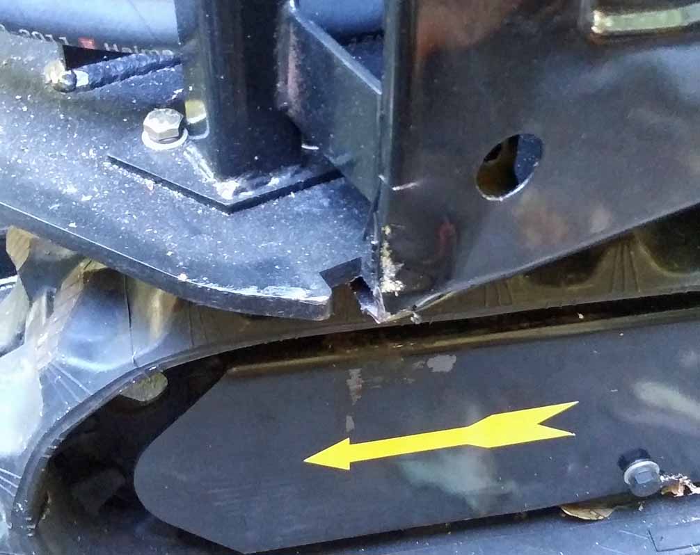

As for the ballast I do have...
The yellow machine has 3 ballast plates, bolted to the 1/2" steel base of the house, for a total of 75#. Not much. The photo shows the rear body panel removed for an in-the-field engine oil change.

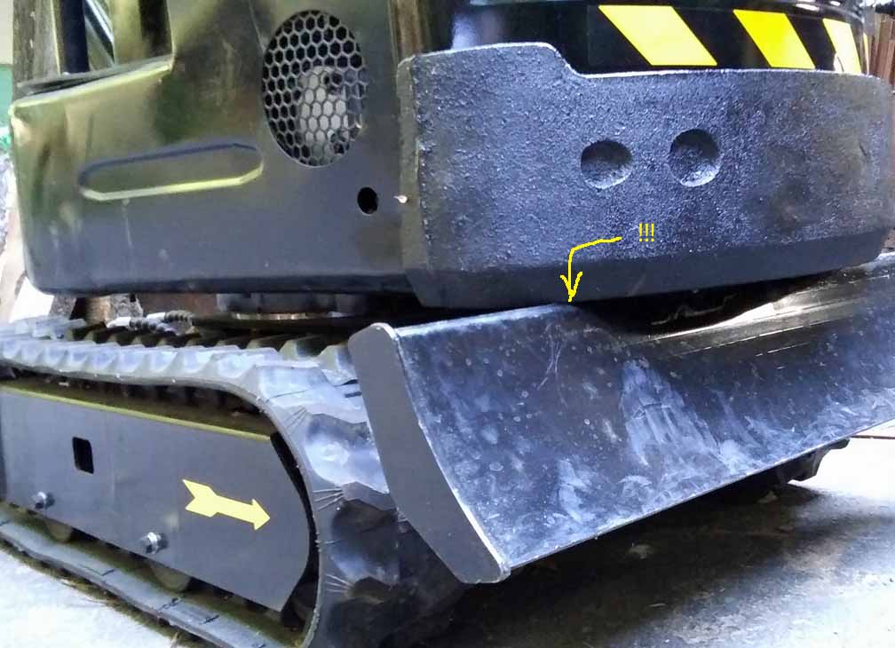

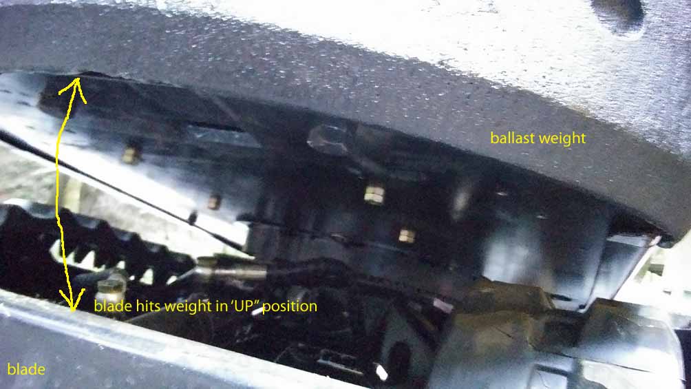

The black machines have a newly-designed external cast steel ballast that is bolted on outside the body panel. It weighs in at about 96#, and hangs out aft a bit more, so has more leverage. Unfortunately, it was not tested, and it interferes with the dozer blade when it is fully up. Fixing that required a bunch of effort with the plasma cutter. I removed about 4 pounds off the lower lip, which you can not see unless you look underneath.

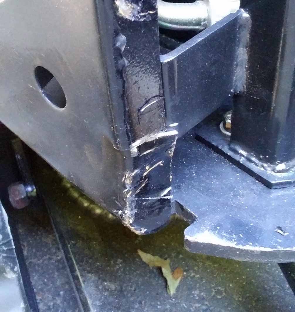

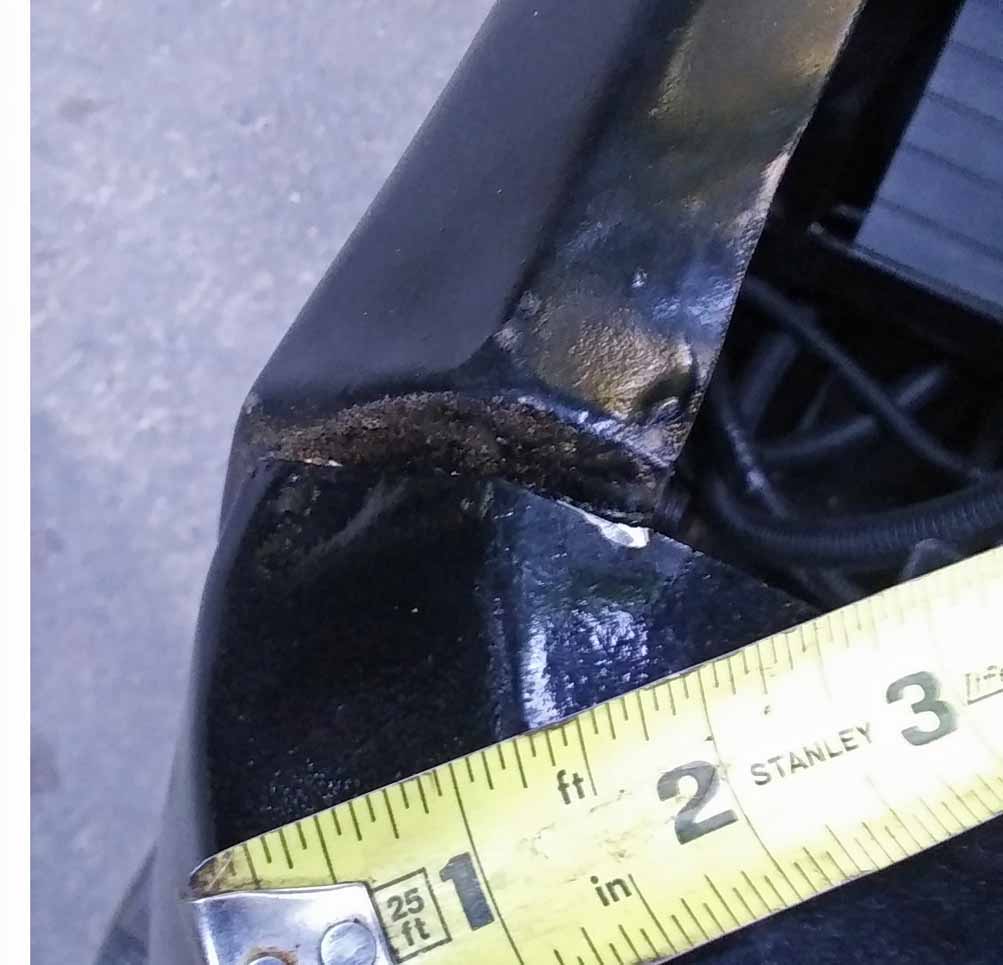

Here are some pix of the body panels on one of the new black minis.
I love the thick formed panels (0.075" thick), but the fit-and-finish of the new units are inferior to my older yellow machine. In fitting the newly-designed ballast casting, Oking adjusted panel interference with a big hammer, it seems. Even on the topside, panel fit was a much as 1/2" off. Rubber bolt hole covers were completely missing. This in no way affects any function, but care in manufacture left a lot of room for improvement. The black paintjob was also poor.

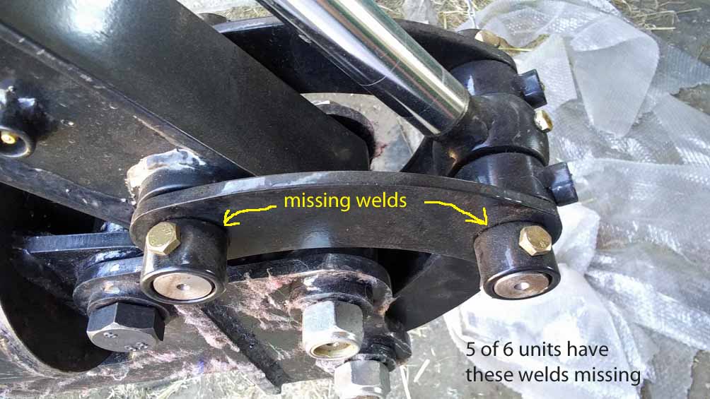

One of the 6 minis that came in the shipment from Oking does not have the bizarre design error I posted earlier (post #76).
The 2 missing welds on one of the bucket kidney links are on all of the machines except one. It is interesting that this obvious error has propagated factory-to-factory. And still, someone corrected one of them, perhaps accidentally.
