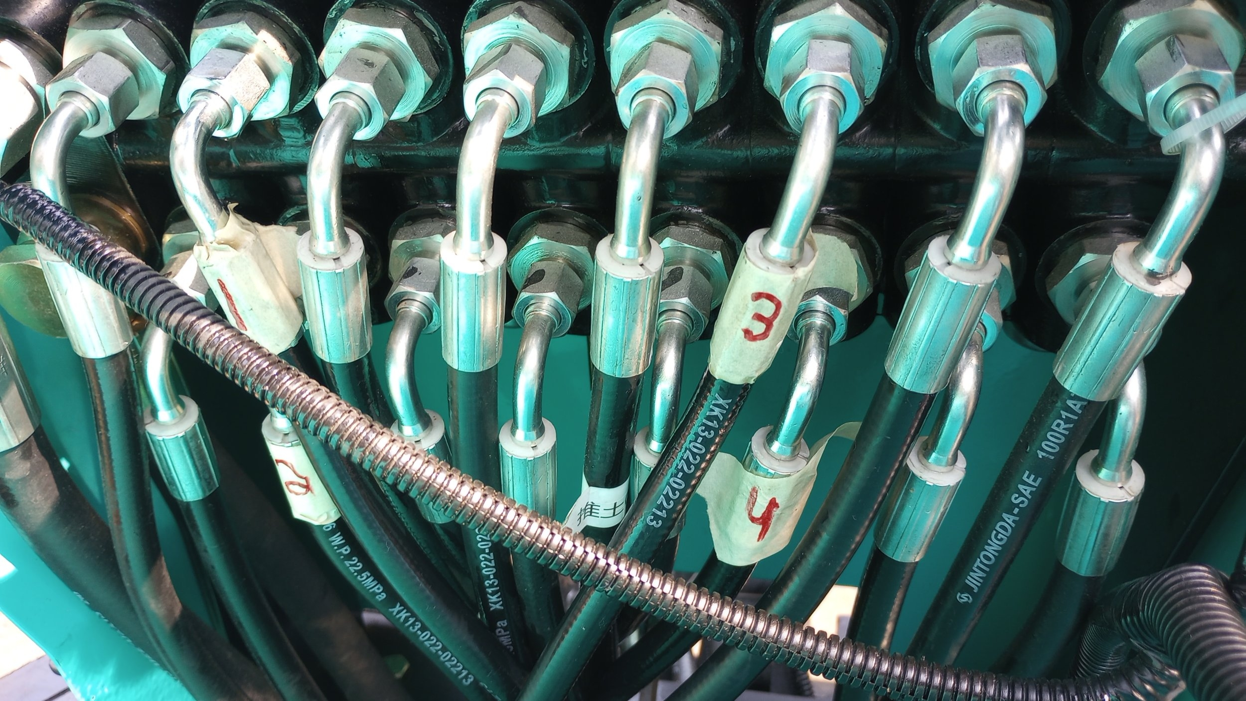

I had gotten Loongsheen and Hightop into a bidding war. They really didn't move much on their price, but Loongsheen kept throwing in attachments for me. I'm happy with my machine can't speak for the Hightop. I would make sure you can get the spin on filter put on there or see if they would use NPTF fittings. From what I can tell so far it's going to take 5 fittings to go from metric to NPTF. Three on the tank side and two on the hose.
