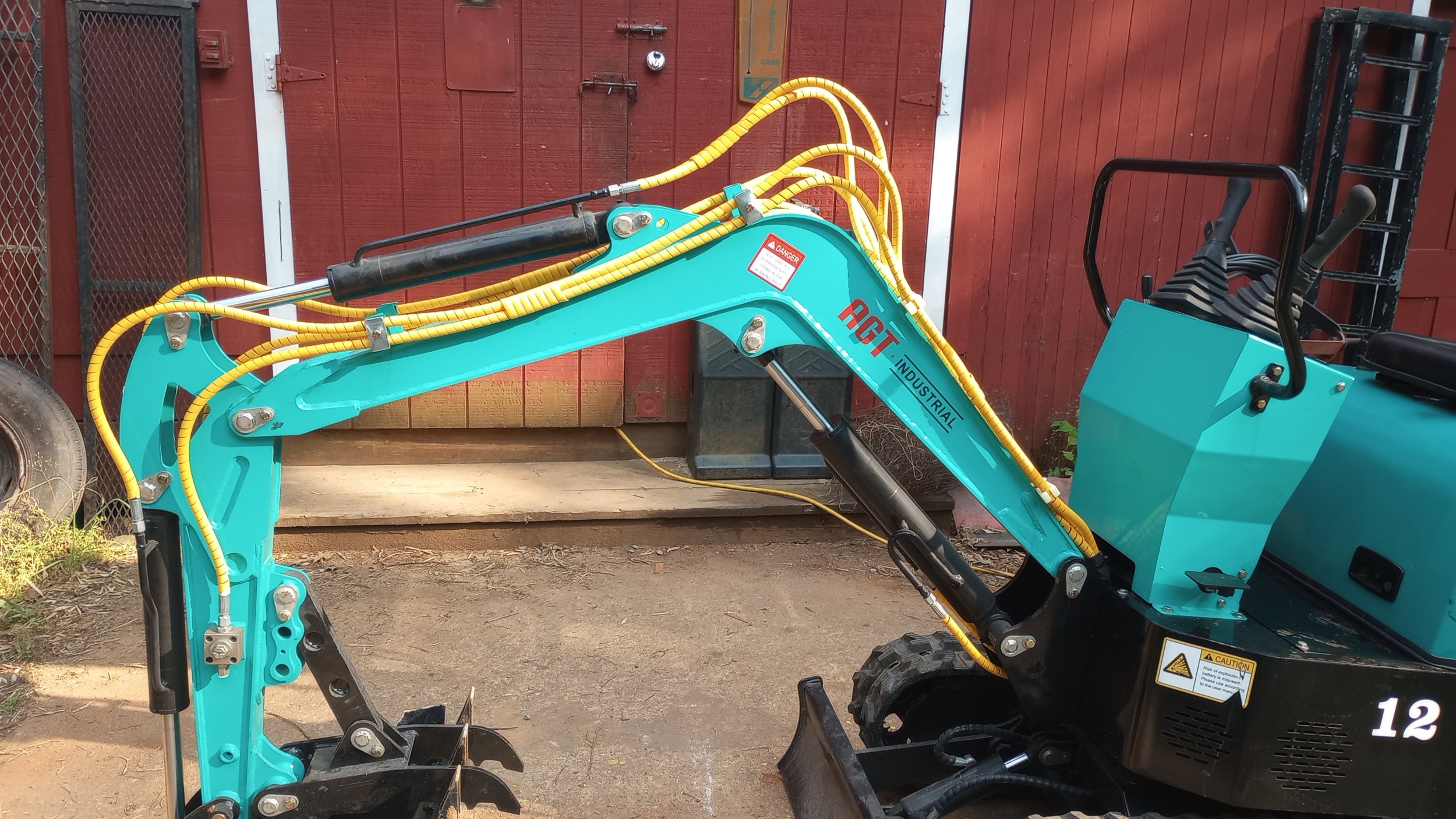

I had gotten Loongsheen and Hightop into a bidding war. They really didn't move much on their price, but Loongsheen kept throwing in attachments for me. I'm happy with my machine can't speak for the Hightop. I would make sure you can get the spin on filter put on there or see if they would use NPTF fittings. From what I can tell so far it's going to take 5 fittings to go from metric to NPTF. Three on the tank side and two on the hose.

I talk about the spares I bought the first time, and then the second. For sure, hoses and tracks, in addition to the attachments you want.
I do wish that I had purchased seal kits for the cylinders. Buying parts after the fact is problematic if you can not go thru Alibaba. You are forced to wire funds, since you can not open a Chinese bank acct.
BTW, one guy I know in the UK has had to re-seal the wheel motors on a unit that has no hydraulic pressure filtration. His spool valves are also getting a little "sticky".

I did not buy seals from China, since I had no reasonable way to pay. I was quoted 4 kits at only $60, shipped DHL. I buy most of my seals by size from Hercules. I just finished a Kubota loader cylinder re-seal, and I might have taken an hour to do it. I do boil the piston main seal in water and clamp it to cool. My XN08 bkt cylinder leaks but not enough to be an emergency.
I see base prices for 1T minis ranging from $3500-5000, FOB Qingdao. There are differences between units: engine, Hyd oil filter, hyd oil cooler, etc. I see that Xiniu has upgraded the XN08 that I bought to the XN10. I see changes to the house, plus use of some Eaton hyd components.

The usual ChangChai or Koop 500cc Diesel engines are only about 10hp, but make their power at lower RPM. The 420cc gasoline thumpers are 14-16hp and have plenty of power, but need to run a bit faster. I asked the makers to reduce their 6.5cc/rev gear pump to 5.5cc so it is less jerky.

My 5 ton excavator is only 38 hp. 14 should be enough power for a 1 ton machine.
