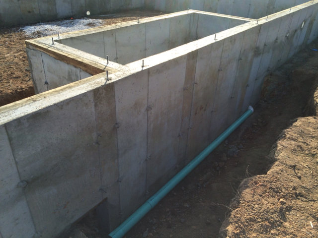

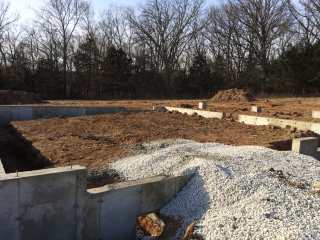

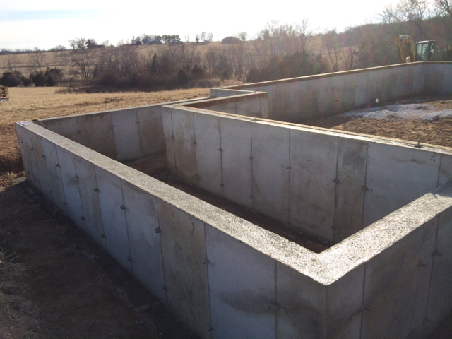

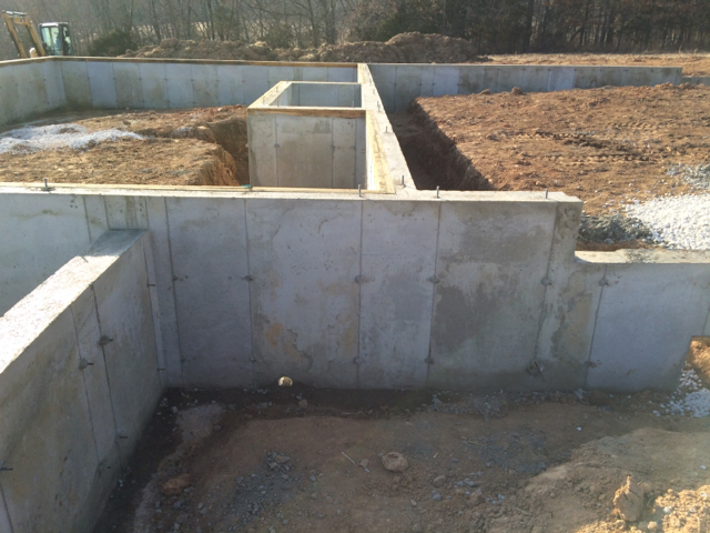

Close up views from the center-front of the building looking over the porch, storm shelter, and garage area.

I'm a big fan of over engineering everything, but when it's my money, I always like to find the most cost effective way to get the job done. I keep wondering what the cost difference was to bringing in dirt to build up the pad and going with a standard slab compared to using concrete and rock fill?
Are the sleeves for the utilities above the outside grade? Will you bring in soil to build up the soil around the outside of the concrete? Do you have water and power to the site yet?
I'm enjoying the pictures and following your progress. It's always very interesting to me to see how others do things in different parts of the country.
Eddie
   / I'd like to build a barn!
#69
I'm a big fan of over engineering everything, but when it's my money, I always like to find the most cost effective way to get the job done. I keep wondering what the cost difference was to bringing in dirt to build up the pad and going with a standard slab compared to using concrete and rock fill? Are the sleeves for the utilities above the outside grade? Will you bring in soil to build up the soil around the outside of the concrete? Do you have water and power to the site yet? I'm enjoying the pictures and following your progress. It's always very interesting to me to see how others do things in different parts of the country. Eddie
Not sure on your first question. From my research I couldn't find anyone that builds that way around here. Yes the sleeves will be below grade after the surrounding fill is brought in. Right now they don't look like it I know. But The water and sewer will be about 2-2.5 feet below grade. The frost line in our area is 18". Yes I have water and power already. Thanks for watching!
