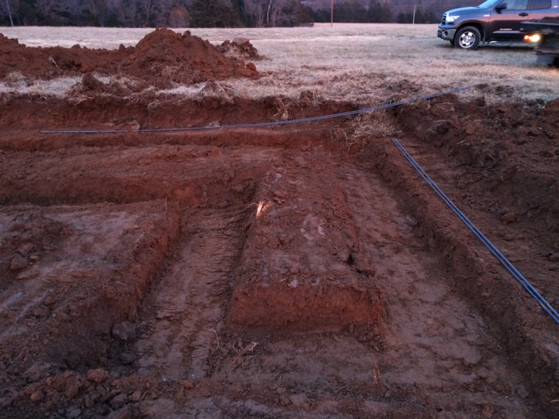

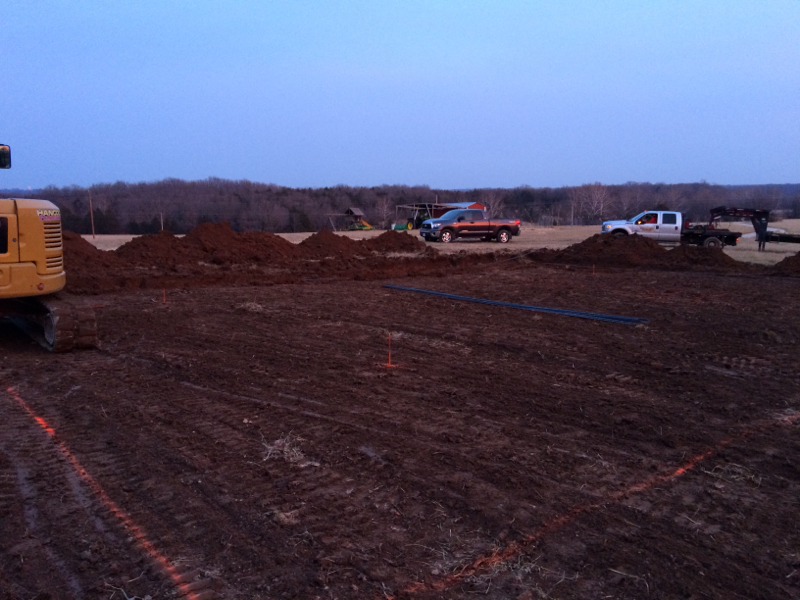

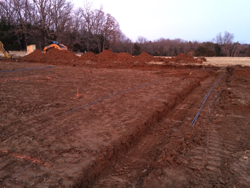

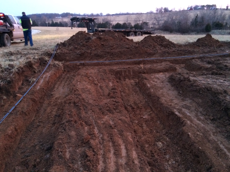

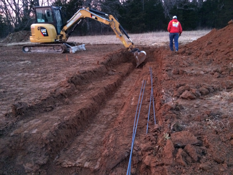

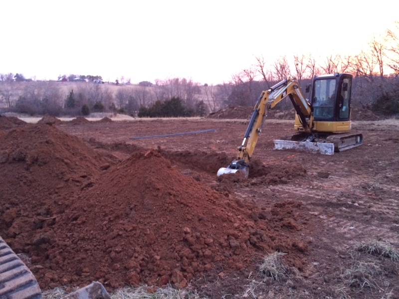

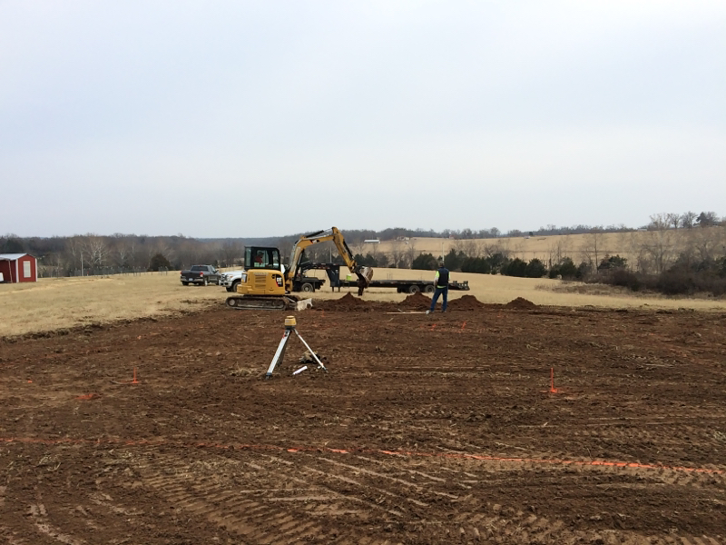

Hello everyone. It's been a while since my last post. And even longer since I posted about building a barn. I guess the name of this thread might not technically be appropriate, since I'm not sure what defines a barn verus a shop/workshop versus a "barndominium". Back in March/April I thought I had it worked out on what I wanted. I even started getting bids on pole barns. But then I had some unpleasant personal and work-related things that came up. Everything got put on hold through the Fall, but then my wife and I decided to kick this back into gear. Using the "Home Designer Pro 2012" program I've mentioned in the past, we drew up plans for a building that is part shop, part living space. Eventually we will build a traditional home on our property. However, the thought of a home mortgage, land mortgage, and construction loan all at once scares me. So our plan is to build a 40'x60' metal-sided, stick built on slab building with a living space in part of it with savings. Based on my research, I know people have done this before, so I can't take credit for it. But the advantages are we'll have a place to live while our home in town sells and our home at the land is being built, we'll be able to do more work ourselves and oversee construction of the home easier since we'll already be living out there, and we'll have a place for guests/in-laws when the house is built. Like many, I considered stick-built vs metal frame vs pole barn. All three have their advantages/disadvantages, but stick-built appeals to me the most as the most familiar. So that's what we're doing. I had also considered a simple structure with an RV parked next to or inside it. My wife vetoed that. We debated a lot on the size of the living space. I know it's going to seem excesive to a lot of you, but happy wife = happy life. unhappy TBN-ers = log my computer off. In the end we decided to measure the rooms that we really use on a daily basis in our current house plus bedrooms and essentially replicate that space. That ended up being 1900 SF. I wish it was smaller, but I have a few consolations. One and most importantly my wife is happy with it. Two is that I don't know how long we'll be there. It may just be a couple years, it may be 10, it may be forever. Three, I'm intentionally making the spaces adaptable. For instance, the downstairs could easily be a handicap-accessible suite. The upstairs could be one big room for storage/entertainement. As it stands, it will be living/kitchen/bath/utility downstairs in a 24x40 space on one end of the building. Above that will be a second floor with 3 bedrooms and a 3/4 bath. There's a "mezzanine" going over part of the shop space level with the second floor that provides for a crafting space for my wife and general storage. And four, is that we're doing everything "builder grade", using coupons, second hand materials, "dent and ding", whatever we can do to save on materials. Plus sweat equity of course. I think that most people on her mean well, but at times I'm not sure how valuable some of the advise on this site tends to be. No offense - many times I agree with posts and many times I learn something. Sometimes I disagree with what is said and it might strengthen my resolve otherwise. But SOMETIMES it makes me doubt myself or frustrates me. To be fair, the last category is the one that I find most troublesome. I have to admit, I debated on whether to post this build on TBN. Part of me wants to just keep going on my own and not share anything. But that said, I have learned a lot on here in teh past. And I enjoyed many posts on here. So I feel like it could be worthwhile to post my progress on this. Obed's "At home in the woods" certainly comes to mind. As long as things don't get out of hand or negative, I'll try to keep posting on the progress and I'll try to be open to CONSTRUCTIVE comments and suggestions. And please no posts that second guess things that I can't reasonably change. I read too many of those on Obed's thread. Whew, sorry for the long post! If you made it that far, then here's the good news: We broke ground last week! Here's pics of the build site and footers. I use my phone exclusively for pics. Most of my posts will be done through that. Sorry in advance for typos and poor formatting.
Looking South over worksite after sod has been pushed off to the side. The orange rebar is set "square" and that's what they measured off of.
Looking South over the porch area.
Looking East along the southern wall of the building. This side of the building is the 40' wall. The living space will be along this wall and have the southern view.
Standing basically where the front door will be looking East over the porch area.
Looking basically West over the NE corner of the building. This will be the front corner of the shop area. There will be a lean-to that is 12' wide and 40' long along this wall.
Looking basically North along the "shop" portion of the East wall. This wall is 60' long. There will be a 16' and 9' wide overhead door to this area.
Standing at the NW corner of the building/shop looking SE over the whole building site. There will be a 7' wide overhead door for a lawnmower and general access in this corner along the West facing wall.

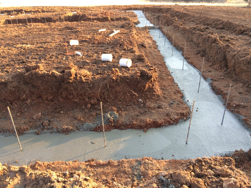

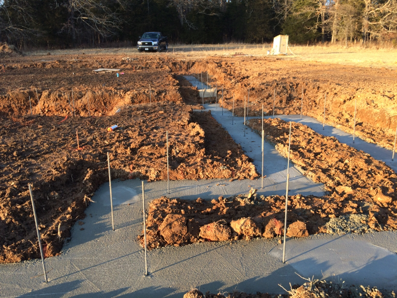

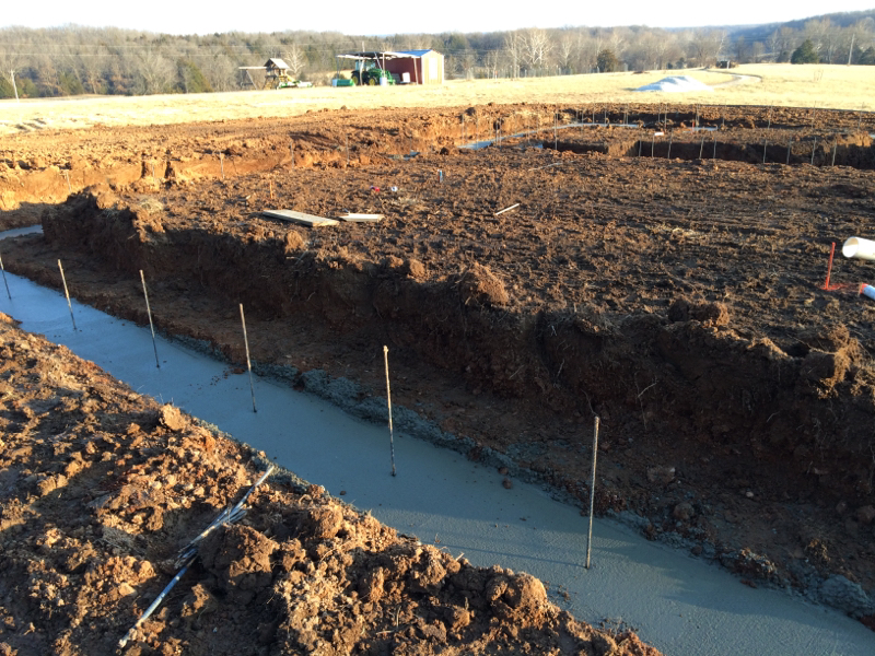

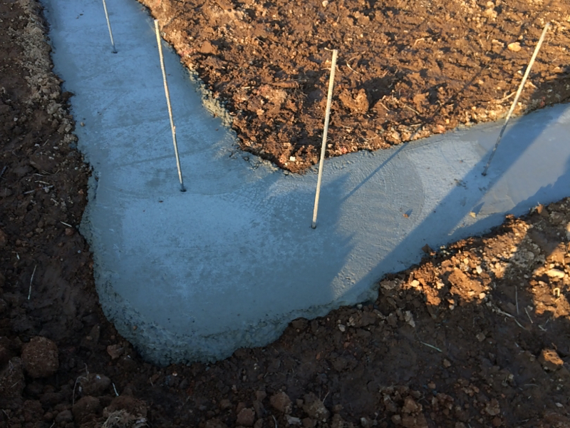

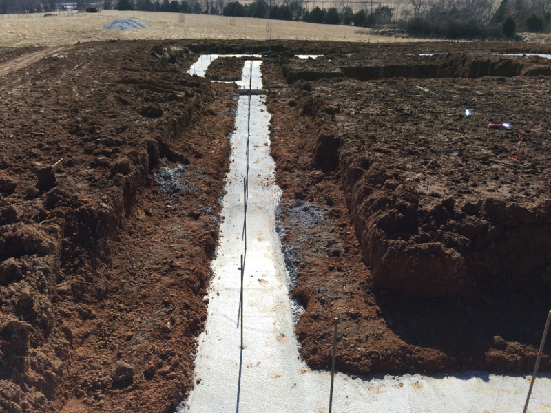

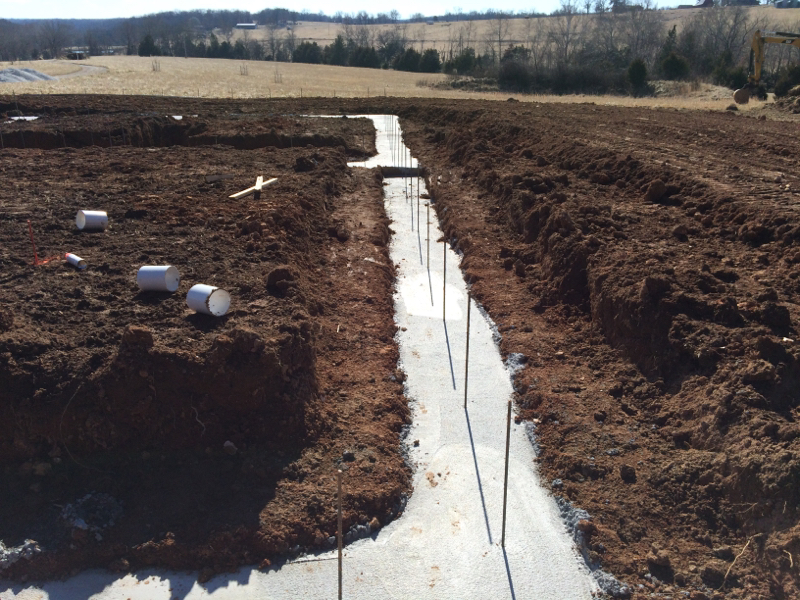

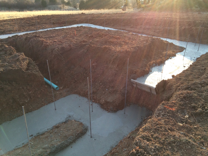

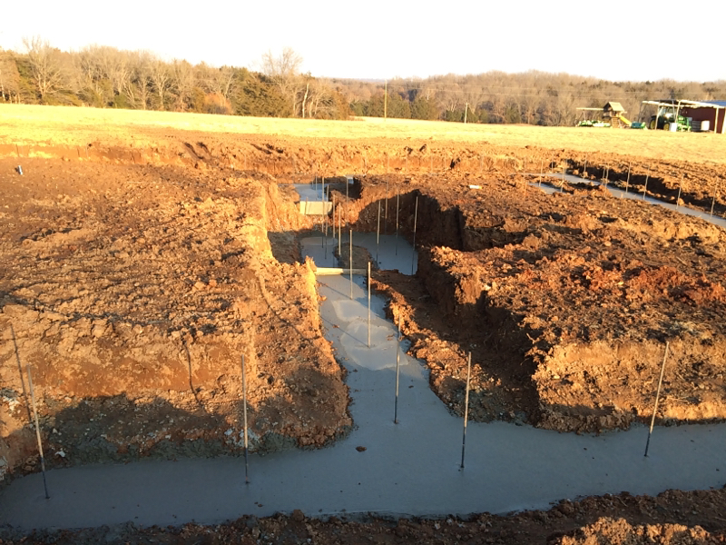

I wasn't there the next day when they poured the footers, but the remaining photos were taken the next afternoon after the footers were poured obviously. This is toward the middle of the building. There's a 40' long wallgoing down the middle of the building that separates the living space from the shop space. There is a stairsell that abuts this wall, and underneath that I have allowed for a 3.5' by 10' storm shelter. We were in Joplin visiting family when the tornado hit in 2011. I will never live in a house without a basement or storm shelter if I can help it.
Another view of the storm shelter. There is a drain in the floor that will go out to daylight. If you can't tell from the pictures, the slope of the property is downhill mostly S/SW.

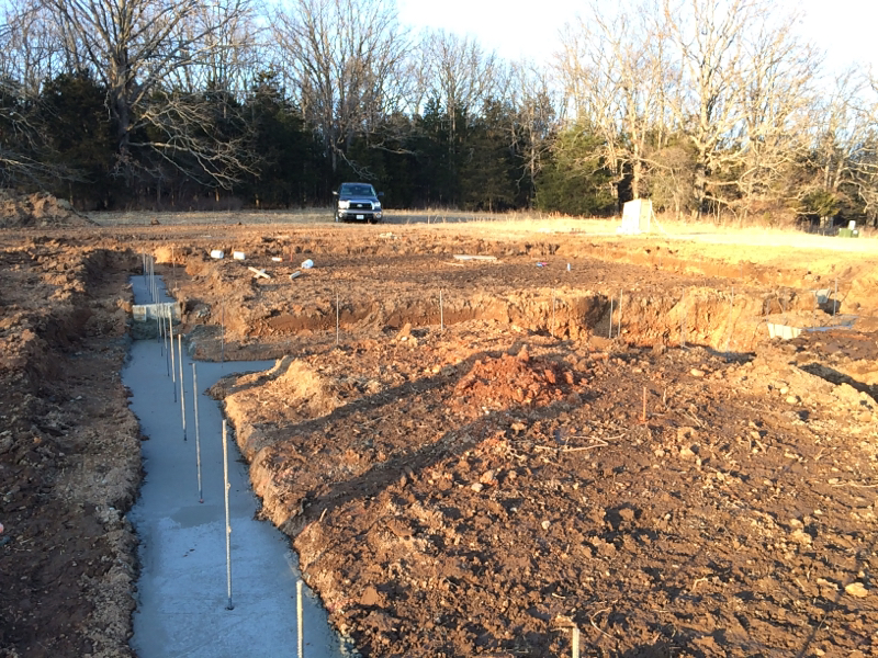

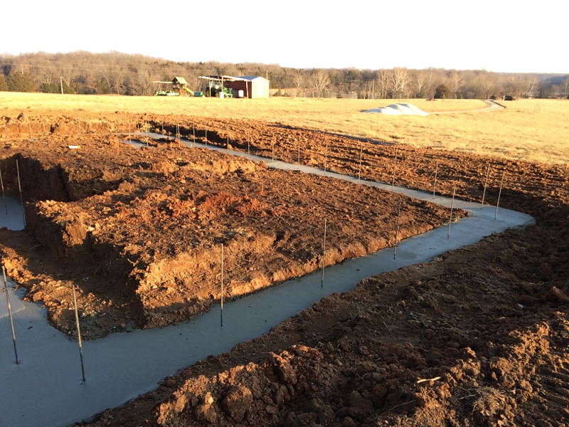

Looking SE over the West end of the living space. That's my 10' by 24' shed I built 3 years ago in the distance. I have a make-shift, temporary lean-to with tarp attached to it for my 5083.

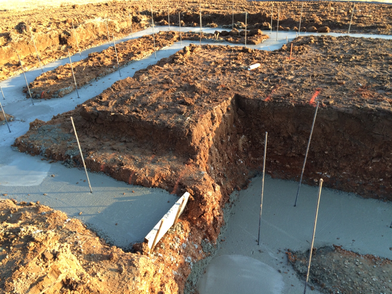

This is the SW corner of the building . It's also the lowest spot and determing the overall elevation of the building. The walls will be 4' at this point. It will need some backfill, but I've got plenty of soil....

Back corner of the shop area looking South.
And another view looking south and of the storm shelter.
