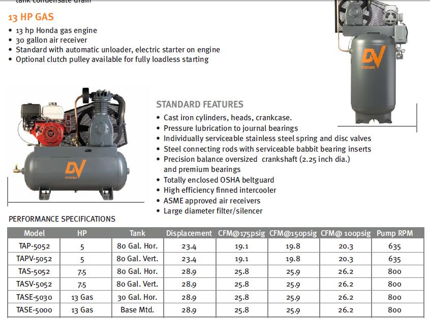

Here's the spec sheet on my compressor - just to muddy the waters some more :confused:
You posted while I was typing - I think that would be a good place to start, for all your reasons and a few of mine :=)

Thanks for all the help. I brought the motor home tonight. I am in the process of mounting it to the frame. The holes don't line up so I'm making brackets.
You electrical gurus out there prepare for wiring questions. The next step is to wire the pressure switch and mag starter.
