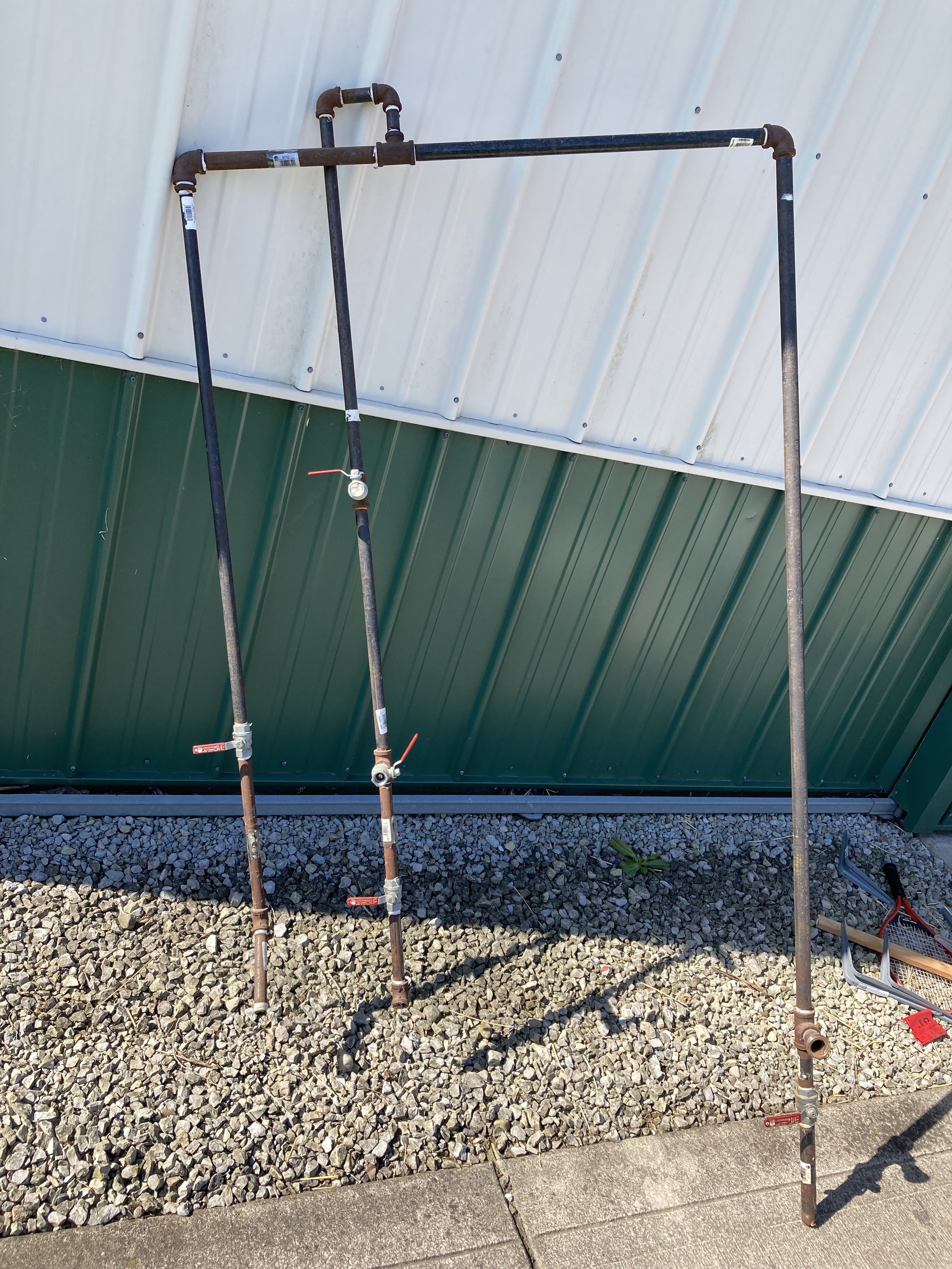

I'm the OP on this and here is what I just took down in my barn because I'm having it insulated. It's iron pipe, I put it in 20 years ago and have no idea where I got the plans. It's worked fine for me.
The hose off the connector went into the long pipe on the right that was also a drain. The down pipe on the left is also a drain pipe. The center pipe had a filter and moisture remover and my output hose connected there. This worked well for me. I drained my tank and filter every day when I used it and no problems.
My plan was to ditch this and replace with something new and easy to install but now I'm wondering if I should just put this back up with a new filter and moisture remover and call it good.
These days I just use the compressor to pump up tires and blow off equipment. I paint a few pieces of ag equipment a year and use OEM acrylic enamel paint. I only paint on dry summer days when the temps are right. It's low humidity here and I rarely use the compressor in the winter.
After all the comments, do you think I should leave well enough alone?

Install the auto drain I linked above, and you'll never have that problem, again.
I’ve been running a Dayton auto drain since 1995 and every 5 years the state comes out to inspect without issue…

@sixdogs Yes, I think you should leave well enough alone. That's a fine design. If the inside of the pipes look ok, I would reuse it if it were me. If I were feeling full of beans and wanted a project, I might redo it in copper not to have rust in the compressed air, but since that hasn't been a problem for you, I probably would not even do that.
Small soap box for others:
A few folks with safe experiences notwithstanding, PVC compressed air lines are known to be unsafe due to rapid and catastrophic failure modes. PVC manufacturers do not support it, neither does ASME, nor OSHA. The OSHA ban dates from 1988. This should not be news. If you have a business with PVC/CPVC compressed air lines, that is an OSHA violation, and if an accident happens, I would expect an insurer not to cover the damages.
PVC can be weakened by impact, solvent exposure, age, temperature, and strain, and when it shatters, the shards can be razor sharp. At 110F, the pressure rating is half that at room temperature, and at 140F, it is one fifth of the room temperature rating. Temperature and Pressure Ratings of PVC
If you have PVC/CPVC pipe for your compressed air system, please do yourself and those around you a favor and replace it.
ASME does permit polyethylene pipe under less than 100psi for underground gas service, and never above ground unless enclosed in a cover that could absorb the explosion.
End of soapbox.
Stay safe out there folks.

Looks like a perfectly useable setup, to me. Why fix what ain’t broken?

I'd just put it back up, modified as needed and with an updated filter/moisture trap. Save the extra $.

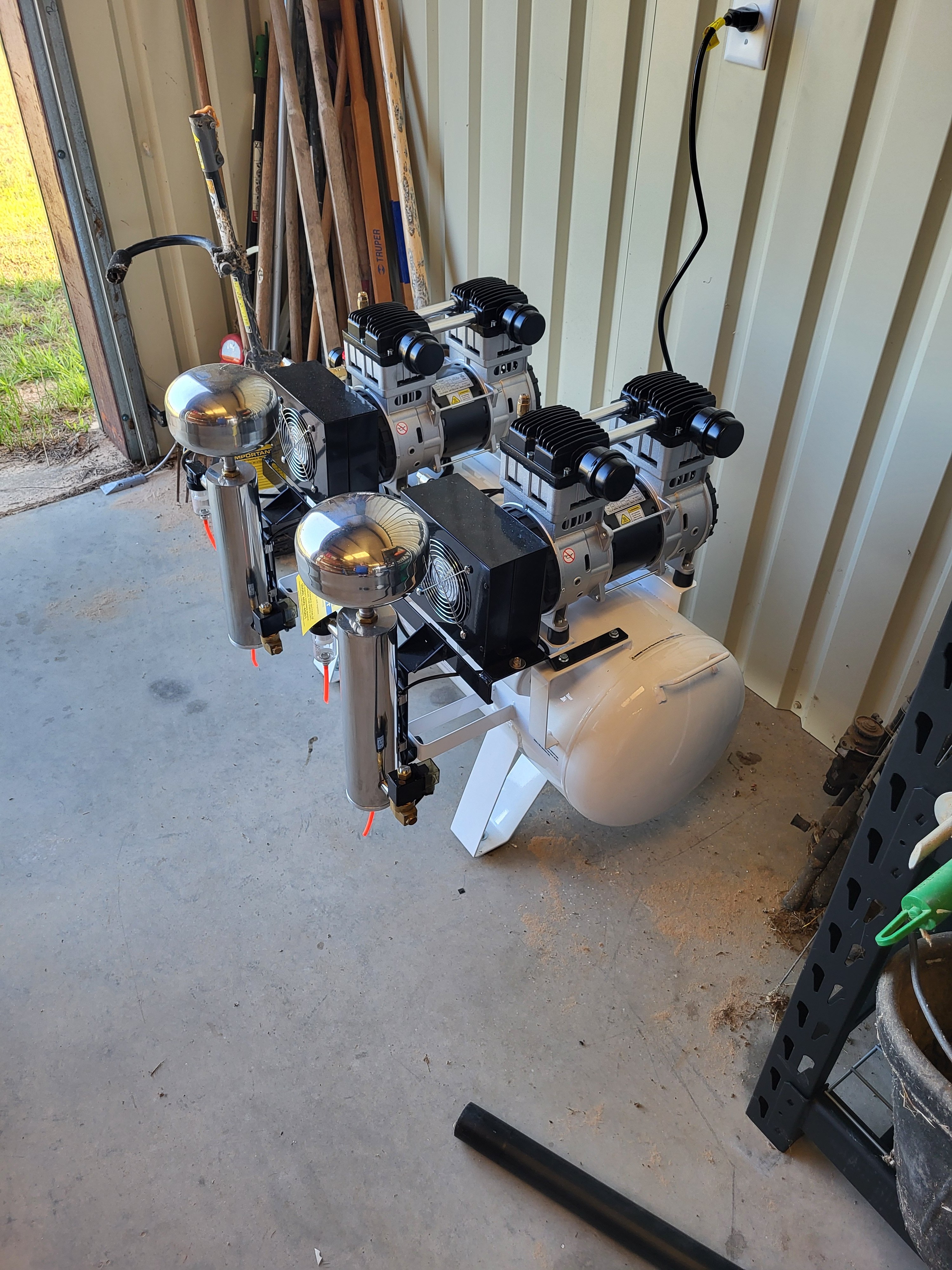

I looked at the cheapo Chinese timed moisture drains as well, but I prefer domestic made if at all possible so I went with the Suburban Manufacturing timed drain from Compressors Direct. It cost more but it's also made here in America and being patriotic whenever possible, I bought the American made unit. Looks like the Chinses / Amazon unit but made here. I bet the Chinese bought one and copied it.
