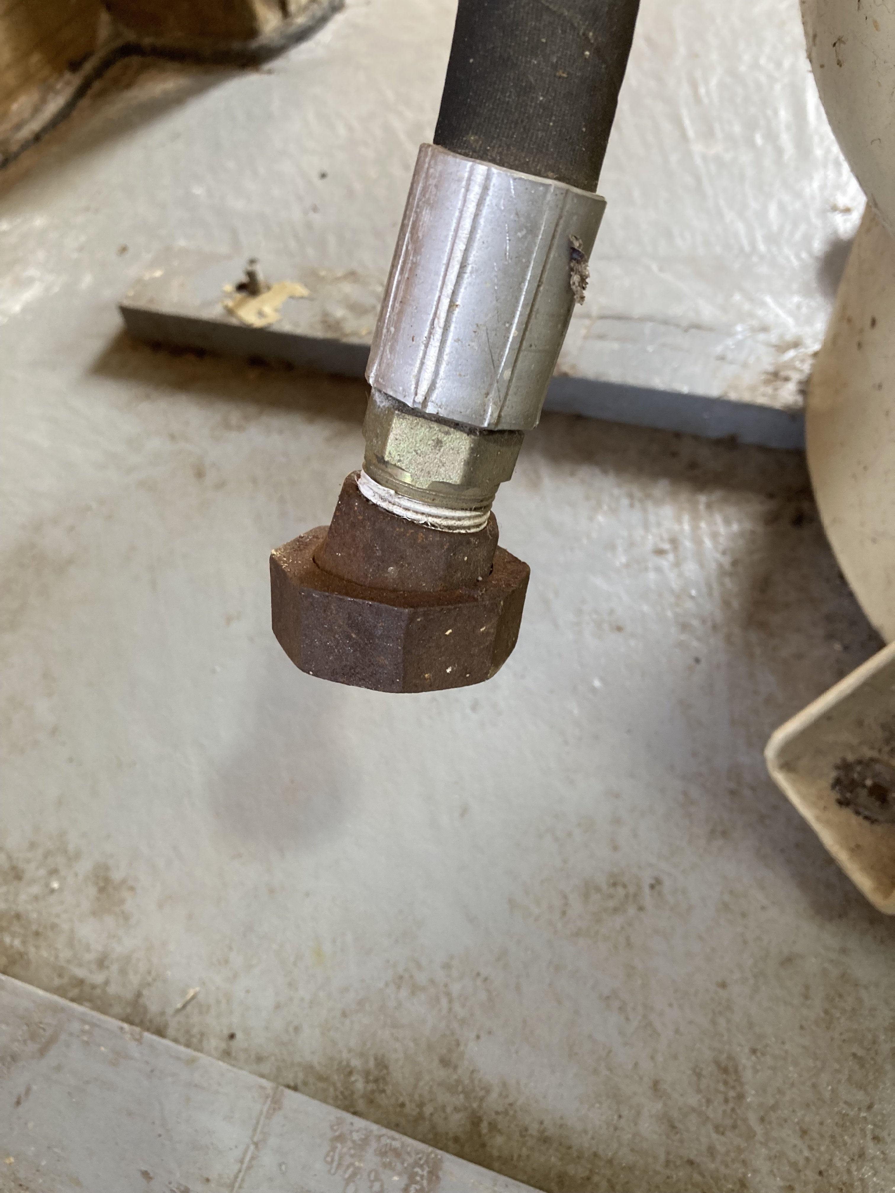

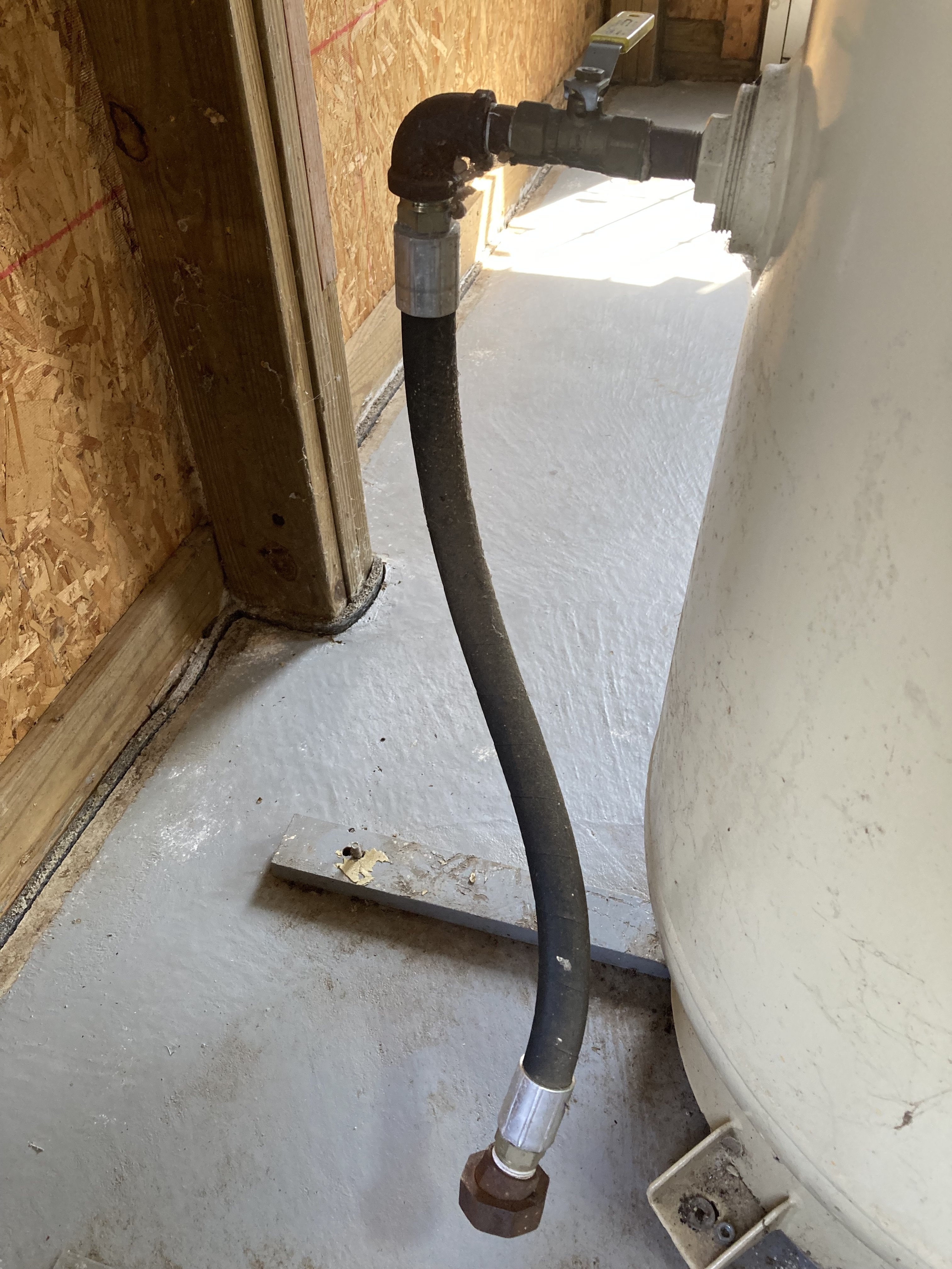

This is the connector hose I had from my tank to the lines. I thought it was a hyd hose but now looking at it, I don't think so. The connection on one end says maybe this was specifically for an air compressor? Anything wrong with using it again? It's in great shape.

Probably fine. I’d personally replace the rusty iron with brass, but I’m fastidious like that. What you have there will likely hold fine for many years.

I wouldn't want anyone to think I was less than a perfectionist but there comes a time when advancing age changes your perspective on priorities.
View attachment 3285590 .View attachment 3285591
Looks like a hydraulic hose from this armchair...
I think this is really your call about fix before it breaks versus fix after it breaks. A new hydraulic hose from Baileys or Surplus center isn't that much.
If you were changing things, my only $0.02 would be to put a valve on it where it attaches to the tank, so the hose doesn't have to stay pressurized.

Yes, I had a valve at the tank and drained lines and tank after use. I don’t use much now and don’t want to leave with pressure or moisture in tank. I’ll look at hose and likely replace. I’m not into cheap.
   / Air compressor lines for stationary air compressor. #51
If you drain the tank at each use, I'd say there was no need for a valve. :)
