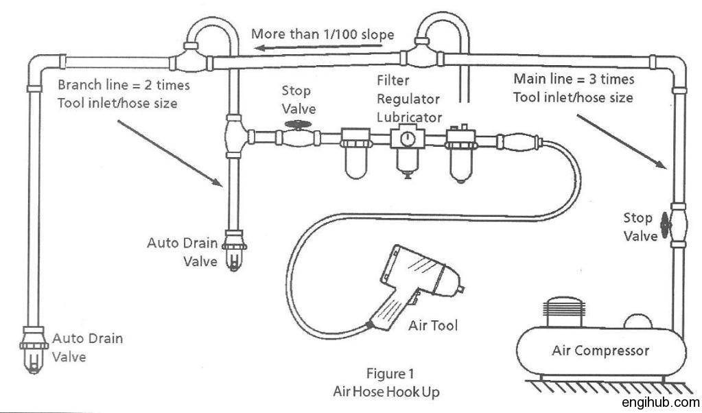

I used to have air lines run in my shop because I painted and needed the moisture removed. At the compressor I had a flex line to a vertical line that crossed over and dropped down to my moisture filter for painting. It looked something like this
It worked great but I just finished insulating my barn and had to take the lines down. I don't paint as much and don't want to run lines again. I have a two stage 100 gallon 180? psi compressor.
Can I just run a short rubber hose off the tank to a moisture filter, possibly right on the tank, and then run my air hose off of that? This would keep it easy for me and I only paint again equipment no that isn't very fussy. I mostly pump up tires.
I'd like to keep it simple. What do others do and how do you run your lines off the compressor to remove moisture?
/ Air compressor lines for stationary air compressor. #2
There are different types of "moisture filters", but what most have is a separator. This is essentially a fine mesh screen that collects condensing moisture droplets from the air as it passes thru, and drips them into a bowl.
To work, these require that the air coming out of the compressor has cooled enough for the water suspended in the air to condense when it hits the mesh. Those mounting it directly to the compressor usually end up with water in their lines, because the compressor tank gets hot and thus the air passing thru the separator is too hot to allow for condensation.
Even just 10 feet of copper or iron line running to the separator, connected to the compressor with a short length of flexible hose, would work much better than having the separator mounted directly to the compressor tank outlet.

It all depends on duty cycle. If you only ever use a small volume of air at a time, this can work fine. But the first time you do a job that keeps the compressor running long enough for the tank to heat up, this method stops working.
Side note on draining tanks: I probably have the same compressor as you, a 7-1/2 HP x 70 gallon "Extreme Duty" from CH, purchased probably late 1990's or ca.2000. Other than a few blown motor capacitors over the years, it's been a great little workhorse, but draining the tank was always a PITA. More importantly, since I'd use it hard on weekends and mostly let it sit during the week, the thing was always left cooling and condensing unattended. So, there was basically always a quart or half gallon of water left in the tank all week... for 20 years.
I had looked at the "old school" auto drains years ago, operated by the unloader valve puffing against an air-operated solenoid, and the whole rig seemed impractical to rig on that compressor type. But then a year or two ago, someone here (I think @5030 ?) mentioned these little timer relay operated solenoid valves that you can plumb in as an auto drain, and I picked one up cheap on ebay or Amazon. Now the thing does a 5 second piss every hour, or thereabouts, which is more than enough to keep the tank always dry, given my usage and air-conditioned shop environment.
The timer is adjustable in both frequency and duration of drain cycles, and I'd recommend this to anyone with a stationary compressor. We've all seen tanks rusted thru from the bottom, and the amount of stored energy in a 70 gallon bottle at 140 psi is absolutely devastating, should one ever rupture.

I made do by putting about 10 feet of 1/2" copper line on input to separator, and then connecting that to compressor with another 100 feet of 1/2" hose. Direct 1/2" NPT connections, no quick-disconnects, to minimize the pressure drop of an already-bad system. It wasn't great, but thanks to my compressor residing in an air-conditioned shop, I got by.
Now it's all hard-plumbed in copper, 3/4" line into three long parallel runs in 1/2" copper, before collecting back into a single 3/4" feed into the separators on each floor. All painted flat black, it works very nicely as a radiator, ensuring air going into the separator is as cool as possible, for maximum moisture extraction. Auto drain on compressor, my only possible point of failure is if I forget to drain the separators.

Unless you have a cooler/dryer, you want those inline separators away from the tank to allow the air to cool and condense the moisture. This is also why iron pipe is a bad choice for lines--They rust from the inside out.
I have a forced-air cooler right after the tank and above it. It turns on when I turn on the compressor. The cooler runs all the time while the compressor cycles as needed. Condensate drains back into the tank and out the bottom drain--Basically, a metering valve. It bleeds all the time. My inline filters and separators are always dry. And that means dry air.

@sixdogs while you could run rubber to the filter (and regulator?) and a hose from there on, I wouldn't. I would run copper to the filter and regulator first. Just on safety grounds, I don't think that you really need to be around hoses with 180psi in them, but that's me.
I have a 3' braided stainless flex line from my IR compressor to the wall mounted coalescing filter and water separator with a float drain. I was leery of using a rubber line at the compressor due to the heat and oil, and concerned about the hose blowing out.
After a few years I added an intercooler that I built with a coalescing filter with an auto drain that removes 99% of the water before it gets to the main air tank. I still cycle the bottom drain of the tank after using it, but there hasn't been water or spray for years.

To have dry air at the business end, there has to be some place on the line where the temps get below the dew point.

Your set up was a good start at having dry air.
However, water vapor can travel through any water trap, or water filter.
A Motor Guard M-100-KIT filter right before your air hose, is as good a trap as you can get. It uses a roll of toilet paper, to filter out moisture, on a limited basis.
As others have suggested, you can add piping that will help that vapor to condense out of the air, so the traps can catch it.
But, the only way to be certain of clean, dry air, is to have a drier.
You have two options: A refrigerated drier. Or, a desiccant drier.
