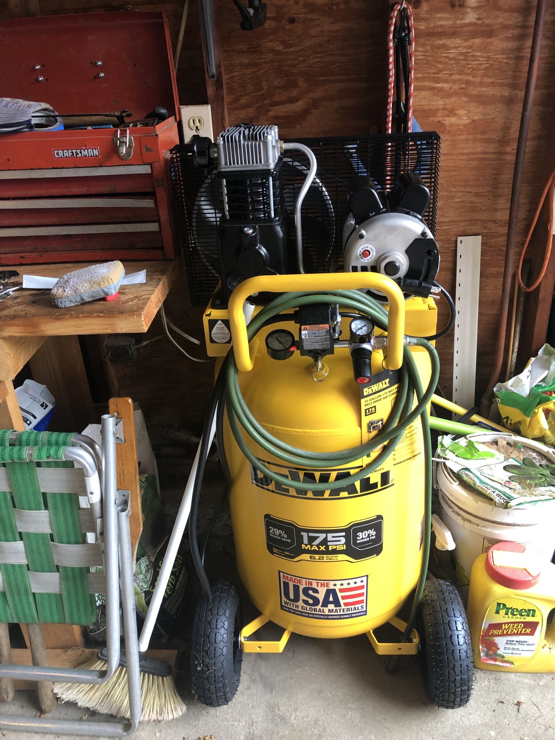

Good Morning Zarkhillbilly,
I know you need a larger compressor, but I went to TSC to find one that works for me. I only occasionally use the compressor for HVLP painting, so I really didnt need anything as large as what your looking at. I had a Craftsman 30 gallon for about 30 years, surprised it lasted as long as it did.
I ended up buying the DeWalt 30 gal 175psi for $599. They offered me 0% interest for 12 months, so that worked for me. I was planning on paying cash, but thought this was a good deal. American Made always makes me smile ! I also liked the cast iron pump, the craftsman was garbage in comparison !
I did look at the larger IR when I was at TSC, but couldnt really justify spending that much for my uses ! In any event, best of luck with the IR, dont think you can go wrong with that unit !
