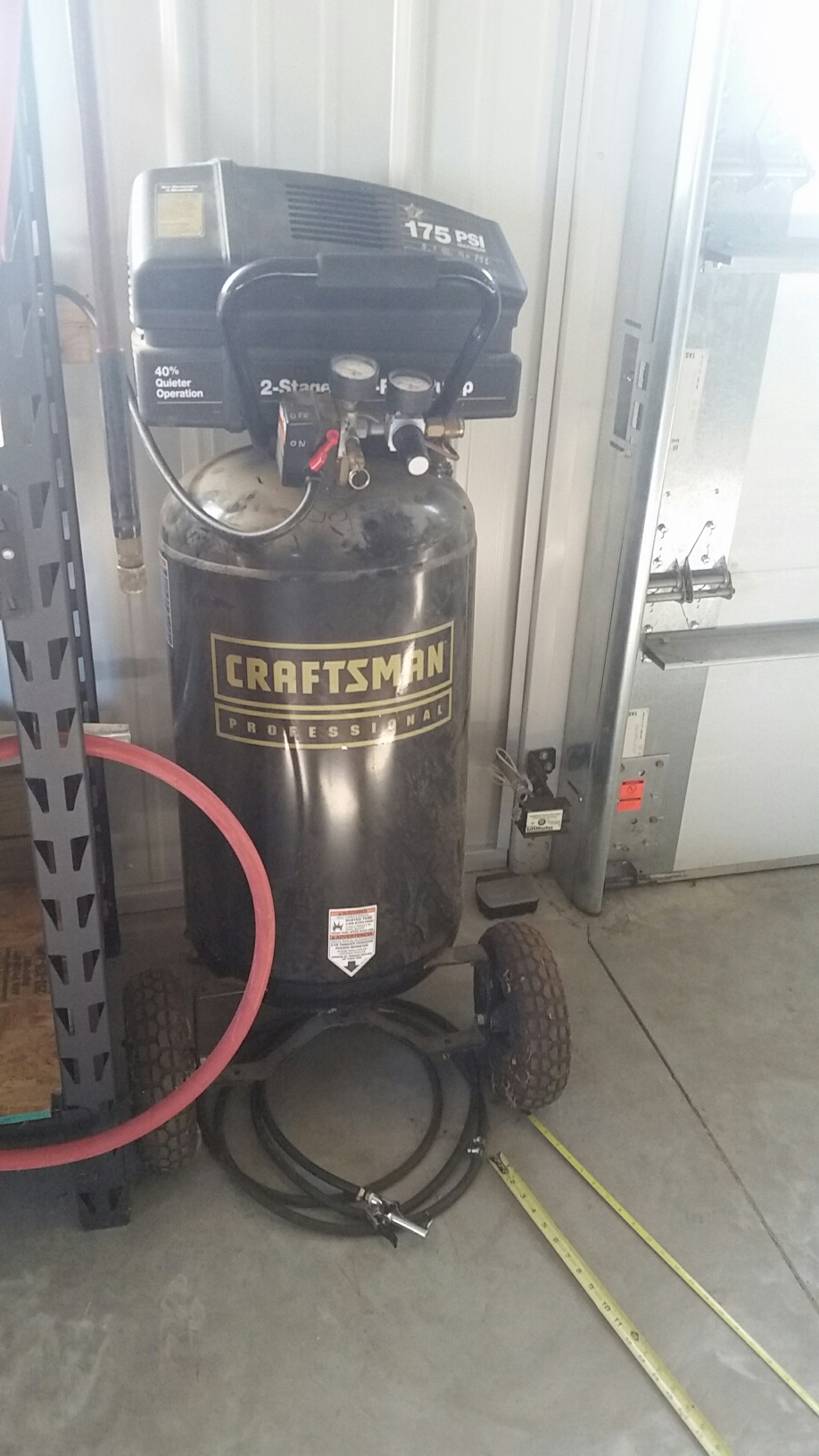

My 30 gallon Craftsman blows me out of the shop sometimes.. Very loud.. I would like to find something half as loud for sure..

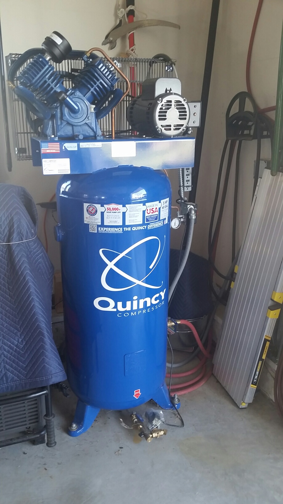

I bought this Craftsman because it said it is 40% quieter. I measured it today with a decibel meter on my phone at 75db & 70db at 10' & 25' away with the overhead doors closed.
The odd thing is, this Quincy is 78db &76 db at 10' & 25' away...... I wonder, 40% quieter than what?:confused3:

Decibel ratings are confusing. For ever 20 dB the volume increases by a multiplier of 10. So 60dB is 10 times louder than 40dB. That's the "field" (amplitude) ratio. We all know that marketing uses whatever they please to get the numbers they want. If they use the "power" ratio it is 10 dB per 10 fold increase. So the 40% quieter could be only a few decibels.
My craftsman (it's a red one just like that, not the black "professional" one) is annoyingly loud. So your black one could be "40% quieter" than my red one. :confused3:

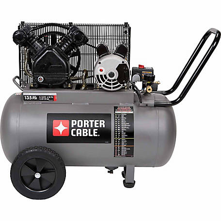

I can't post a direct link as this is my first post. Search Tractor Supply for Porter Cable 20 Gallon Portable Belt Drive Air Compressor
SKU # 109376499. This style has a very different sound than the direct drive models and it is much less annoying and does not startle me when it comes on.
The $349 price is good and I got mine on sale for $289 a few months ago. You will see this same unit in different colors and brands for nearer $500.

Slow oil lubricated belt drive compressors are where it's at. I upgraded to a real 5hp 80 gallon Quincy a year or 2 ago. It's a lot quieter than my previous ones. The 60 gal "5hp" oil lined Kobalt wasnt bad, but not super great. Way better than all the oil free ones.
I hear the new scroll compressors are wicked quiet compared to a piston pump. The rotary compressors are really nice as well but way more than my high end Quincy. You need to use rotarys a lot so they heat up & stay hot, or they don't have issues. They dont work well for occasional usage.
I can vouch for that exact model craftsman professional. My dad has one and wish I could swap with my red upright. It's half the noise of mine.
