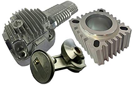

If you study normal air compressors design, they don't use a cylinder head as such, but a "valve plate". Its a much simpler way to go about it than trying to modify an internal combustion engine and its original poppet valve train.
A valve plate is just a flat sheet of metal bolted directly to the top of the cylinder block, there is no large combustion chamber space, its just a flat steel plate. You could bore two holes into that plate for the intake and exhaust valves. Both valves are just flat reed valves, or something very thin and flexible and springy. The exhaust valve is just a springy flap that sits on top of the valve plate. As the piston comes up, air forces the flap valve open.
As there is zero combustion chamber volume, its VERY efficient at pumping all of the the air out, especially against the high constant back pressure that a compressor normally has.
The intake is a similar thing, but the flapper valve is mounted flush under the valve plate, and opens by itself as the piston moves down the bore. Its all very easy to make, especially if you buy proper reed valve replacement parts for an existing commercial air compressor. Trying to do something clever with the original cylinder head and camshaft is still a lot of work, and its never going to work as efficiently.
valve plate.jpeg In this picture the exhaust flapper is on top surrounded by an orange O ring. The five upper holes feed the intake flapper located underneath (that you cannot see).
An alternative arrangement that has several advantages is to place the intake reed valve on the top surface of the piston crown. As the piston moves down, inertia tends to help open the intake valve, as well as air pressure. As the piston goes back up, inertia helps slam the reed valve shut. The induction air all must come through the crankcase, which is not a problem.
The top of the valve plate then just has only the exhaust valves. Its then a lot easier to fabricate a sealed box over the whole valve plate as a combined exhaust manifold.
Induction reed.jpg This picture shows a very small air compressor with the induction reed valve placed on top of the piston, which is quite a common design.
It would be very easy to do with an automotive piston, especially if its slightly dished.
If you go about it this way, it will be vastly more efficient than trying to use an original cylinder head with a large combustion space. So much more efficient, that the compressor can be run at greatly reduced rpm (but at a higher drive torque). But the lower drive speed will definitely help with noise.
