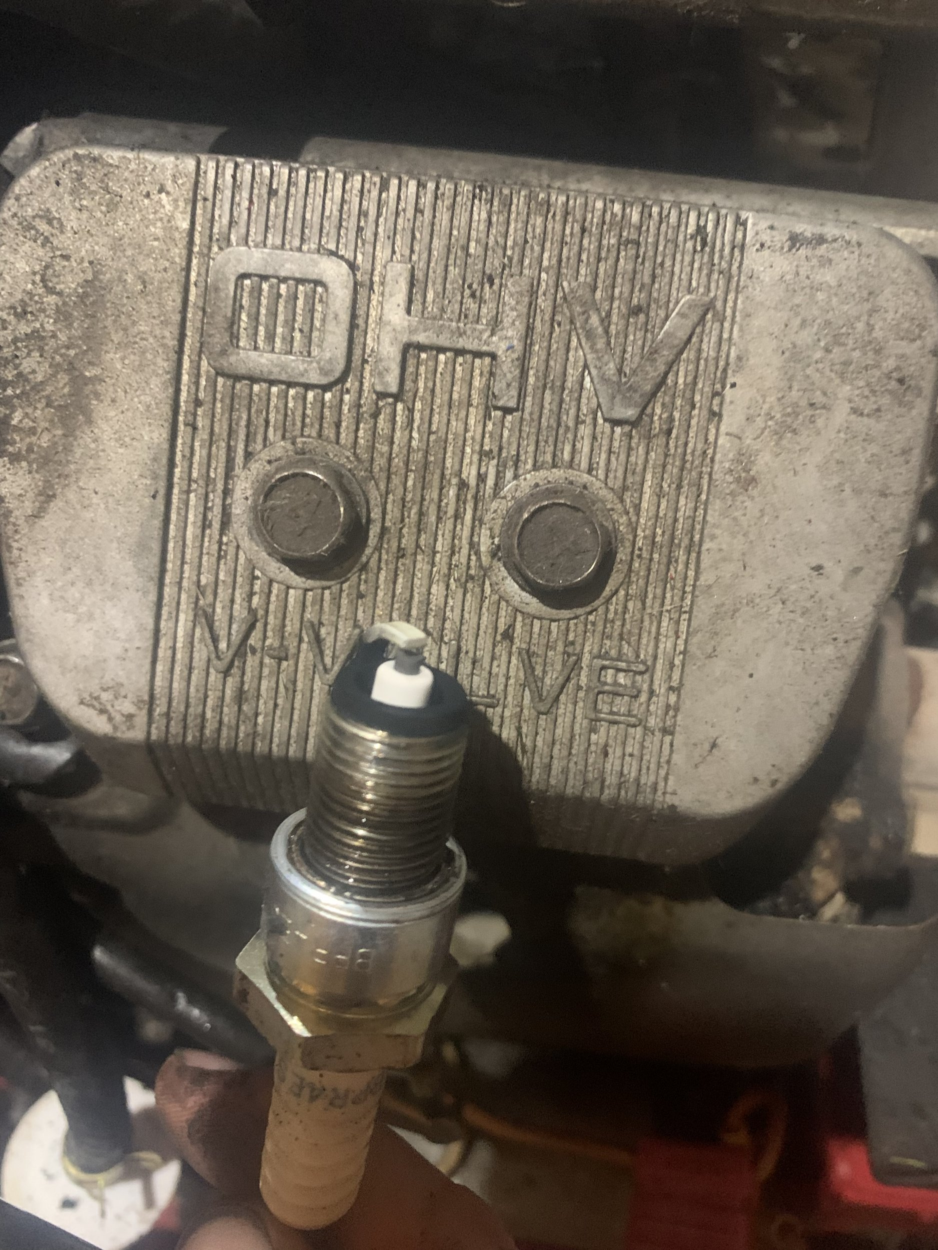

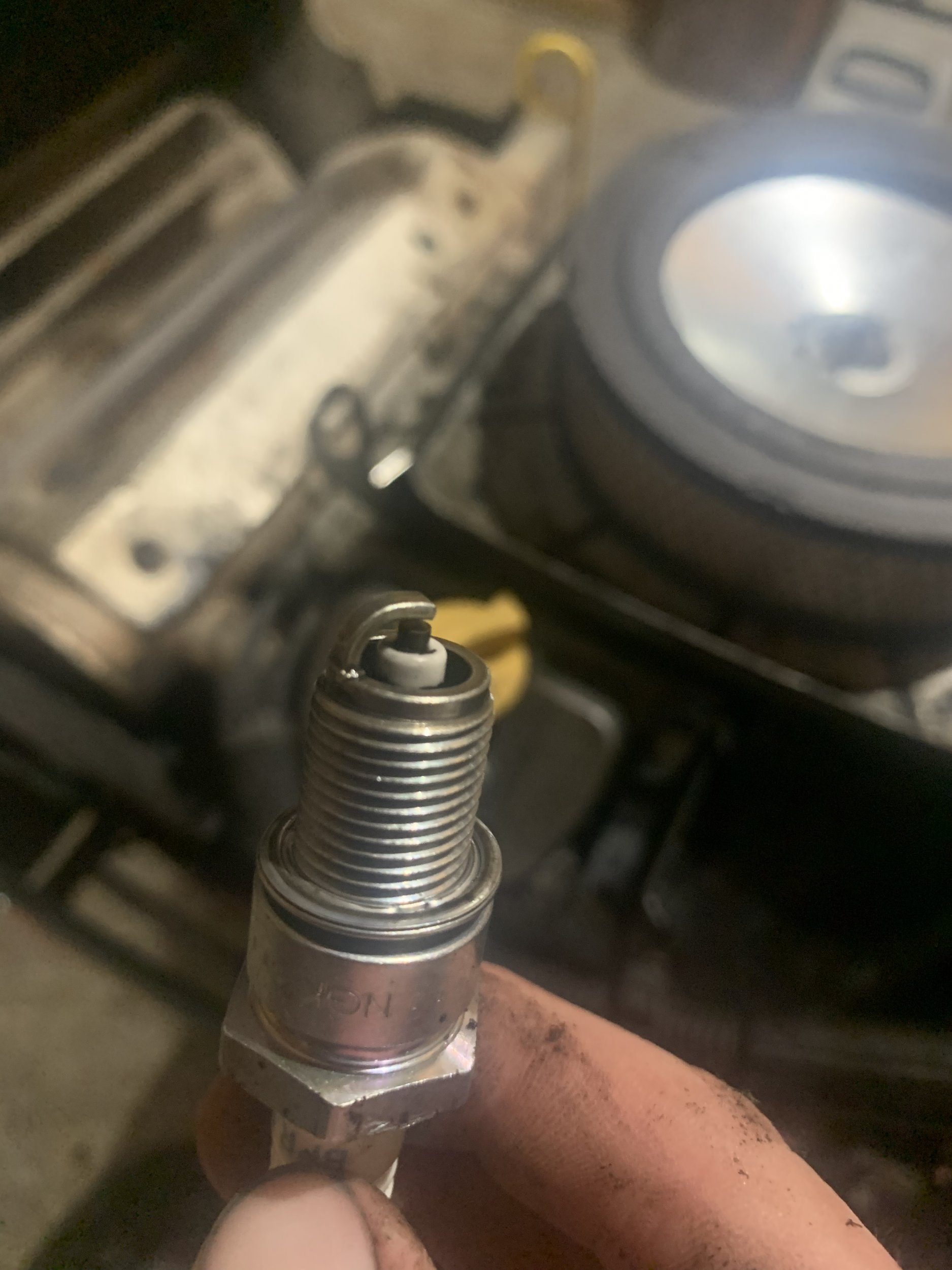

Ok, replaced the hydraulic filters (both) and no change. Fuel filter is brand new but a little dirty so getting another one. It seems that front arms/aux hydraulics don’t bog it down.
The big find was that I think one of the cylinders isn’t firing. With the engine running (idle or WOT), I could pull off the left cylinder spark plug wire and the engine sounded the same. If I pulled off the right, the engine died.
Here is what is weird, I swapped the coils left to right, and no change. Right cylinder would kill the engine, left made no difference while running. Does this eliminate the coil being the issue?
Swapped plugs, left to right, same thing. Pics attached of right cyl plug and then left cyl plug before I swapped them into opposite cylinders.
Now I’m confused, where do I go from here? Can I eliminate coils? Is the carb not getting gas to the cyl? What else could be causing the miss?

I didn't think a compression test would tell you anything but now it seems that should be your next step.
Its beginning to sound like you may have a stuck valve, valve out of adjustment or possibly a blown head gasket.
If it were me, I would pull the suspect spark plug and ground it to the engine and hit the starter just to visually see if there is actually spark.

I did ground the plug to the block, spark at both sides.
Pulled the valve cover off and all seemed well, did a lash adjustment anyways. That’s when I realized the intake valve was stuck open. Took the head off. Bend pushrod and stuck valve.
In doing all this I realized how much the PO let this thing go. Dirt and grass caked in all the fins so overheating was certainly the culprit.
Now that I have it off, can I get away with just a new pushrod, head gasket, and cleaning the head and valvetrain? What else do I need to replace?

To close this off - dropped a valve from a moved guide. P.O. must have overheated the engine. Replaced the head and bent push rod, and we are at full power!
