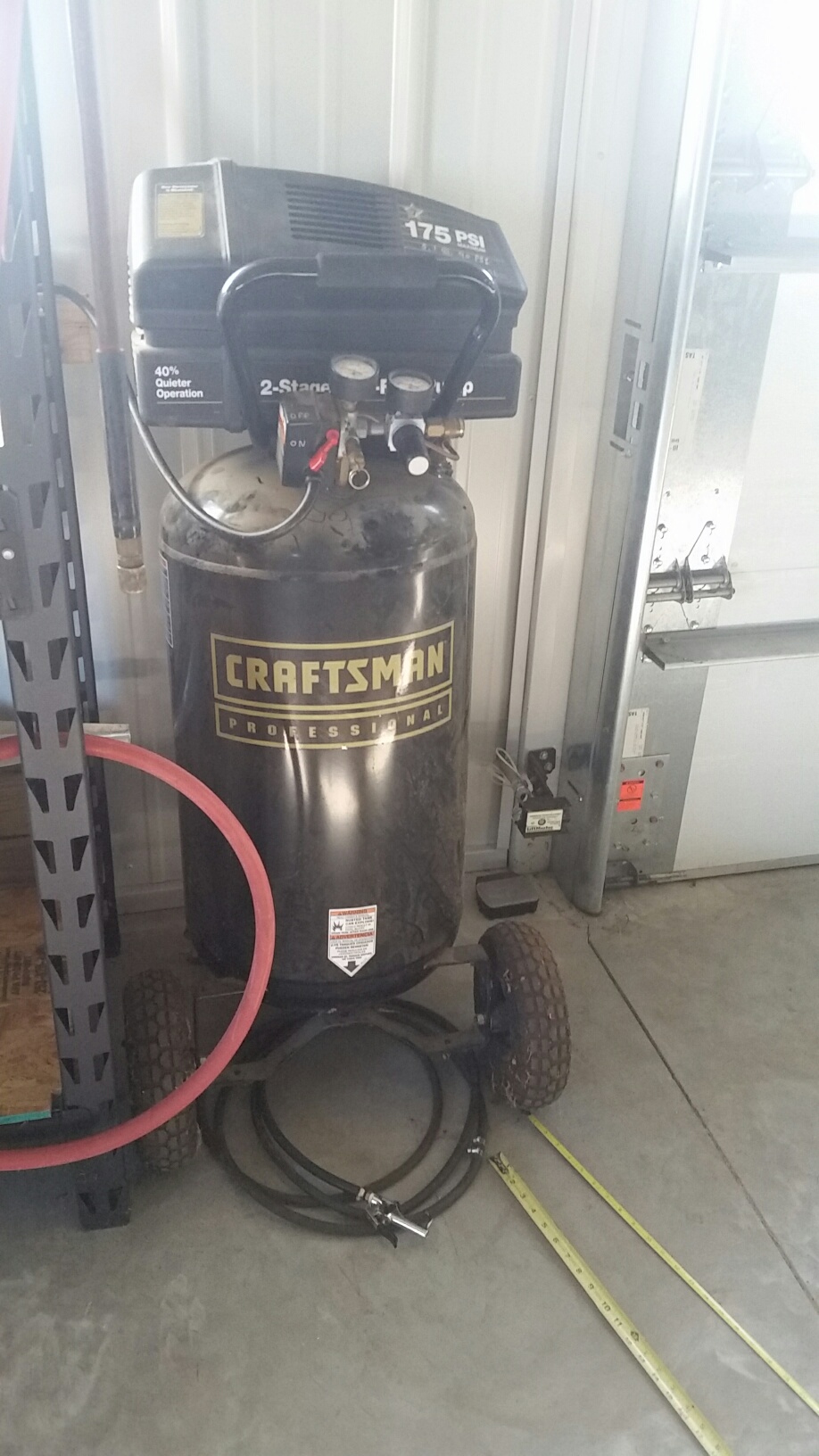

What I'm thinking is, those little 1HP/6gal "silent" import compressors may not put out enough air for a shop, may not be capable of continuous duty, may not last as long as a good quality one, etc., but...
At <$150 each, I could buy 5 of them, plumb them together along with my 26 gal craftsman acting as a storage tank, and I'd have:
5HP
56gal
15.5CFM @ 90PSI
125 PSI max
51db (whisper quiet)
... all For $750.
I could connect an analog pressure sensor to a little programmable control board like an Arduino, which would track the run time of each compressor and when the pressure drops below, say 120PSI, it could switch on a single compressor, whoever has the lowest hours. And if it drops below 115PSI, it can switch on a 2nd compressor, the next-lowest-hours compressor, and so on in cascading fashion until all 5 compressors are running in response to a large air demand. This way none of the compressors has to run continuously and as long as air demand is minimal (which is usually), the run time will be divided among 5 compressors, theoretically extending their lifespan by up to 5X. There is the added benefits of having FIVE levels of redundant backup, being able to easily detach a part of your air system and take it on the road, and if a compressor fails you just replace it for $150 and leave the tank connected to your system, so if ever you do experience a failure it's not a total loss; your volume grows with each failure.

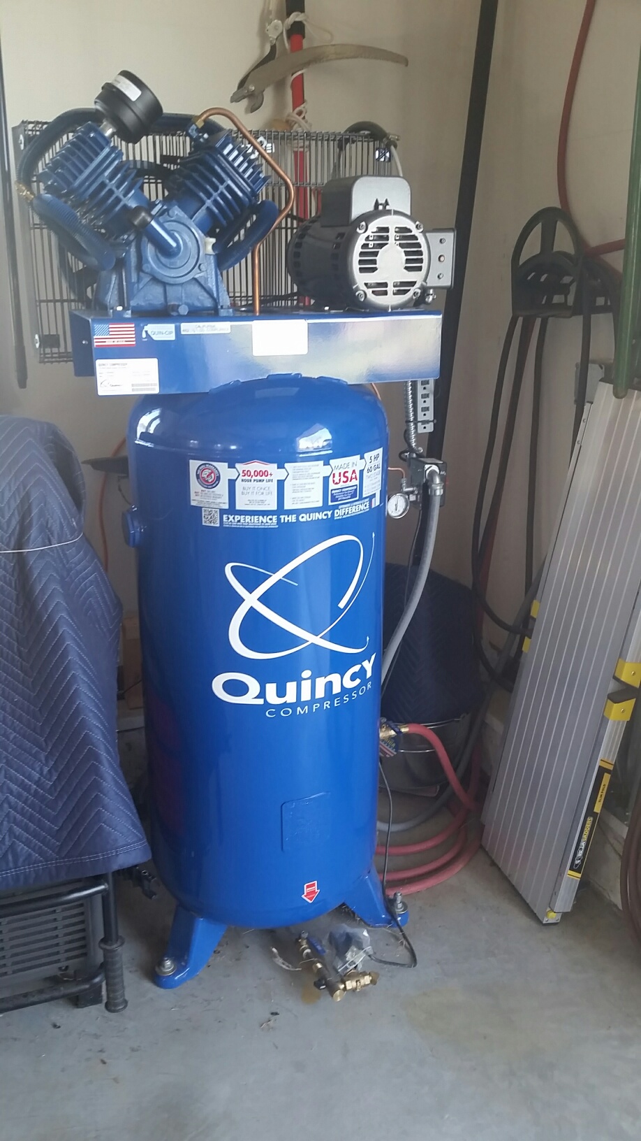

Compare that to a quincy such as this:
$1,399
5HP
60Gal
15.4CFM @ 90 PSI
175PSI max
75db (super loud)
Single point failure if the compressor goes out
The only area I see the Quincy winning in, is max PSI, and I never use more than 100 PSI, so I don't see the justification in paying the extra $650.
(oh yeah, and 4 gal more storage)

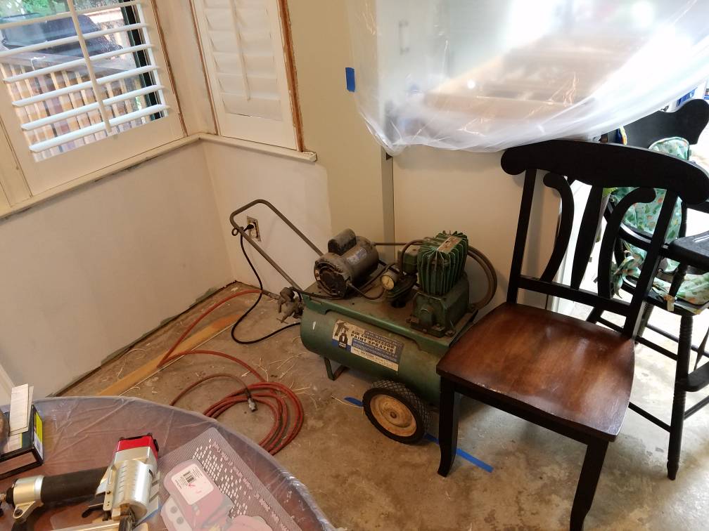

I got this from my grandpa. Its quiet enough you can watch tv in the next room. I use it for things around the house away from my garage. I guess its quiet because of how slow it runs?
Or put the loud one outside in it's own enclosure.View attachment 575768
Anyone know where I can get another braided cloth air hose? I like this one alot. I know it's old though.
I have a similar model at my city house. Very quiet indeed. Same size oil less compressor would have my neighbors complaining.

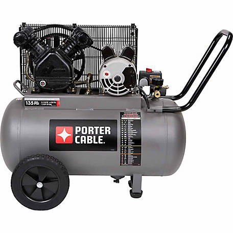

Interesting concept, a couple concerns- and I am sure I am probably being overly critical on this...
If using high demand tools for long periods (as an example a D/A sander) will likely push them all into continuous duty at the same time.
Most belt driven oil type pump compressors are rated for continuous duty (both the pumps and motors)
So if needed you can and likely will- run them non stop, don't have to worry about having to shut off the compressor to save either the pump or motor or being in the middle of an important job -say painting and have the compressor (gasp) turn off- to protect itself.
jmo but that would bother me more than the noise..
I run 2 parallel compressors ( IR 5 hp 60 gallon uprights) when needed.
They are not super quiet but run very smoothly and not what I would call irritatingly loud but surely louder than the small quiet compressors together. also provide 24+Cfm @90 psi If both are turned on.
Maybe these new direct drives are long lived but what I have been able to find for durability/ quoted lifespan it doesn't look real good...
15 cfm @90 psi that you quoted,using them in parallel sounds good, right up with the belt driven units
but wearing out or over working these small non continuous duty multiple motor/ pumps could be a reality.
