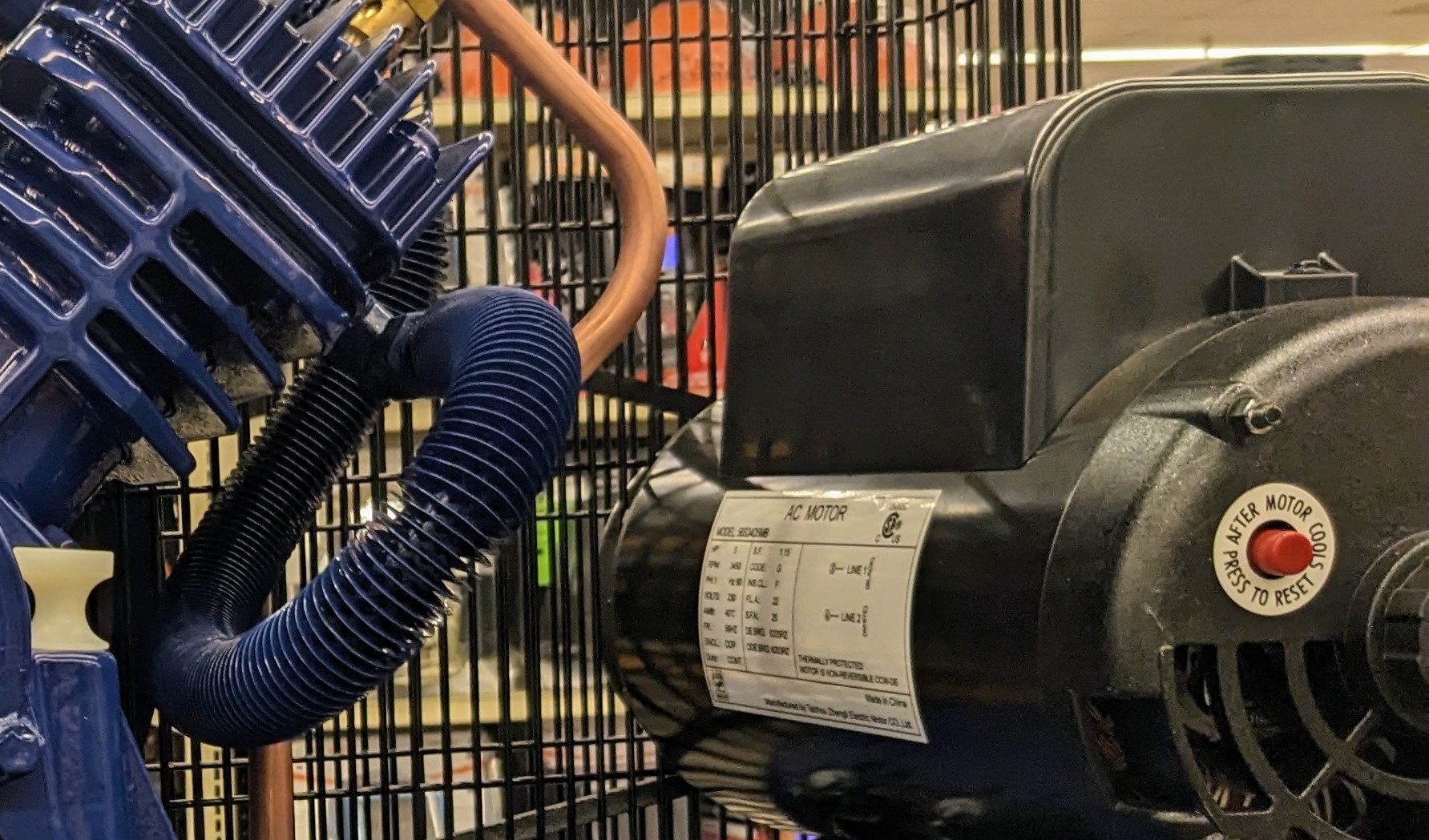

I was going to buy the well regarded QT 54 but they dropped the Baldor motors and now just say made in china. Then they jacked the price up another 200 bucks. That caused me to buy a different compressor.
Some Ads still show the Baldor motors.
Not sure on the smaller Quincy's but I would at least ask which motor you get.
Still a fan of their actual compressors
Have little doubt that the Quincy pump will outlast the Industrial air pump on my 80 gallon 2 stage
Not so confident on the motor.

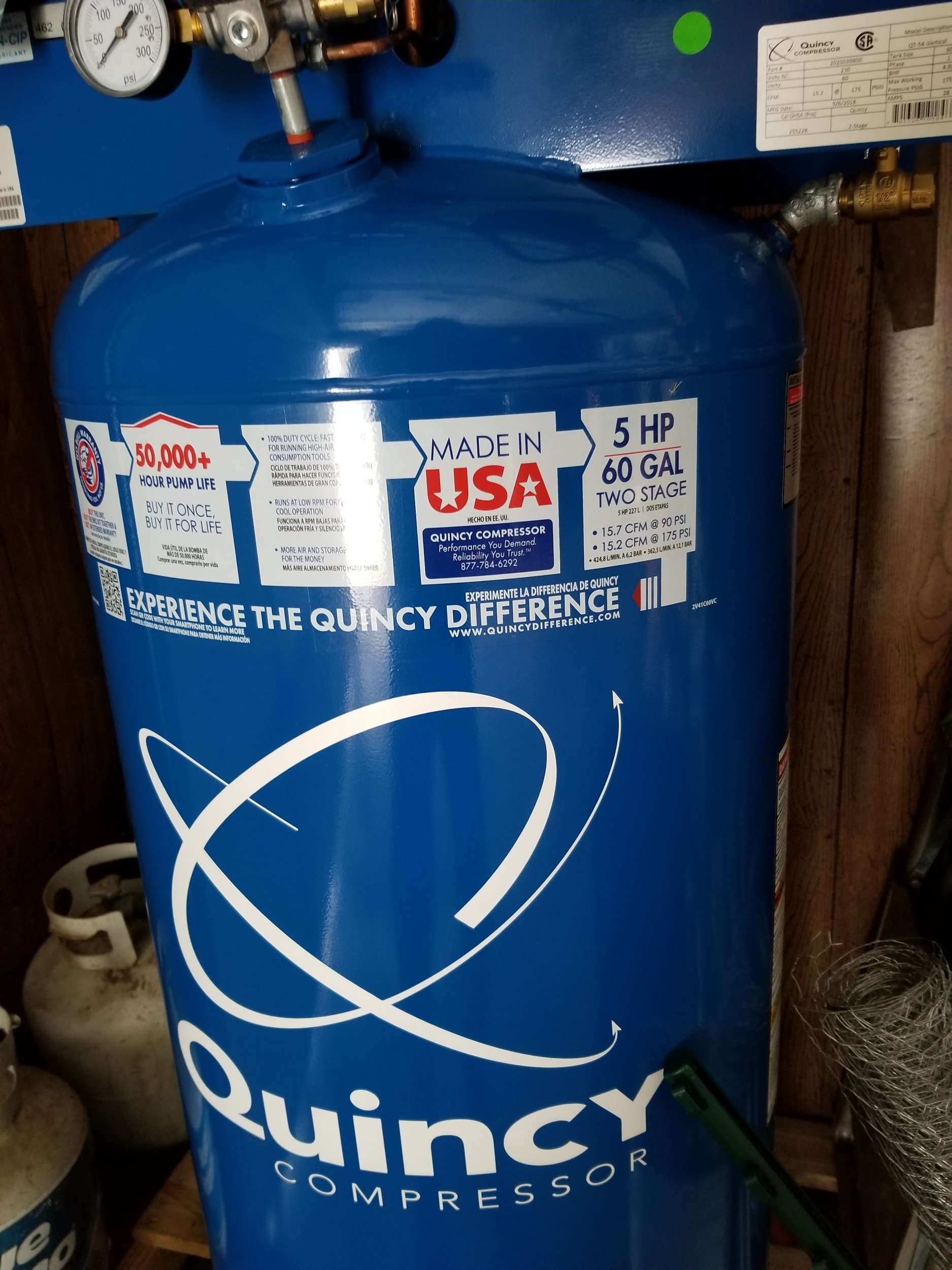

Love my Quincy:

Were you lucky and got one with the Baldor before they switched?
